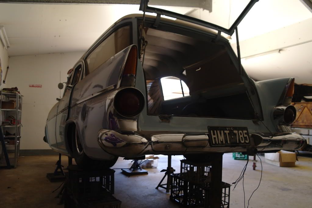

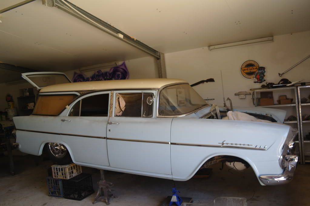

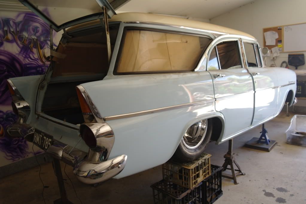

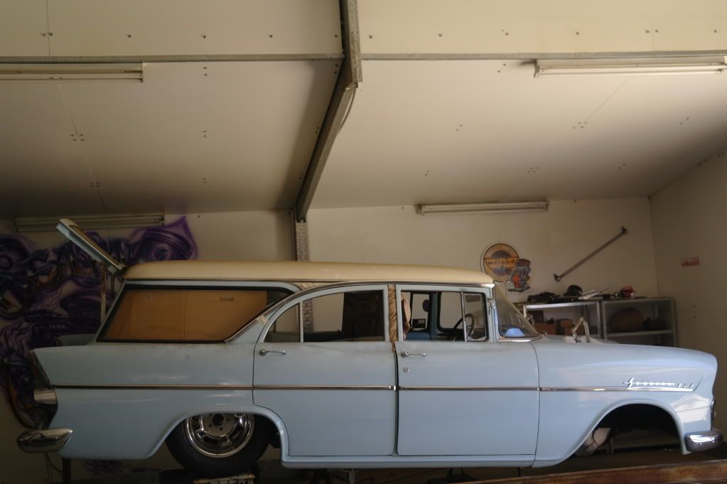

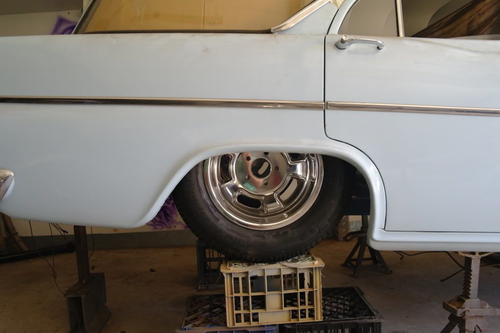

Hi All,
As promised,I have some current pics of the build,so far all going to plan(your right choppedfan,I am working to a plan)
Planning an old school look with Halibrand wheels,centre cap with spinner knock offs,none of this low profile stuff.
Got wheels sitting under the car,9 inch has been measured,getting cut & shortend as we speak,
Love the car to sit that low but it will sit at least 2 inches higher.
There`s no going back to stock now... :roll: :roll: :roll: ImageImageImageImageImage

Have you tubbed it ? They look too big to fit in a stock wheelwell

Blacky wrote:Have you tubbed it ? They look too big to fit in a stock wheelwell
Blacky after watching the kid's sedan build up anythings possible :esurprised: :esurprised: :thumbsup:

kidds wheel wells are no were near stock :lol: :lol: :lol:

wow that looks awesome i think my fc is getting some tubs now... cheers

Details, Details, Details............rim/tyre size you've used?, tubbed to the chassis rails or full tub?, what engine/gearbox ya gonna use?......we love details here :wink:

Starting to piece up the hr front end,gearbox will be a turbo 350(fully manulised)3:55 F##d 9 ",leaf spring rear end & for the pony at front,either a 307 or 327,depending on how big I can legally go.The bigger ci,the bigger hp,waiting on engineer to confirm... :?:
