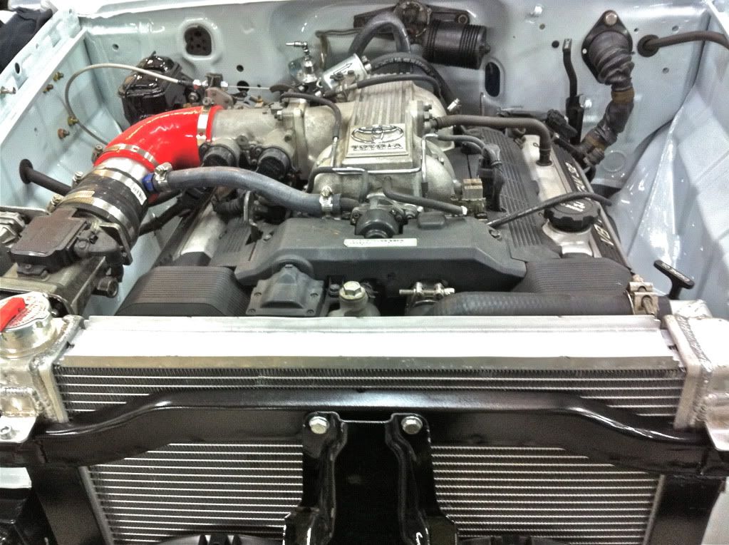

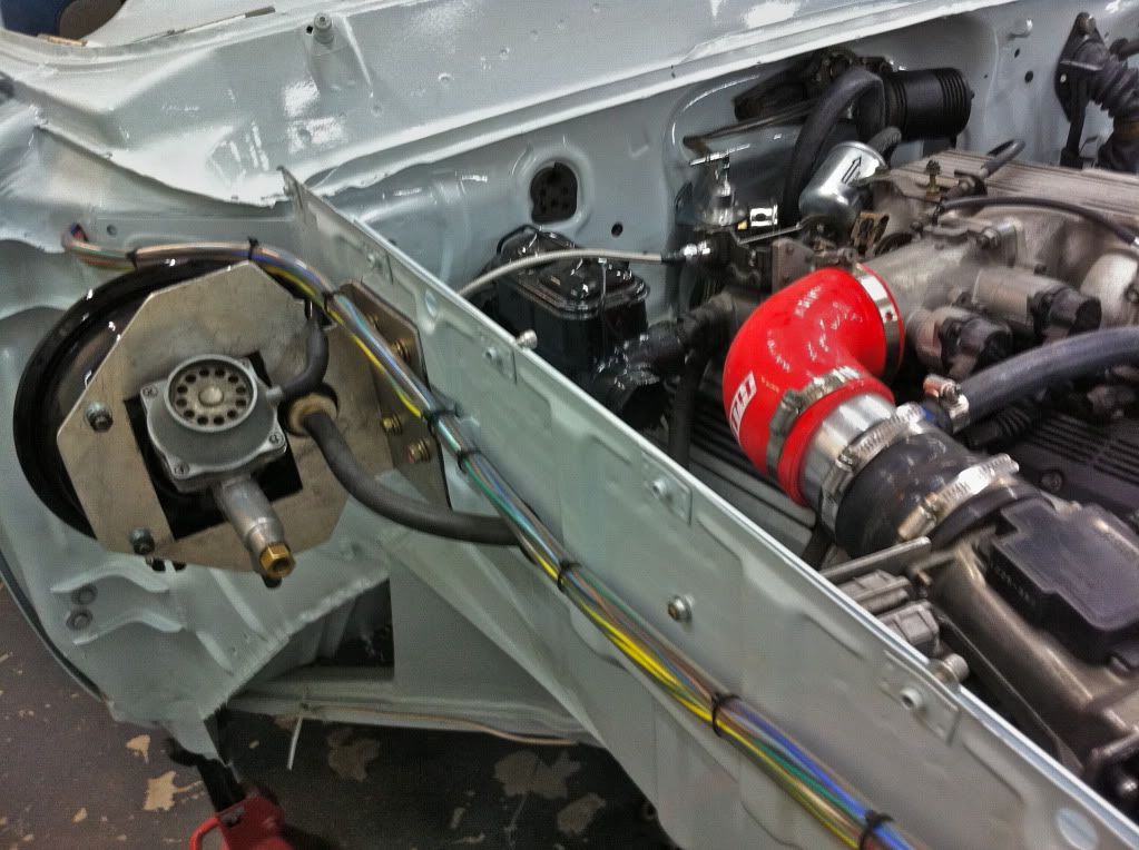

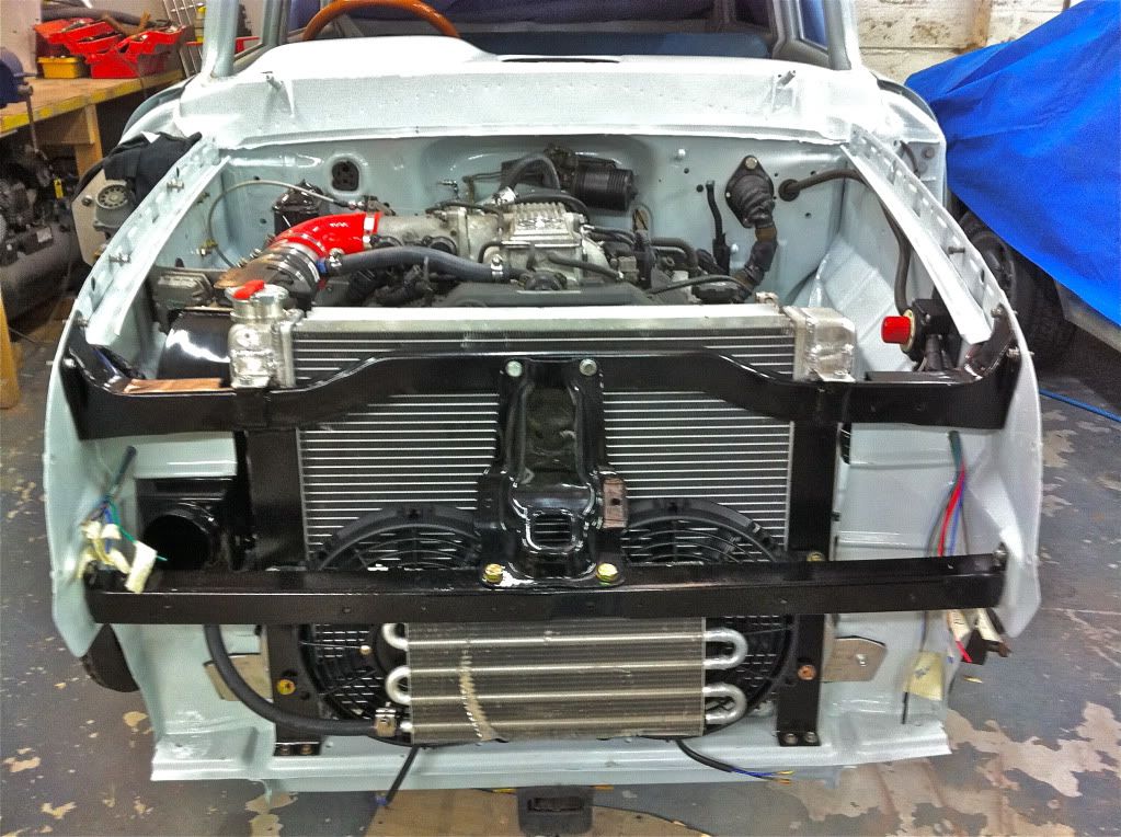

Have done a few more things in the engine bay , radiator, fans, trans cooler etc . getting close to making some noise I hope ,the wiring scares me a bit though , if anybody has any wiring info it would be appreciated.ImageImageImageImage

thanks Blacky much appreciated , here is some details of the engine ,computer etc . It's a 1991 Toyota celsior (LS400) UCF11 1UZFE V8 connected to a 30-41LE auto transmission , the ECU is 89661-50102 26p/16p/22p/26p . How is it over west at the moment , seriously considering looking for a job over there , things not to good here at the moment.
