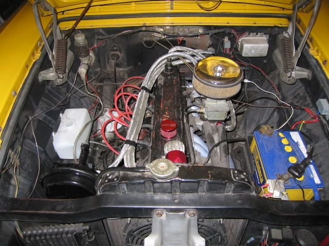

yes it is, and no there isnt.... have thought about moving it, but it has a gap behind it for flow, so cant be bothered, havent had any probs with overheating so farSammy wrote:just out of interest, on the drivers side infront of the radiator support, is that a tranny oil cooler ? if so is there a hole behind it for air flow ?
The Trans cooler is not doing its job there where it is located.
1stly it is mounted to high for air flow (the EK bonnet closes well below where it is situated.
2ndly there is no cooling from the fan at idle for good temp control for the trans.
3rdly, You will never know if the transmission is overheating untill its to late.
If the air transcooler has been used in conjunction with the radiator transcooler, then the above is not so bad as there is no benifit of having one anyway as the radiator cooler works very well in controling trans temps.
I would suggest to locate the cooler in a different spot for it to be efficient and if you do not have a radiator cooler, see if you can source a radiator with this provision. You'll be suprised as how hot the Auto Trans gets and at idle shes pumping through some pretty hot fluids.
Possible locations for cooler mount:
Behind the grill mounted in front of the radiator at the bottom.
Behind the front bar Under the gravel tray mounted at a 30 to 45 degree angle.
Regards John
