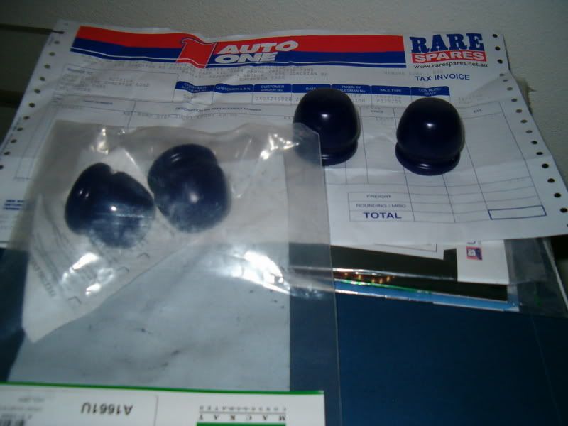

:shock: after 7 weeks the bump stops finally arrived...

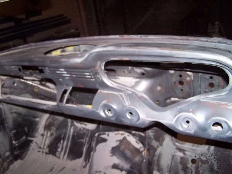

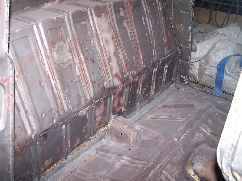

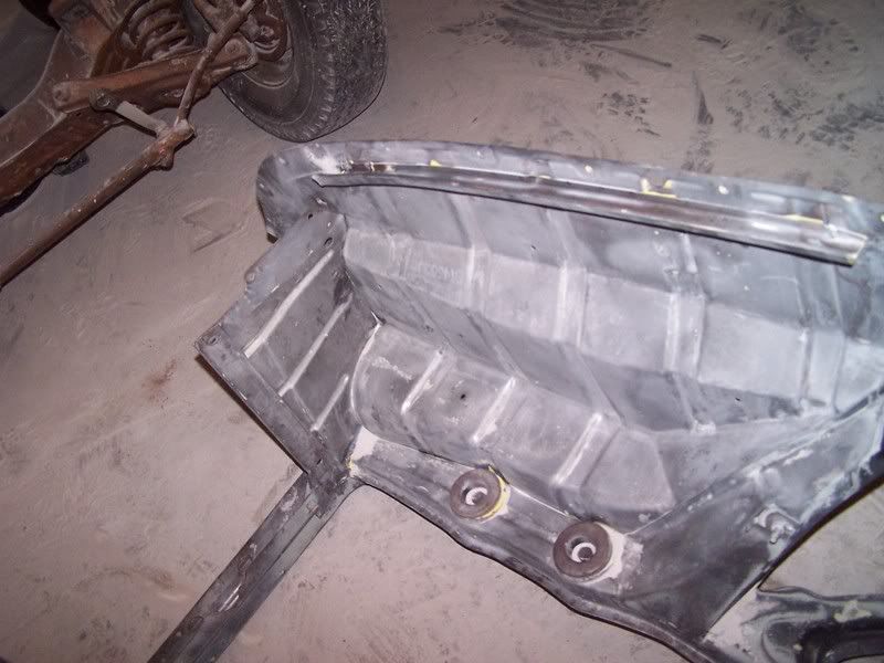

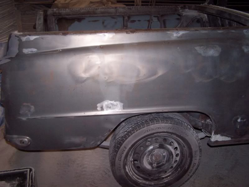

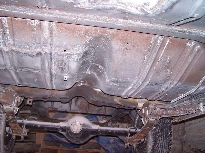

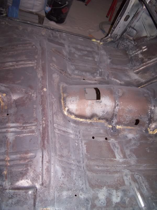

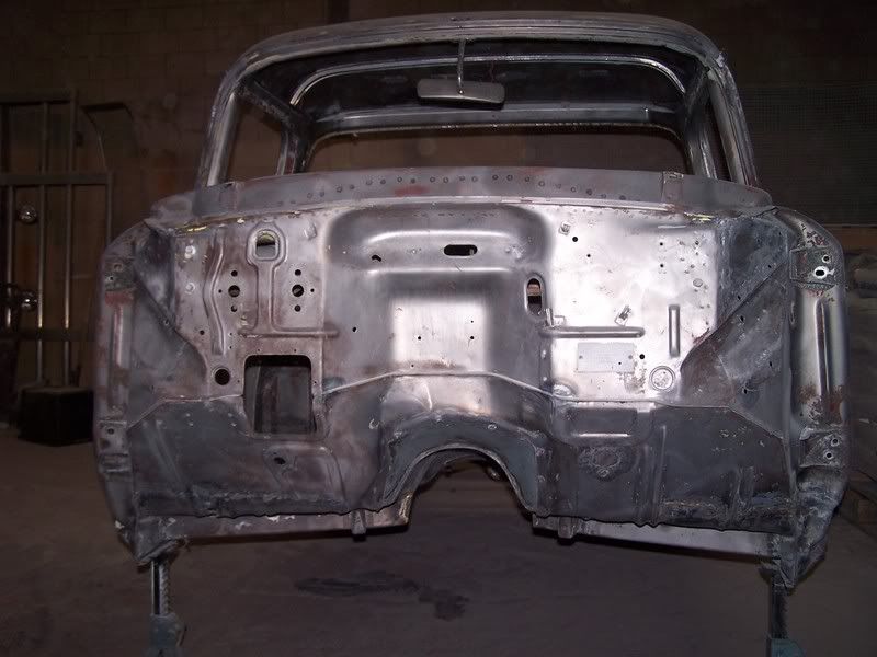

ok so i have got some pics of how the ute looked after soda blasting...
soda blasting doesnt pit the stainless or chrome and i even left the glass and rubbers in one door and it didnt damage them at all!

sweeeet :)

Looks great,
I’m at this stage myself tossing up weather to bead and sandblast or just
sandblast everything except panels or acid dip the whole thing, so I’ve got a question(s) for you please :)
Who did it?
where are they?
What did it cost?
Were they helpful?
Was there any disadvantages?
Regards Tim
ipg
Post by ipg »
Who did it? www.MelbourneSodaBlasting.com
where are they? Dandenong, off cheltenham rd near east link
What did it cost? 2400
Were they helpful? vince is a top bloke, pulled the front subframe off and put it back on after blasting.
Was there any disadvantages? can someone else fill this one in?...

smooth
Post by smooth »
My only concern is that it doesn't look fully stripped? For that sort of money I would expect it to be 100% perfectly clean. Still, most of the hard work is done. I just think maybe it could have been better......
