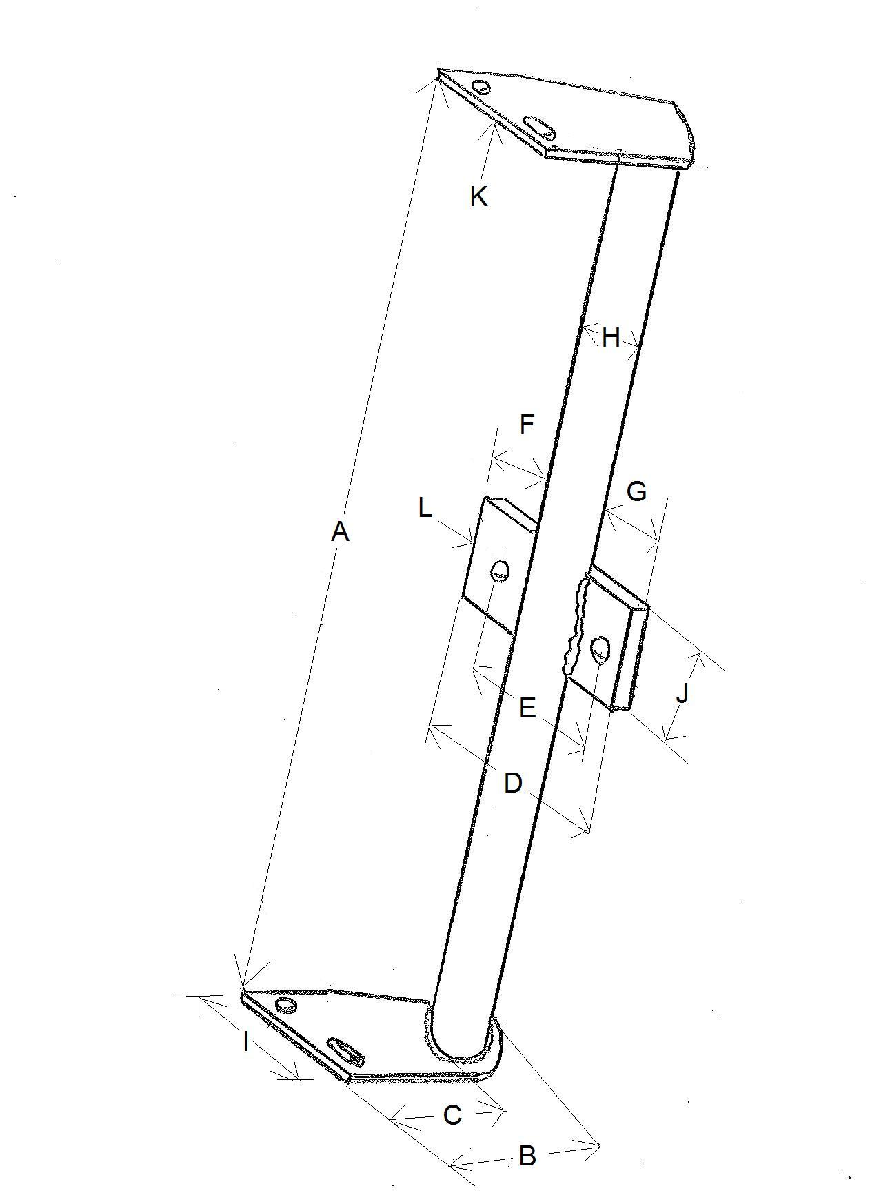

:mrgreen: The towbar in my sedan has a "dimension A" of 41.25". When I put the two plates either side of it, I get a width of 42.5". This is the distance between the two rear subframe rails on the sedan.
:mrgreen: The towbar that came off Bootlegger's panelvan, which also had plates, is also 42.5" across the subframe rails.
:mrgreen: My wagon towbar (which has the plates welded on) is 42.5" across the subframe rails.
:mrgreen: My "eBay special" towbar, which has no plates, is already 42.5" across the subframe rails.
:? Does your sedan towbar have (A + W + W = 37 + 3 + 3 = 43") across the subframe rails, or have I counted two thickness of 1/4" plate twice (ie it's really 42.5")?
Looks like:
:mrgreen: my "e-Bay special" will sit 0.75" lower than your ute bar (my "dimension B" is 6.5", your (X + V = 3 + 2.75 = 5.75").
:mrgreen: my "e-Bay special" will stick out 0.75" further behind the car than your ute bar (my "dimension I" is 5", yours is 4.25")
Now for the hard question:
:mrgreen: I have 1 3/8" of tongue plate sticking out behind the drawbar, you have none. Because my drawbar sits further back, I think my tongue plate would sit (1 3/8" - 0.75" = 7/8") further forwards than yours.
On your ute, at 0.75" lower than your tongue plate, is there a gap of at least 7/8" behind the drawbar, or is the fueltank in the way?

I know this is a bit of an old thread but now that the photos don't work is anybody able to explain what the letters are for all the measurements? I need to make a tabor for a FB sedan.
Cheers Ben

Apologies for the missing images... PhotoBucket no longer wants to talk to me. Image below will help.
towbar sketch.jpg (114.34 KiB) Viewed 8405 times
