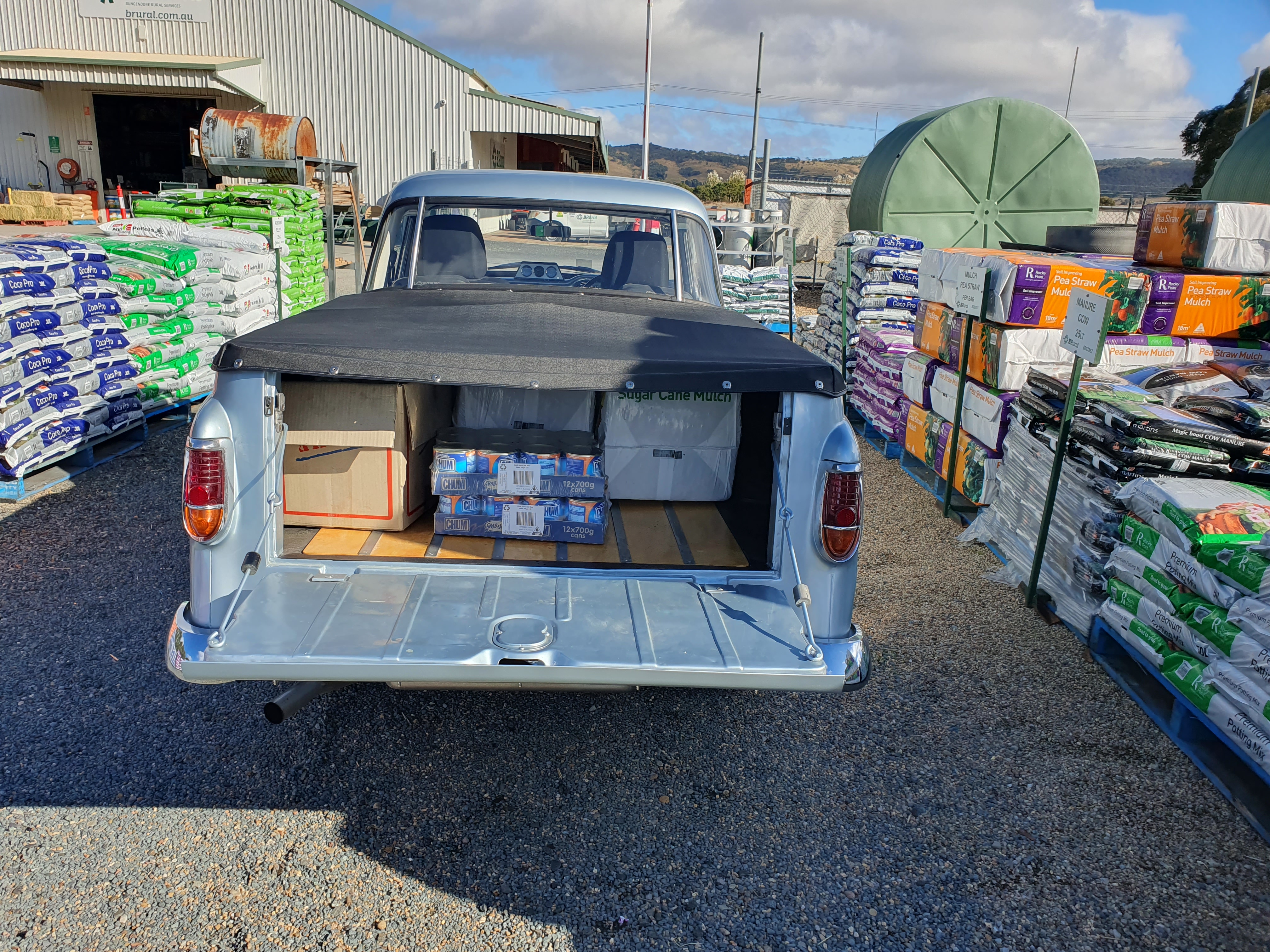

Ute doing utey things today.

Hmmm… gardening followed by happy hour nibbles for the pup :thumbsup:

Nothing gets past you Stephen! Spot on.

That's what they are for :thumbsup: the tray in my ute hasn't been completely empty in years ......

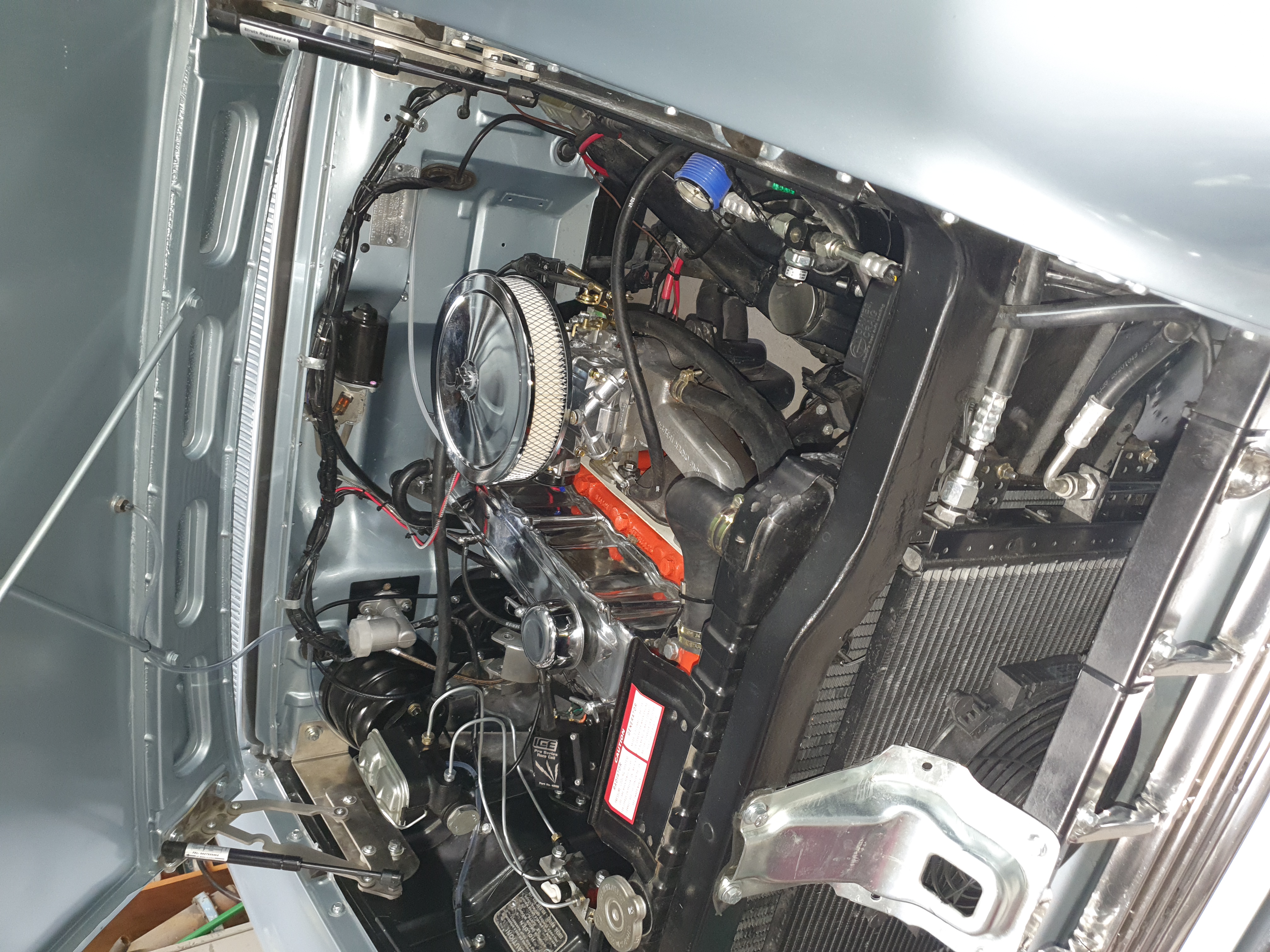

Tripples are sold and heading to an LC XU1 in Sydney I believe. Still have the LJ XU1 manifold and CD175s but they need a lot of work.
The WW has proven to be a great carburetor and with very little tinkering has worked very well.
Now it's Holley's turn. First try out of the box and motor was awash with fuel. With Harv's suggestions on main jetting and power valves it's now a different story. Good running now and I can instantly feel the difference from the WW's capacity ( 280cfm I think) and the Holley's 350cfm. Will see how it goes longer term.
The firewall indent is telling me it needs tripples to be happy, but not happening at the moment....

Good to know the WW worked well. Is that the one I sold you?
Posts: 2518
Re: Project 2.
I'm not sure Clay. I ended up with 4 of them. The one I put some effort into and used had a manual choke. Definitely your manifold though. Having troubles now with the 350 being too lean on the road. Consulting Harv.

Yes it's only a matter of jets and power valves and a few other minor fiddles. I like the feel of it already though.
Posts: 2689
Re: Project 2.
Looks nice Brett,
I must admit for ease of tuning and keeping it there you can't beat a holley.
If you go webbers it can be painfull to keep the tune, although you wont see the full potential of the 6 without them.
Looking at the picture it floods me with memories, and yes i ended up with the webbers then back to the SU's then out with the 6 and into V8's.
Something is wrong with me ! Every car i have owned, it has been tested and tortured to get the best and the most power, a man just can't sit still !
Have fun with it.
