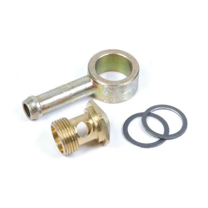

Any advice on fuel line connection to 350? It came with a bigger flared straight tube that heads straight to the cylinder head. I need a 45degree bend and smaller diameter tubing to match up with original fuel line. Other than that I think it's sorted.
Re: Project 2.
Posted: Thu Apr 18, 2024 7:27 pm
I'd re-run the fuel line from the pump to the carb in larger line, and use a different adaptor (1/8-NPT to 3/8 inverted flare) at the pump.
An easier way out is to get a banjo fitting that runs to a nipple (Holley part number 26-25). Point the nipple down 45 degrees. Slide the flare nut back slightly on the original fuel line, and bend it out of the way a little. Run a 3" length of rubber tube between the original fuel line and the banjo nipple, relying on the original fuel line flared end to act as a barb.
I'm not a fan of the easier way out as rubber or braided hoses for fuel lines are a pet hate.
Re: Project 2.
Posted: Thu Apr 18, 2024 7:31 pm
by Brett027
Thanks Harv. Will that banjo fitting just seal up against the carb body ( and not use the flared fitting inside)?
I was wondering about the fuel line size, but figured it all flows through the needle and seat so probably not a problem with the original line size. Hopefuly it's not sooo thirsty that I need so much more fuel than before. šŸ¤”
Re: Project 2.
Posted: Fri Apr 19, 2024 6:54 am
The banjo fitting seals with two washers, one of which is up against the float bowl body.
Holley banjo fitting.jpg (25.52 KiB) Viewed 4729 times
You probably don't need bigger fuel lines.

I was thinking last night that I might silver solder a made up original diameter fuel line onto the supplied fitting as it slides neatly inside - just need to adjust the bends a bit. I'm keen to crank it up and test today and I've got new fuel pipe left over from the resto. The pity of it all is that I have to lose my filter/ pressure regulator and guage.
