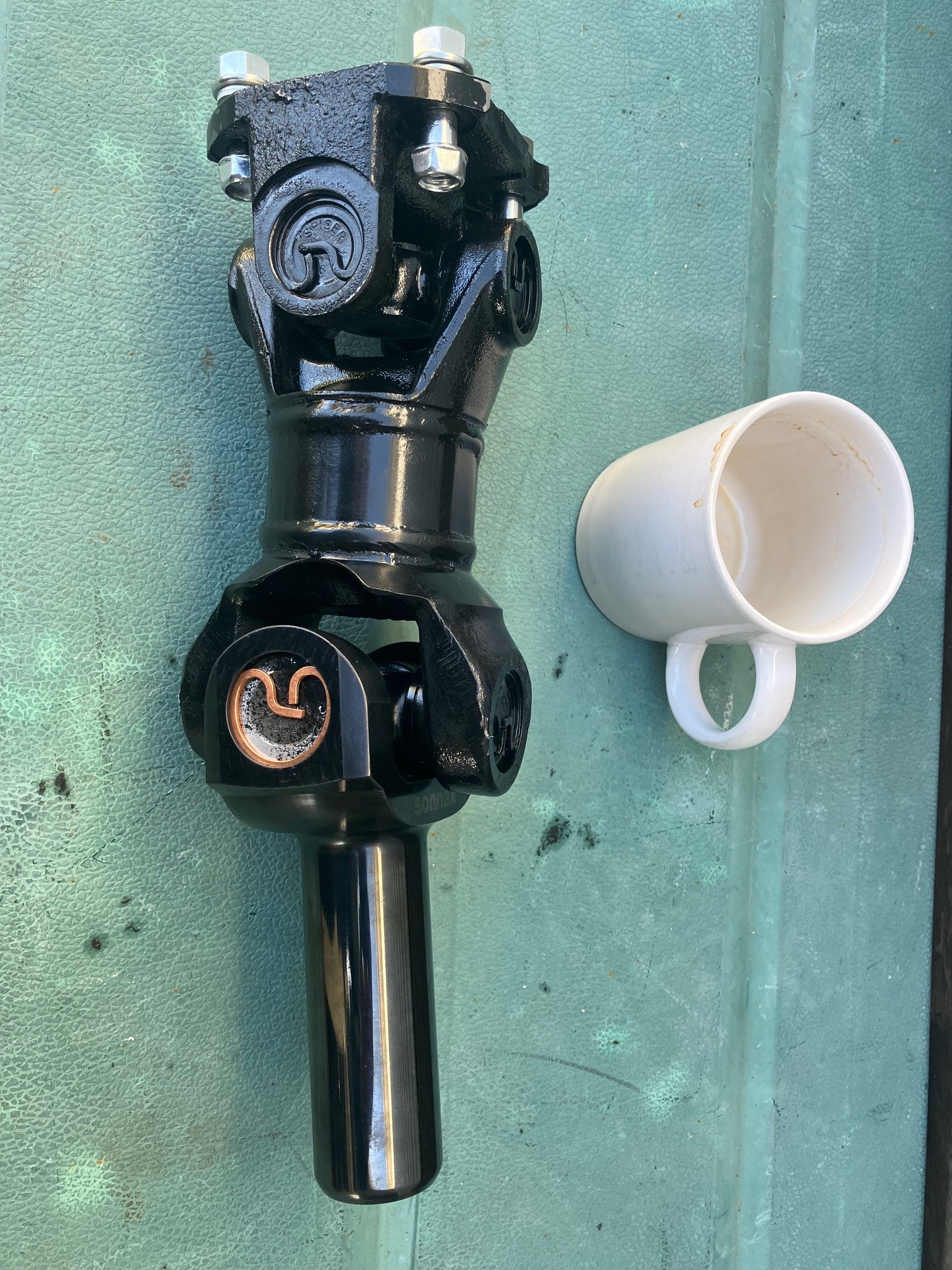

Brett027 wrote: Tue Feb 20, 2024 9:57 pmI had to sign a disclaimer that had the maximum shaft rpm listed.
I didn't have to sign a disclaimer, but am praying this thing does not deform in the FED. It sits between the legs about mid-calf for the driver :wtf: . Has to have a minimum 1/8" thick steel plate cover around it, connected back to the chassis. It's on the to-do list for next time I'm home.
Shortened driveshaft.jpg (906.7 KiB) Viewed 2542 times
Re: Project 2.
Posted: Wed Feb 21, 2024 7:10 am
by Brett027
No chance I reckon Harv. If your shaft has the same end plugs that they welded on mine, your shaft would be solid inside😀.
