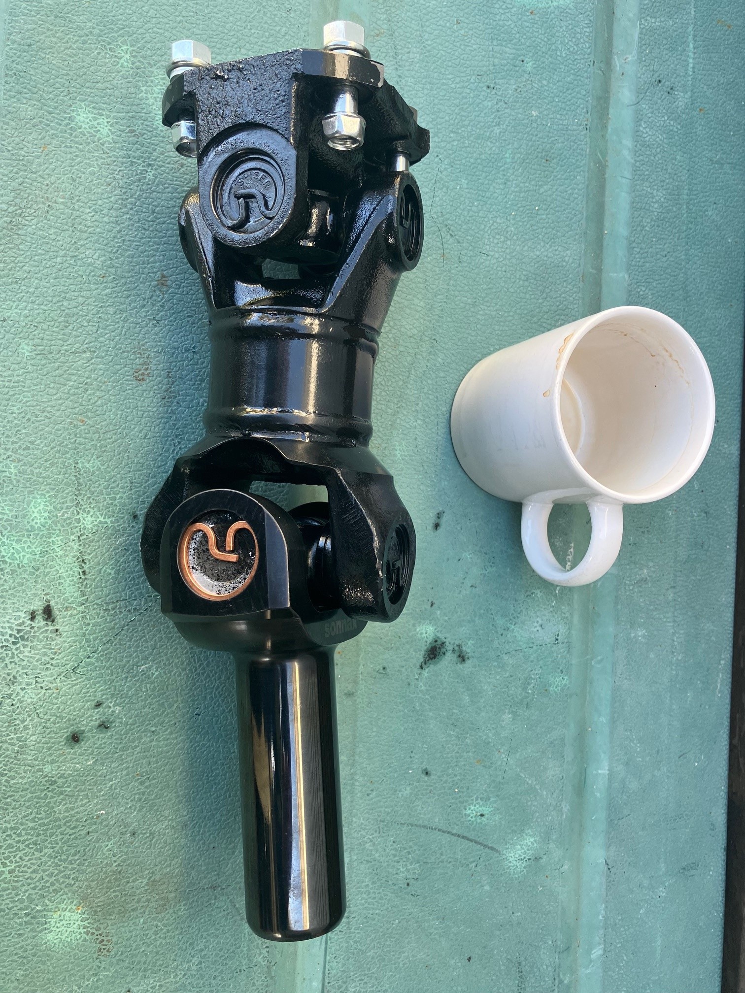

I didn't have to sign a disclaimer, but am praying this thing does not deform in the FED. It sits between the legs about mid-calf for the driver :wtf: . Has to have a minimum 1/8" thick steel plate cover around it, connected back to the chassis. It's on the to-do list for next time I'm home.
Shortened driveshaft.jpg (906.7 KiB) Viewed 2584 times
Posts: 2536
Re: Project 2.
No chance I reckon Harv. If your shaft has the same end plugs that they welded on mine, your shaft would be solid inside😀.

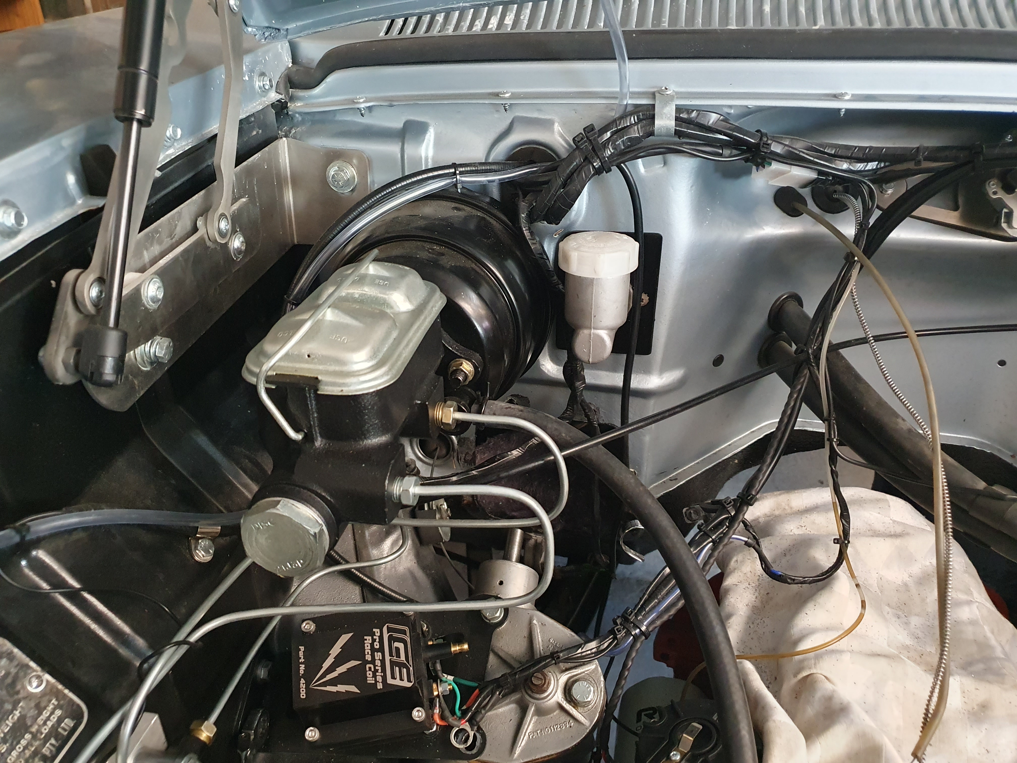

Bit of progress. Modified the pedal box to return to hydraulic clutch and made the necessary changes to accept the smaller bore master cylinder that works with the hydraulic throwout bearing. I was toying with using the original EK clutch hydraulics on the W50, but common sense (and finding that both my spare EK masters were US) prevailed. Clay you might recognise something in the photo.
Next big job is modifying the floor around the steering column base to fit the Prius electric steer unit.
Posts: 11675
Re: Project 2.
Yes. Everyone that looked at mine said it was off a trailer, but I asked for XR &*#@.
Posts: 2536
Re: Project 2.
It is petite😌. Just as long as it works like it should.

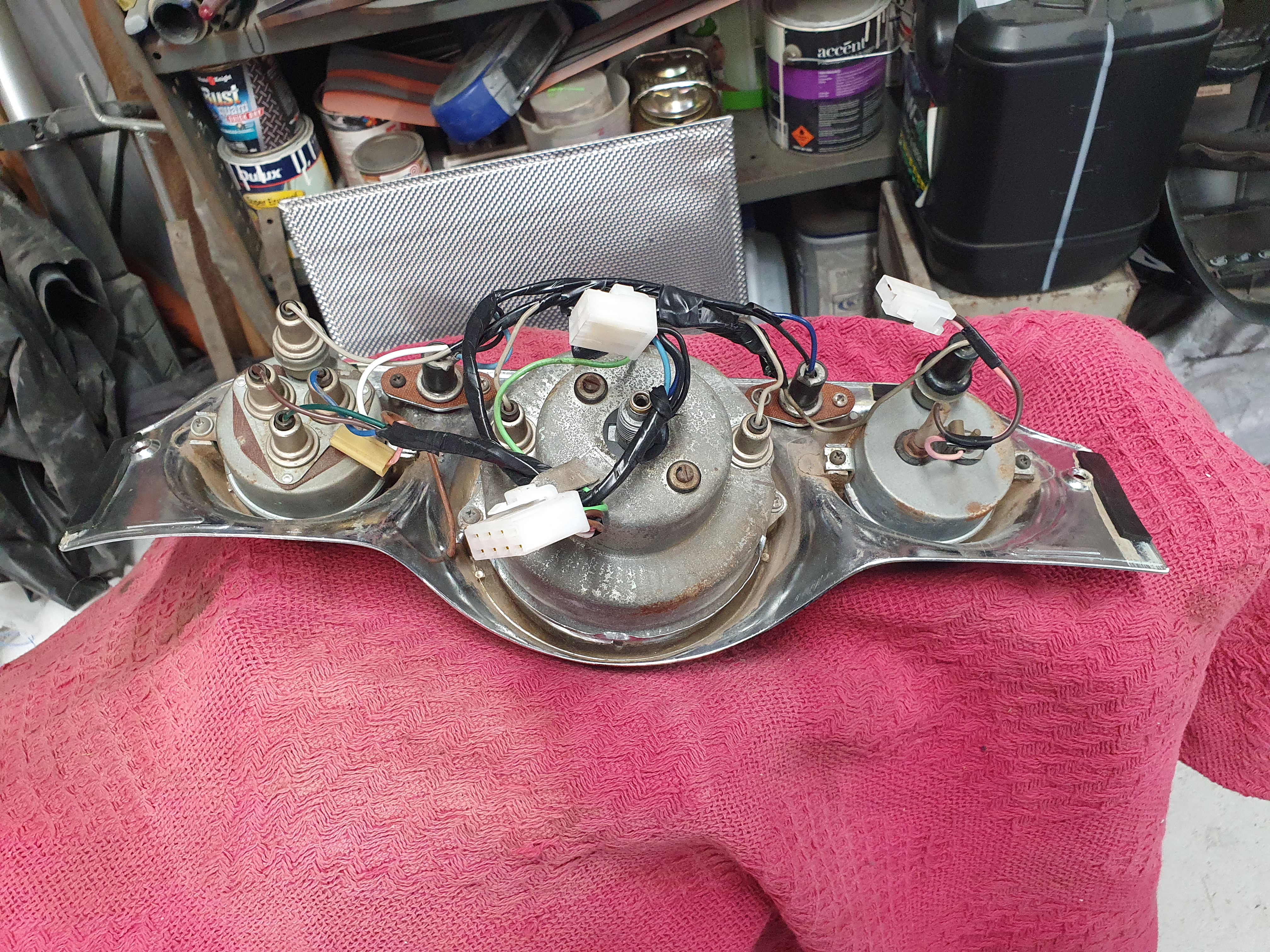

While everything in and under my dash is in a thousand pieces, I thought I would share one of the simplest but very rewarding changes I made to the ute. Putting connectors on has made popping the instrument panel in and out so much easier.
Posts: 5743
Re: Project 2.
Playing dash-bulb roulette is half the fun :lol:
Posts: 11675
Re: Project 2.
Great idea Brett.
Posts: 2536
Re: Project 2.
Thanks Clay. I reckon it saves me a heap of trouble anyway.

Nice one Brett, that is definitely on the to do list. Like the way you grouped everything too.

Post by Wrongway Roger »
Thanks for sharing Brett.
I'm current rewiring the ute and this will tidy up a heap of them.
