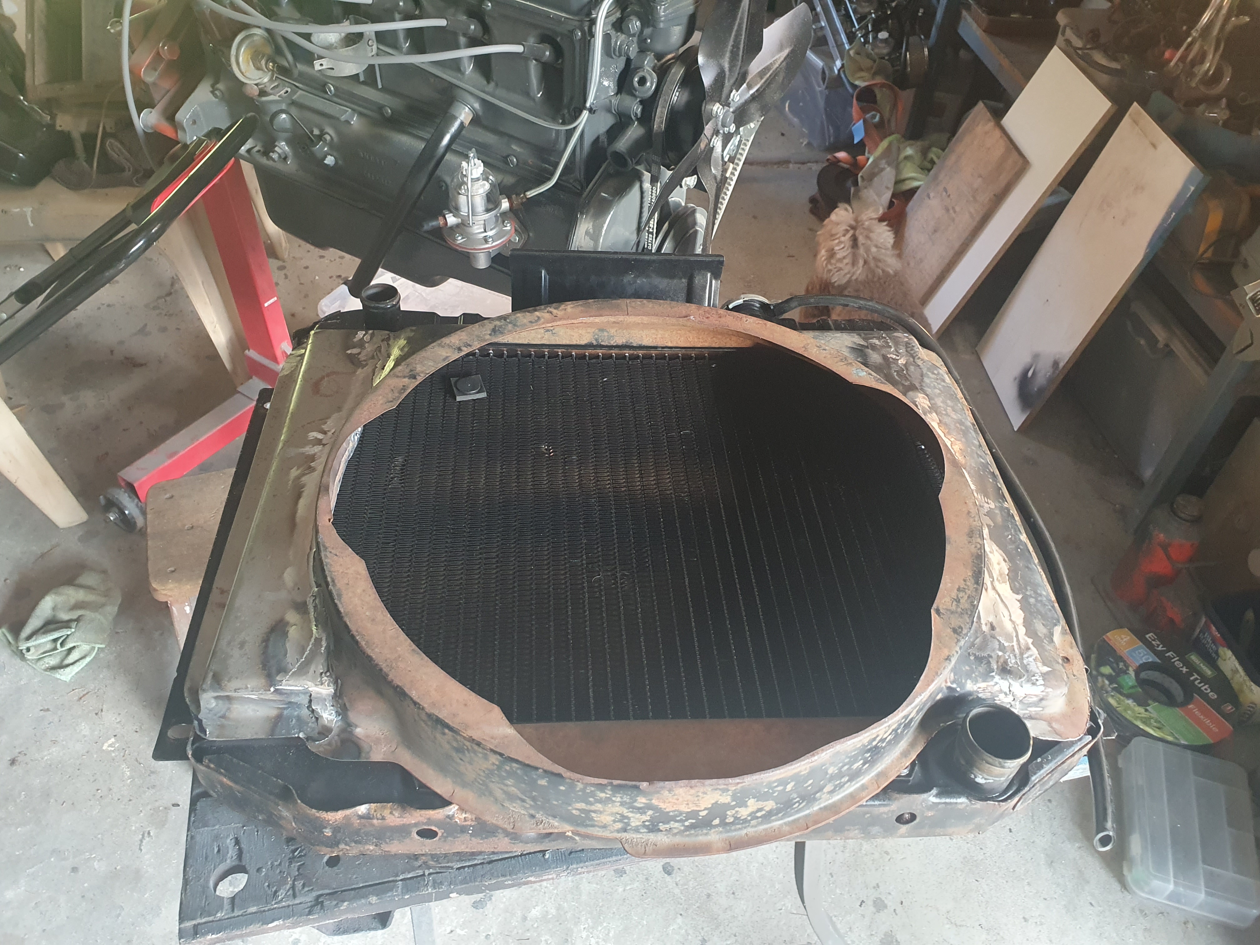

Mucking about with a Holden Shuttle fan shroud today. Probably should be silver soldering but went gung-ho with the MIG. More to do, but basic shape is there.

Shroud needs the centre cleaned up and bolt tabs welding on. And of course, seeing if it works!

Rough job finished. It wil be a nightmare to change the fanbelt. Going to stick 1cm strips of black foam around the edges that butt up around the radiator.
