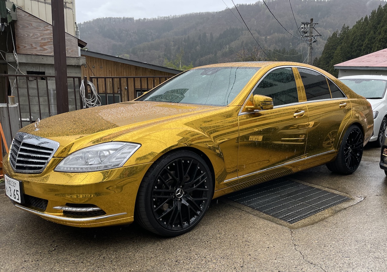

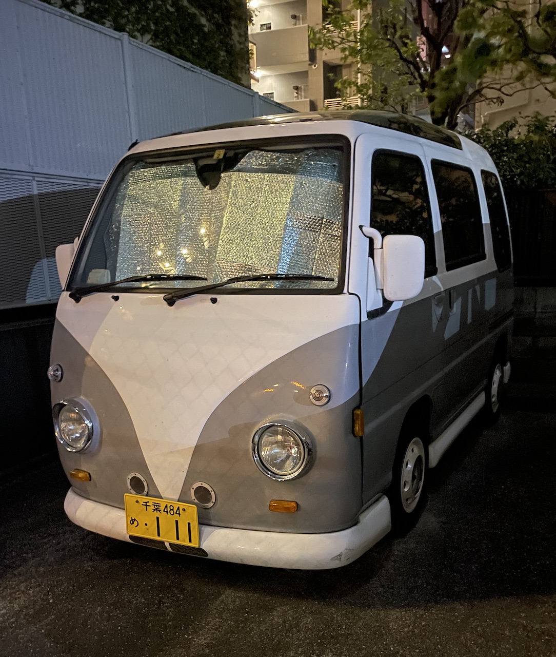

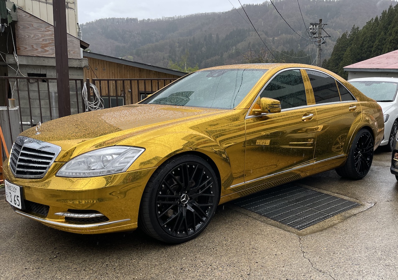

Update on body work: photos attached!

Those wheels might work on the ute?
