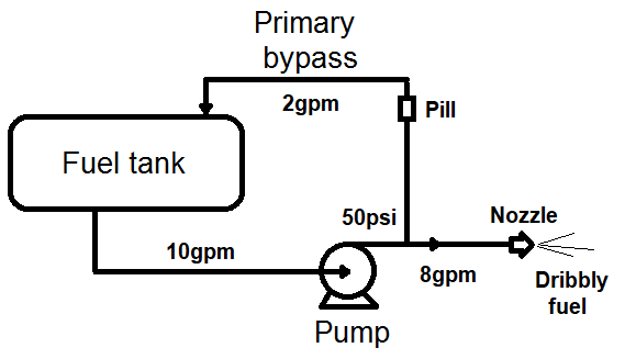

Take as an example a car running as per the image below. The car is running (imagine the banshee wail), spinning the pump up fast enough to deliver 10gpm. The engine only needs 8gpm, so the pill is selected to make 2gpm flow back to the tank. Because the nozzles are a little big, the fuel pressure only gets to 50psi. It’s not the end of the world, but 50psi doesn’t give great vapourisation out the nozzles.

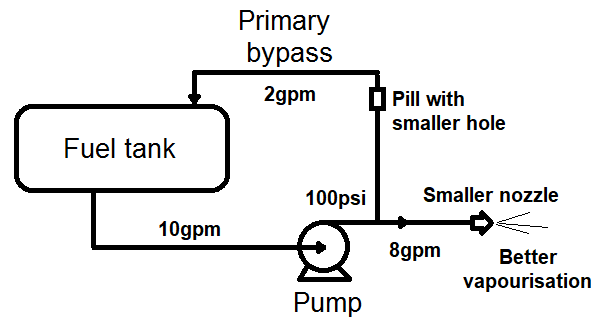

We could swap in smaller nozzles, like the image below. The car is still running at the same revs, the pump still puts out 10gpm, and the engine still only needs 8gpm. The smaller nozzles make it more difficult for the pump to put 2gpm into the engine, so the fuel pressure ends up higher (in this case 100psi). The pill will also be a little smaller too. With 100psi the fuel is better vapourised.

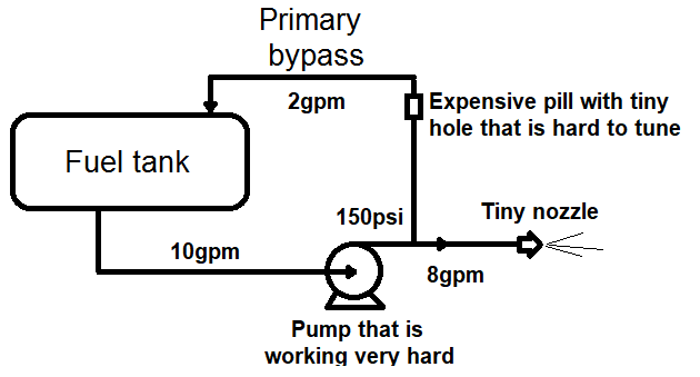

We could go too far though, and put in tiny nozzles like the image below. Fuel pressure comes up to 150psi, making the pump work hard (more load on the gears and drive, more leakage past the seals). The pill would need to be much smaller too, with the tiny pill sizes being more expensive. There is less room to move tuning with tiny pill sizes, making life harder at the track.
