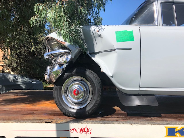

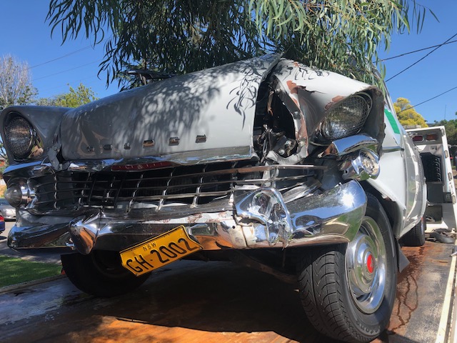

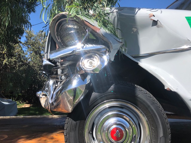

After much mucking around, we have gotten Grace's ute repaired and back on the road. I've held off posting much until it was all sorted.
A couple of months back, Grace was driving home from school when a bloke pulled across the front of her. He didn't look, and somehow did not see the ute. Busted up the front of the ute, and sprained Grace's hand (thankfully healed). Broke the other blokes arm, and stove in the side of a VS Commodore wagon.
Ute was written off, but thankfully is over 15 years old so not a stat write-off. The blokes from Hawkesbury Smash did an awesome job of resurrecting the old girl, with thanks to those of you who contributed parts. Still a few odds and ends to sort, but it is now legally back on the tarmac again. Photos below are not for the faint hearted.
Face like a pug.JPG (161.6 KiB) Viewed 1350 times
For looking around corners.JPG (119.05 KiB) Viewed 1350 times
