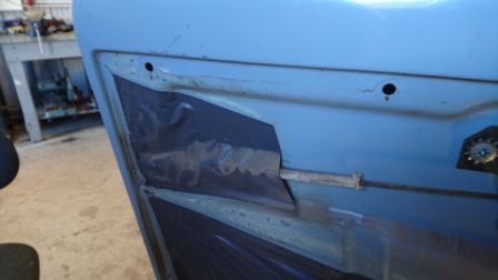

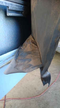

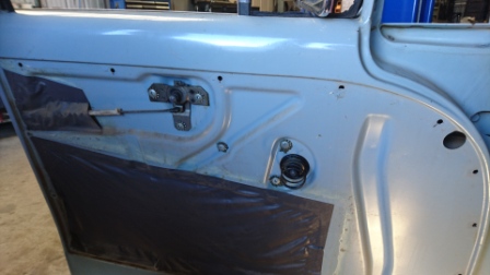

Doors all good on the inside, still had the original plastic sheeting with inside plastic lip.
