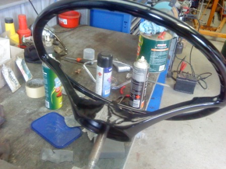

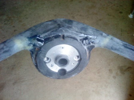

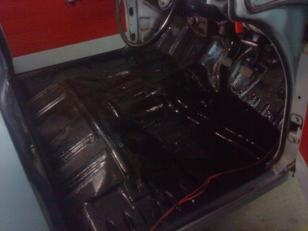

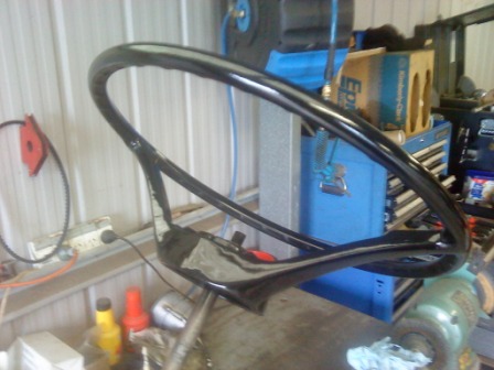

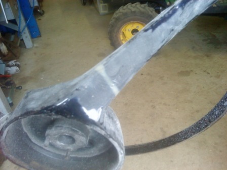

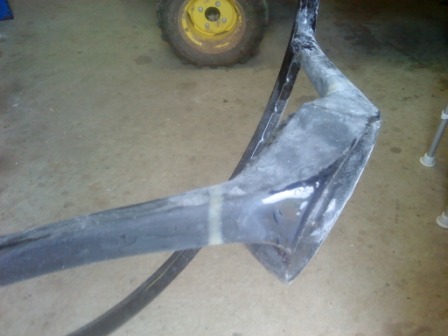

Well the acid is on. Booked for roadworthy next week. Finished the steering wheel. Had to have a few goes at redoing the epoxy as I had trouble with it running even after letting it sit for a couple of hours before applying it. Cleaned up the surface rust on the floor and jammed it up. Final bleed and adjust for the brakes done. Just a few fiddly bits and it should be good to go fingers crossed.

Hi Craig,
What was the epoxy and paint you used on the steering wheel. Apart from the challenges with the epoxy running were you happy with the result?

With the epoxy did you do any dowels between the two surfaces or is it just epoxy binding ?

In the Shed wrote:Hi Craig,
G'day Stephen, the epoxy I used was 2 part Araldite, nothing special there. Paint was acrylic with edhesion primer for plastic. I may or may not do a clear coat on it, haven't decided on that as yet.
I'm happy so far but you dont know till you get some usage on the wheel to see if it cracks again at the repair spots. I think overall all if you have a wheel that hasn't become excessively brittle over the years and it has only a few cracks from being over flexed then its a worhwhile job. I have another old white wheel that I reckon it would take weeks to repair and would only crack in different places after that. Bad wheels would need re plasticising and the cost of making moulds would be prohibitive unless you could arrange a run of wheels.

EK283 wrote:Don't tell me you drove this car down to the river without a RWC naughty boy :helleyes: :helleyes: :helleyes:
Ok Greg I won't tell you! :tongue:
I did relent later and get a permit :sealed:
No Dowels just binding. I did a test on an old wheel and the epoxy seemed to chemically react to the plastic so it appears to bond ok. Rough surface areas where the best for adhesion.

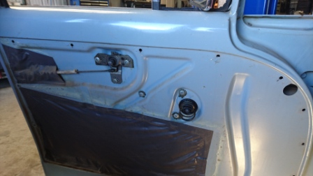

A little set back today. Finally got to fill the tank right up only to find out its leaking really bad around the sender. Was looking like I'd have to pull the back floor up again and worse if it was rust. Drained the tank, managed to get the sender out reaching though the spare wheel access door. Luckily it was just a shot gasket. All fixed.

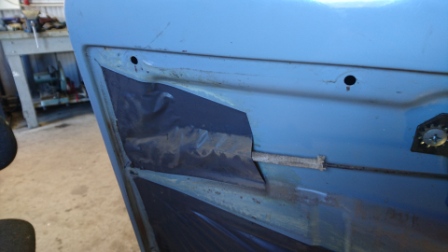

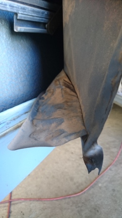

Changed quarter vent seals...... a day of fun!
Doors all good on the inside, still had the original plastic sheeting with inside plastic lip.
