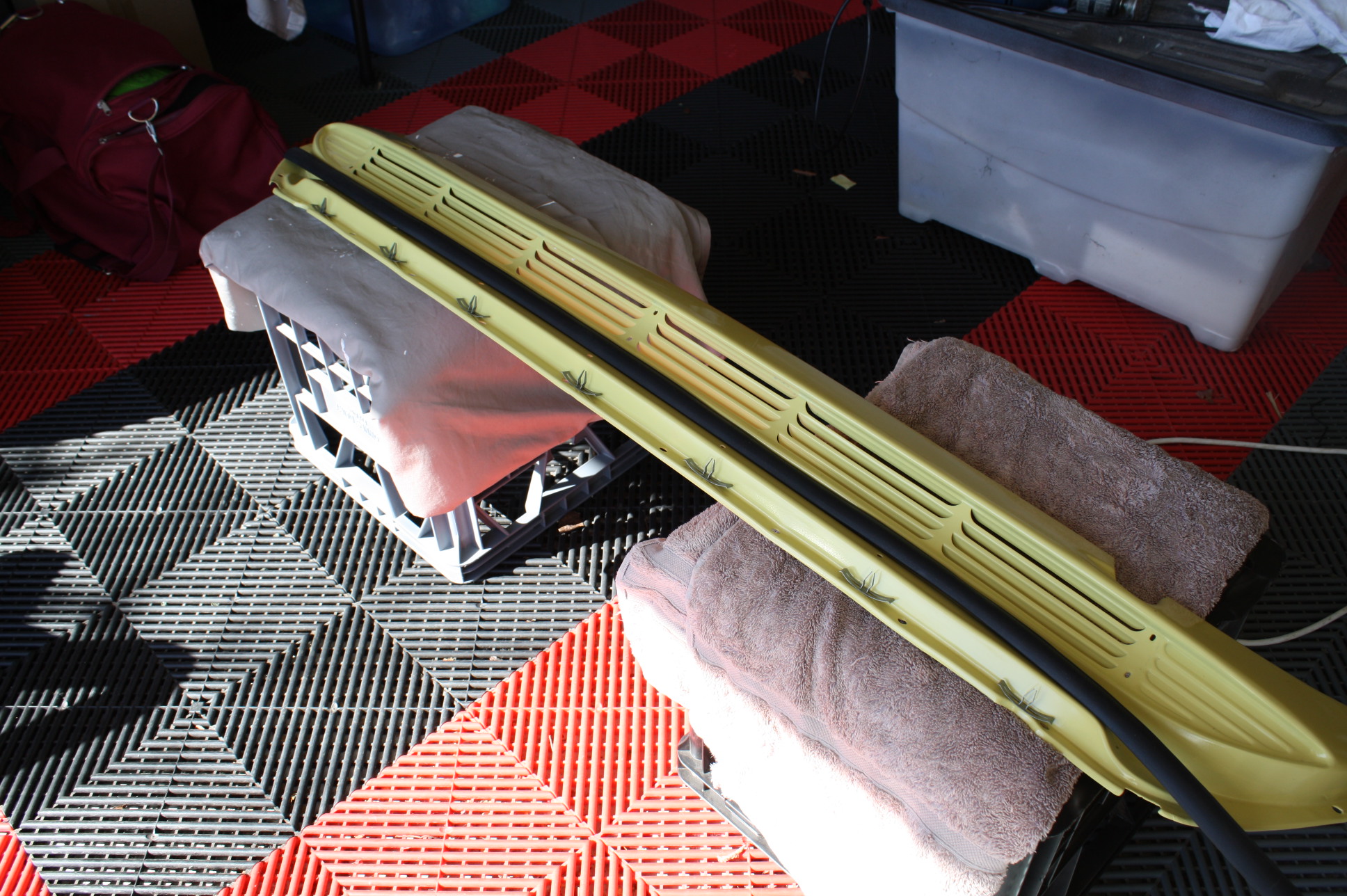

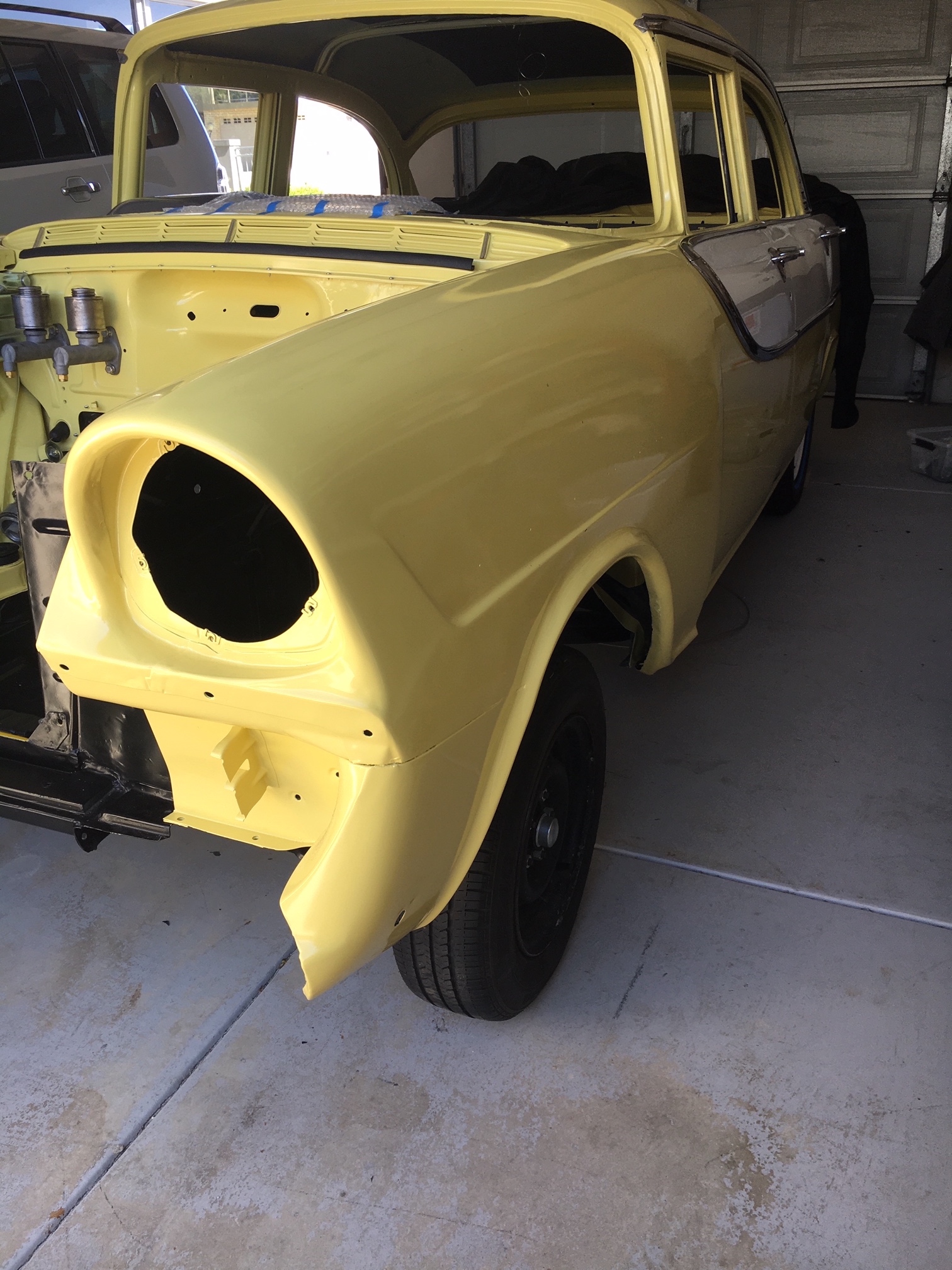

A bit more progress, slowly but surely!!

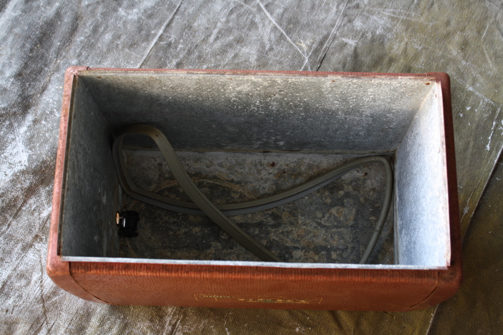

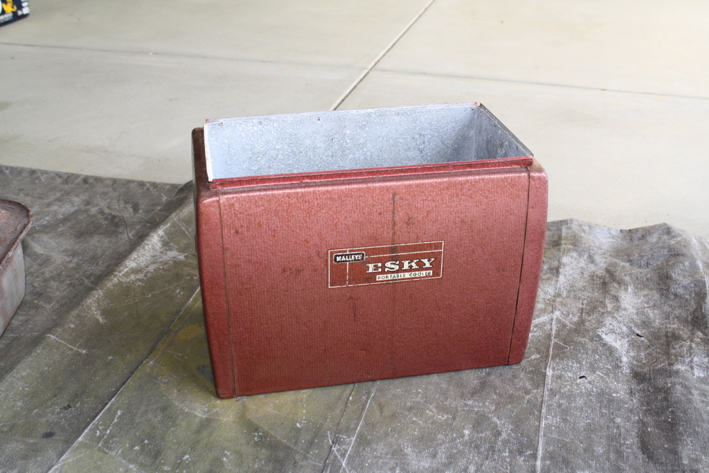

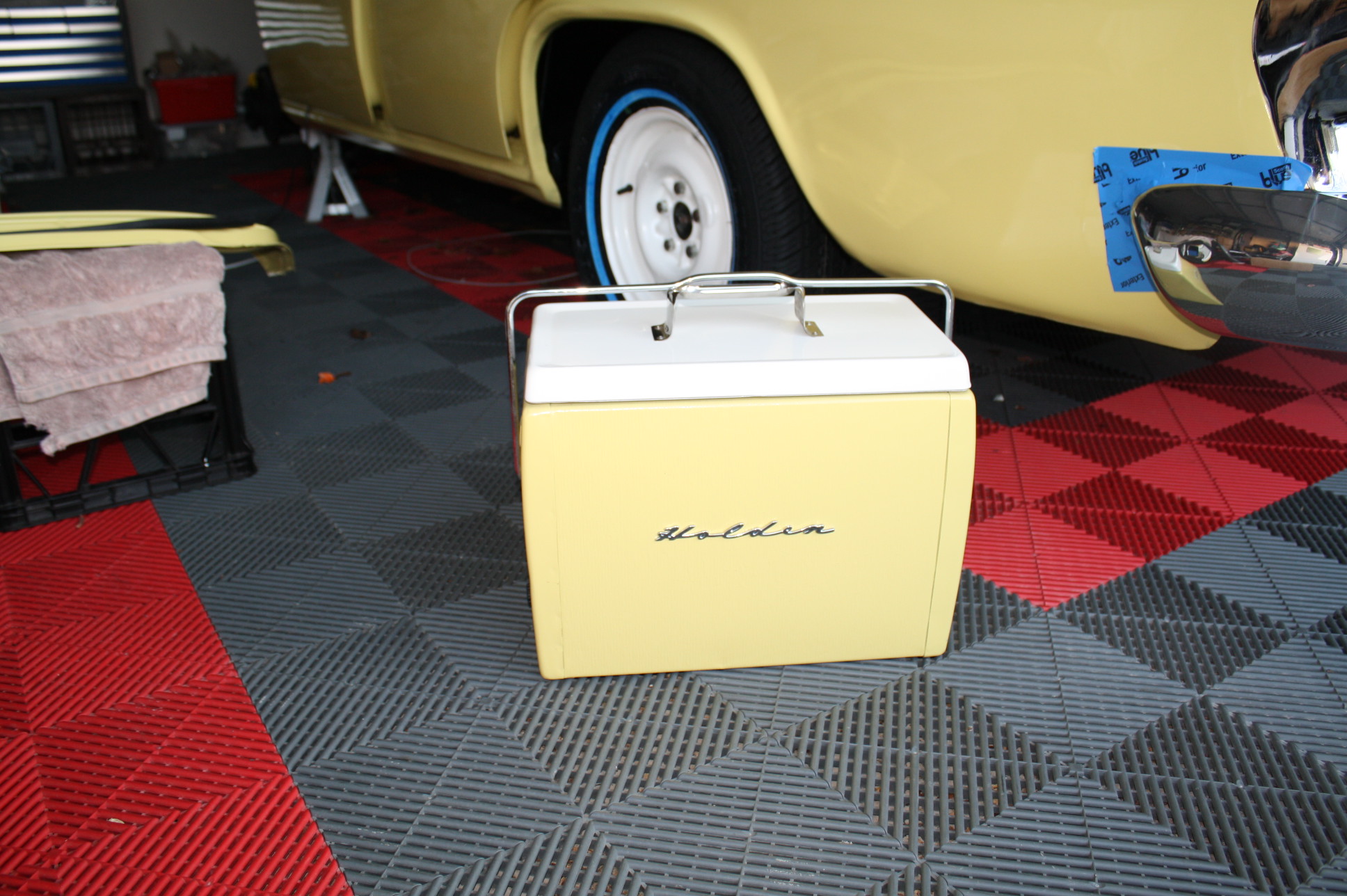

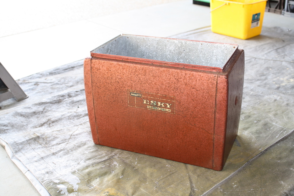

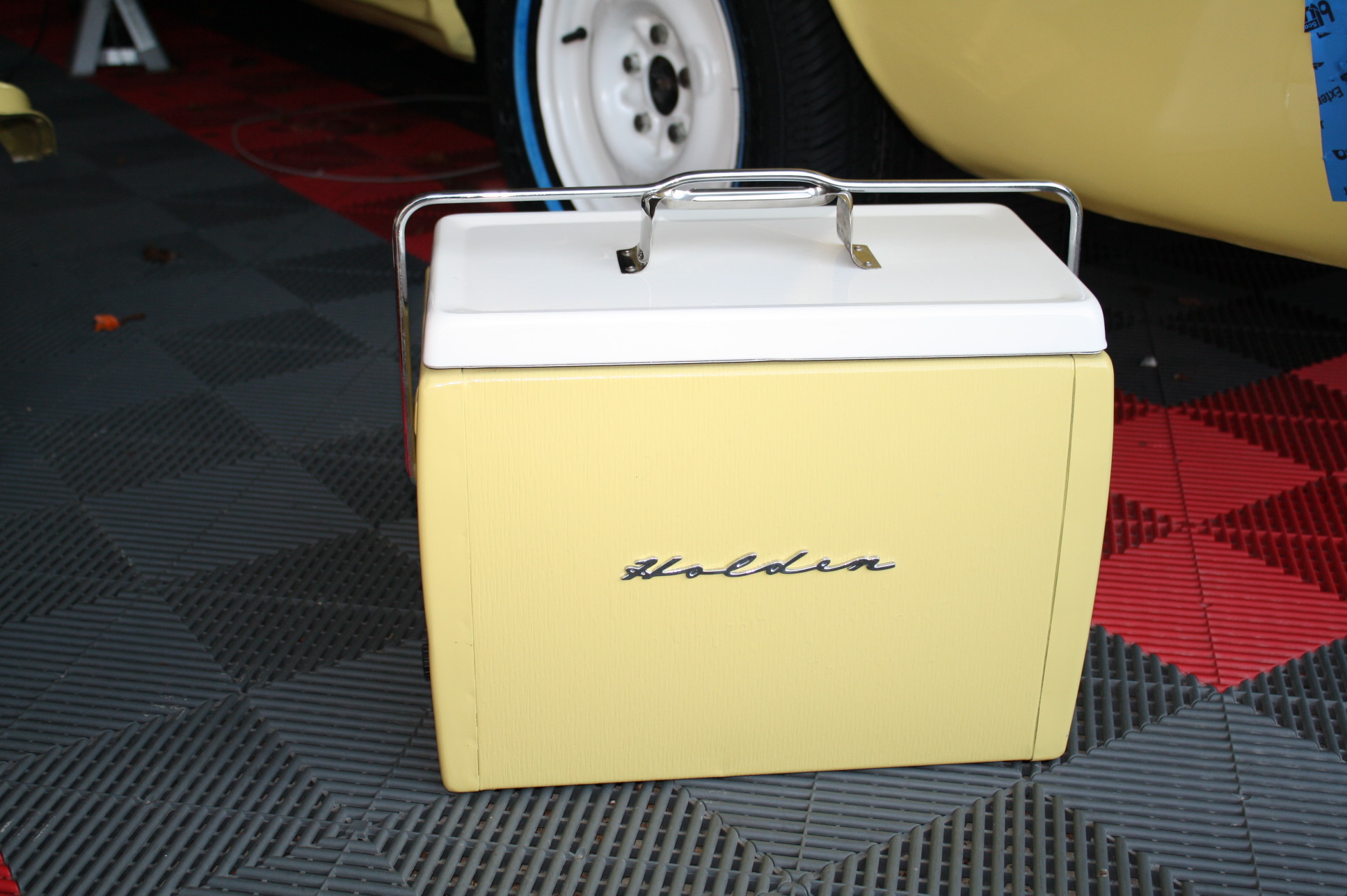

The original Malley's Esky, it was pretty rusty and had no lid
The original Esky
The original Esky
Posts: 5654
Re: FB Special project
I grew up with one of those eskys, in a pale brown colour. The old man still uses it 8)

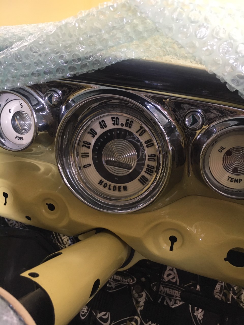

It has been awhile since I have spent some quality time on the old girl but have had a fair bit going on over the past few months, life always seems to get in the way of the important stuff like playing with your toys :-) Anyway just a few pics for a quick update.

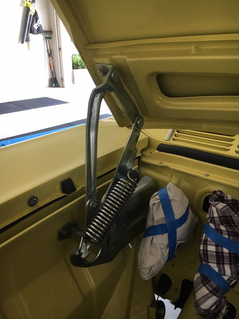

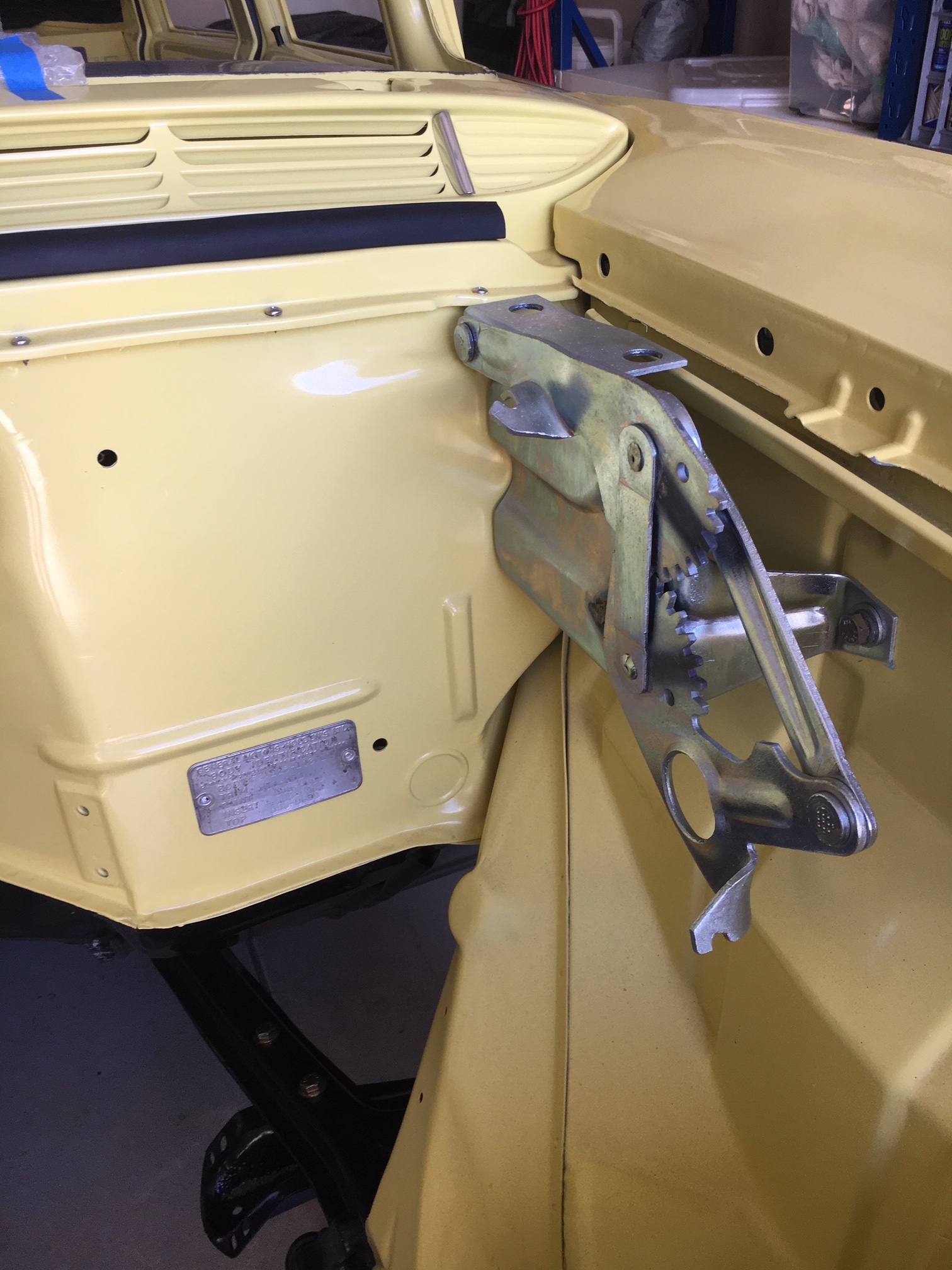

Anyway just another couple of quick pics for progress.

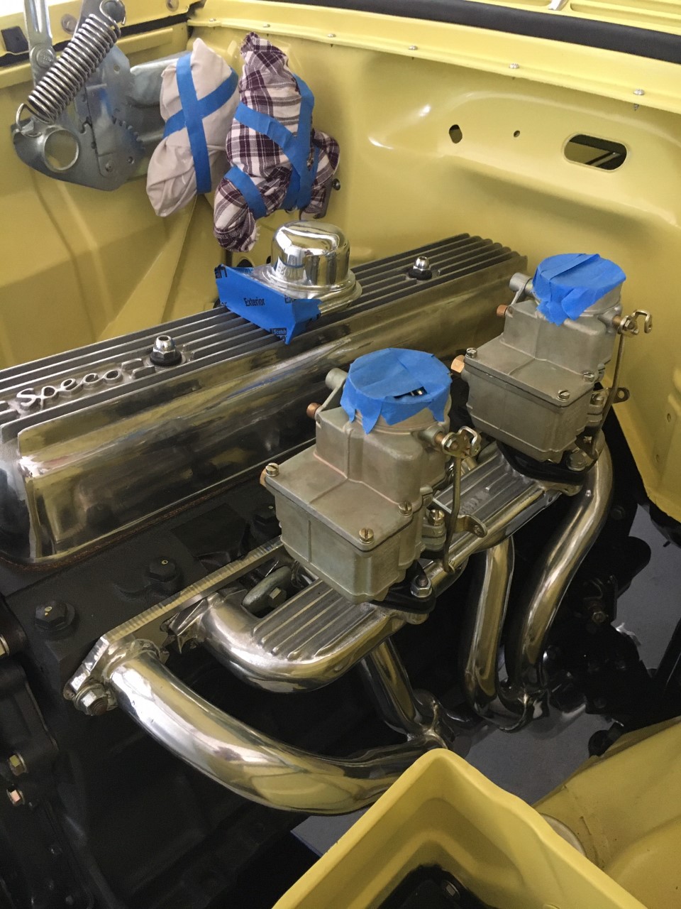

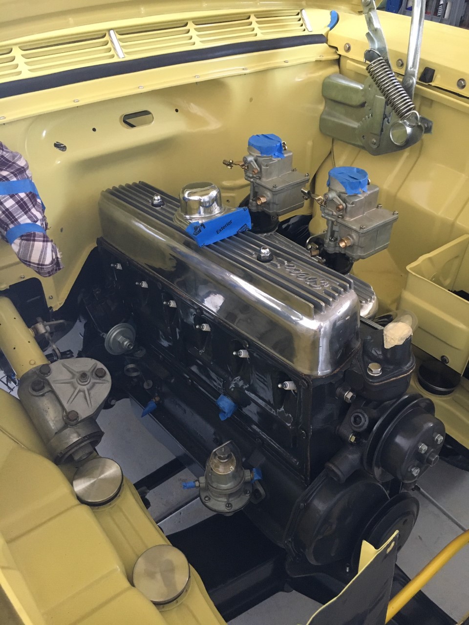

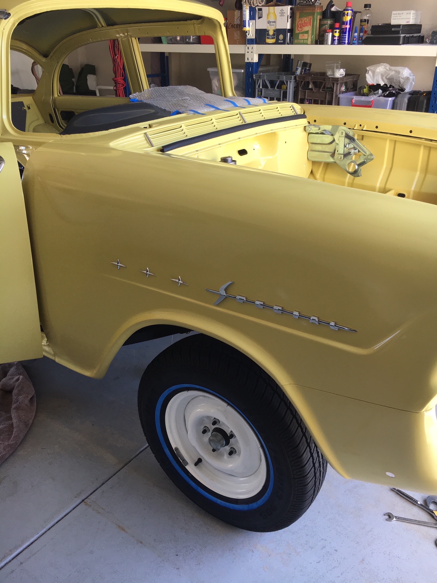

Engine & gearbox now in
All badging on the guards now complete
All outer door seals fitted

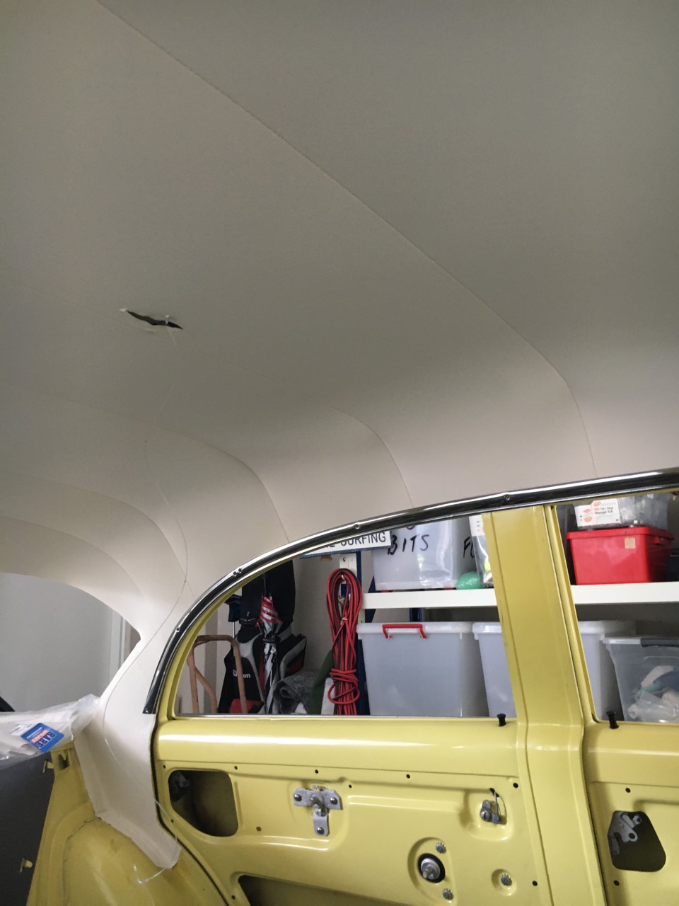

Hood lining in and looks smick
Front windscreen arrived the other day, so hopefully front and back in early next week

Did you polish the rocker cover - if so, you did a darned good job of it. Now, with all this time on our hands - those carbies would come up a treat if polished and set off to compliment the intake manifold..... bit of work, but they look darned good when done.... easy for me, I only had one to do..(sic).
I note we are using stainless bolts - well done. I might suggest using Loctite 76769 silver anti-seize paste on the threads... stainless and steel create issues over time with seizing... so too, does stainless in alloy. One tub of this product will see you out.. and probably your kids.. if not your grandkids... don't get it on you though, it takes a bit of effort (and time) to get out of your skin... seems to love getting into any cut flesh as well...
Keep going - great looking build... it's a bit like "elephant eating"... never sit down to eat it in one go.... but, bit by bit - and presto!... one day the elephant is gone... (no disrespect to elephants intended).

The rocker cover was in pretty reasonable nick when I bought it, so just needed a couple of final touch ups. I would love to do the carbies but I'm not sure I have it in me, there in really good condition now so I think I'll just leave them (for now :wink34: )
I had all the original nuts, bolts and washers re-plated, unfortunately there were a lot missing so I have used 316 stainless and high tensile zinc where ever applicable. I have definitely tried to use anti seize on just about everything, time consuming but I think worth the effort, if god forbid, I should ever have to pull anything apart :grin:. I didn't specifically use Loctite but hopefully the MolyTec stuff will do the trick.
