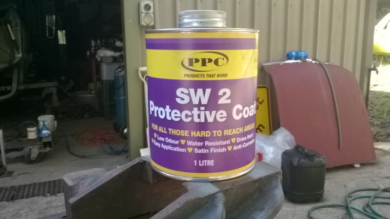

I prefer the artificial fish oil, it dries hard after a few days and really gets in any nook and cranny
Thanks Greg. You’re using this on your guards? I’m using rustoleum deodorised fish oil, the real thing but that is not for external use.

Hi Clay,
I'm putting this stuff in all the creases overlaps etc including the guard arch supports.
I'm not worried about the headlight peaks just because I'll keep an eye out for crud build up.
Just about to start my interior , headlining windows etc so will spray this stuff everywhere in the roof and down the pillars.

Hi Greg,
I might be able to save you some grief... please read.
To start with, I don't know the product you have... being PPG, I would hold it way above most others. If it is related to POR15 - I would probably consider it myself.. but would still go the POR15 on bare steel or slightly rusted surfaces.
My drama commenced in 1983, I painted over 20 litres of "3M body sealer and deadener" into my old bus..... worst mistake I ever made apart from modifying it...
It took me over 20 years to get the wretched stuff off again.. and the damage that was done needed a huge amount of "fixing".
Any such "hard" and "waterproof" sealant is dangerous stuff to metal.... it "traps" moisture underneath it and that's where the rust will start.... creeping away until it shows up eventually as bubbles.... by the time you see these emerge - it's too late...
The "satin" nature of the finish conceals those bubbles/blisters very well, until your eyes finally twig on what's going on...
The stuff might be ok if you prepare the steel properly, neutralise any known rust, prime it and then seal it with an many coats of enamel paint...
But, if this type of sealant is applied to anything but a well prepared and sealed out surface - rust will eventually come.... and it will come in a big way. Moisture trapped under a sealed surface is far worse than simply leaving it bare and wearing whatever surface rust develops... sealing over rust is a killer....
I have used fishoilene, primer and epoxy enamel on my floor - the best part of 20 years now has the floor as sound as the day I laid the carpet back over it.... I have used POR15 on the underside and in the boot on bare steel and it has also remained perfect - the big advantage of POR15 is that it can be painted over rust (hence POR)... although I did sand as much of it back - and also had to "metal ready" the shiny steel (the product needs a little bit of rust-like surface to work at its best).
I am keen to learn what this product you show is.... I will chase up the data sheet and see what I can glean from it.
I am extremely hesitant to take any notice of a product which states it "seals out" moisture.... if it can seal "out"... it can seal "in"....

Ok, just chased up the product.... it's nothing like POR15... in fact, not from the same company... this company is "PPC" not "PPG".
It would appear that this SW-2 product is similar to fishoil.... works by capilliary action for the most.
As Greg states, it would be excellent for areas which are inaccessible.. however, if any intention to top-coat surrounding areas is planned - it will more than likely react as fishoil does.
It further states that it can be removed using thinners... which is a good thing for repair work.
I am a little perplexed that it dries "hard"... my limited understanding and experience with anything containing or related to fishoil had never resulted in a "hard" finish..
This is what I extracted from the specs...
SW 2 Protective Oil is similar to Fish Oils, but without that fishy smell and will penetrate into difficult to access areas. Where applying paints like POR 15 Rust Preventive Paint or similar is hard or impossible, SW2 is the way to go. Ideal for the interior of vehicle doors, body panels, hollow sections of chassis, trapped recesses, etc. SW 2 Protective Oil forms a water resistant, penetrating thin film which dries to a satin finish, and will help prevent condensation, corrosion in these areas. SW 2 Protective Oil can also be used as a long term protective film on stored machinery, parts, castings and the like.
Ok - and it can be top coated.. in another data sheet...
Can be painted over the top which makes it ideal to use between sandblasting and painting if there is going to be a time lag.
I don't know this product, but an keen to follow your use of it....
thanks for posting.
