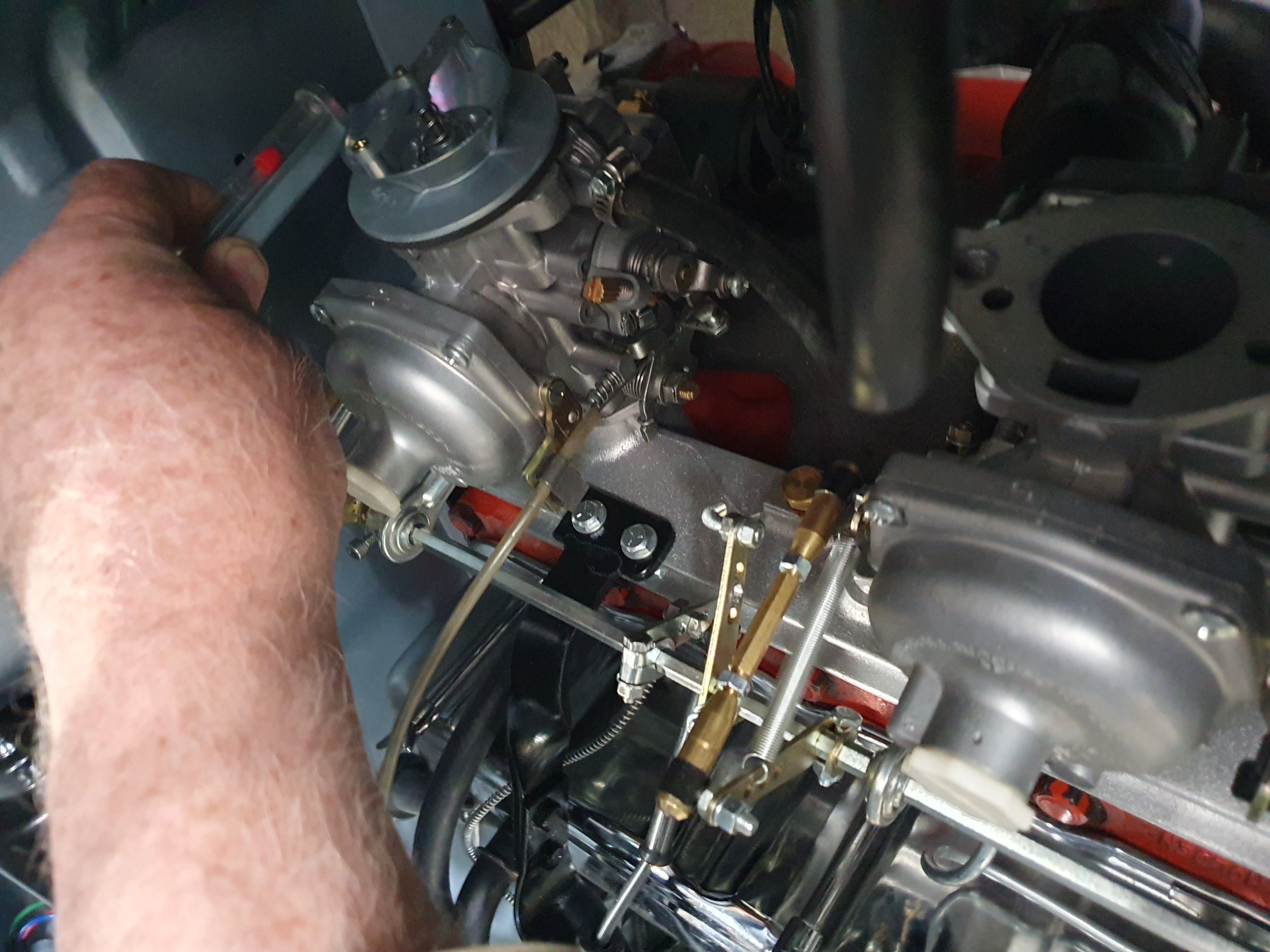

Re: Project 2.
Posted: Fri Jul 28, 2023 10:56 am
by Brett027
This one for Clay who is fond of 'jugs'😆

Tuning completed. Blue mixture and 1/3 up the tube for each. Easy peasy. Running sweeter than when on WW.

Re: Project 2.
Posted: Fri Jul 28, 2023 1:01 pm
Thanks Brett. Kept me entertained for 20 minutes looking at that. I’m using a similar throttle cable set up by the looks. I see the Holden manifold is water heated and you are only choking the rear carb, which should still give you idle up on all three due to rigid linkage. Tidy setup with the springs. I don’t like the way mine hang down under the carbs, sorry jugs, so may revisit this. I take it your throttle cable and lever aren’t fully set up in the photo, and you have the individual levers pulling the throttles. I’ve seen some set up to push but not sure about it. They turn the levers 180 degrees on the individual throttle shafts. Engine bay looks mint mate. Bit more exciting than the old WW.

Belly760 wrote: Fri Jul 28, 2023 12:54 pm I’m intrigued. Got no idea what your doing there. Image
Same here. What is the 'jigger' you are using with the float tube thing??
