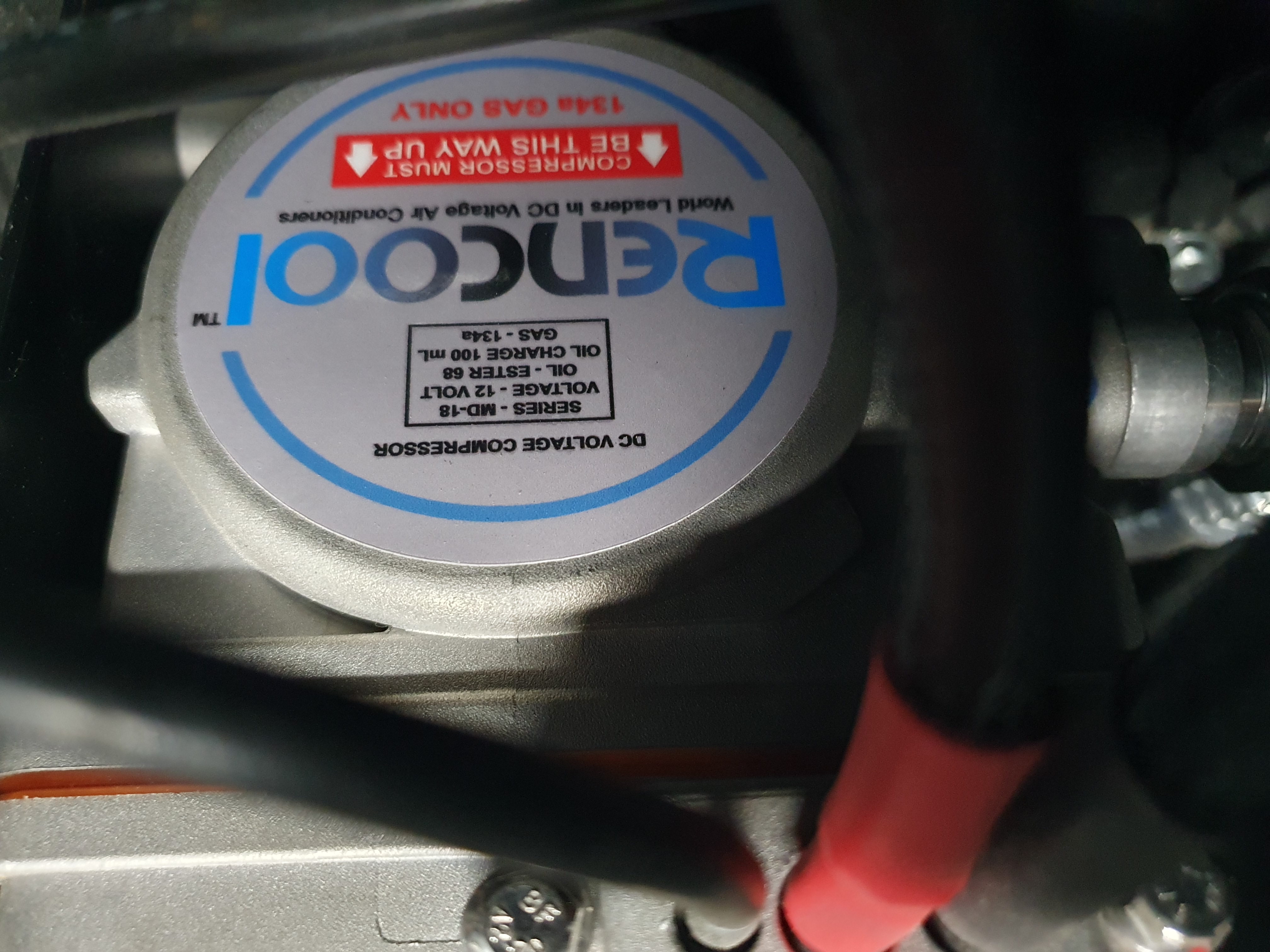

[image][/image]
Thanks Scott.funkyscooter wrote: Fri Feb 24, 2023 7:24 am What an achievement - well done Brett. You made it look easy!
Re: Project 2.
Hey Brett and Briby can you tell me what type and model you electric compressors are please so I can have a good idea of choice, I’ve been told by Jeff at Madd that some of them are unreliable.
Appreciate your thoughts
Re: Project 2.
Cheap ones are trouble. Rencool is the best and Aus made too. Buy direct from them if you go that way. Mine's a model '18'. There is a bigger one that might be better for sedan- I don't know.

Mine seems ok @ medium speed ~4000rpm, not sure everything could handle higher Amps.

I just had a look at their website to get an idea of pricing and they state these units are no longer available for individual sale , they must be bought as part of a package ????
Re: Project 2.
HHMMM , so the MD24 is only available in 24VDC ???
