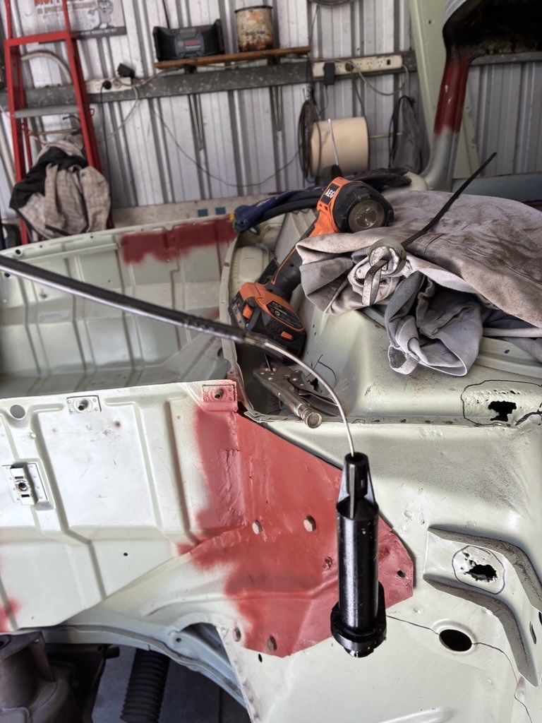

Gearbox drama update :roll: :roll:
I think I said before that when we changed the gearbox we almost dropped it off the jack a couple of times, one time the TV cable got caught and the outer got pulled out of the bottom mount :roll:
Well I had another cable and after driving it the Ute a couple of times before changing the cable it seemed that the box wanted to change properly but I just couldn't get the gear change setting right.
I'm "working from home today" :thumbsup: :lol: so decided "what did I have to loose" I will change the cable and see what happens.
Now I have to tell you there ain't a lot of room for a TH700 even in the bigger tunnel so I had to be a bit of a contortionist but got the old cable out and new (second hand) cable in, topped the box up, gave it a drive and looks like the gearbox is ok, changed gears really well :clap: :clap: :clap: put Frank back in the shed and put him to bed :lol: :lol:
While I was playing with the good cable out of the car I realised that the adjustment actually pulls on the outer so with the damaged one in the car there was just no way it would adjust correctly.
Anyway it appears at the moment to be a good outcome, damaged cable below.
Image (1).jpg (246.26 KiB) Viewed 3795 times

by EK283
Great stuff Neil,
Saved some work and some dollars.
