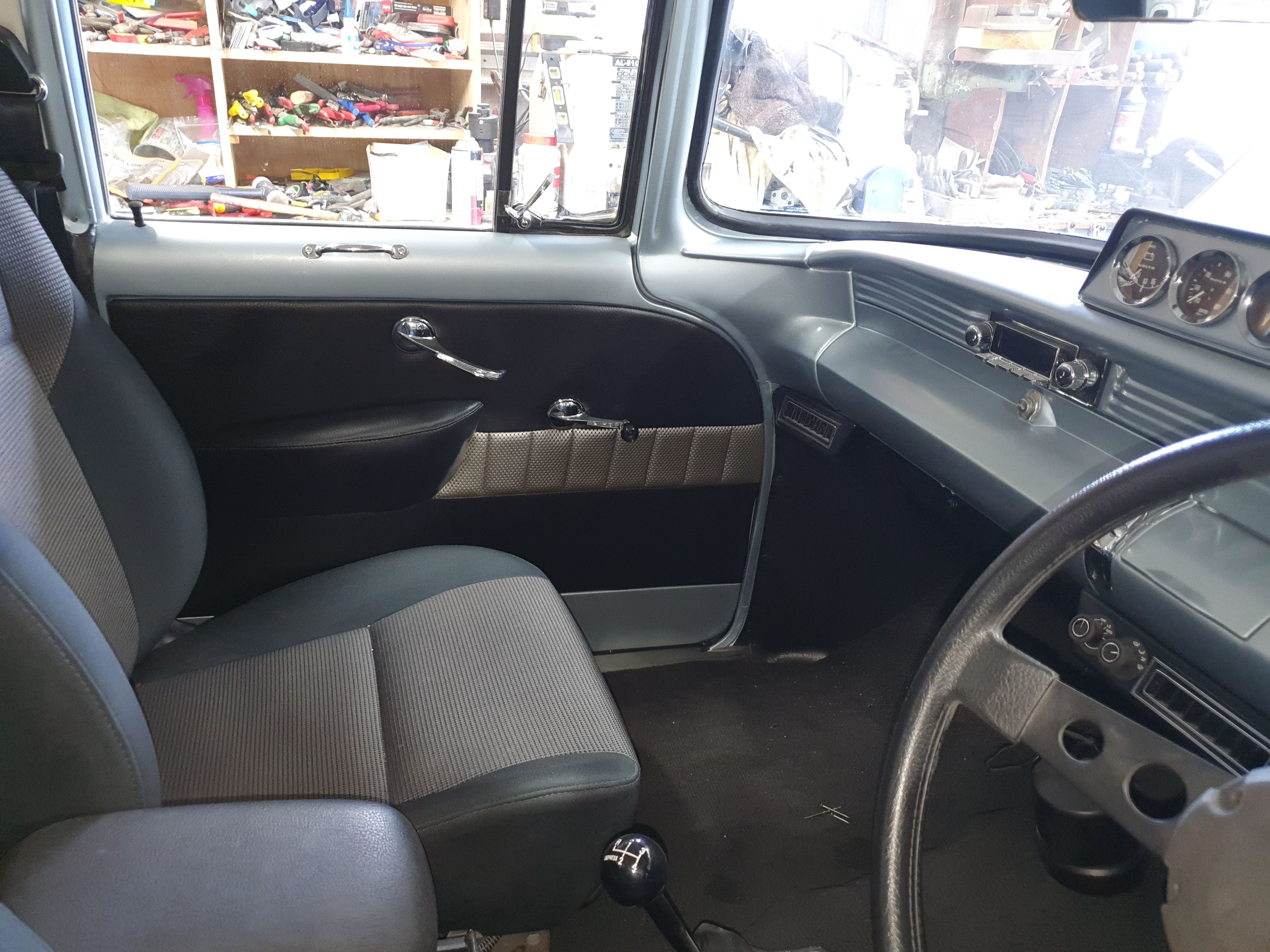

Re: Project 2.

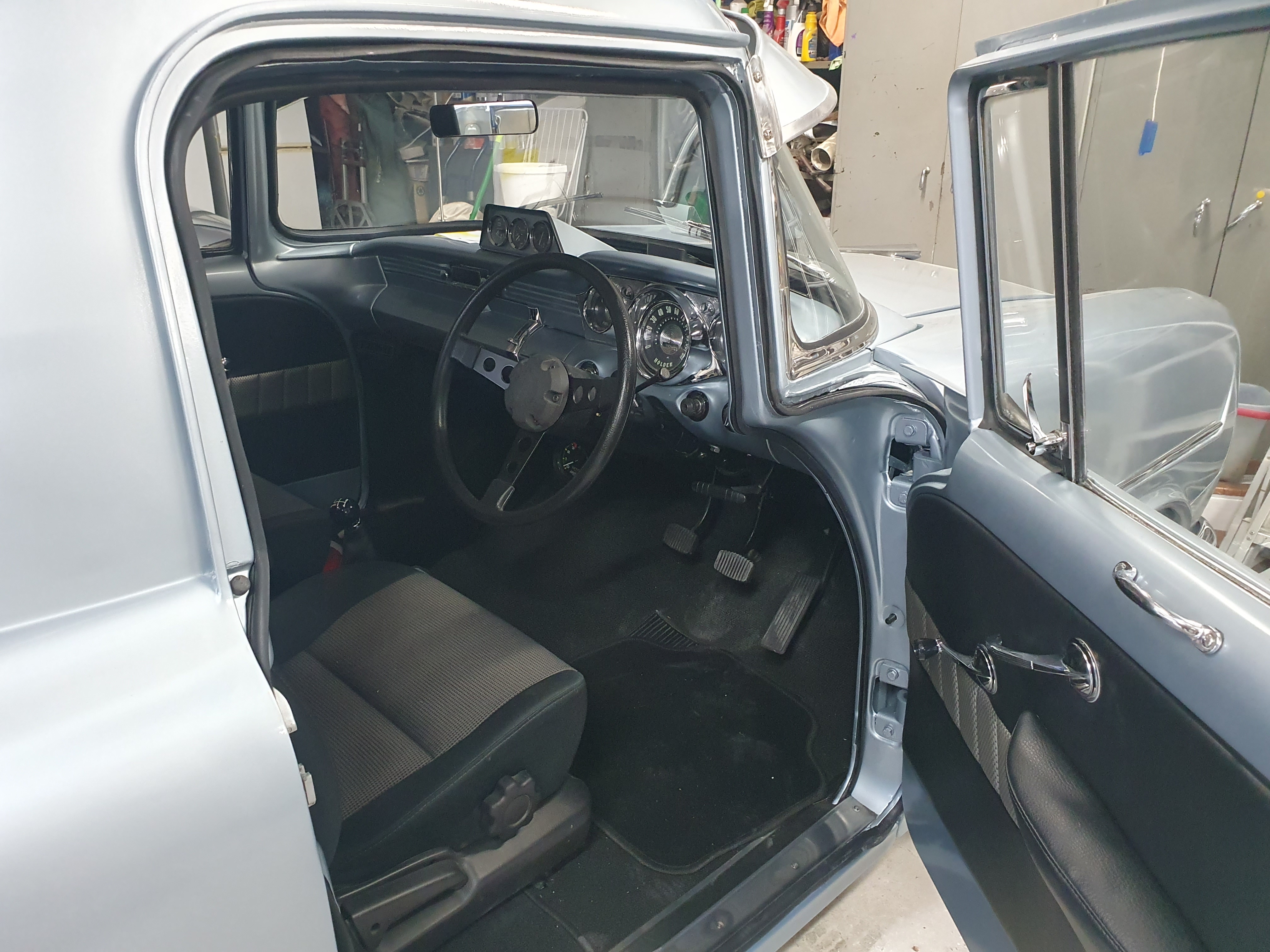

Nice one Brett - love the subtle inserts in the door cards matching the seat trim. Are the seats Subaru still? They look in good condition.
Scott
Re: Project 2.
Interior looks great Brett, seats look really comfy, and appreciate the air con install blurb I'm planning to aircon Frank I think.

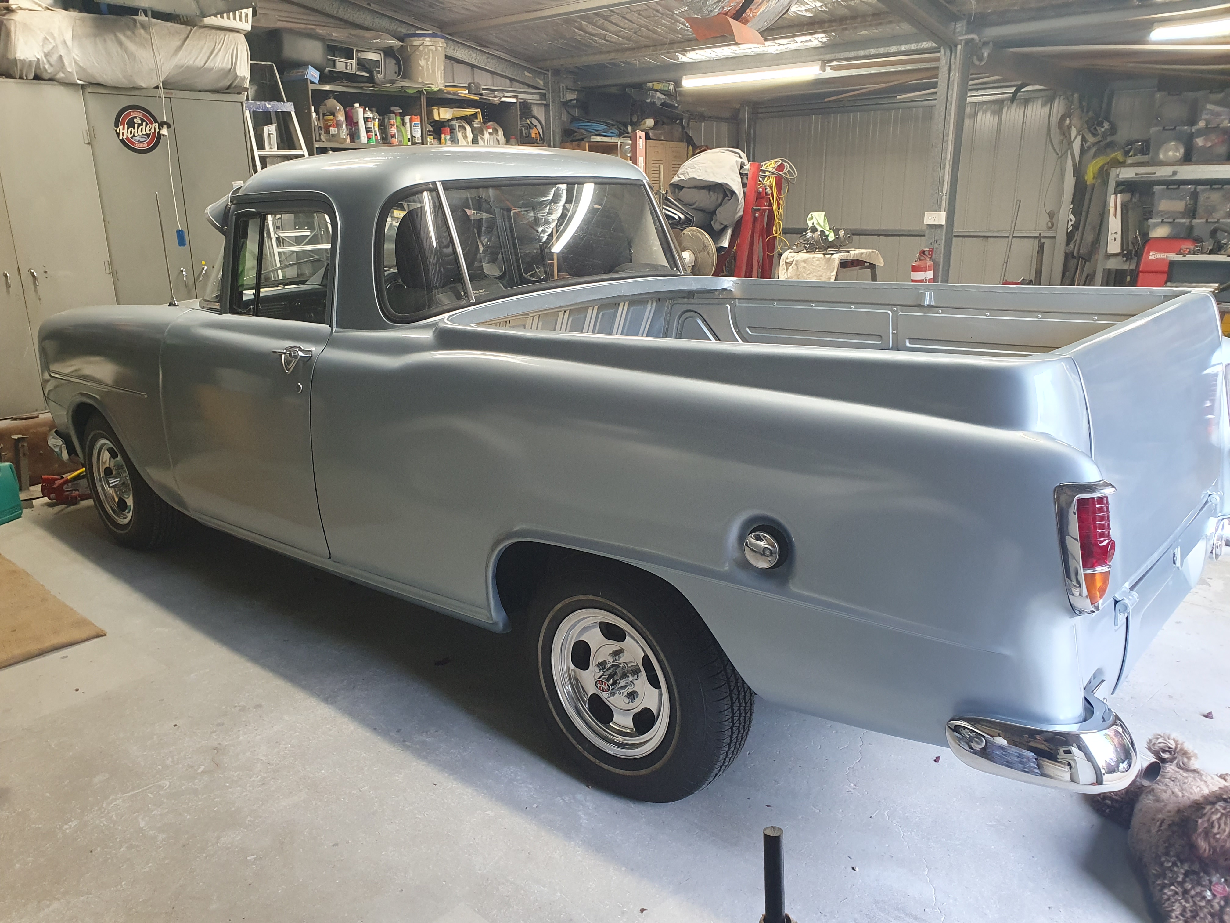

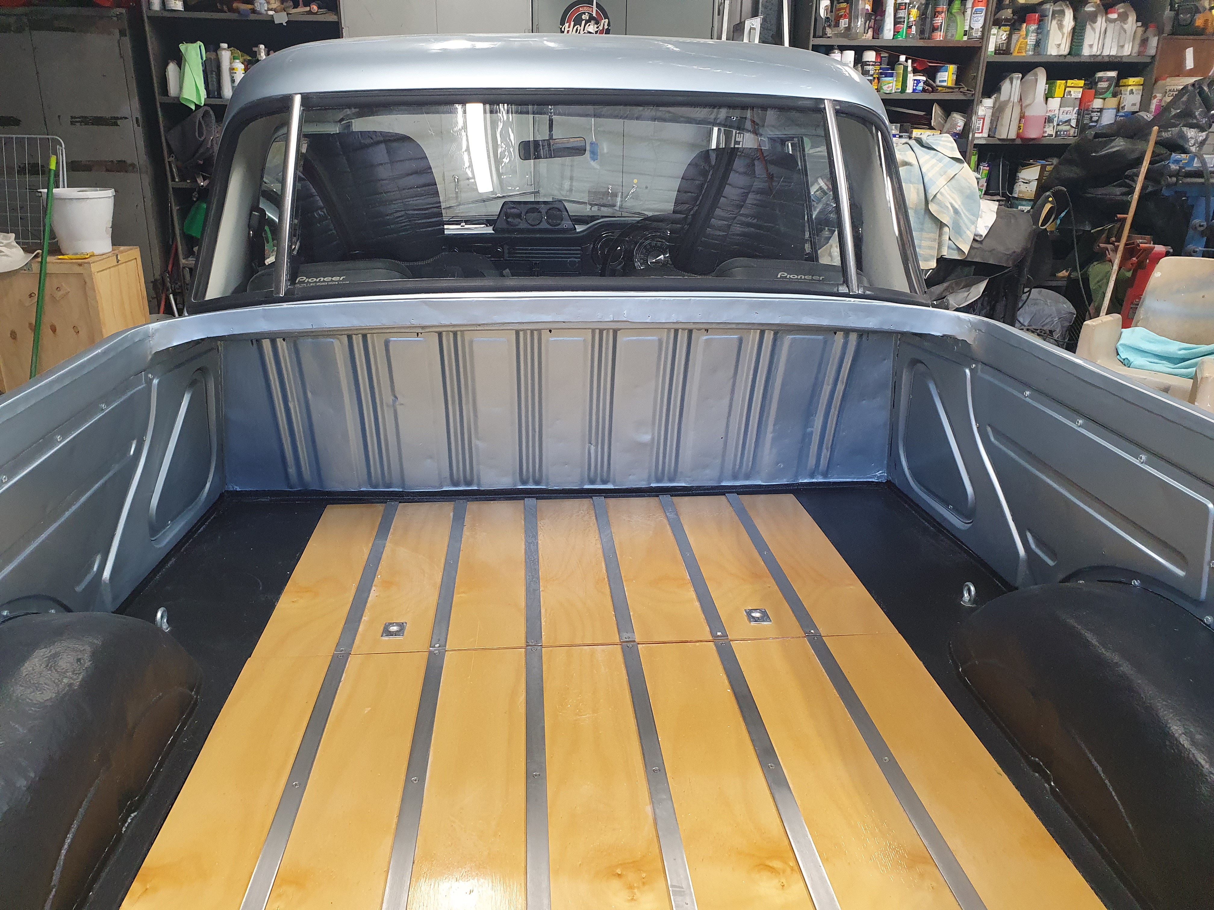

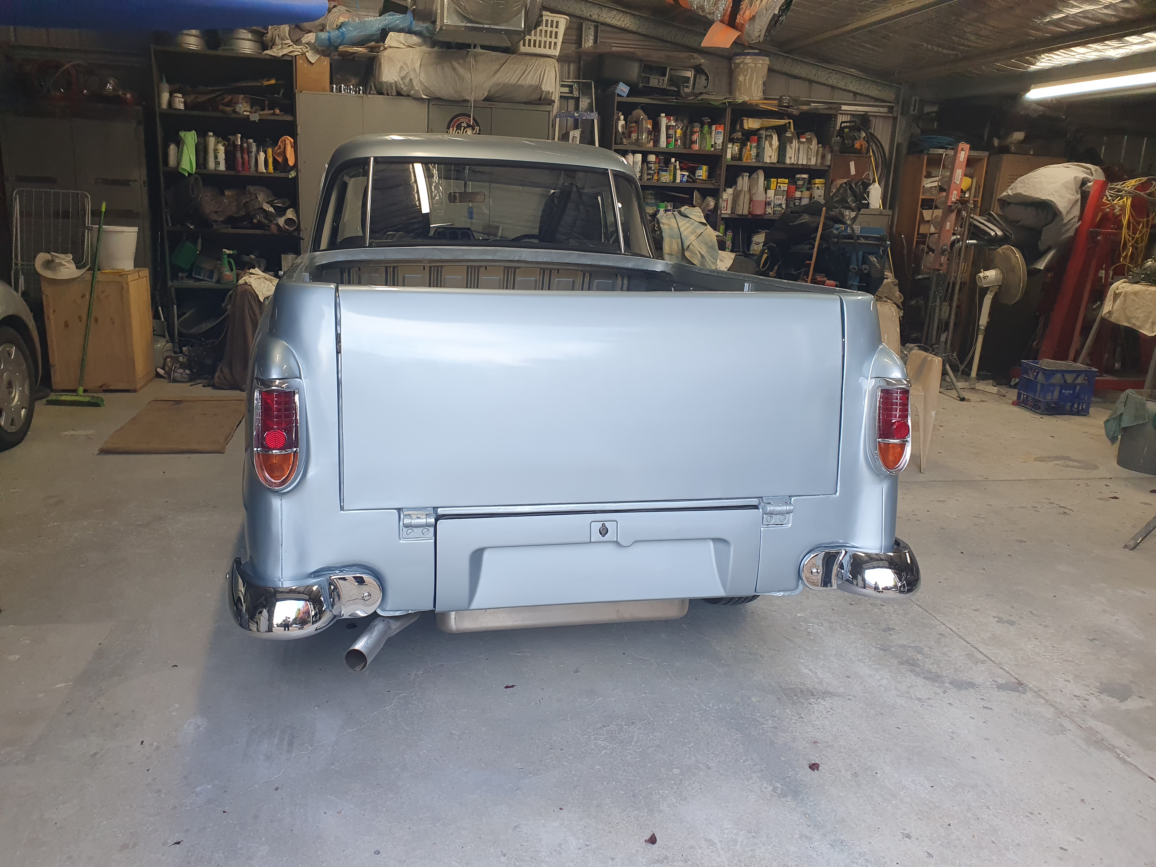

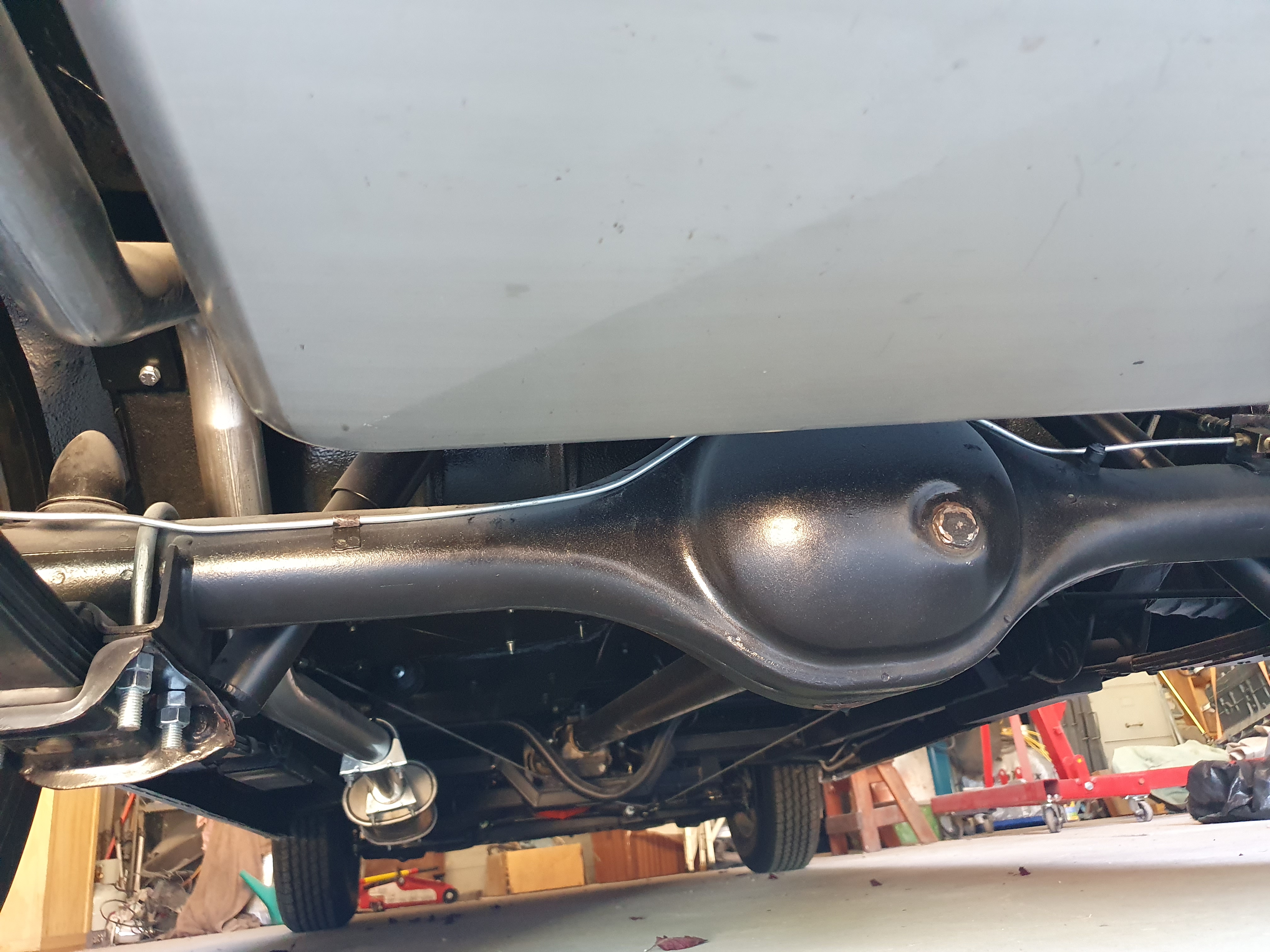

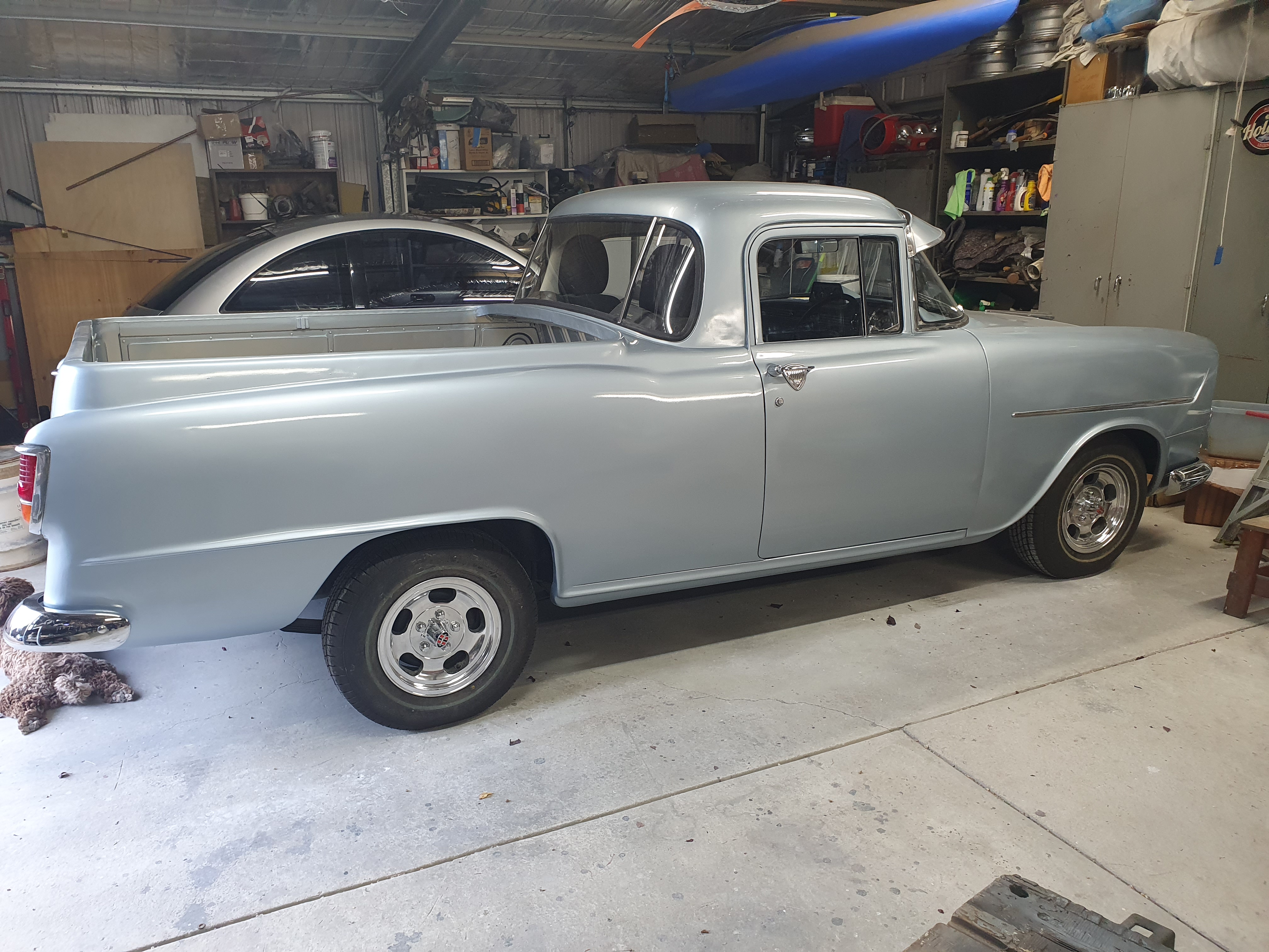

Project 2 is ready for engineering check next week. Lots of rough panel work to finish off in the coming years and also a bit of buffing to do before Echuca. Should be a reliable and playful ride.
- 20230215_191522.jpg (3.5 MiB) Viewed 783 times
- 20230215_191303.jpg (3.12 MiB) Viewed 783 times
- 20230215_191317.jpg (2.72 MiB) Viewed 783 times
- 20230215_191358.jpg (3.2 MiB) Viewed 783 times
- 20230215_191538.jpg (2.54 MiB) Viewed 783 times
Re: Project 2.
Beautifully done.
That colour really suits it - modern enough to be noticeable, but subtle enough to be similar to an original colour.
Good luck with the engineer.
