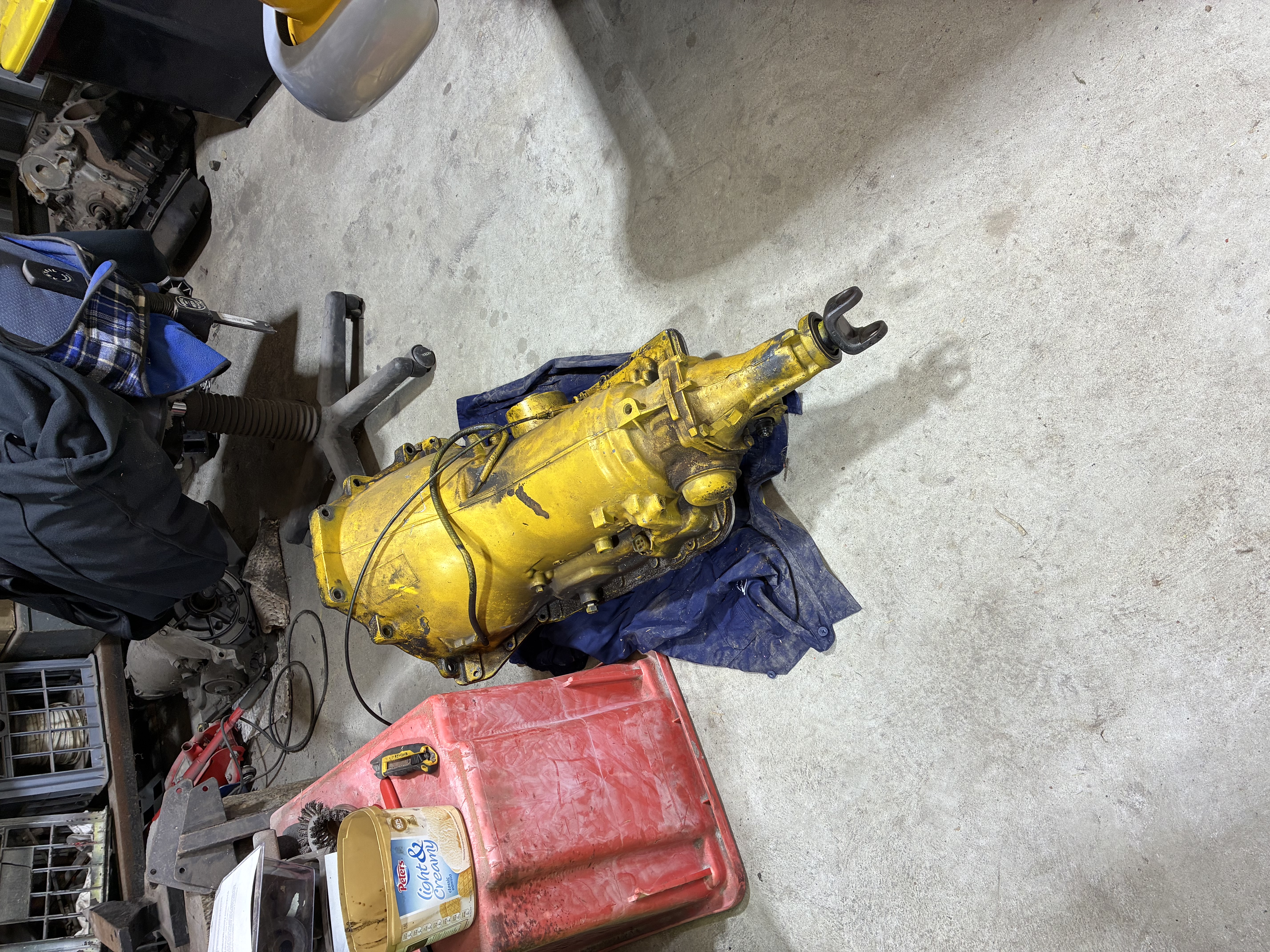

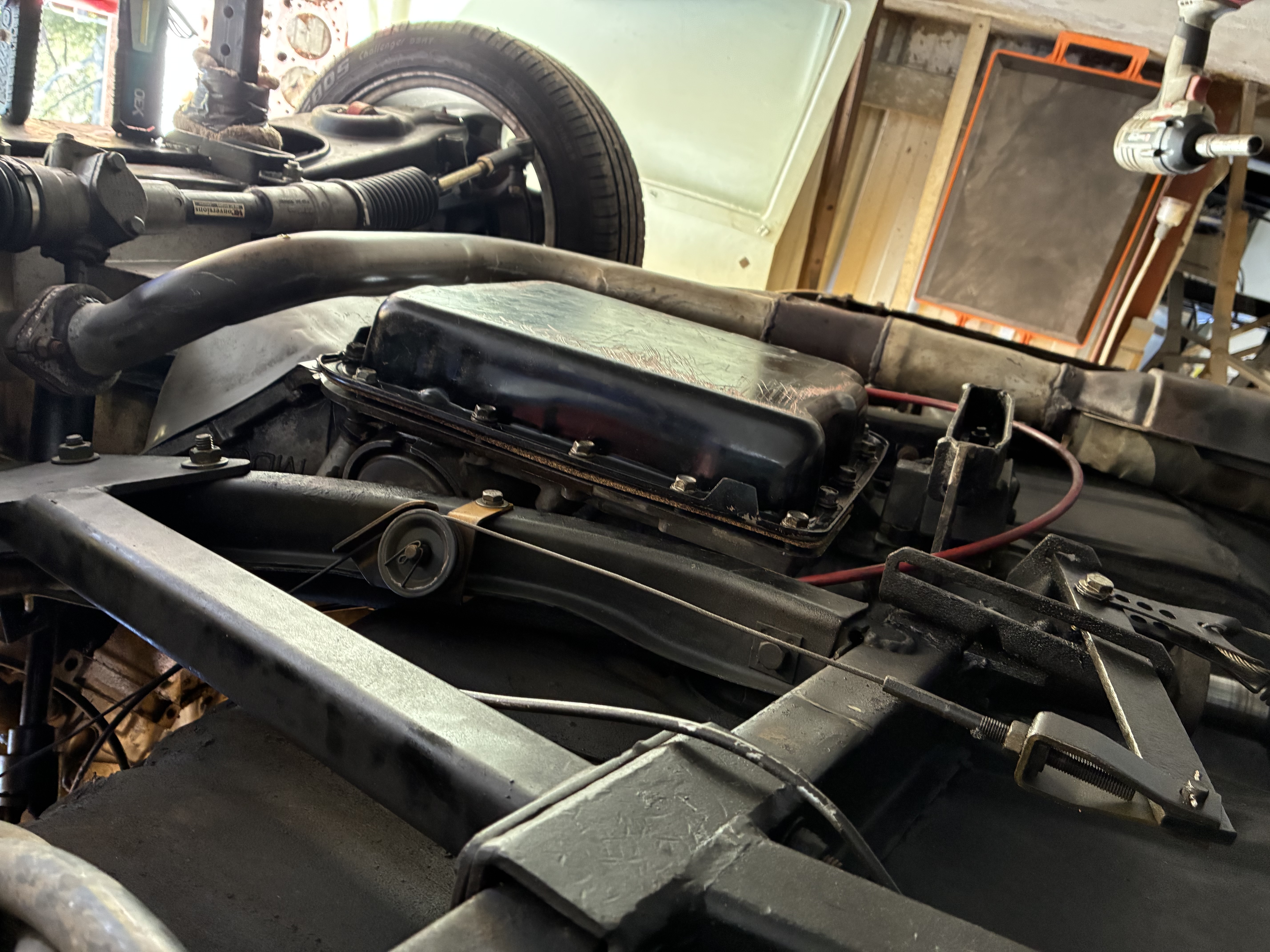

So I bit the bullet took Thursday and Friday off and got into changing the gearbox.
My old mate Keith came down Friday morning and we got the fragged box out.
It was a bit of a comedy show with two old farts trying to get the secondhand box in, we only had the floor jack and I could only get the Ute high enough off the ground to manoeuvre the box out.
We almost dropped the box of the jack 3 times and those boxes are pretty heavy with the torque converter on the front.
4th attempt and we got it in, Keith is 82 and without him there is no way I could have done it.
Finished off everything Saturday morning, by lunchtime I had it on the ground, went for a test drive and BINGO it’s back to running and driving, shifts seem a little soft but it went really well.
My biggest concern was the torque converter but it appears to have survived :roll: :roll:
