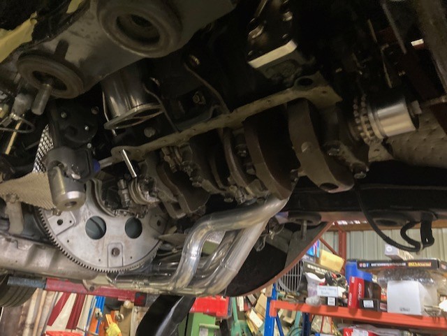

GRRR stuffing around !! Took me 2 days to do the timing chain with plenty of spanners growing wings !!
I had to make up a puller and installer for the crank gear then off and on 3 times to finally get the sprockets parrallel. Spent hours looking for a box of shims i had some where, when i finally did find them none the right size. The torrington bearing is 30 though thicker isnt it, that pushed the cam sprocket forward so the crank has to be the same.
Anyway, waiting now for a oil pick up and most of the suspension is done, just got to put it all back together.
See what tomorrow brings.
under car no sump 2.jpg (79.84 KiB) Viewed 2419 times
An old brake piston was just the right size and length to get the crank sprocket on, bewdy !!

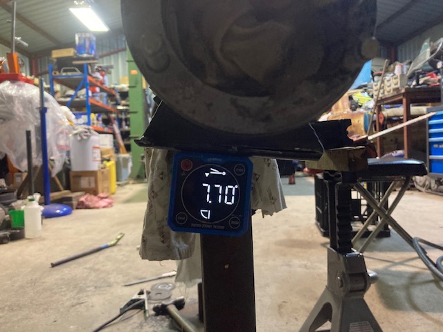

So in my last post I mentioned that the car has developed the dreaded driveline vibration. Although not bad, enough to warrant some investigation.
Underneath I discovered that the pinion angle was a whopping 6 degrees out from the gearbox !! I didn't feel a thing when i had the 2.73 gears in but the 3.55 ratio has sped the tailshaft up to about 2000 rpm and thats been enough to give me the helicopter drone.
Now you would think I would have checked but no i did not, left it to the diff builder and his measurements were fine but not for an EK.
Why did this change ? When i initially started i had flipped eye springs but the engineer said to low so i went back to the normal eye on top.
Because i rushed the finish for the car 3 years ago I never got around to measuring the angle and i had no issue with the tall diff ! (very surprising with the final measurements).
Ok no choice so out it come !
Now the springs i have in the car are standard height but not reset, it rides great but the springs are nearly flat. This flatness brings the spring perch area to 7.7 degrees, my diff was set up for 0 degreees, being normal height for most cars and the diff was pointing down 3.7 degrees. The math is normal spring perch of 0 degrees would have had the pinion at 4 degrees up, close to the transmission and tailshaft degree, tops but not with my situation, being sagged lowered springs (Which i like).
I can't believe how dirty the underneath is, but i built it to drive and drive i have been, pouring rain for nearly 2 weeks over the nationals period and 2000kms through all sorts of roads up north.
Anyway More math and my solution is to chop out a 15mm high wedge from the saddles, and tilt the diff back to get the correct 4 degree rise in the pinion, basically 6 degrees movement.

Will the caltracs be affected? I suppose you have done length adjustment in the rods if needed. I hope it ends up vibration free mate.
Even with the 3.08 centre in our sedan I get the vibes at 100kmh when going down hill with throttle closed. I did measure angles at some time but whether I recorded it? I plan to tilt pinion up a bit in any case to see if it improves.
Posts: 14275
Re: Chev EK
I bought some wedges to help diff vibrations in the Chev, they are available in 1/2 degree increments and not too expensive, might be an easy way to check yours out Clay ???
Posts: 11669
Re: Chev EK
Yes. I used them in the ute. Three degrees from memory. Tacked to diff saddles. I think I will just profile my lowering blocks, after I’ve checked the angles that is.
