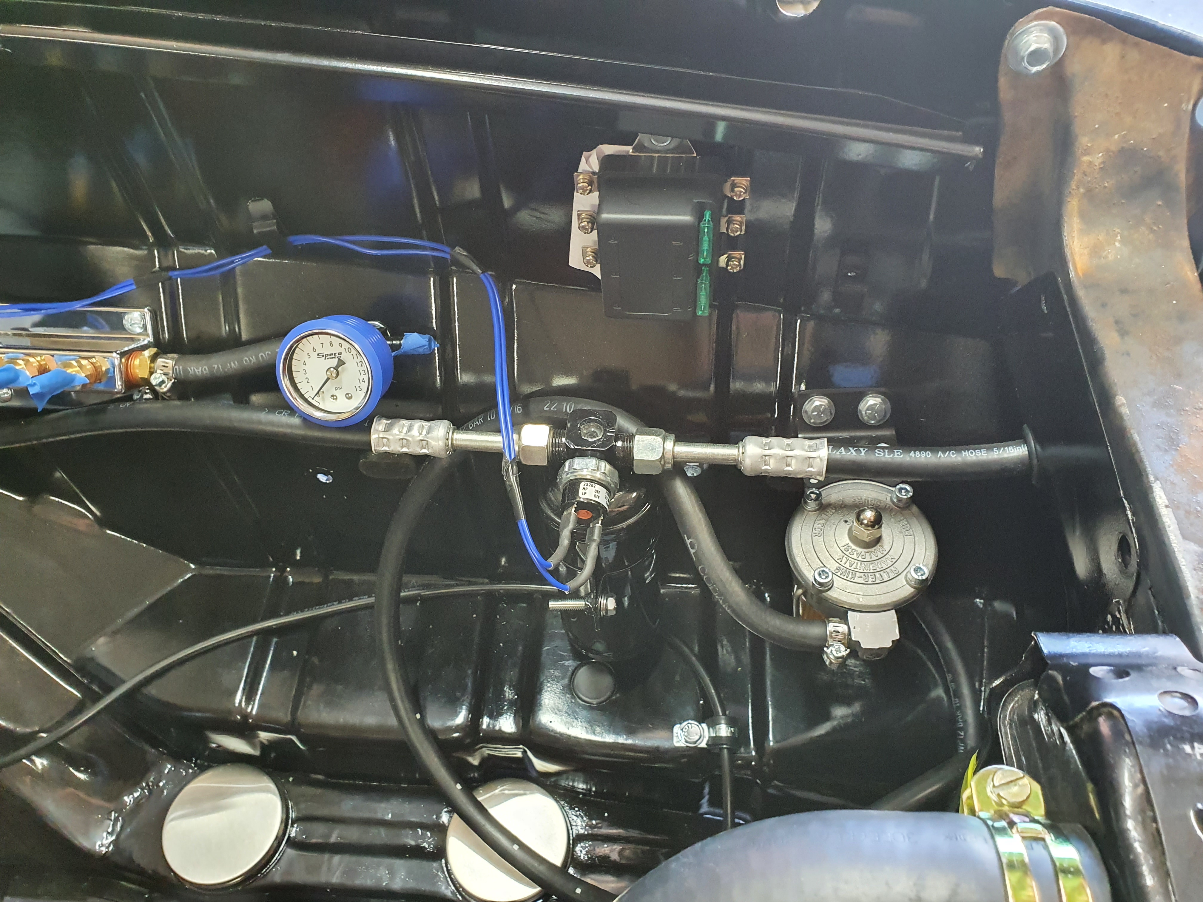

"Not sure if you and Rob have noticed but I'm not running a standard fuel line
- Guilty as charged. Didn't notice, but was wondering if . . .

Yer ok your car. Sorry don't like it but it's different.Brett027 wrote:No it won't. Will work just the same and currently inlet and outlet align to where I'm running my pipes. Not sure if you and Rob have noticed but I'm not running a standard fuel ine
Re: Project 2.
Clay you are acting like a wanker. Well duh it's got tripples, a fuel pressure regulator, a three way splitter and a cute little guage to go on.

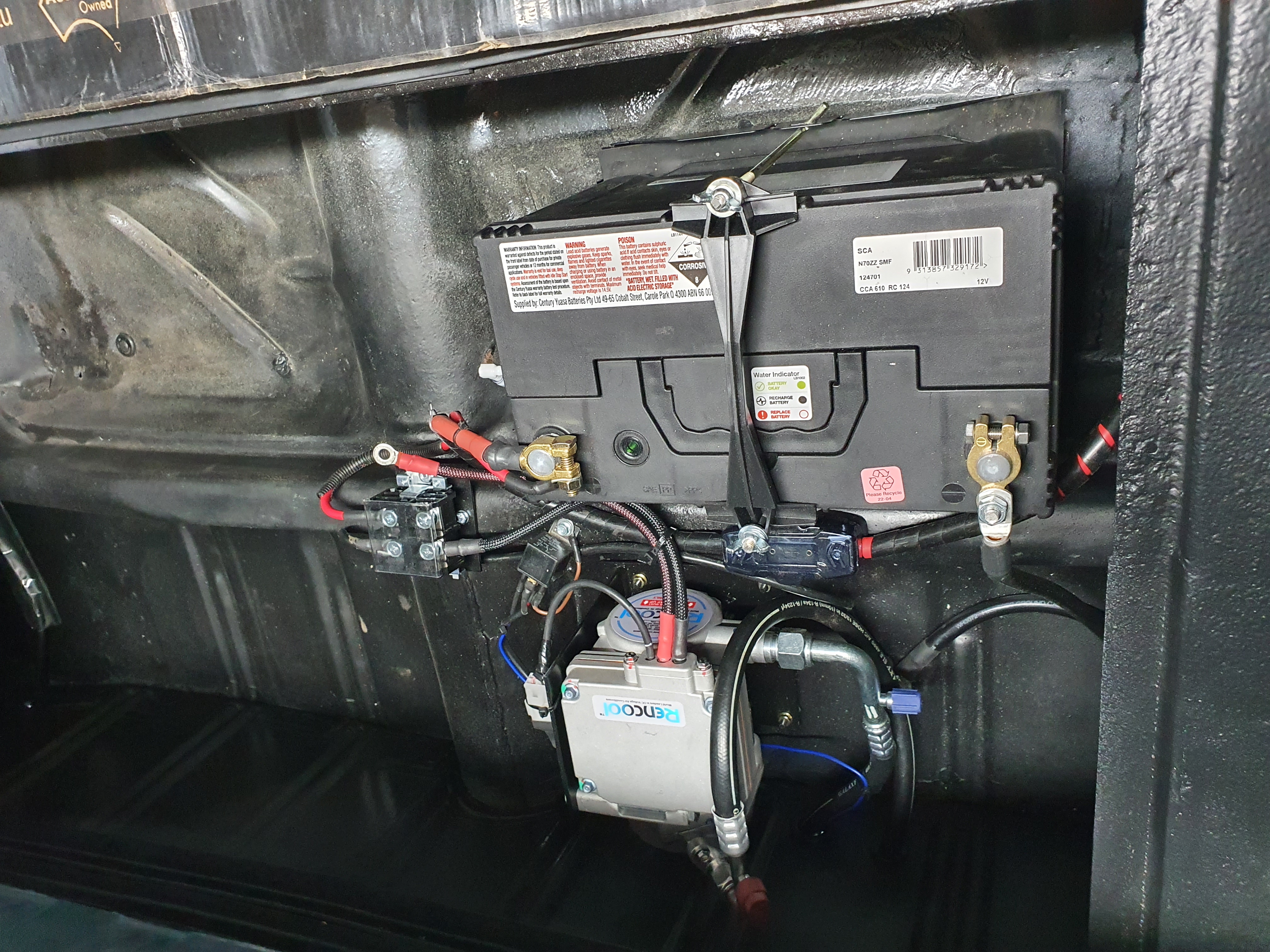

Re: Project 2.

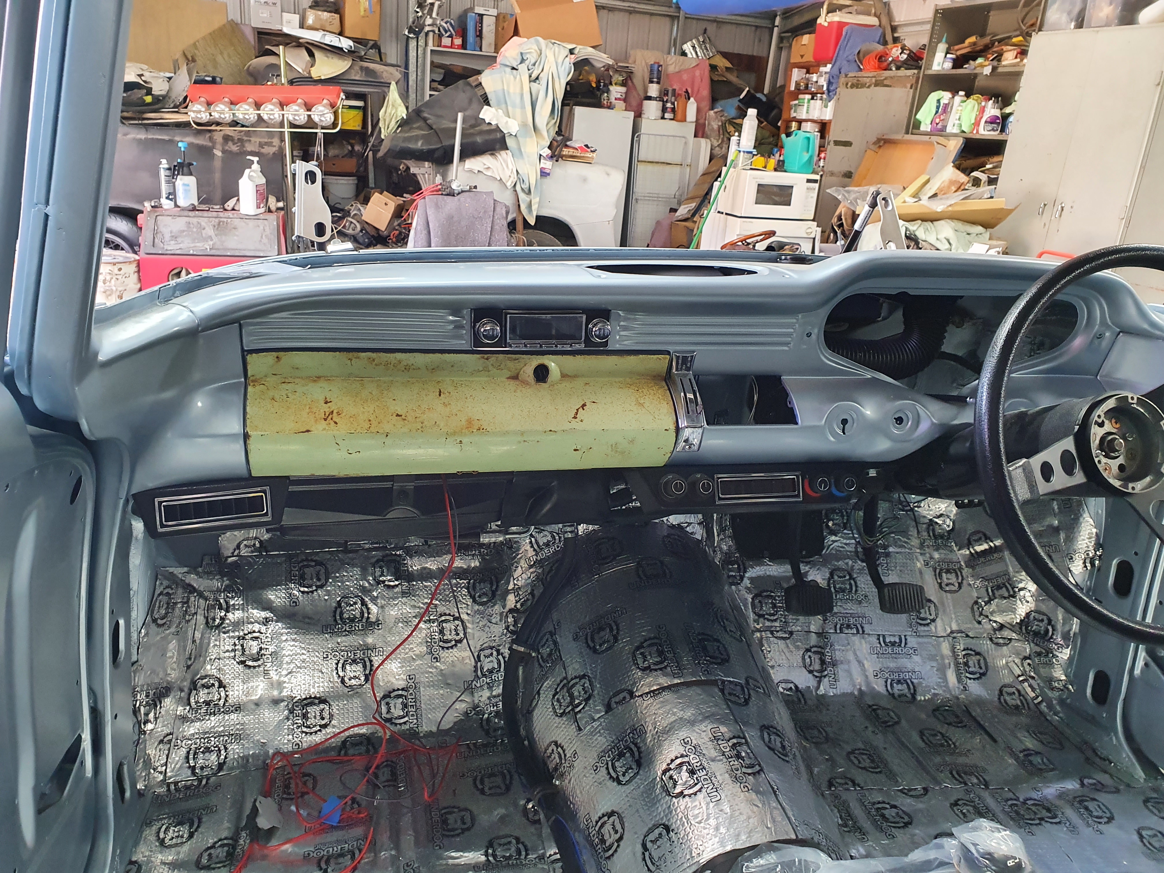

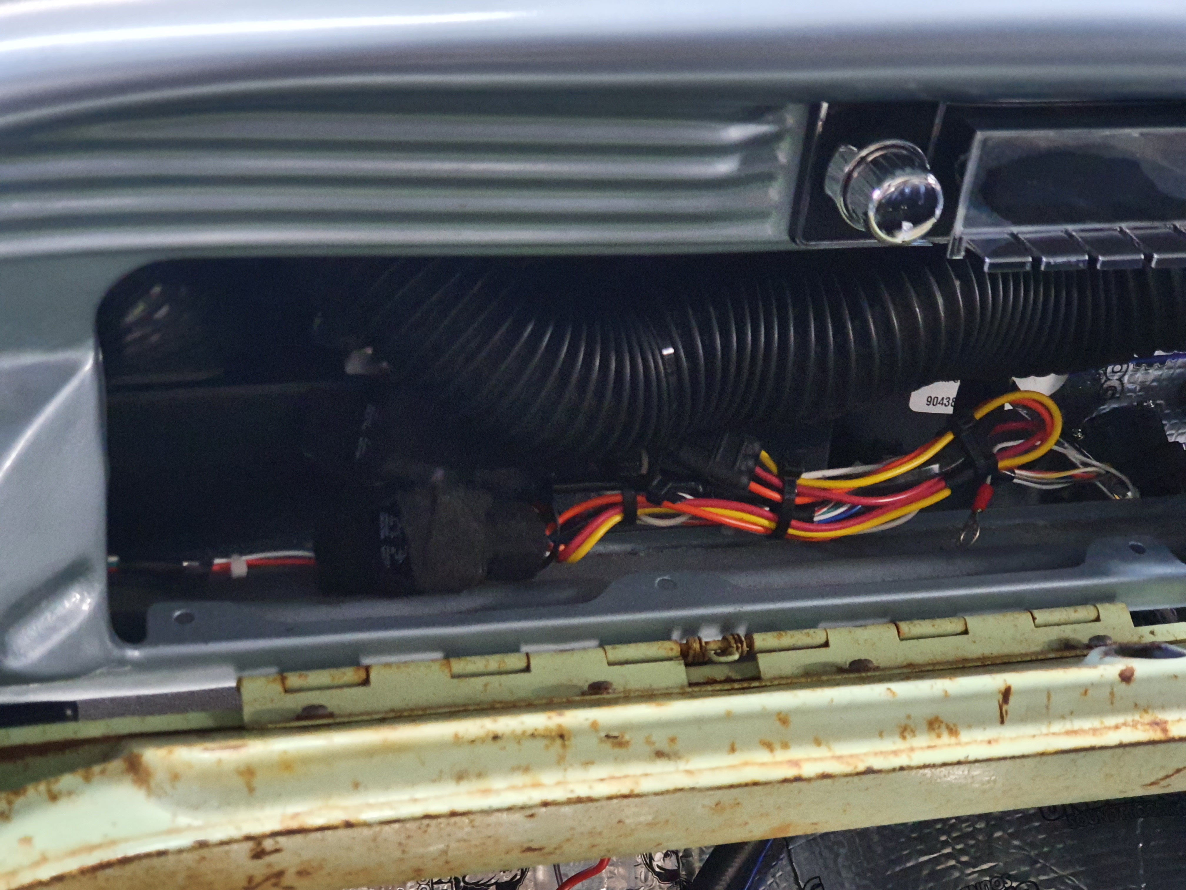

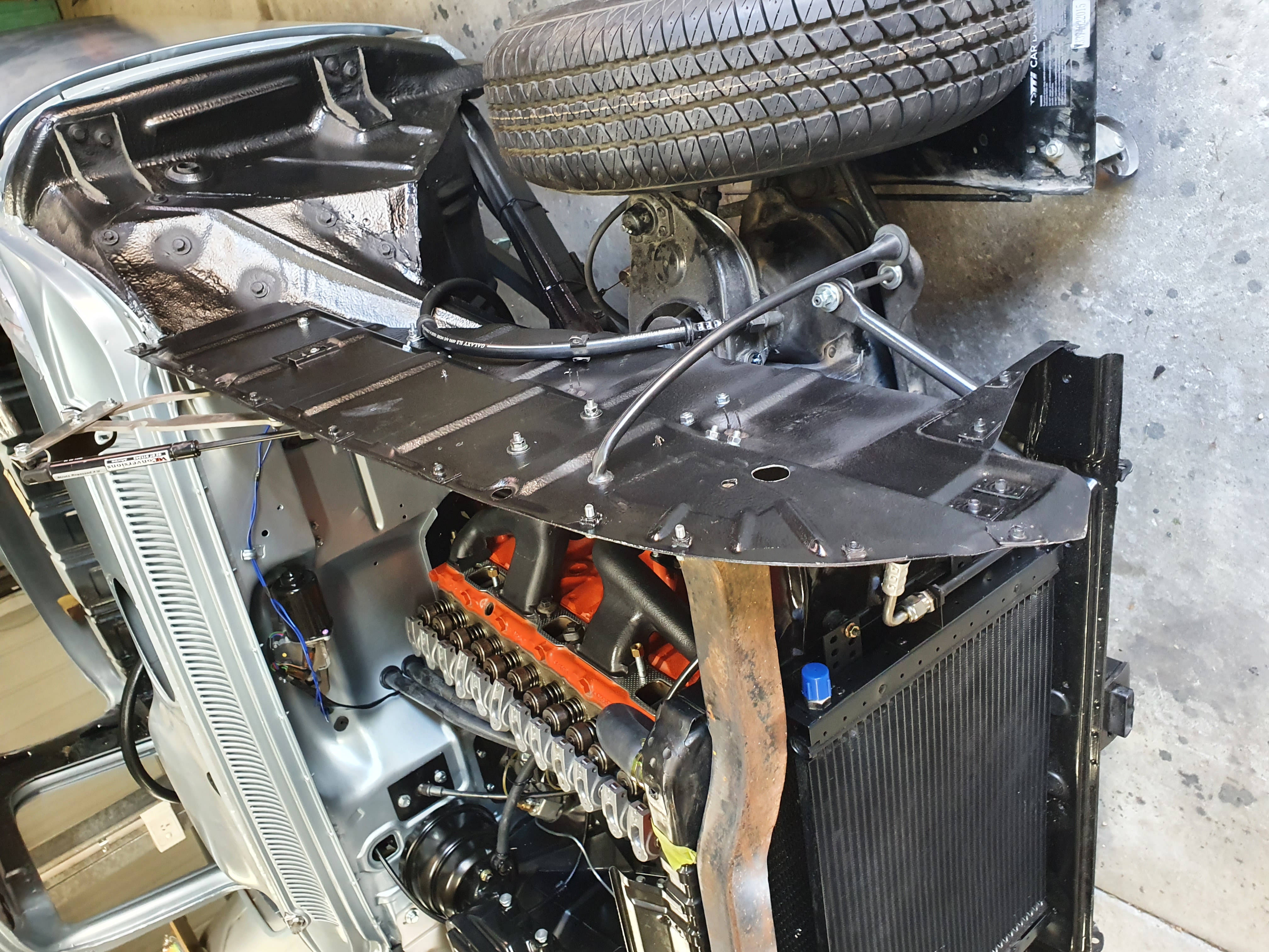

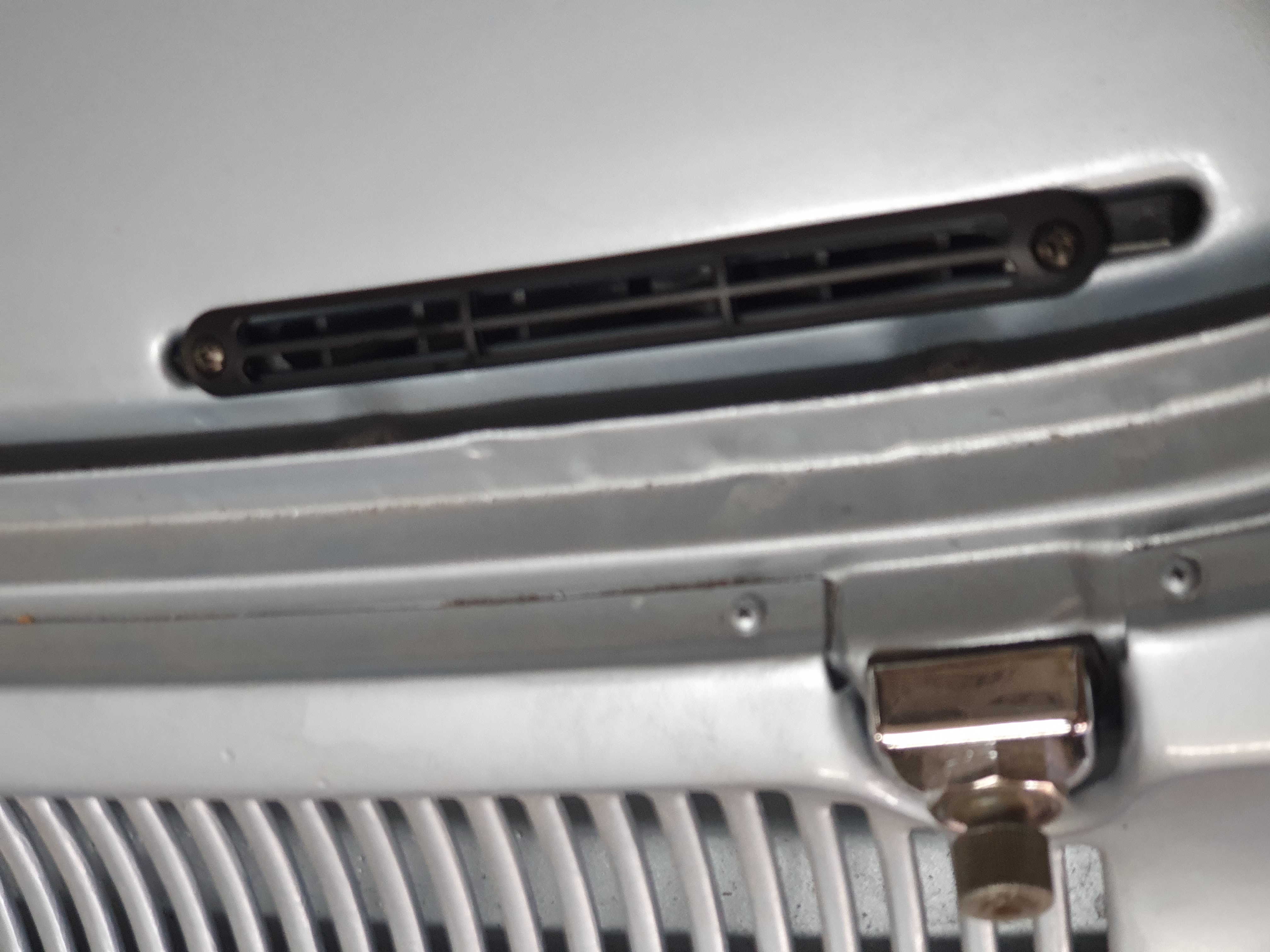

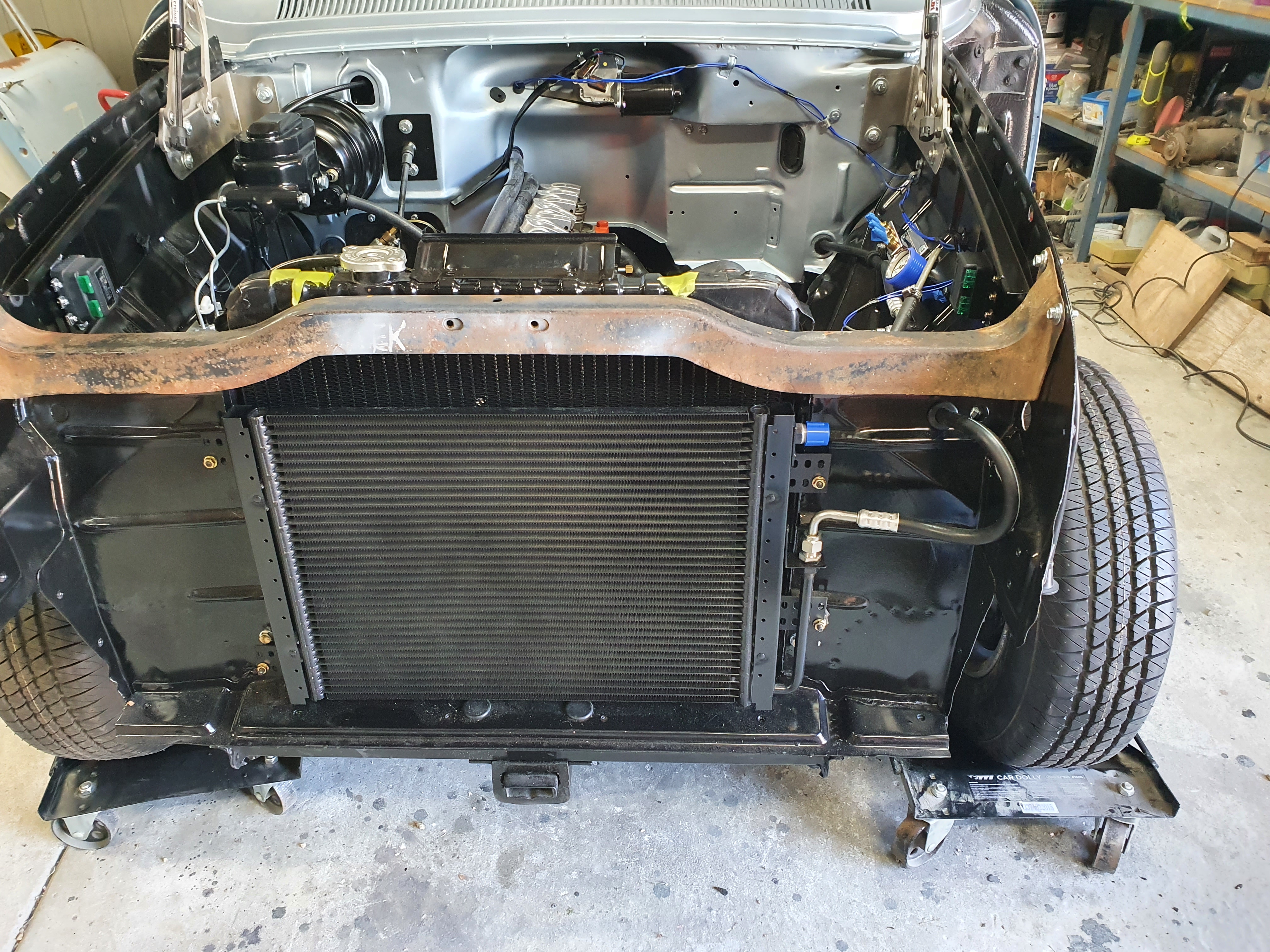

Some aircon pics since a few have asked for them. Unit is a Vintage Air Mini Gen 2 which does heater, demister and cooling. Rencool MD18 electric compressor. Will run on speed 1 setting which draws about 40amps. 140amp alternator fitted. Very tight fit in dash and glove box is now just a lid. Couldn't fit a fourth vent on drivers side because hose won't fit. Three vents should be enough with floor vents as well. Still waiting on a hose to finish. Liquid hose from condensor runs under floor, suction hose runs on floor and under carpet. There are any number of hose placement options, these work for me. I may install an electric fan on condensor depending on head pressures and need.
- 20220919_123834.jpg (2.69 MiB) Viewed 2949 times
- 20220919_123814.jpg (3.7 MiB) Viewed 2949 times
- 20220919_123730.jpg (3.44 MiB) Viewed 2949 times
- 20220919_123719.jpg (2.85 MiB) Viewed 2949 times
- 20220919_123707.jpg (3.1 MiB) Viewed 2949 times
- 20220919_123703.jpg (3.53 MiB) Viewed 2949 times
- 20220919_111810.jpg (3.43 MiB) Viewed 2949 times

Re: Project 2.
Looks cool Brett! (lame dad joke but couldn't help myself)
Probably an obvious one, but do you have to measure and get the hoses all made up with the kit, or do the hoses after you install everything?
