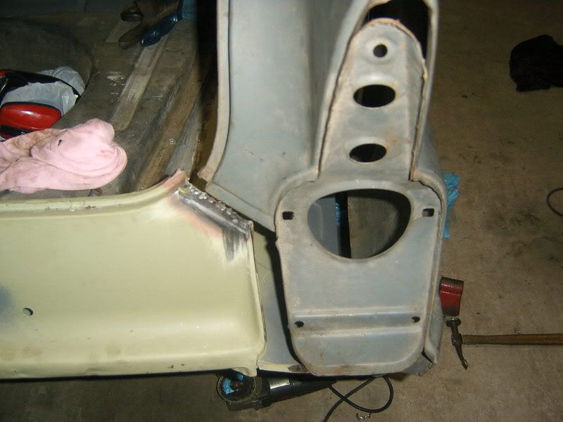

Its been a while since I posted but things are starting to look good time wise again.
I have finished some odds and ends and now most of my spare time will be back on the EK.
Finished a small repair on the lower inner rear drivers side but I think I will replace the whole lot later.
I found a NOS 1/4 and thats going to be my next task, will keep you all posted.
Tank should look at home painted nice just breaks the rear a little.

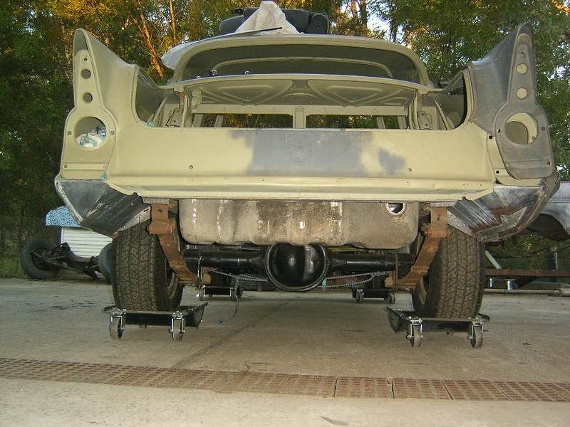

Whats are you planing on doing with the sender unit for the Tank...special cover, the lines etc?...anything?
I've been working at putting mine in the same way it came out, only need to 'massage' the tank a little to clear around the rear spring mounts, i should have the frame built and in by next weekend, (so give me 2 or 3 weeks for Pics!)
Was curious as to your plans with it :?:

I thought I would put the tank in this way for 2 reasons,
1/It fits in with no modification to the tank itself
2/Gives the impression of a drop tank which I have always liked.
I was going to run the sender unit hose and wiring between the tank and chassis rail so you wont see it once the tank is in place.
I haven't thought about any cover at this stage but I when the bumper goes back on you wont see it anyway.
I need to do some research on the paint that needs to be used cause the tank is gal plated I think.

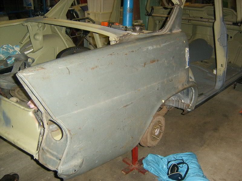

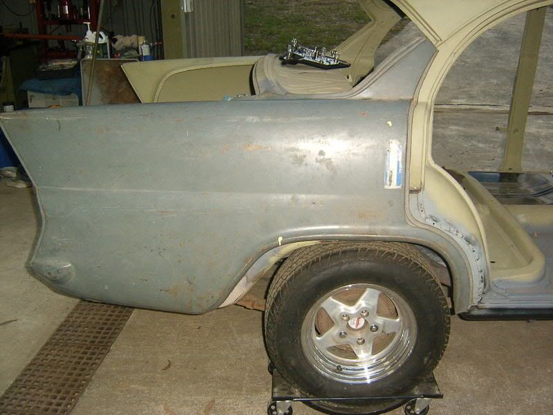

Posts: 2710
Guys and Gals
Congratulations to everyone that attended the nationals and to those who won prizes, well done :D :D :D

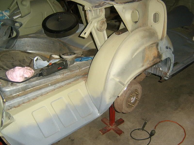

I couldn't make it but the little time I had left over the weekend I used to do some more work, finally!

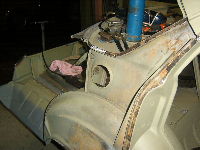

I got the shits with the rear right 1/4 because it had a little rust and had been stretched around the dog leg after hitting something years ago, I just wasn't happy with it.
So after finding a NOS one I decided to cut it off and replace!!!!!!!!!!!!!
With the 1/4 gone you can see how I made the frame to hold the tank.
Still lots of work to do to make the NOS 1/4 fit the body.
I need to check the boot lid for gaps and also the rear door gaps before its welded in place. I am trying extremely hard not to use any bog (my own challenge) so far so good :wink: :wink: :wink:

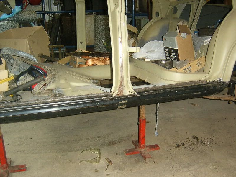

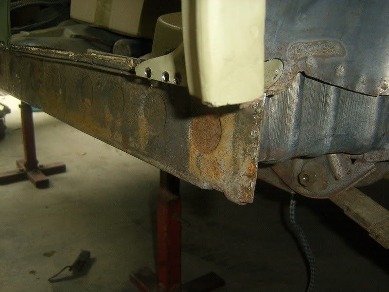

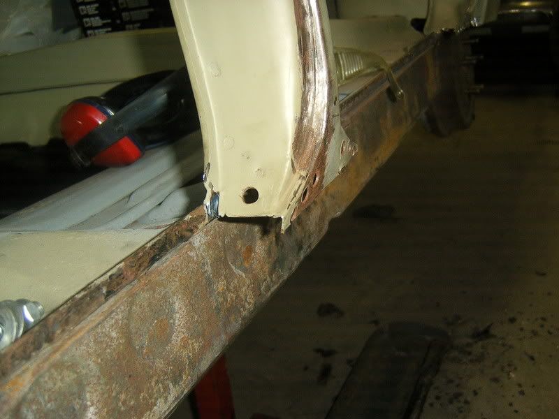

Hi everyone,
Well I cant believe thats its been 8 months since I struck a blow on the old girl :shock: :shock: :shock:

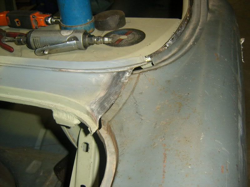

Got into the shed today with a rare day off and inspired by all you guys decided to finish the left sill.
First I had to tidy all the spot welds and get rid off what was left of the original sill.
I had to cut the B pillar away from the body to let the sill slide up into it.
I still have to massage the sill with the doors on before its welded in place.
Have to make sure all the gaps are right.
Hopefully some more progress over the weekend.
