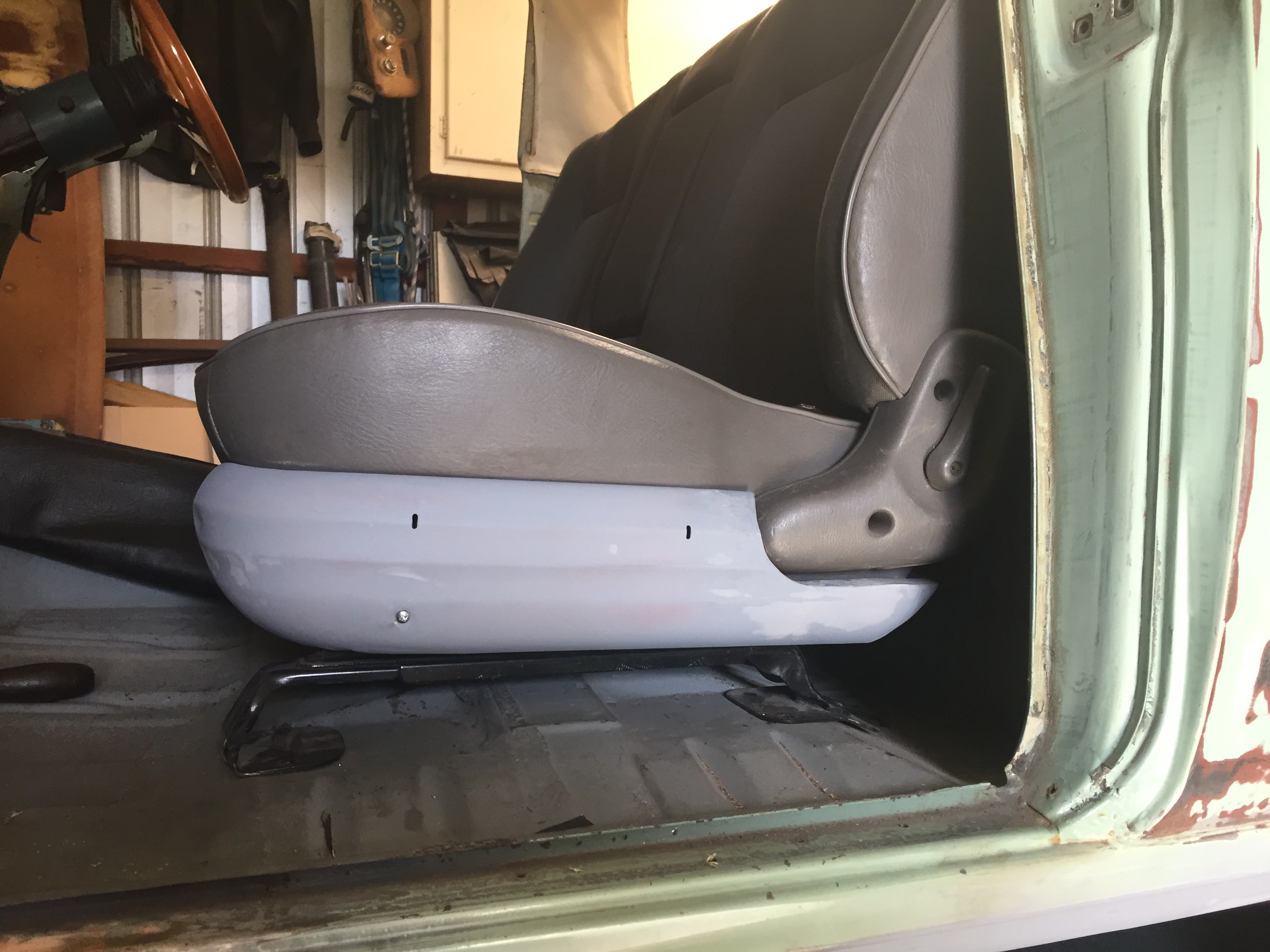

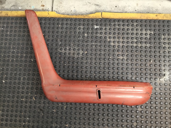

Front seat is Mazda T50 that will lose the centre holes when it is re-covered.
I wanted to dress up the sides so I took a couple of the metal side covers for an EK old seat and cut them up.
I hear the groans and mumbled comments but as Clay quiet eloquently pointed out, I’m a bloody hot rodder.
Seat side 1.JPG (172.75 KiB) Viewed 755 times
Seat side 2.JPG (1.64 MiB) Viewed 755 times
Surprisingly what looks like a fairly quick and simple task, takes a lot longer to complete but progress.

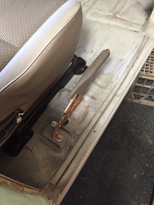

I have completed the bloody handbrake setup.
Ended up using a combination of short RH cable and change the knob to suit the balance plate.
The LH side is a part original and Laser for the wreckers.
It would have been easy to do a centre mount or even easier to leave the original setup but I now have the cables tucked up to the body.

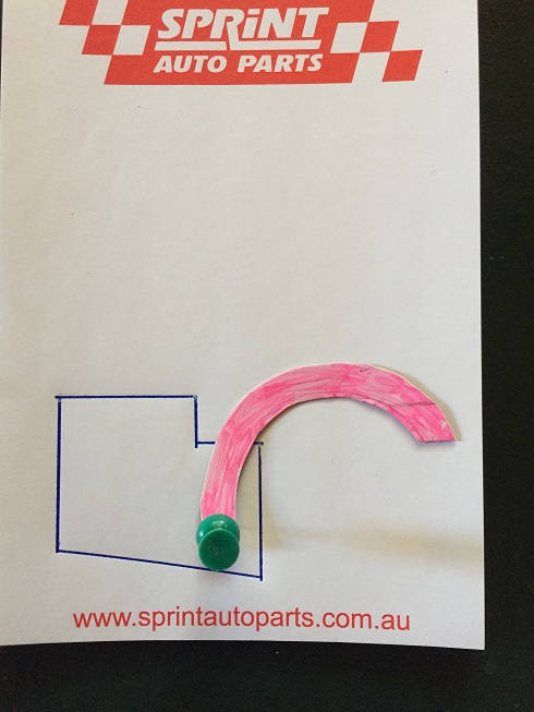

Little progress on the tailgate hinges but I did try using the upper tailgate hinge from a HQ van.
These there too big and did not have the correct arc.
HQ upper hinge.JPG (112.62 KiB) Viewed 716 times
I when back to cardboard temples

I like the handbrake lever setup, like a HQ style. Works well with the Mazda seat by the look. You are getting there. What’s the hurry right?
