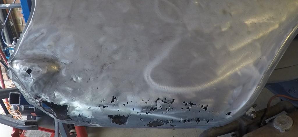

Well it's been awhile - again... But started work on the right rear qtr panel

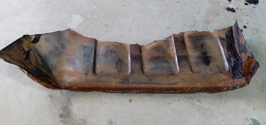

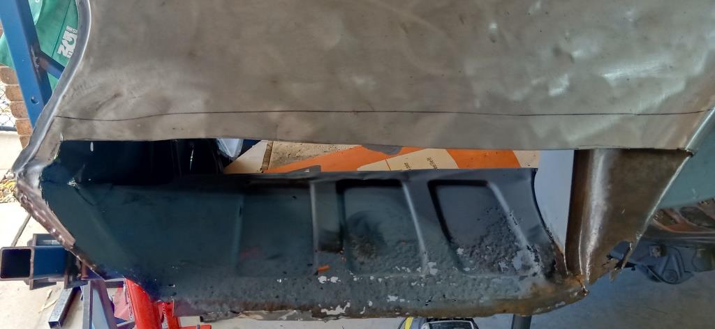

I have the Rare Spares lower patch panel so cut out a section to reveal the inner swiss cheese
Donor section not perfect but salvageable Now just trying to get the Rares patch to fit.

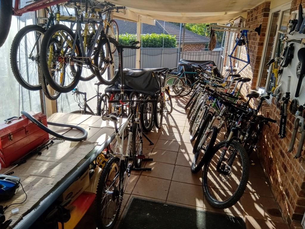

But I haven't been idle, I have alot of vintage/retro mountain bikes to look after.... And more car related I finished my first engine build, as practice for Betty's grey motor. The Junk 186. 3 pistons were completely stuck in their bores and I broke 2 persuading them to come out. No 1 bore is waaaaaaay oversize, out of round and tapered and understandably only has 30 psi dry compression and 50 wet. The rest average 80. But it runs, so I didn't do too badly. The only new bits were bearings, rings, gaskets, fuel pump, spark plugs, leads and bits and bobs. The rest were original to the engine or used parts sourced elsewhere. It was good fun and I enjoy running it and disturbing the neighbours!
