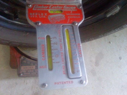

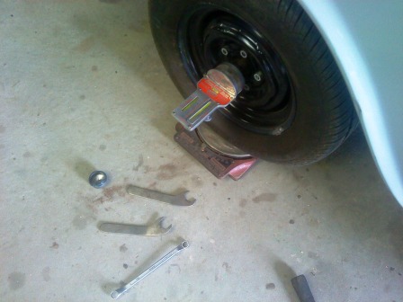

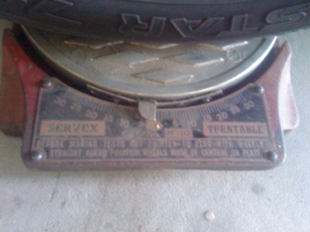

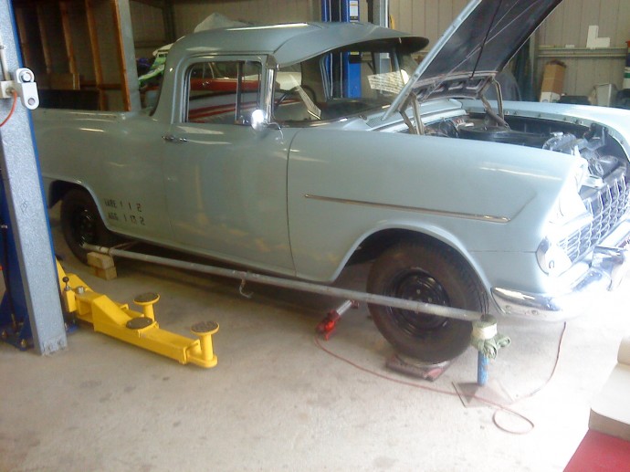

Wheel alignment done today. Had to improvise a bit as I haven't got a track rod to do the toe in. Steers well now and holds a straight line with no hands. Steering wheel nice and straight too.

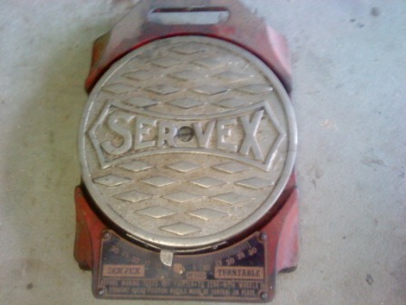

Who remembers this good old Australian made gear?

Craig,
That wheel alignment gear is gold !
I have used brickies string in the past to get the toe in and out, actually its quite easy to do the alignment if you've got the gear.
It always bugs me that the so called pros can't do these old cars or don't want to !!!!
Great stuff now the tyres will last forever.

Post by Craig Allardyce »
Thanks Greg, yep its not that hard but I've learnt one thing with these old busses regarding caster. Trying to get more than 1 degree change in caster is nearly impossible with what adjustment is available. Unless you index the wishbones in a staggered fashion (between top and bottom) its just about impossible to get the required caster spec for a ute. As it is I can only get sedan spec.

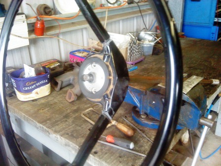

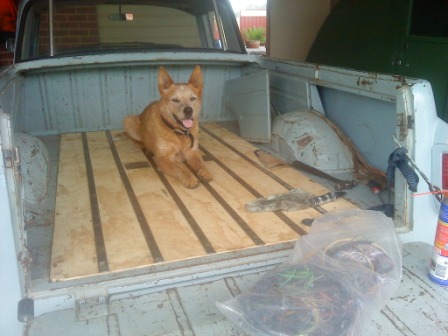

Today I've had a crack at doing an epoxy repair on the steering wheel for RWC. Stay tuned on that one. Also started to wire in the trailer plug (lovely Australian made Utilux 5 Pin original with towbar). Dog at least approves of the tray!

What are the best spec settings for the ute alignment Craig?
Loving this resto mate - it is one amazing survivor.
Craig Allardyce
Posts: 1566
Location: Stratford
Re: Seagull Grey EK 2106
Wally I did +1 degree camber +1 1/2 degree caster & 1/16" toe in. Ute specs for caster are 0 to +1 caster but I couldn't get it down that far as I ran out of adjustment (both sides). Either way its within caster spec for sedan and steers well. I'll have to get back to later and work it out. I had similar issue with my FB sedan but not as bad. Might have to go through the service bulletins.
Today I finished off the trailer wiring. Ended up using and old loom and th3 4 way connecters and bullets. Took some fiddly solder work but come up well. Looks factory.........but no one will see it anyway............dunno why I bothered lol.
Anyway all hooked up and working and ready to go!
