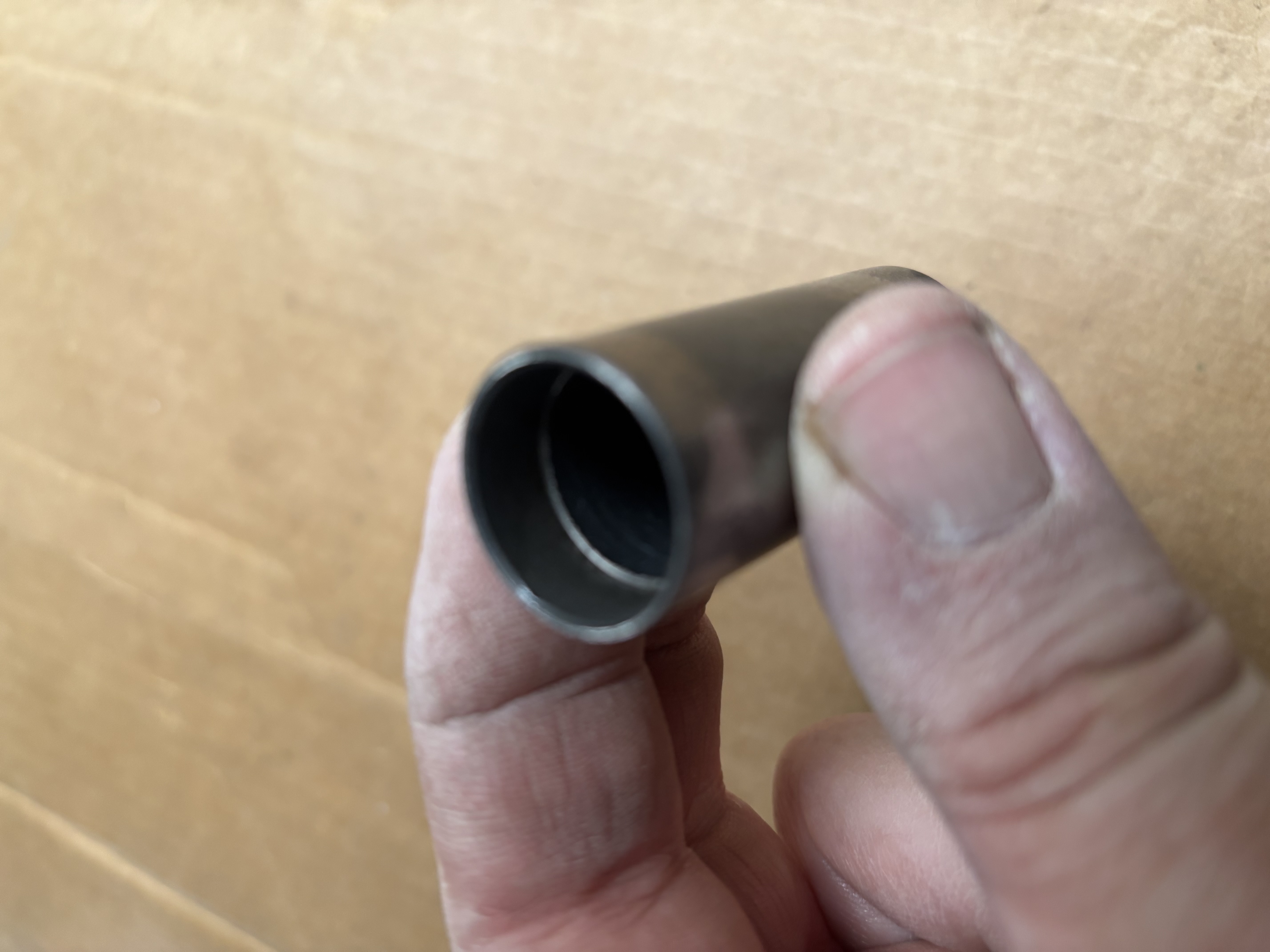

Today, pushrods. Almost.
Knew the pushrods were too long for the rollies, so didn’t fit them when I put the head on. Need to measure, then get new ones made up. Somewhat frightened, as they are NOTHING like a normal pushrod. They need to be custom made from 1/4” silver steel rod, then heat treated. Preparing for a wallet-dectomy :(
Figured I could screw the rocker adjuster out, slip in a pushrod checker, then refit the adjuster. Good in theory, not in practice - adjusters only come out downwards. Rocket gear off. I had bought a ball-end pushrod checker years ago, and managed to put it aside when I packed the shed up.
In theory, fit the checker and rocker gear, screw the checker out (with a feeler gauge holding roller tip lash at 14 thou) and then get the new pushrods made up to that length. Slight problem: the checker I bought years ago does 9.8-10.8”… and I need about 8” for the exhaust and 6.5” for the inlet. I could cut some rod down and fit, cut, fit, cut but all that gear is now packed away with the shed, and my patience for refitting rocker gear a dozen times would grow thin. Two new checkers to suit on their way.
The next learning was that the rollers are made for 5/16” balls, and the lifter end cups are made for 1/4”. The cups are an insert fit into the standard lifter, once it has been recessed a little. If I get the cups milled to suit a 5/16” ball then I can use standard type pushrods. Lifters back out and off to have the buckets milled.
