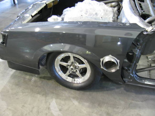

I'm waiting to see you drill 4" holes in those guards so the fenderwell header collectors can poke through :mrgreen:
fender header exit.jpg (42.1 KiB) Viewed 7017 times
Mebbe in the US... not so much here.

They are v banded at the collector for easy/ish dumpage
