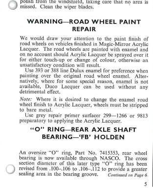

hey Steve. found this little bit of info... not sure if it helps ???
wheel paint.jpg (106.12 KiB) Viewed 5657 times
