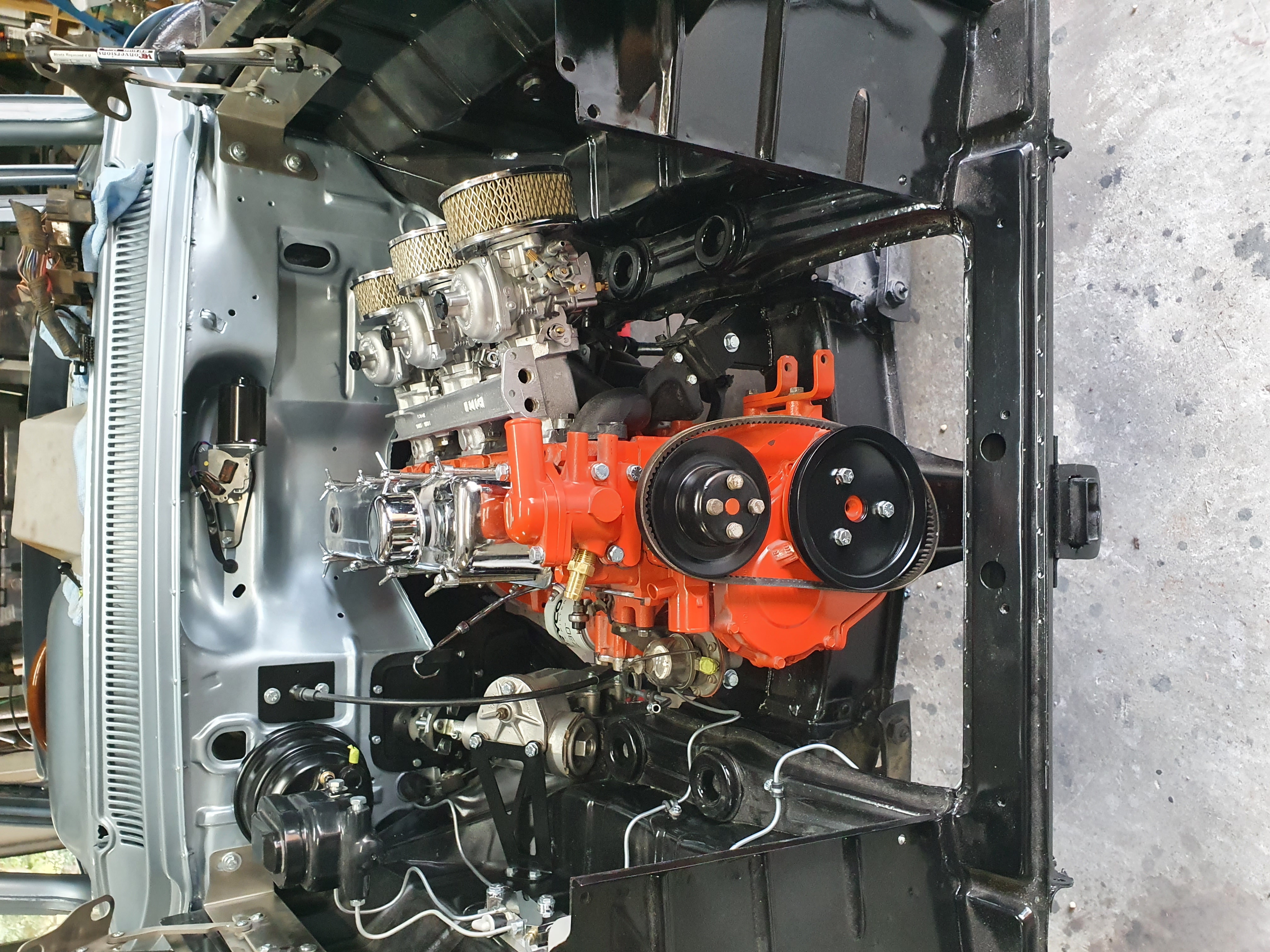

A bit of mock assembly today to work out a few things.

Brett,
Top part of fuel pump needs to be rotated one screw hole counterclockwise. Normally inlet is at 7 o'clock and outlet is at 1 o'clock . . .
Just being picky.
Posts: 2518
Re: Project 2.
Really?!

Triples, and a chrome rocker cover on a red painted block look awesome.

Awesome is the look BRS is going for😀. Thanks Neil, Harv, Stephen. Sam and I kicked the tyres again this arvo and it was smiles all 'round.

Spotless. Yes the jugs and manifold look top notch. Like Rob says fuel pump will work better with top turned one hole anticlockwise.
Posts: 2518
Re: Project 2.
No it won't. Will work just the same and currently inlet and outlet align to where I'm running my pipes. Not sure if you and Rob have noticed but I'm not running a standard fuel ine🤪

You'll need a shorter fan belt, it wont work with that one. :lol: :lol: :lol:
