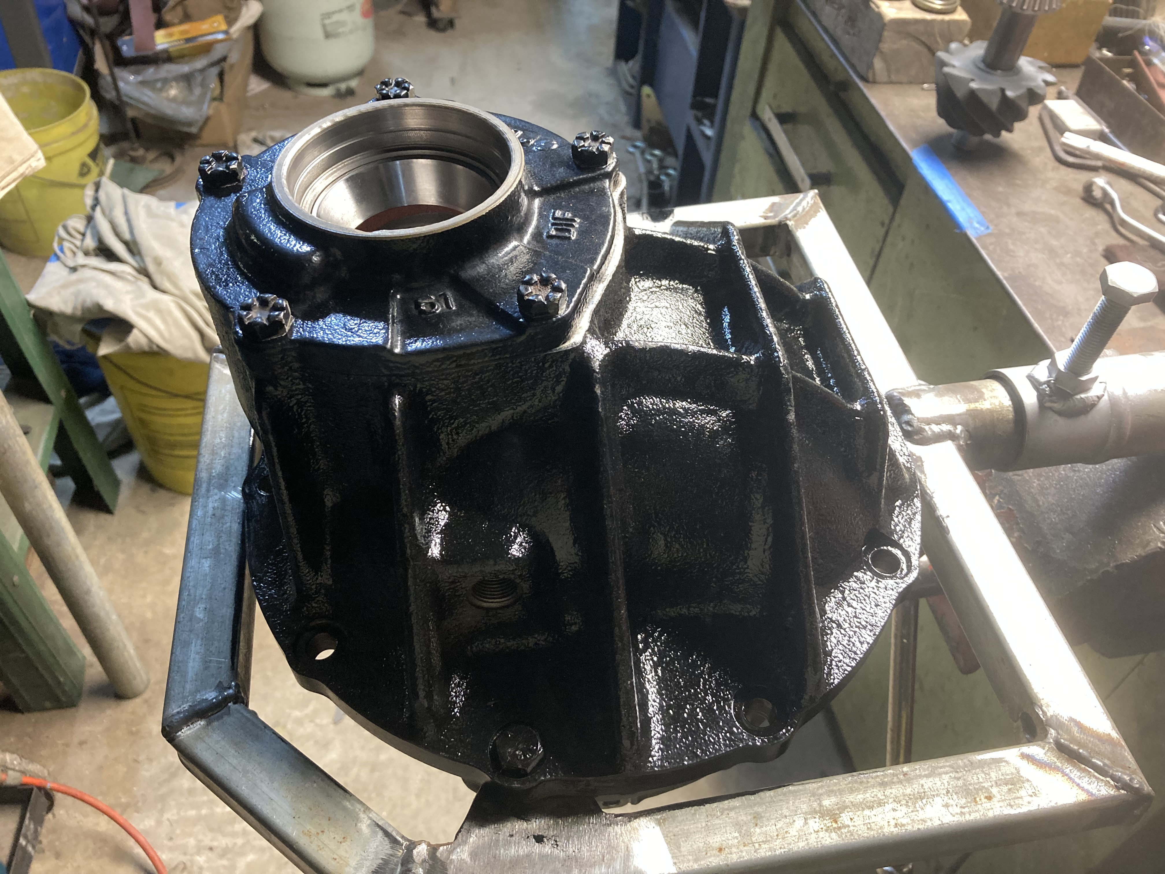

So i finished my first diff build, i always wanted to do this and to be honest kicking myself that i didnt give it a go when i was younger.
It would have saved me some cash over the years.

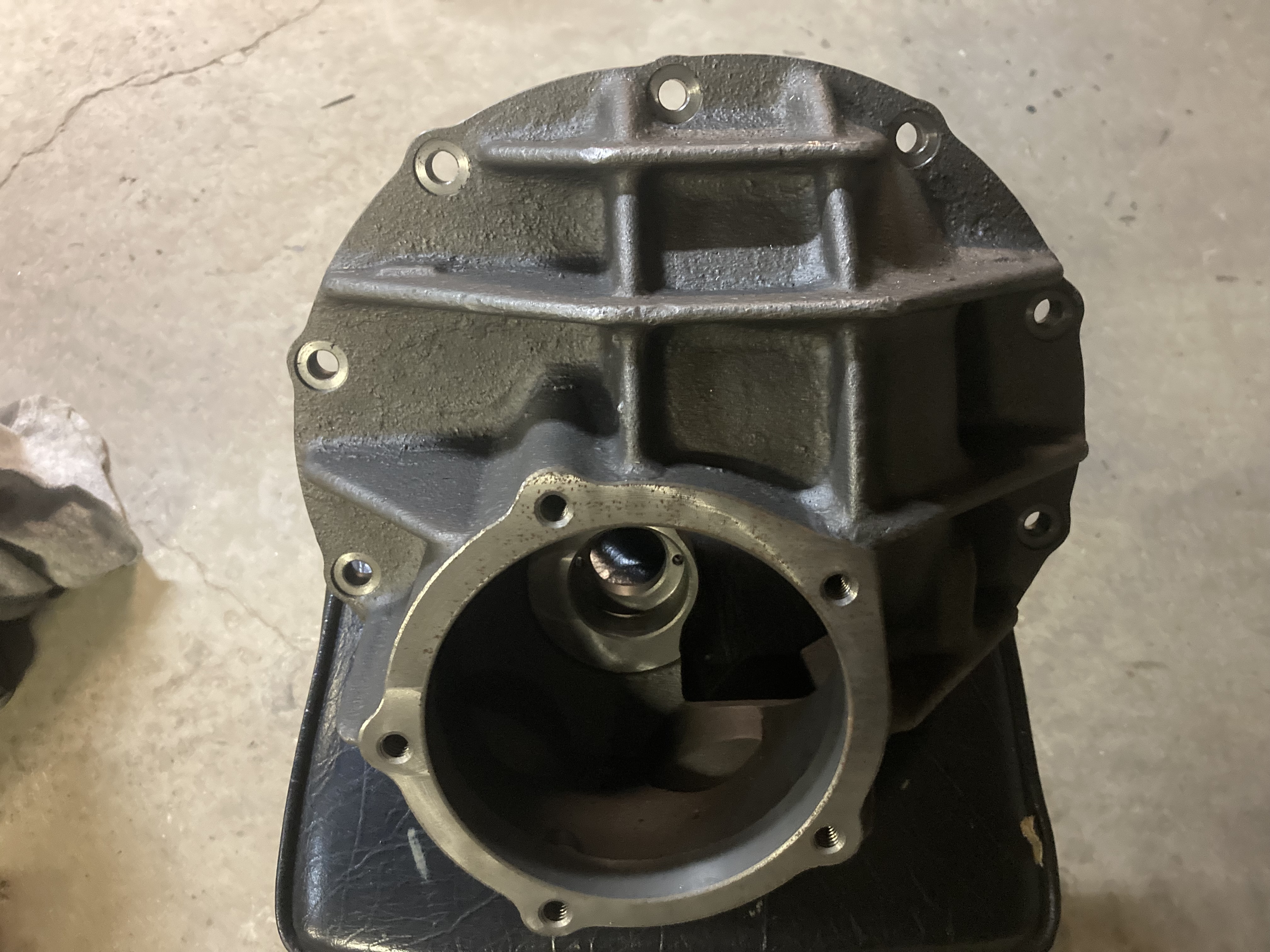

Bought a brand new case to suite the aftermarket larger carrier bearings
Painted with new pinion bearings
New tool foot inch pounds to get the correct bearing preload on the carrier

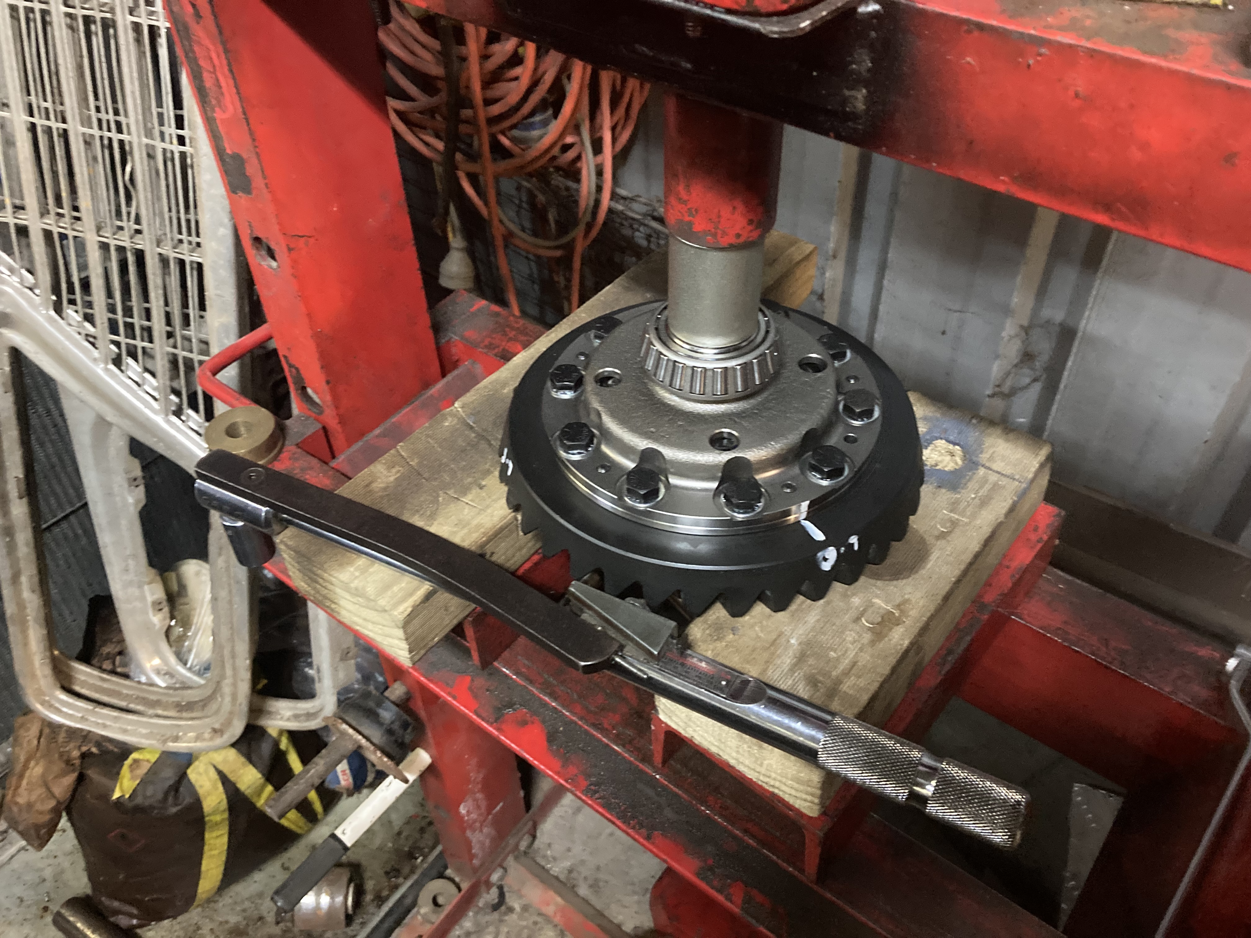

New ring gear installed on the true trac center

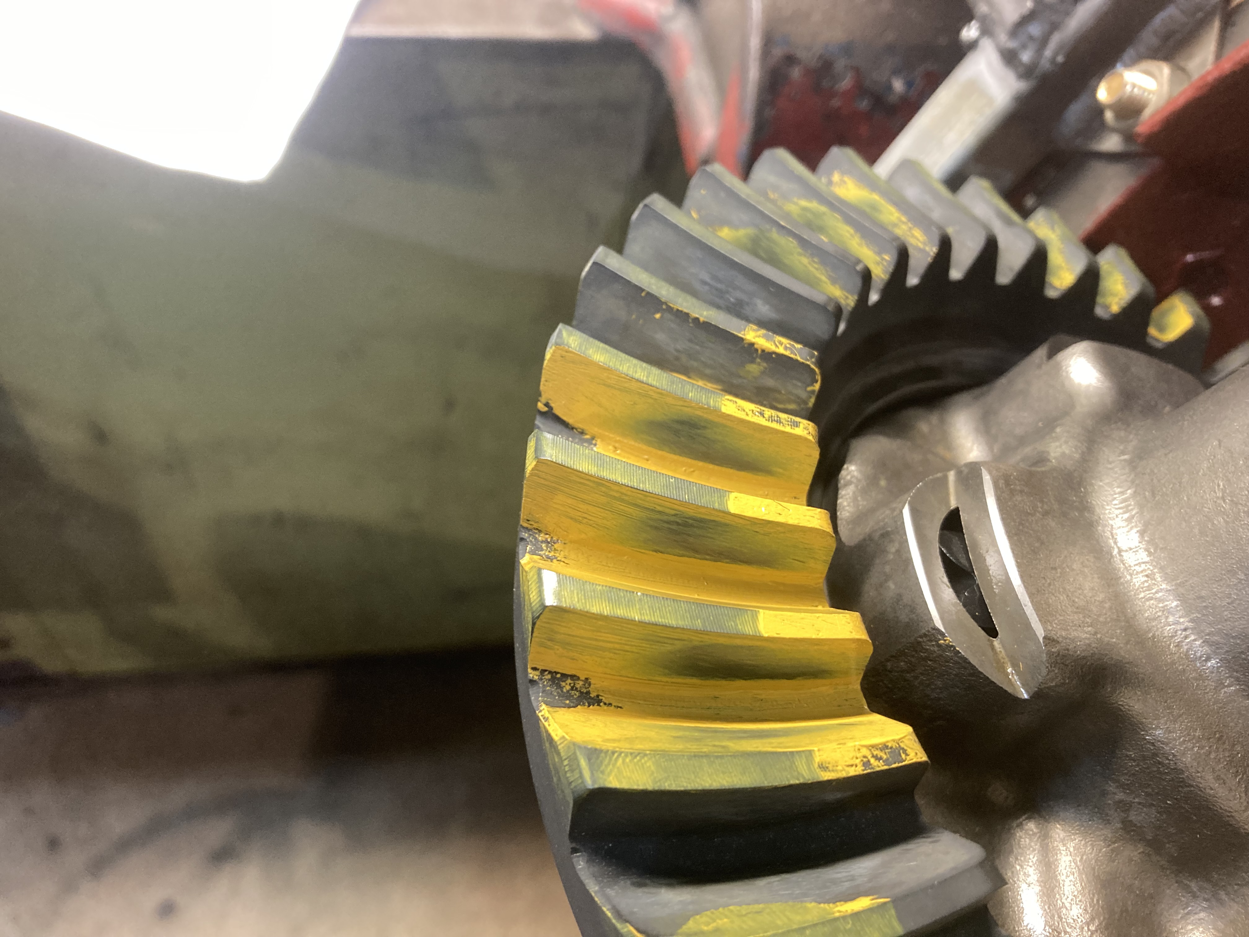

First spin attempt on the meshing, i dont have a photo of the final product but i got the pattern very central to the teeth.
Big axles should be right mate !!!!
All back in and ready for a decent run this weekend, you have to bed the gears in with a couple of hot and cold cycles appparantly !!

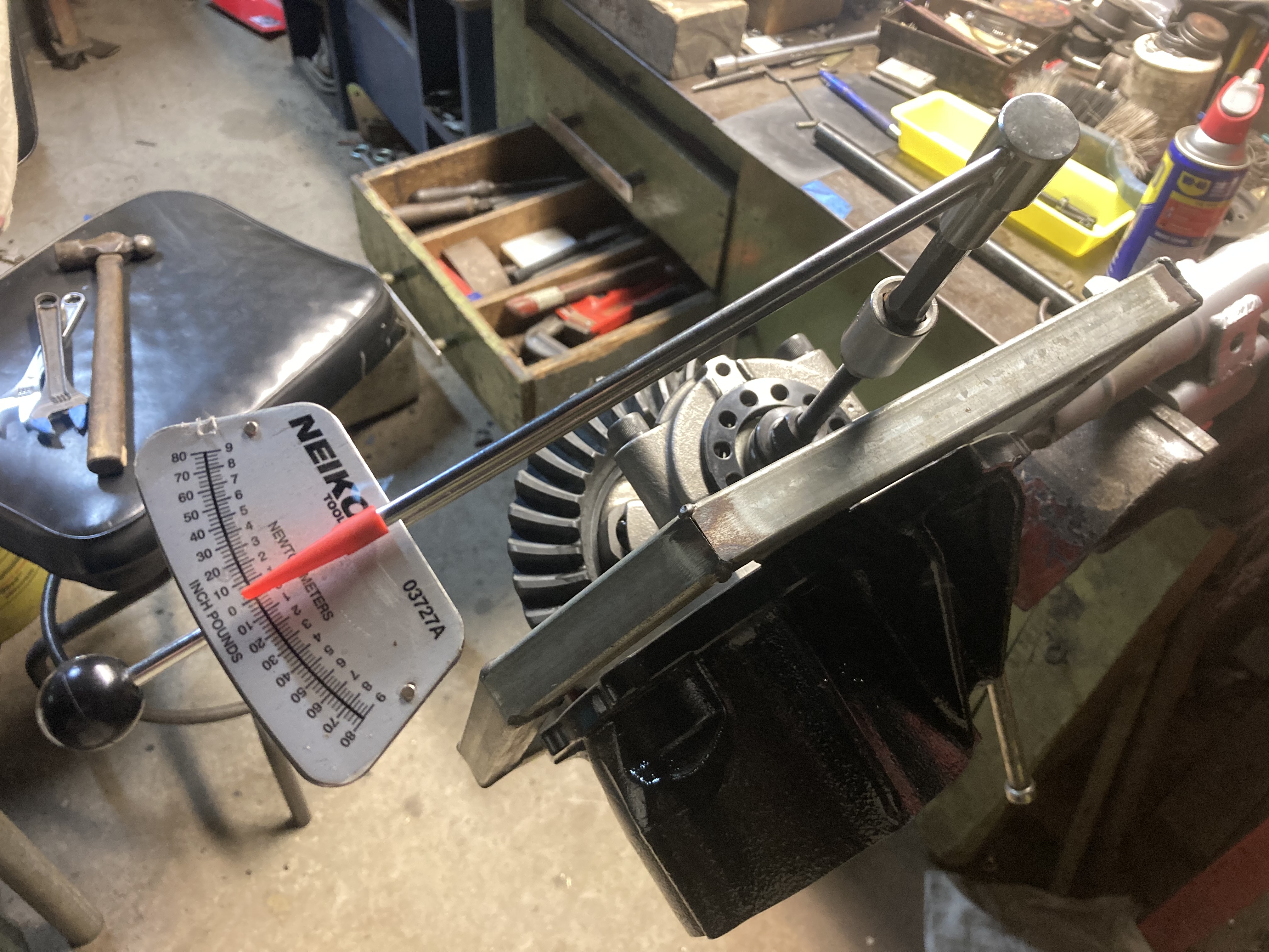

The foot pound wrench callibration is just too big for this detailed precision work, even with your correct equation it is not possible to go down that low on the foot pound scale being that 12 foot pound is 144 inch pound. My Tension wrench starts at 20 foot pound.
The bearing preload on the pinion bearings and carrier bearings need 15 to 20 inch pounds of resistance, and needs to be measured without seals and with the wrench i have in my pictures.
The wrench is 1/4 inch drive, so you need to be creative with the adapters and sockets to achieve a fit.

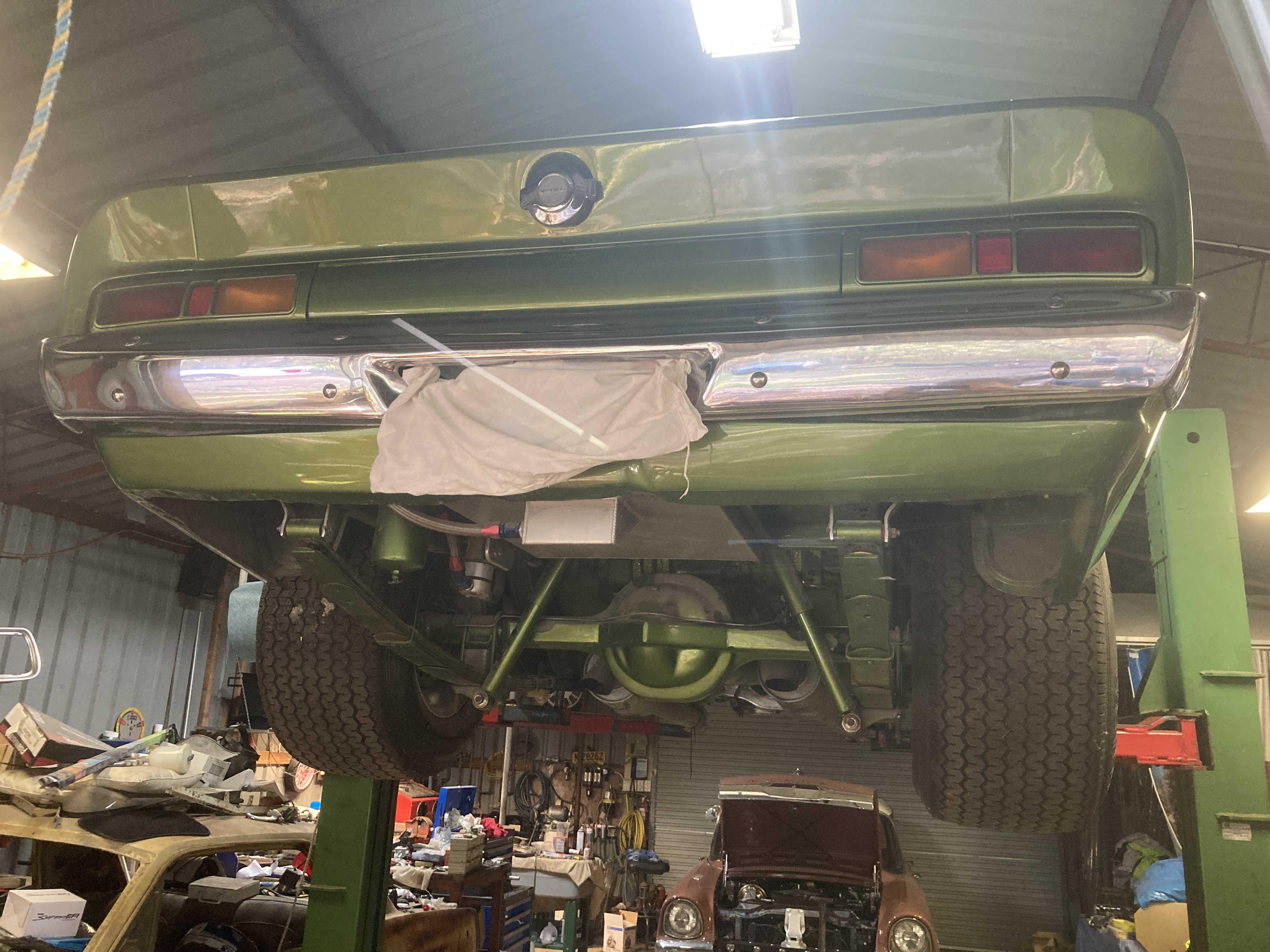

Diff update, absolutely fantastic !! the old girl moves along at shall i say scary speed and i have left some decent liquorice strips around my local area.
Private roads of course !!

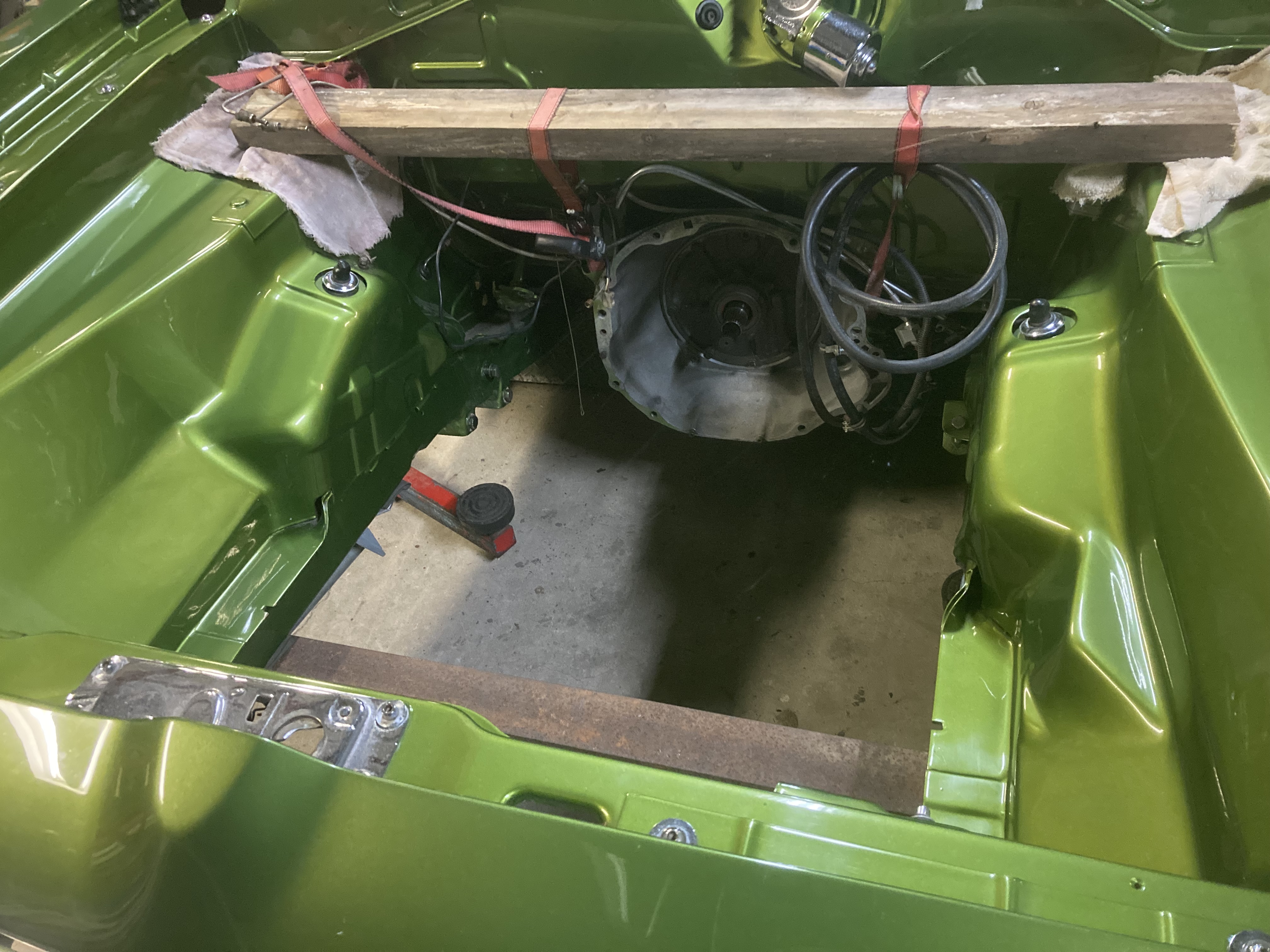

Doing an engine for a buddy, 360 Roller cam with all the goodies. This Val is good looking and has the fats as well !!
I just hate how much room is in the engine bay !! Plan is rack and pinion steering, 360 roller engine and some good exhaust. I know its not an FB or EK but what the hell why not !!
