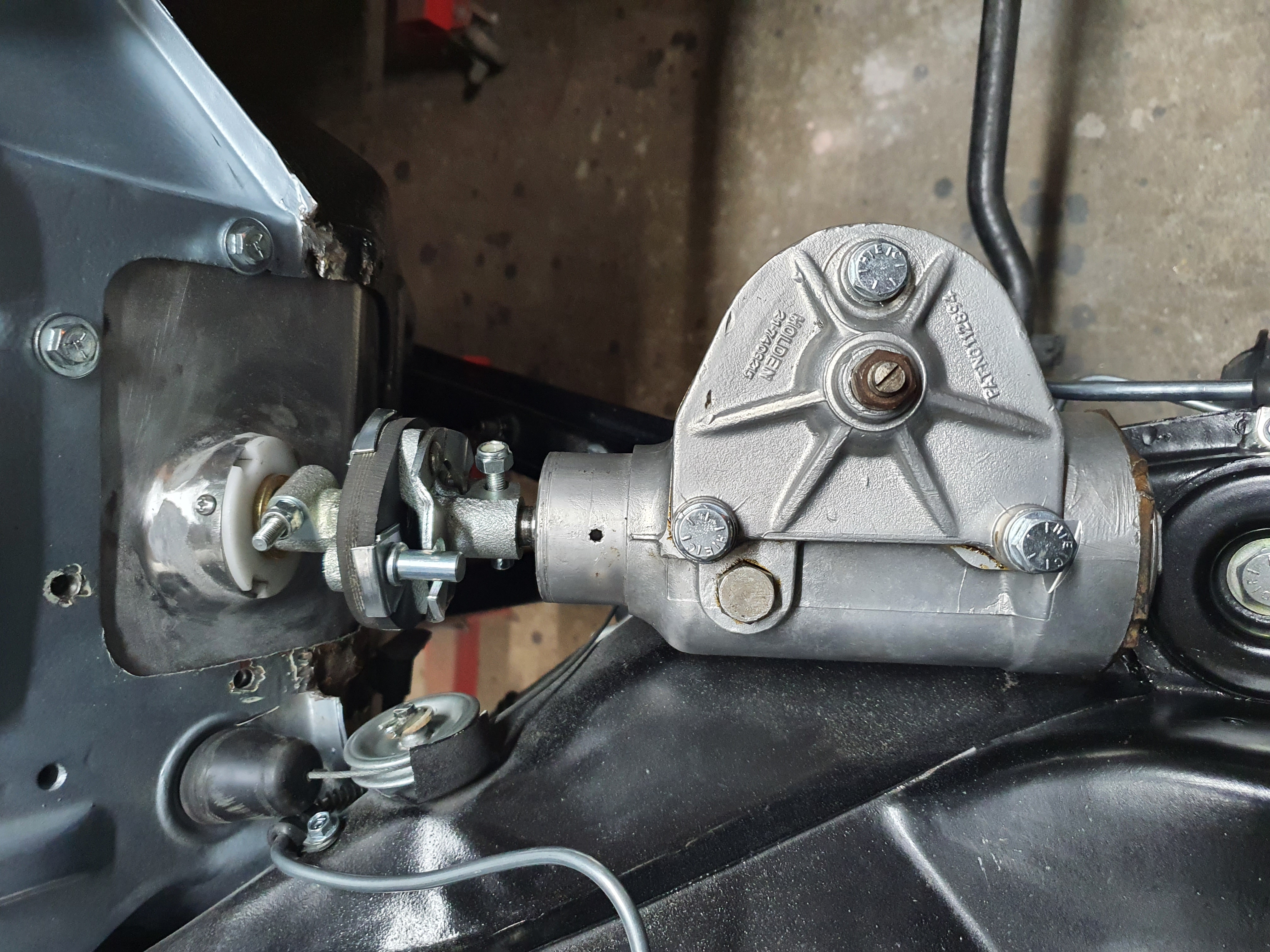

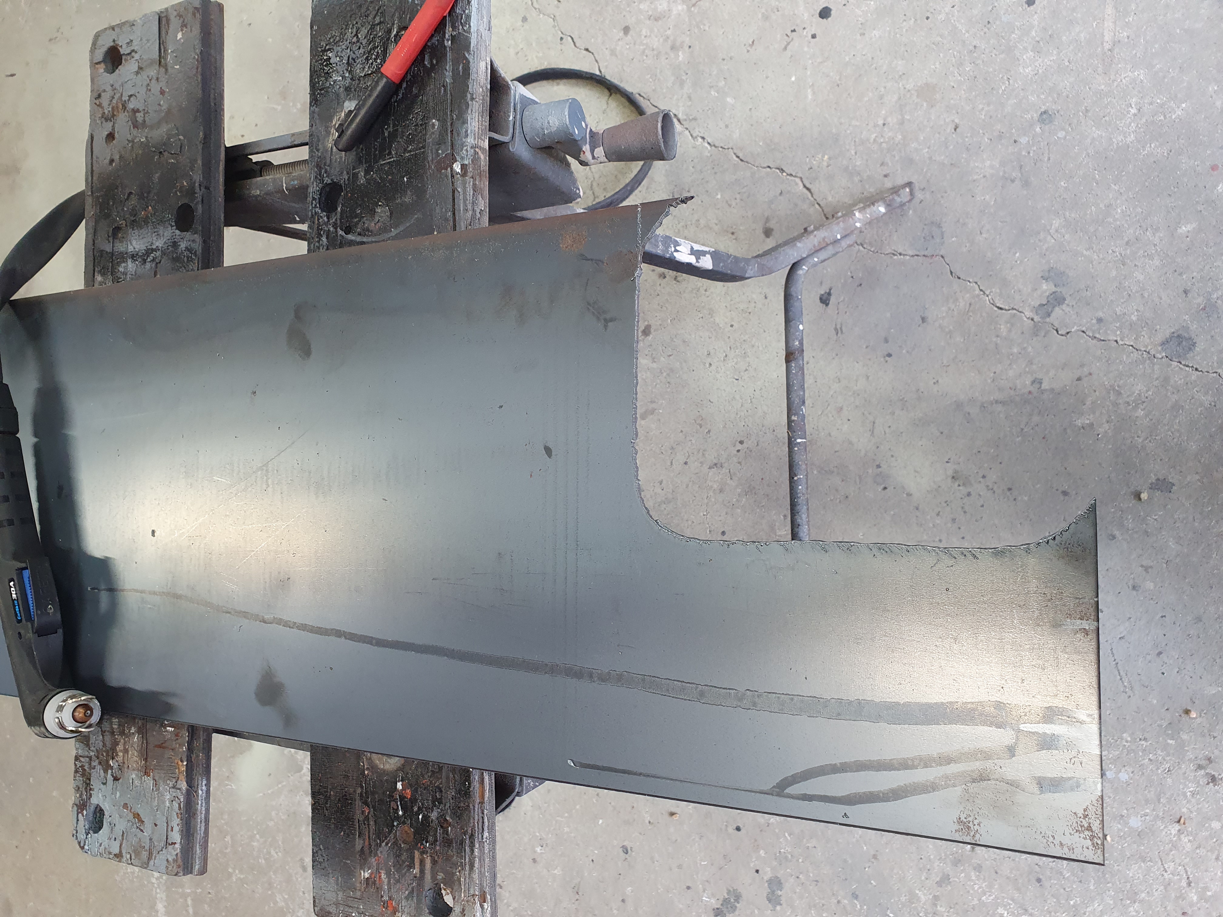

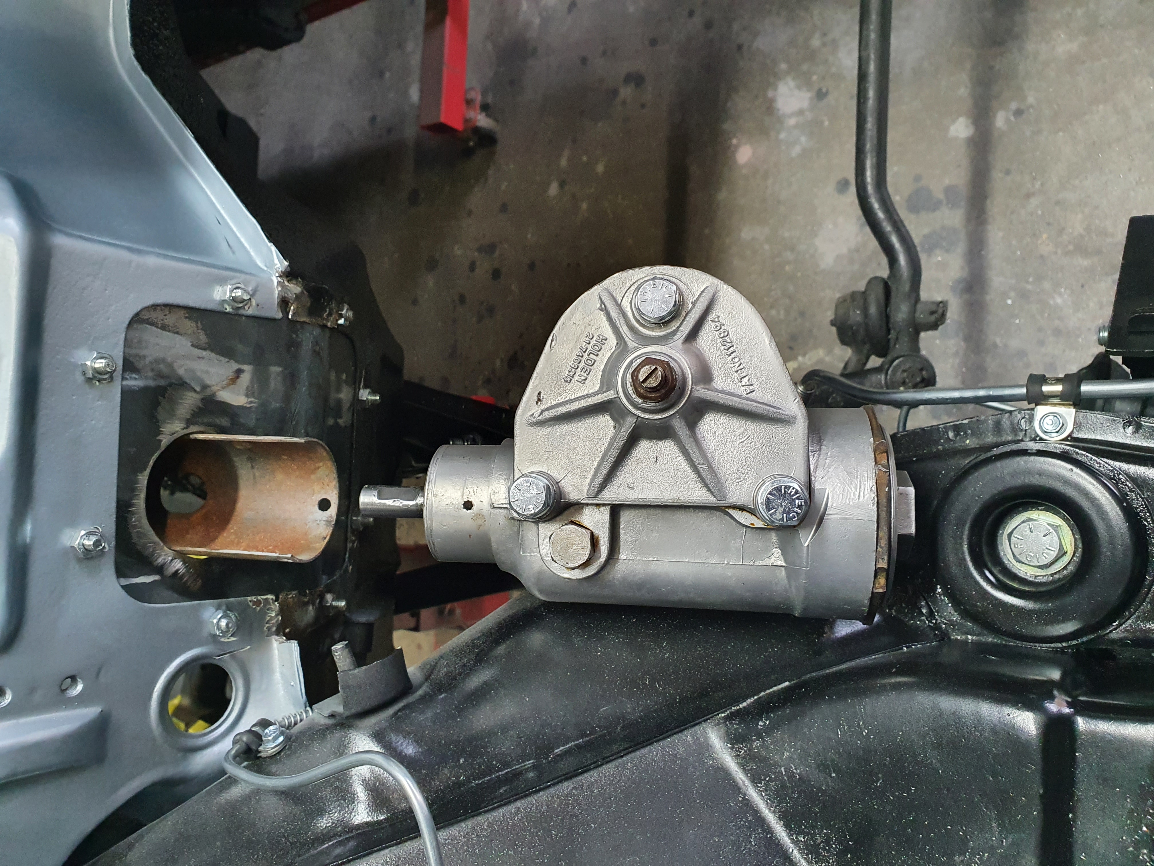

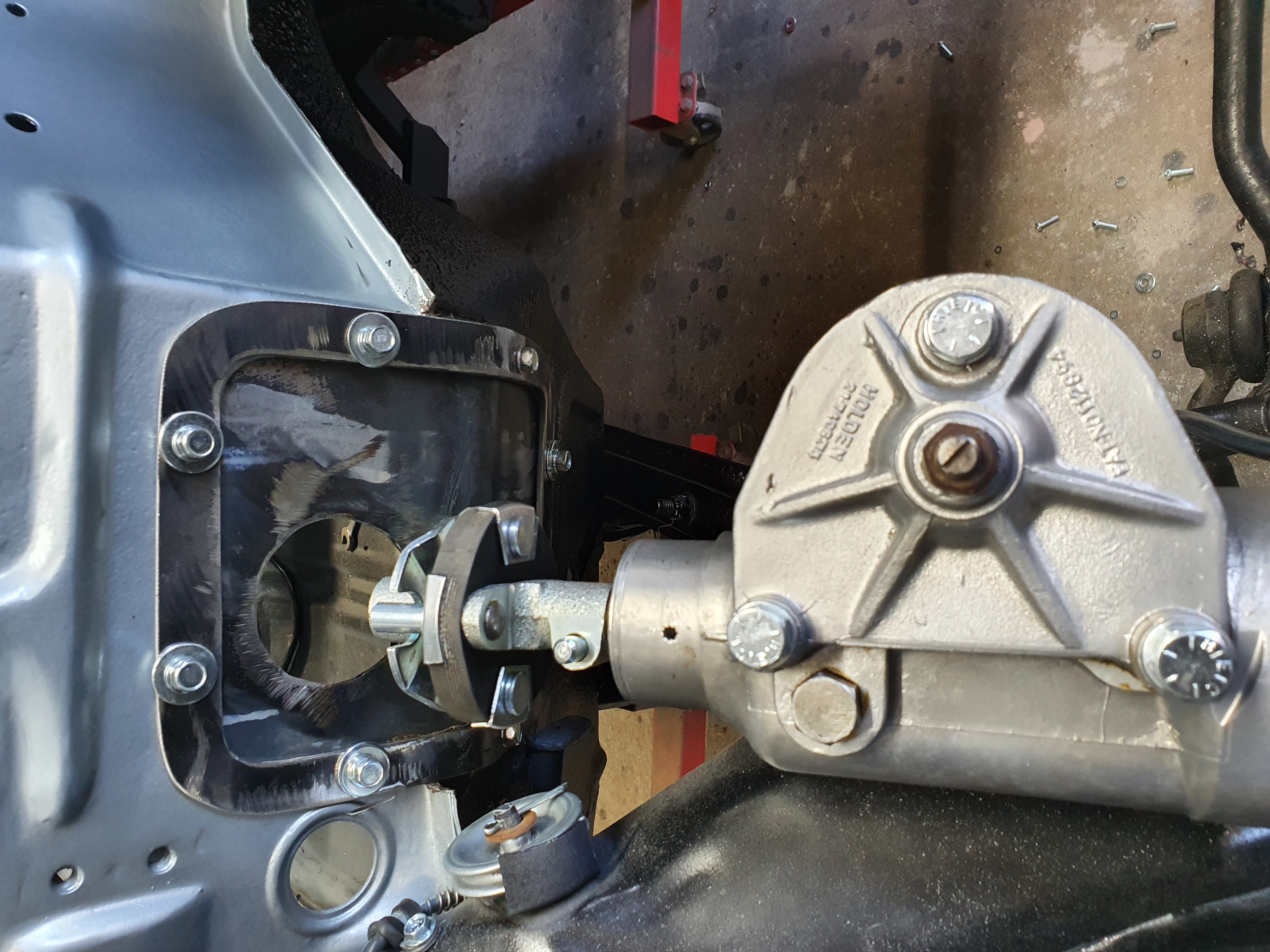

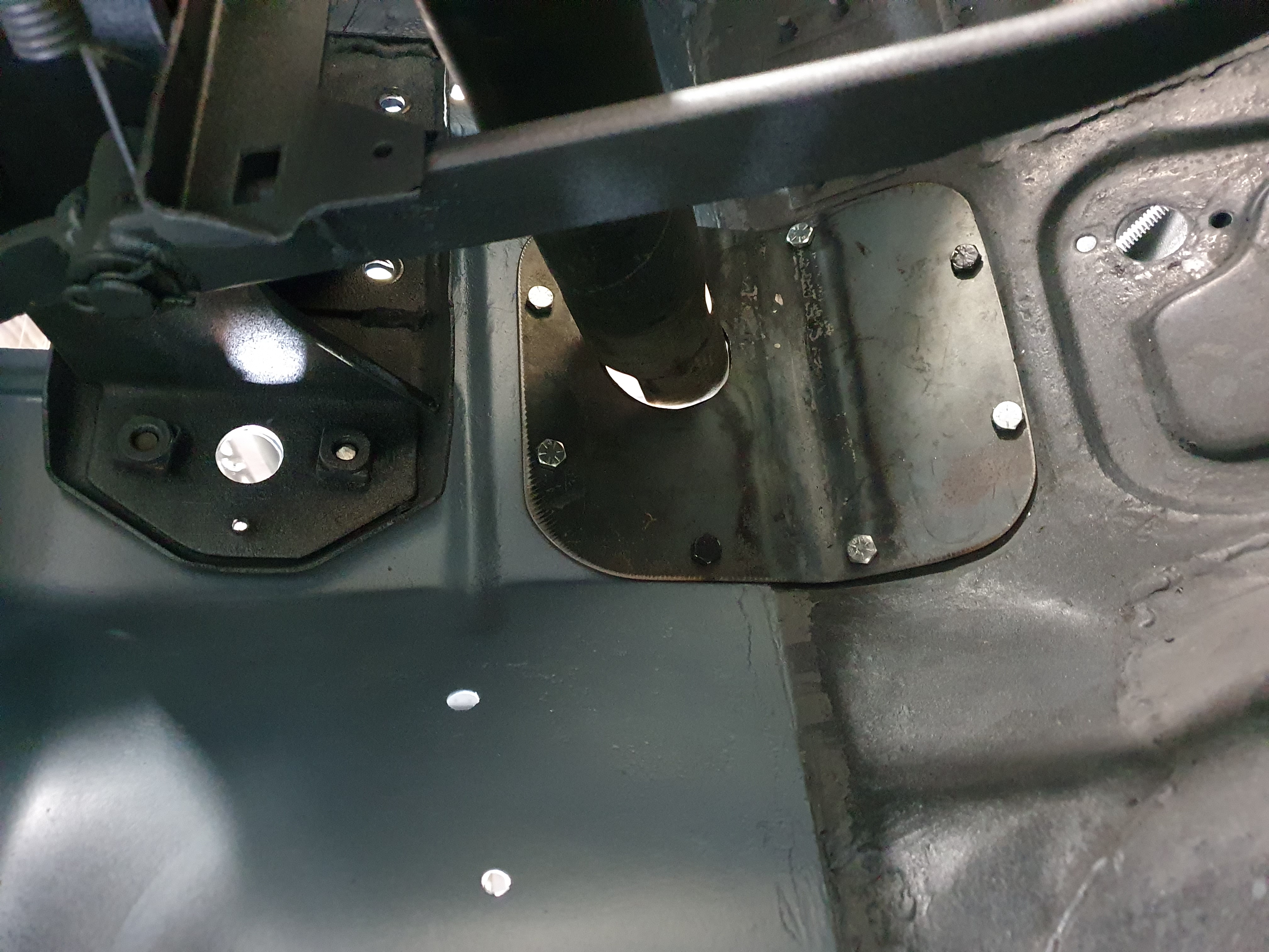

A bit more steering progress. Cut and bent the mounting plate for the firewall and test fitted it. Engineer wanted 3mm. I will get laser cut mob to cut me a 20mm wide 3mm thick cover strip/plate to put on the firewall front and then tack the nuts to the inner plate to make it easy to fix. Column will be welded to the plate.
I have decided to go with the torrie ignition and indicator set-up and see how it goes. It would not be difficult to install the EK bearing housing and honey pot if I dont like the look of it.

Yeah easy peasy. Column will come out from inside, seperate to box. Box can be unbolted seperate from column. So muuuuch easier than standard set up. Maybe nuts on outside plate to make it just like old one.

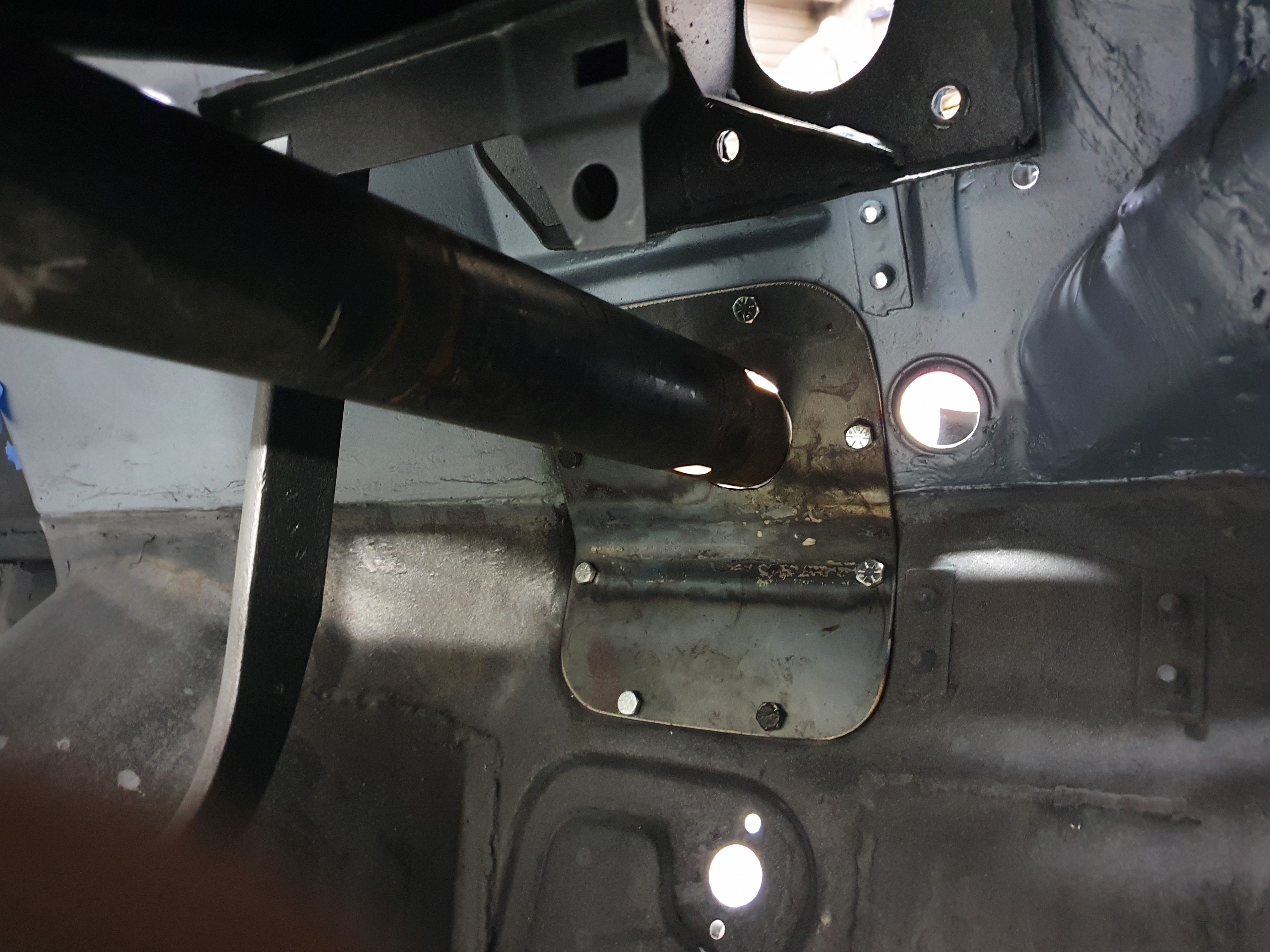

Mounting plate bits sorted, will lose flat washers and keep spring washers. Currently using Rares guard screws but will probably change for 7/16 head. Nuts now welded to back plate for ease of install. Next job is placement column and weld up. Slowly, slowly😁. It's all pretty tight....

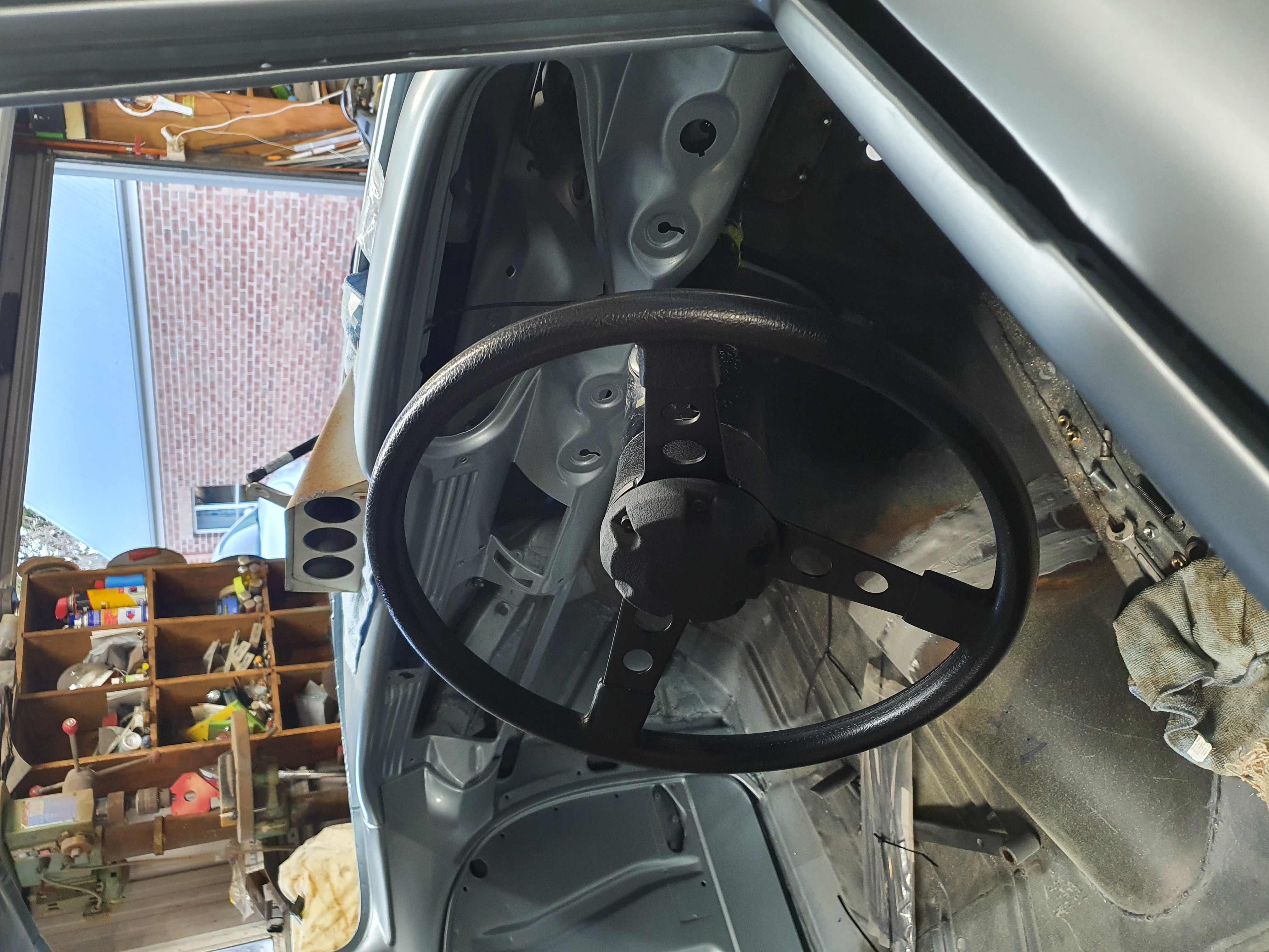

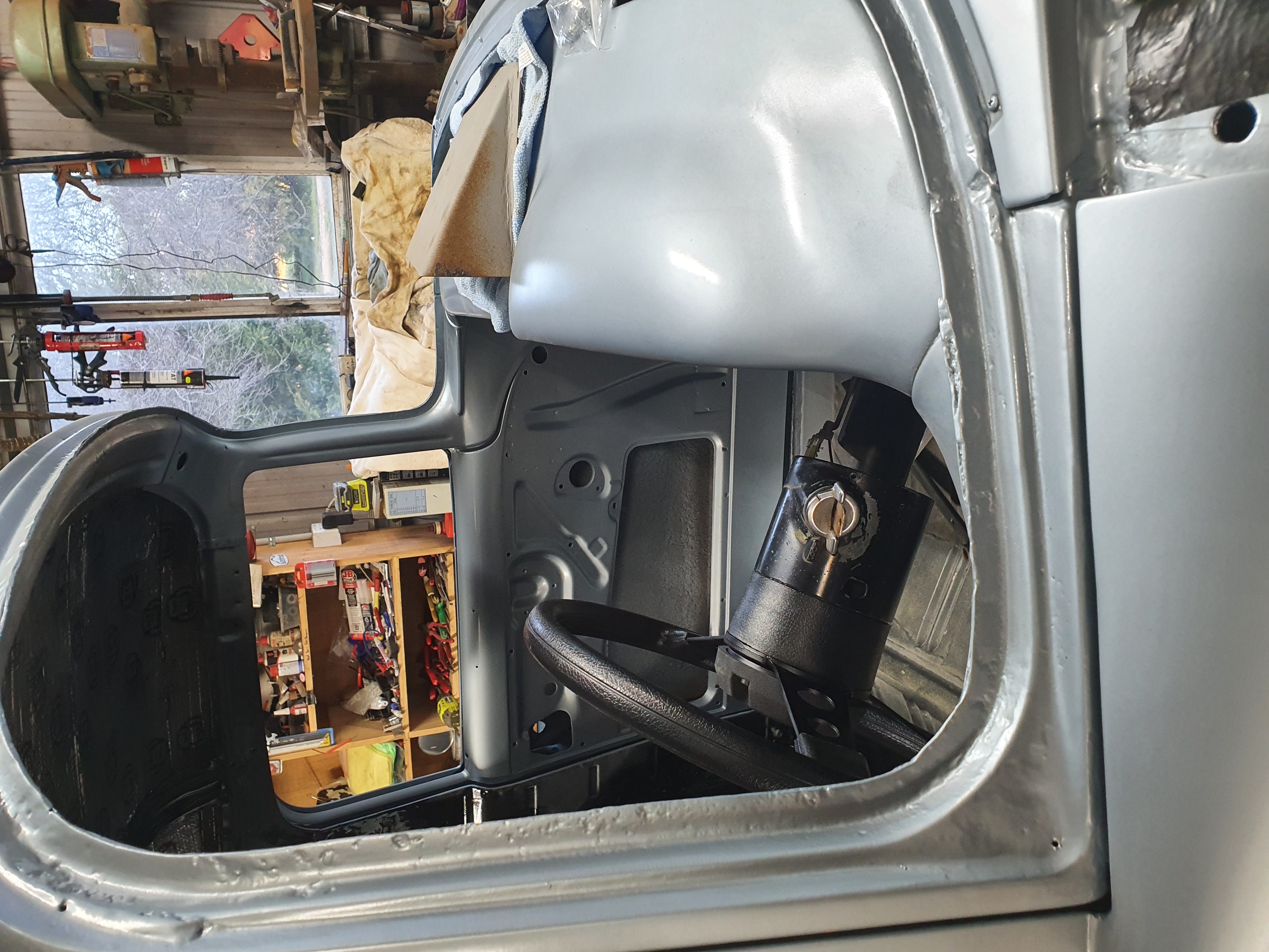

A bit closer to the finished product. It seems to be working out OK. Next job is to weld up mounting plate to column. May still add EK honey pot to make it neat or use the plastic filler that comes with it.
You can see my steering wheel of choice to keep the theme going🙂. Dimensions from wheel to dash are almost identical to black utes standard set up so should be OK.

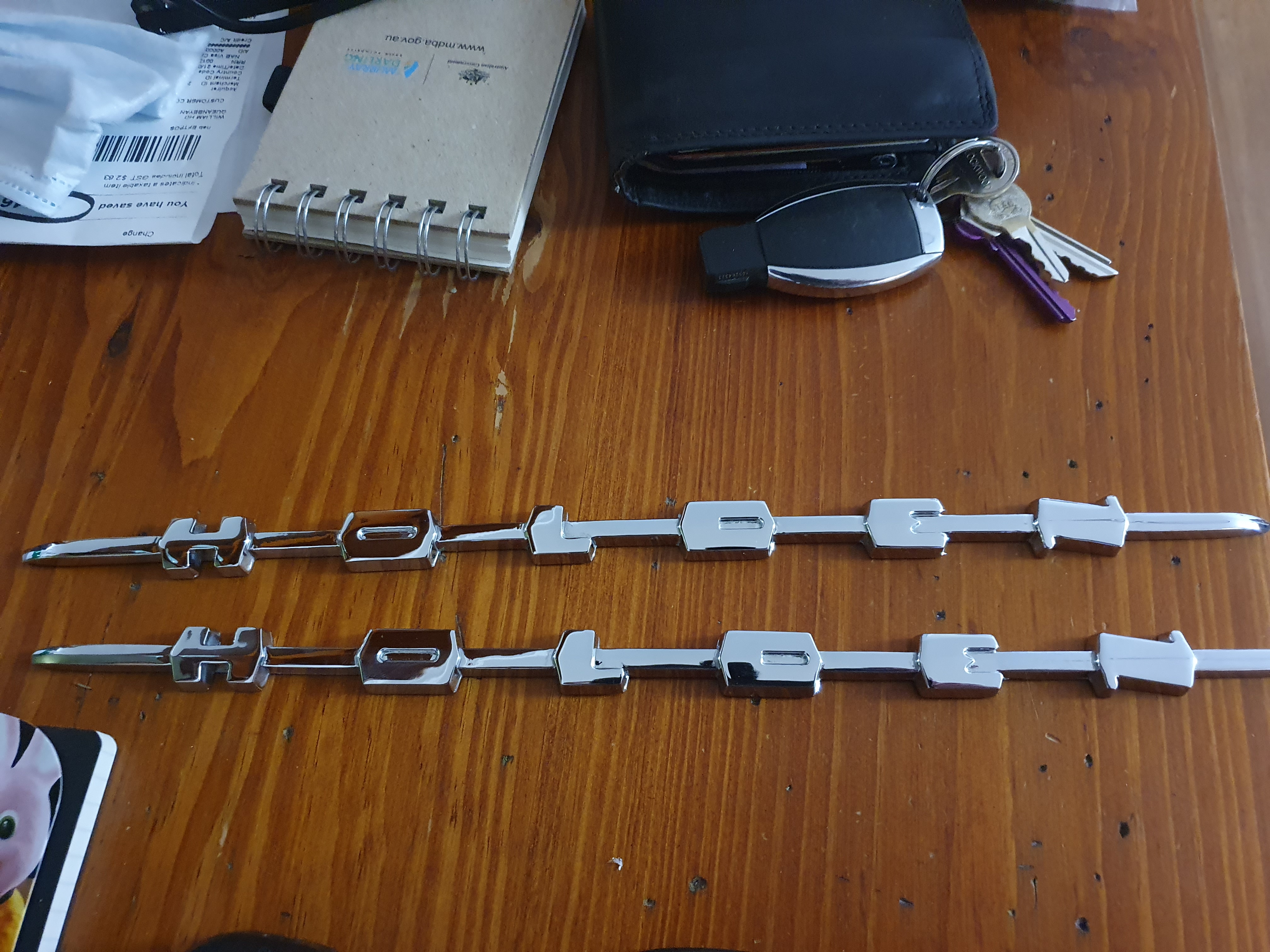

My new tailgate badges arrived today. Thanks Stephen they are spectular.
Posts: 11630
Re: Project 2.
Unique beast you are building Brett. Tidy work as ever. The boot badges look fantastic.
