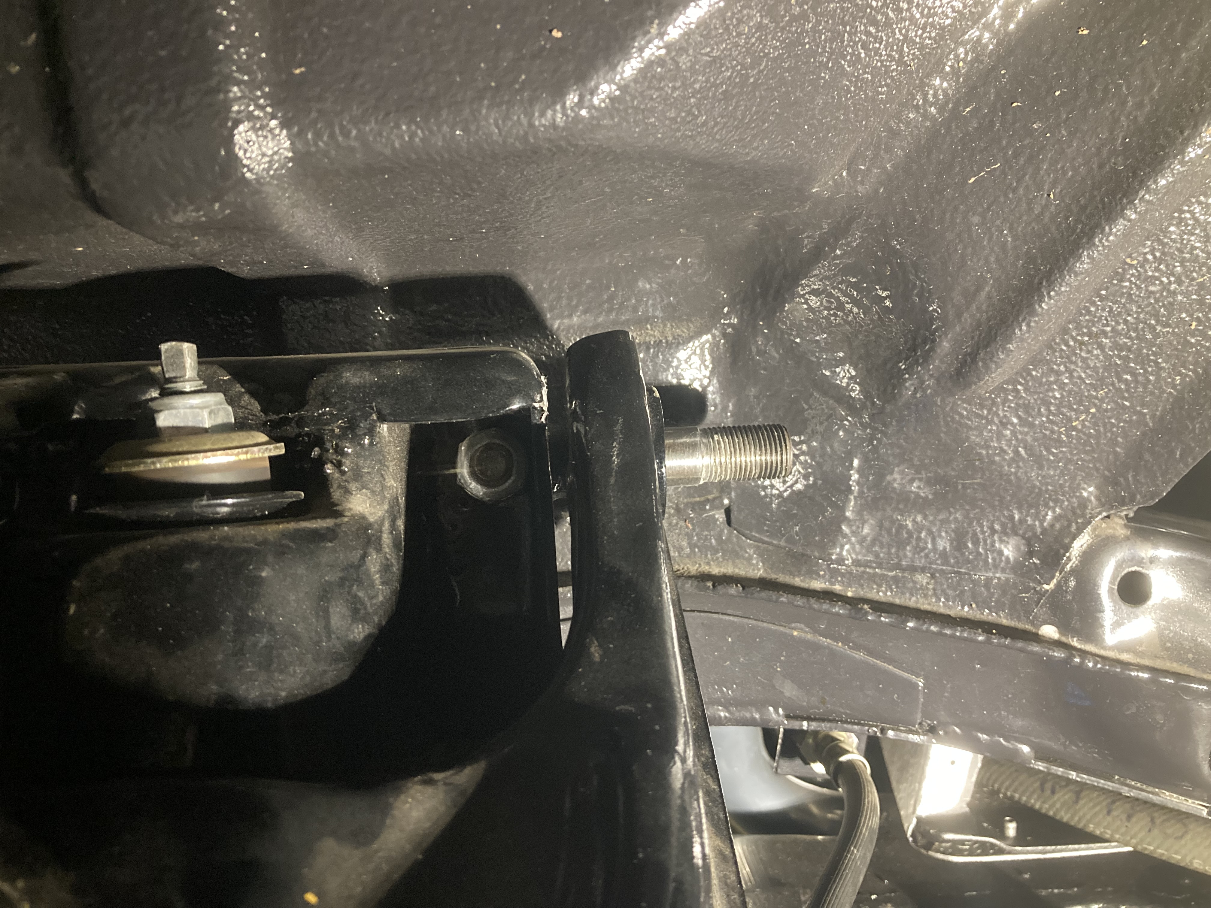

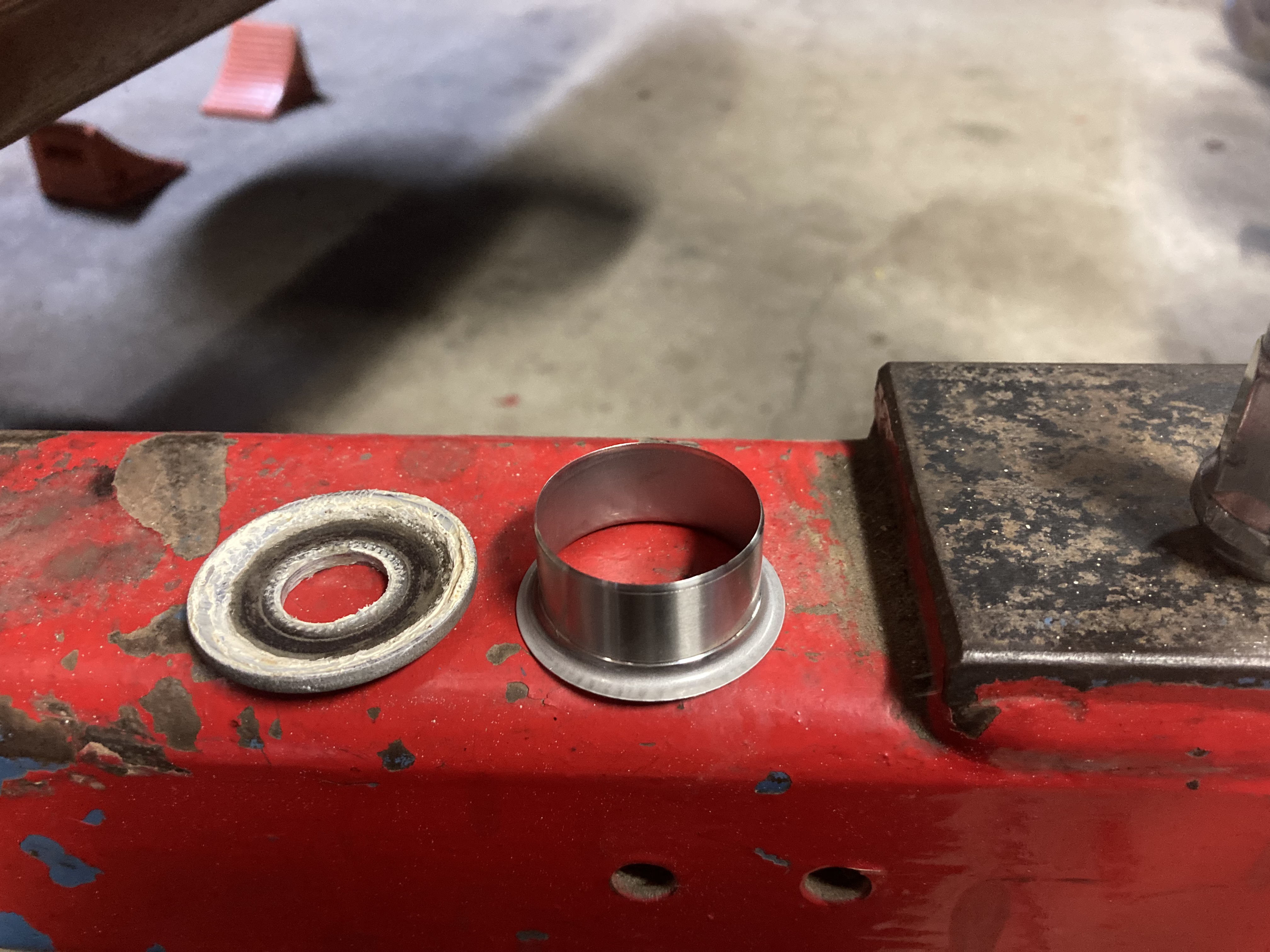

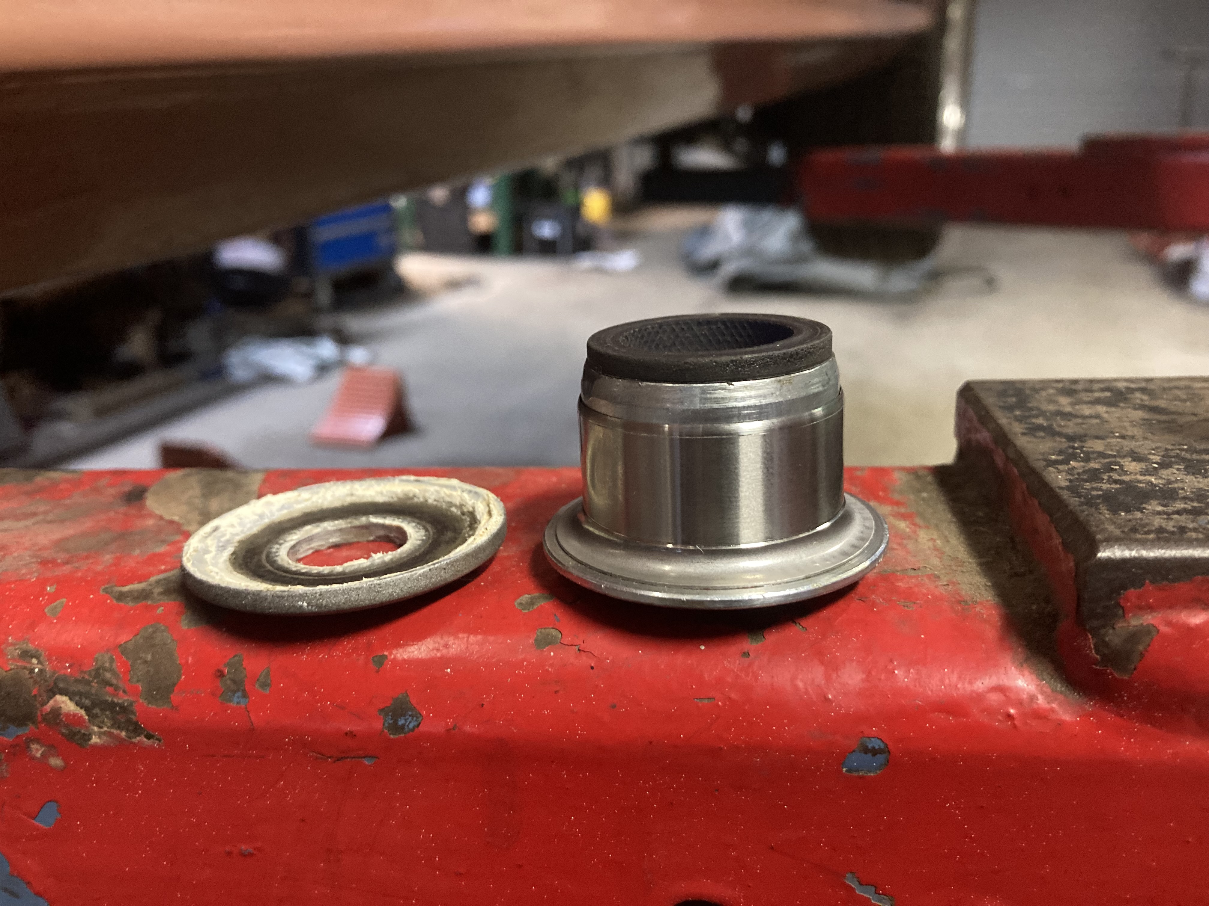

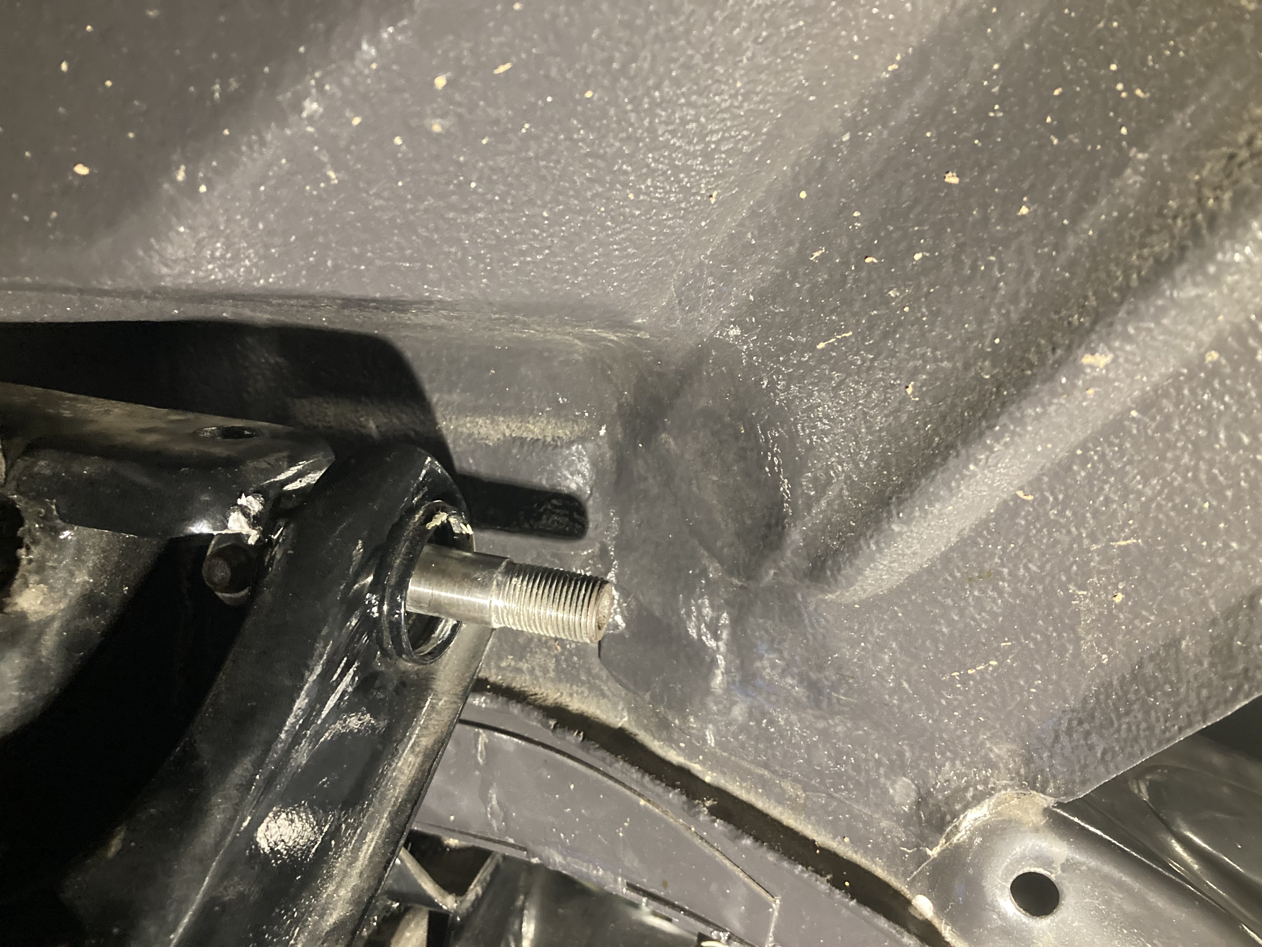

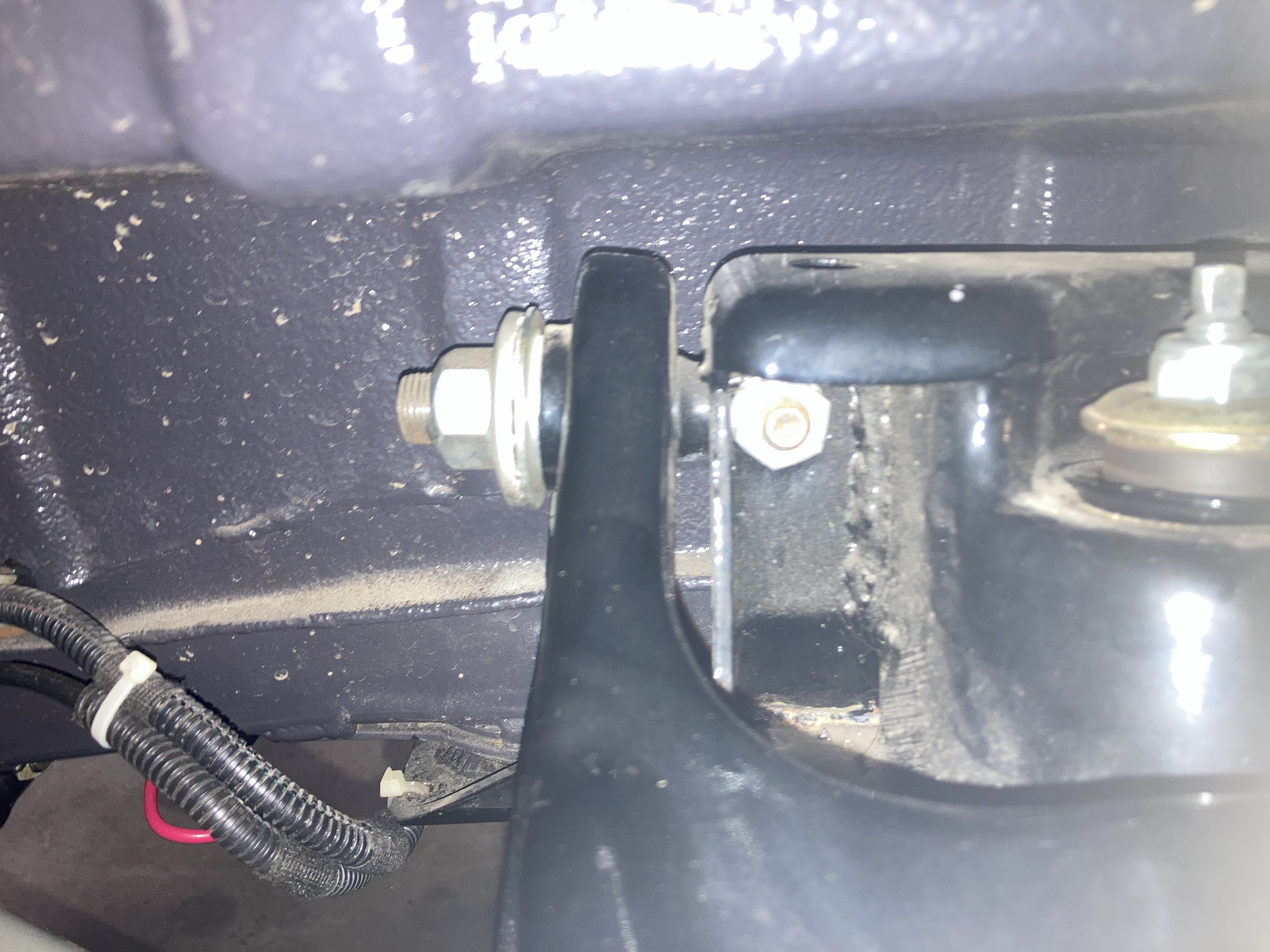

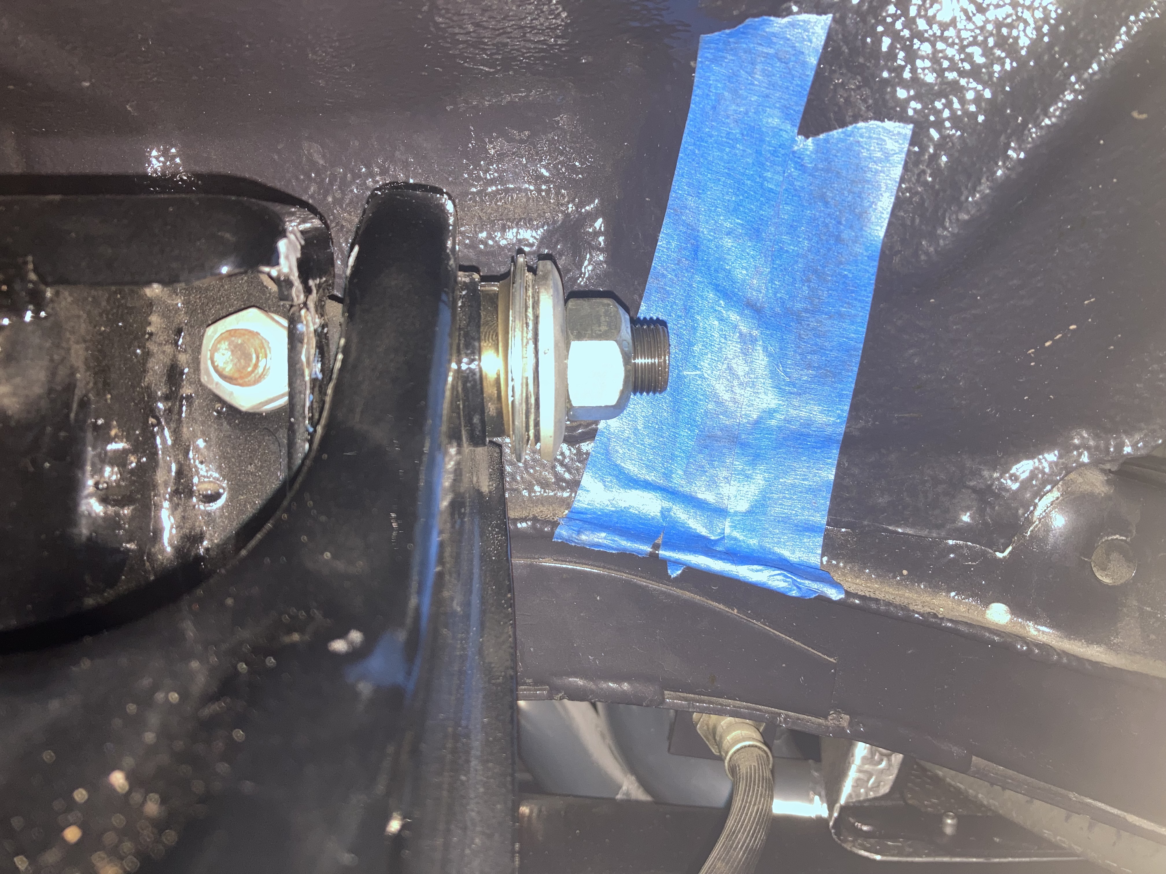

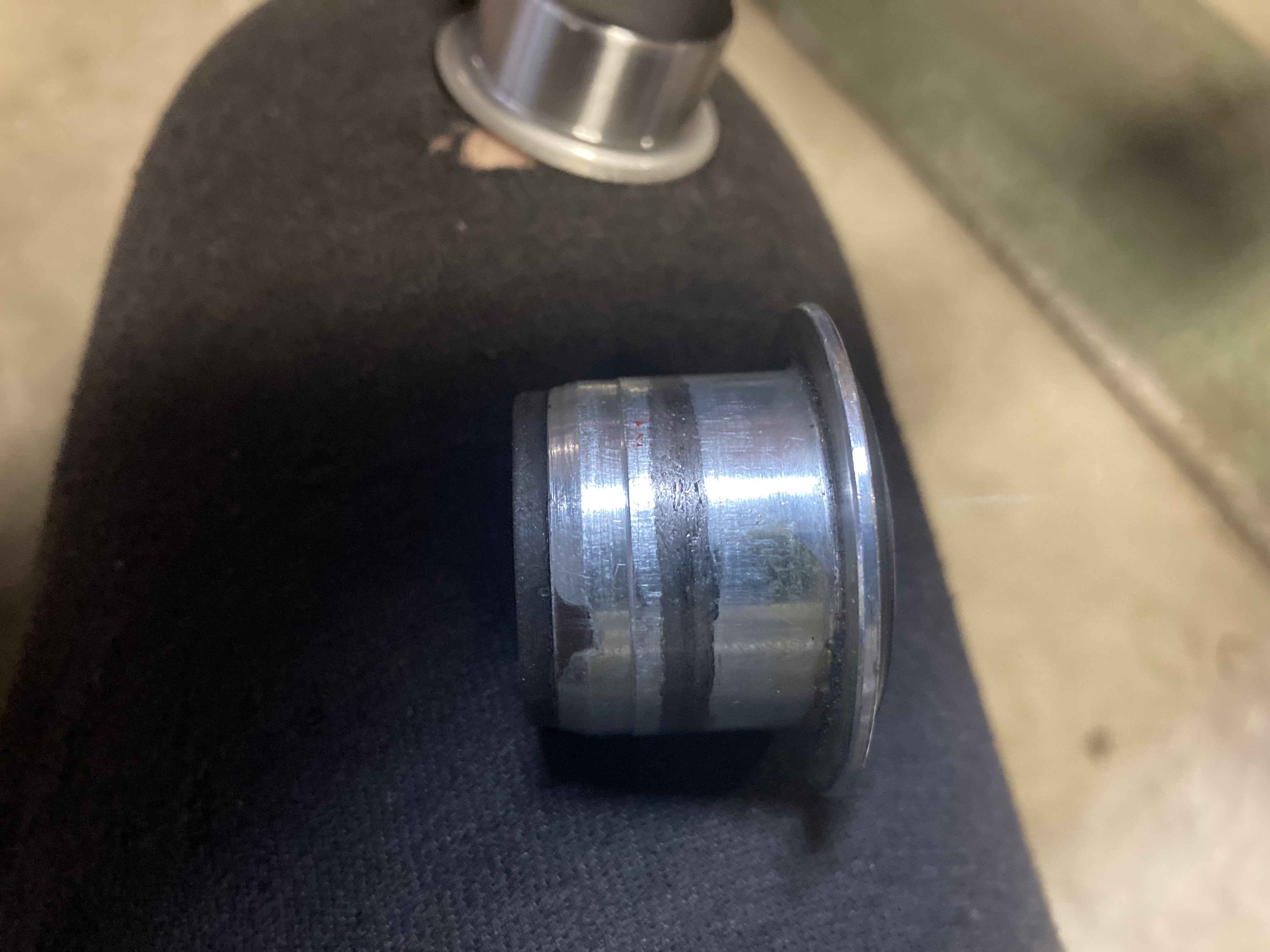

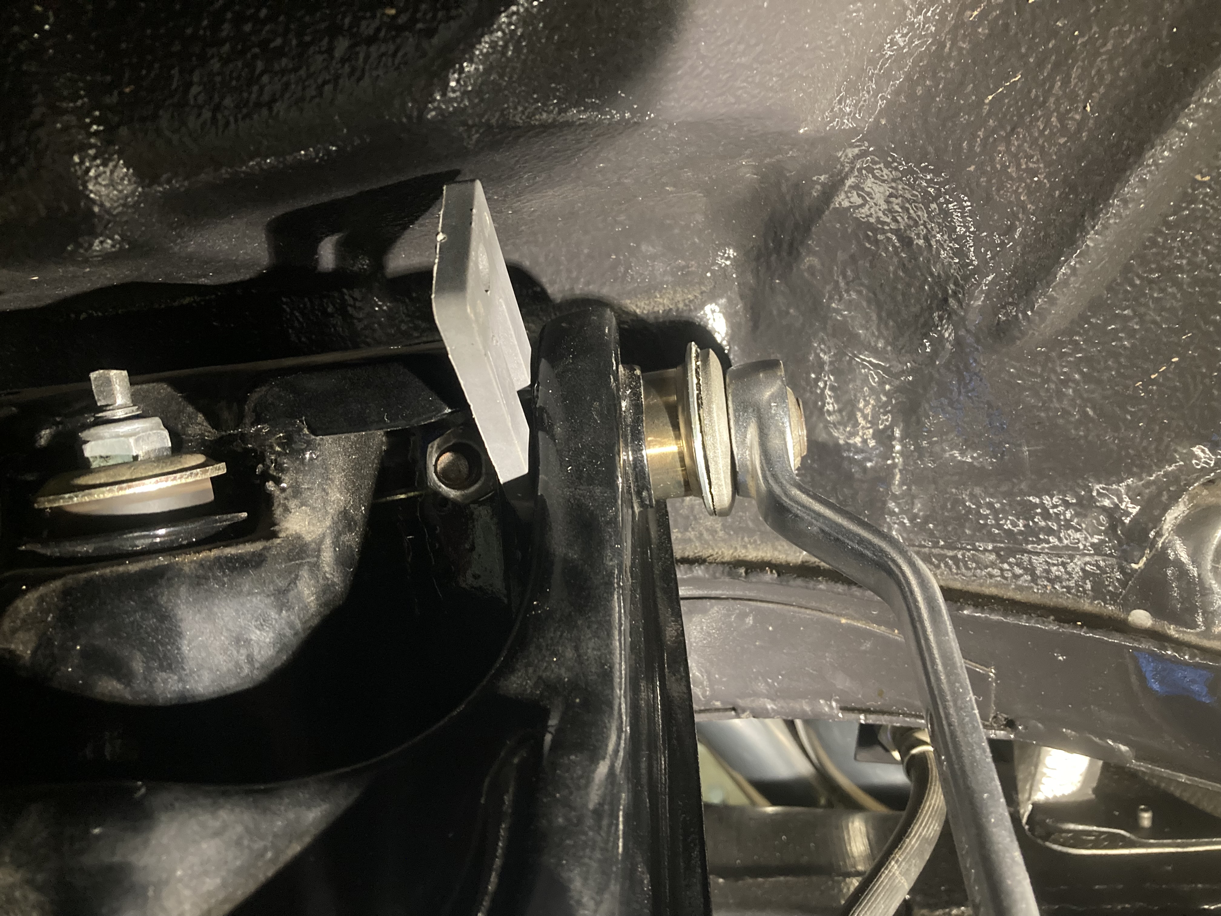

Whilst i was at it i looked for a squeek the front end had developed, this time not so easy the upper wishbone has worn away the so called pressed in bushes and moved across enough to rub on the crossmember, GRRRRRRR !
So a quick fix you say, no the whole front end has to come out to get the top wishbones out, guess what it aint going to happen soon.
I had a thought and here goes,
So a speedy sleeve might work as the bush just fell out, i have gotten this far but it appears the arm may be slightly out of shape and it wants to pull towards the shock tower, no use painting stuff when this happens, not happy Jan !
I stopped last night to re assess, i think i may have to re shape the arm somehow !!

No oversized bushes that i can find, would have been simpler !

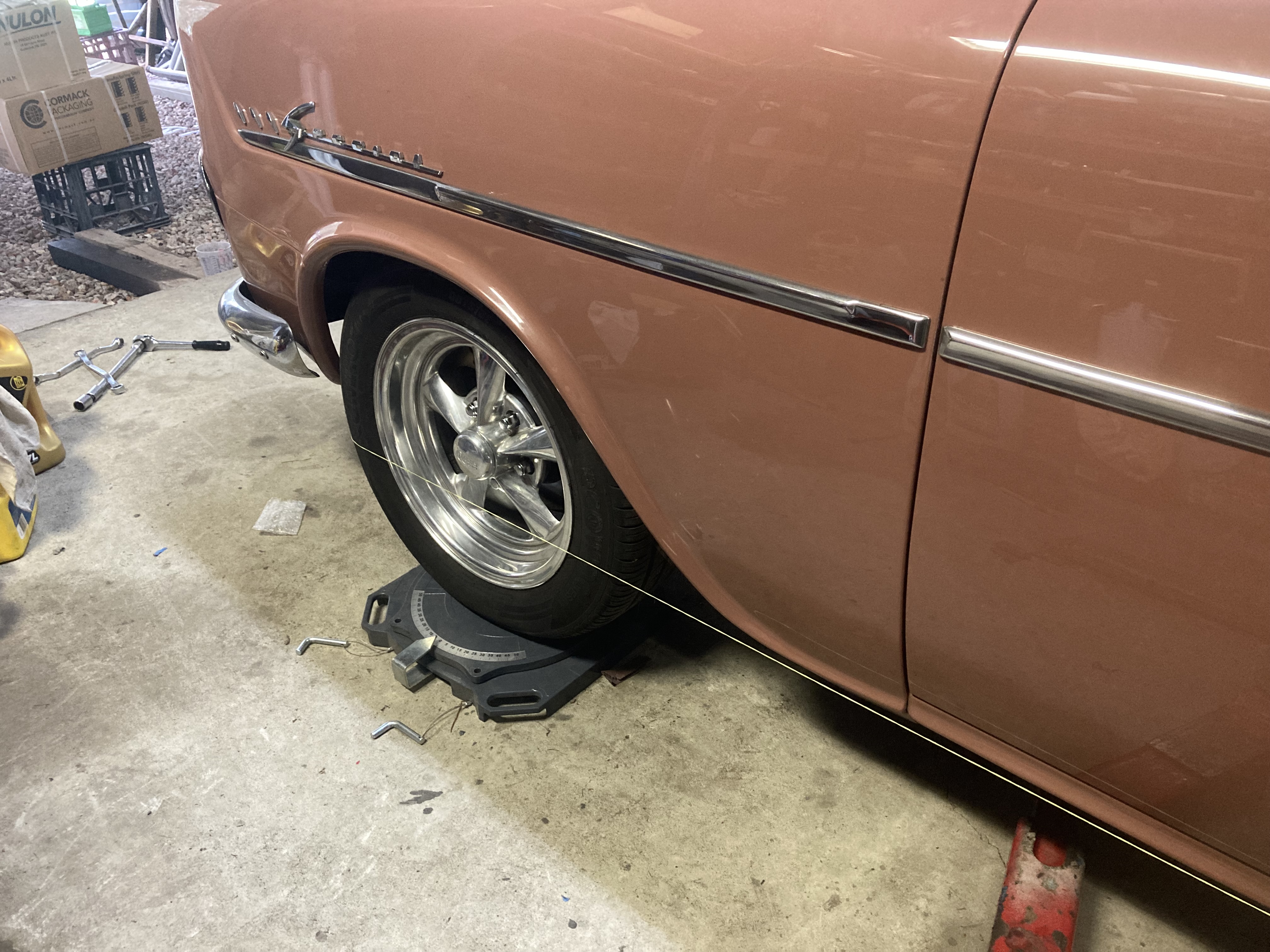

Anyway it worked out, i couldnt get the bush in as far as i liked but for now it will be ok. The Torana front is good and a nice ride but the issue is the alignment. There is no room to use spacers on the top arms unless you cut holes in the inner gaurds to get access.
To counteract that problem i have used offset bushes on the lower arms, to get the castor and camber right is fidly and the alignment gets knocked out after a couple of hundred kays.
I'm going to look into this with a bit more detail in the next few months, i may consider a custom front end, maybe.
Can't believe how dirty the under car gets in such a short time, oh and all the scratches are re painted as well.
A quick alignment again and back on the road, Got lots of other stuff to do in the next 3 weeks, busy busy busy !!
