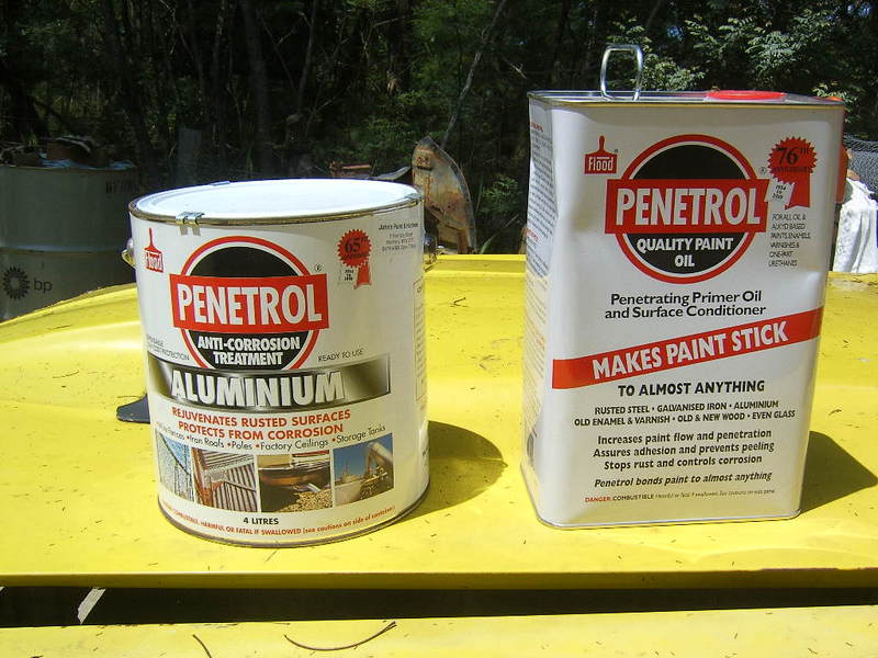

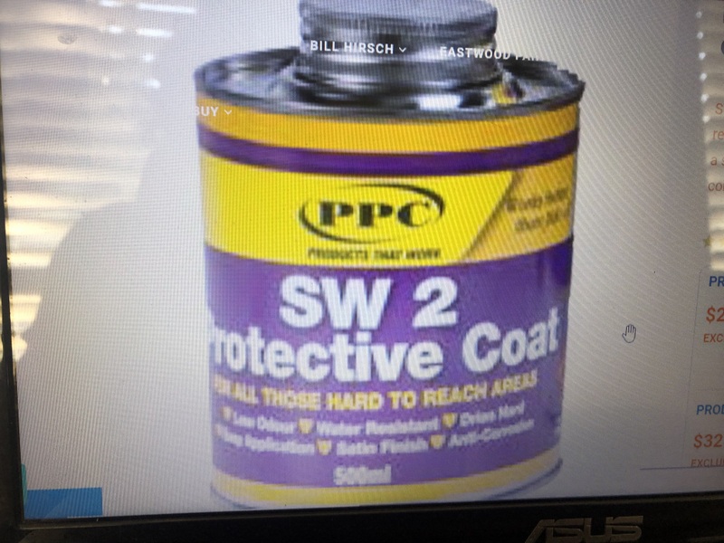

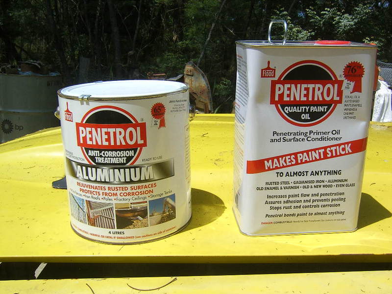

Posts: 2705
Hi Clay,
In the areas you cant see or reach I used the below products, Penetrol,then Penetrol aluminium then the PPC man made fishoil.
The penetrol products are oil based, the fishoil runs into every nook and cranny dries and is water resistant.
The areas such as under the roof I used a product called gravitex stone guard. It sticks real good and acts as a noise suppressor,
I also stuck dynamat to that and I am very confident it wont peel off flake etc.
