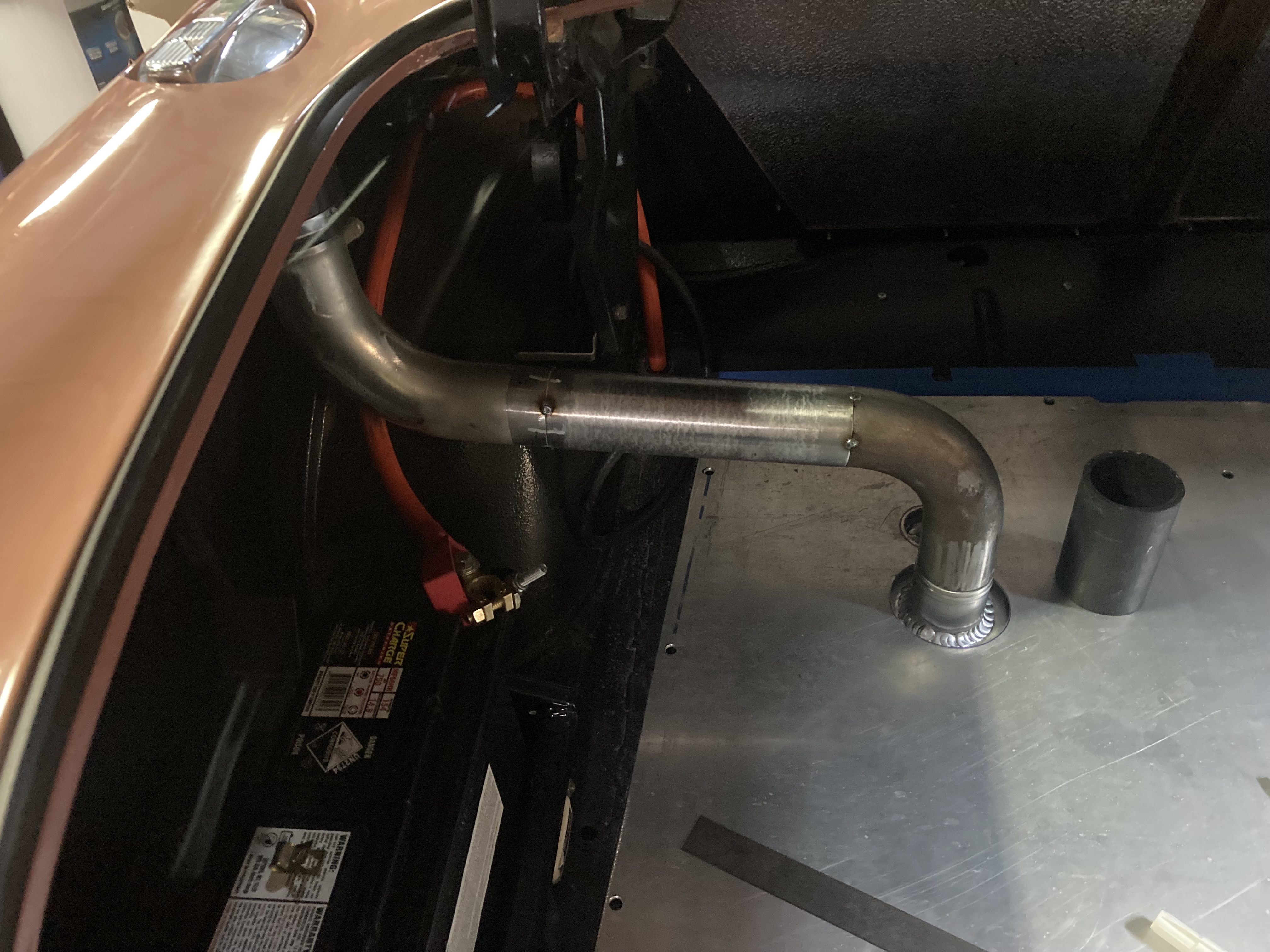

Made a new filler neck, its in your face a bit but I'll eventually box it in with an area either for some tools to sit or I may relocate the battery just behind it. Really no issue as the car wont see any big boot loads, not while i have it anyway !
Going to move the exhaust inbound and along the tank as well, spring hits them on big bumps, very annoying.
Raptor coated just to blend it in a little, subtle changes you see !!

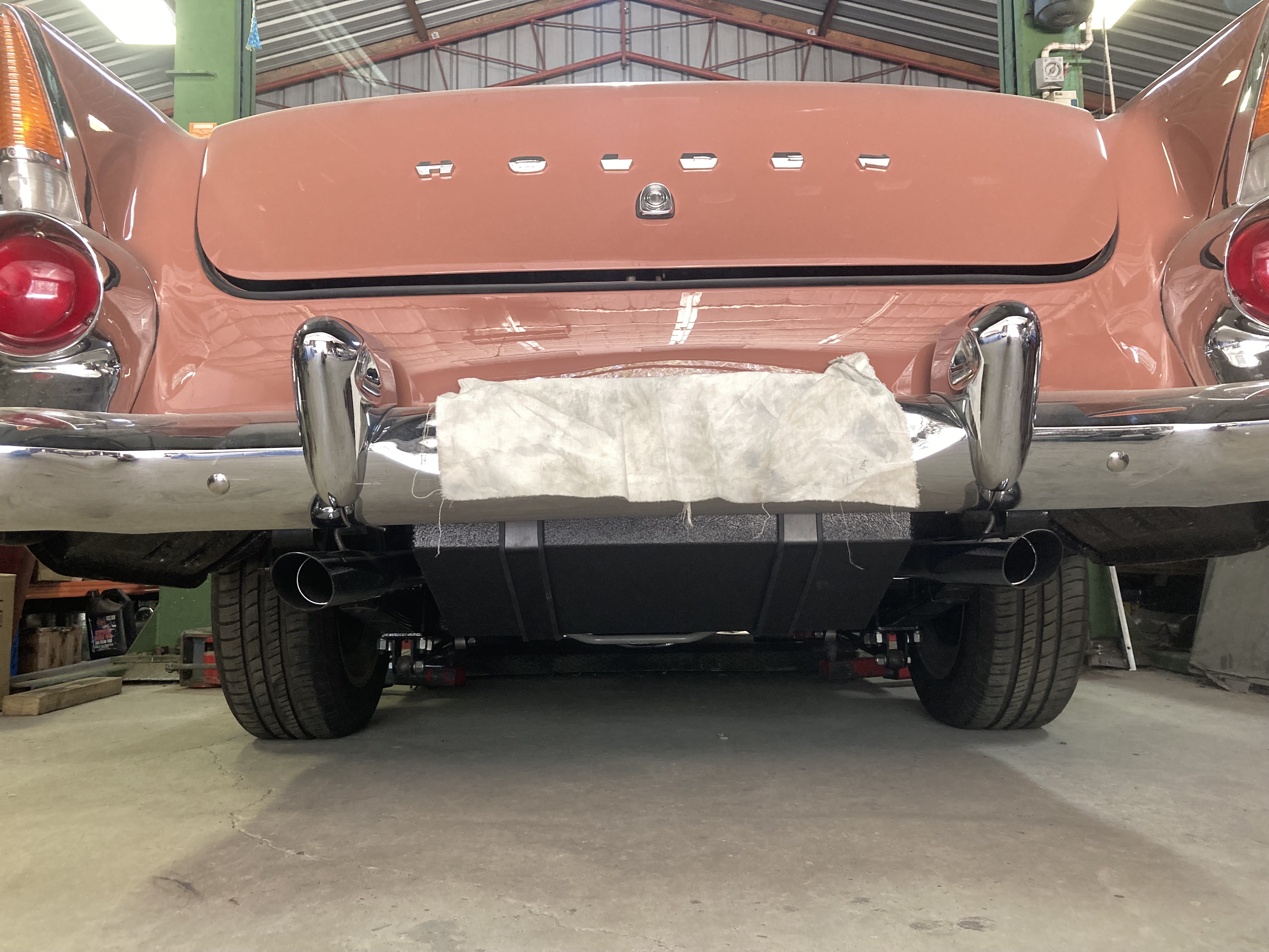

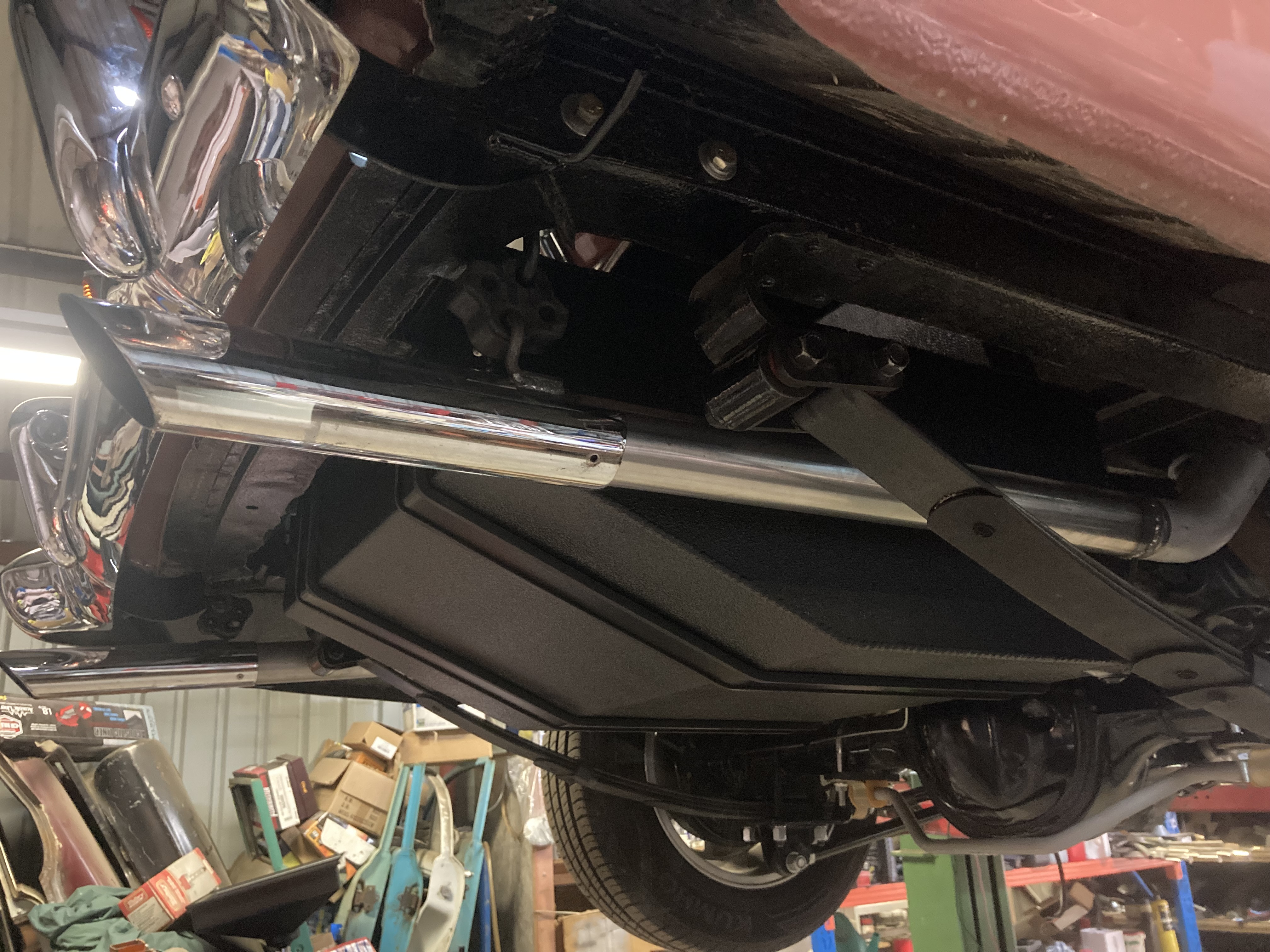

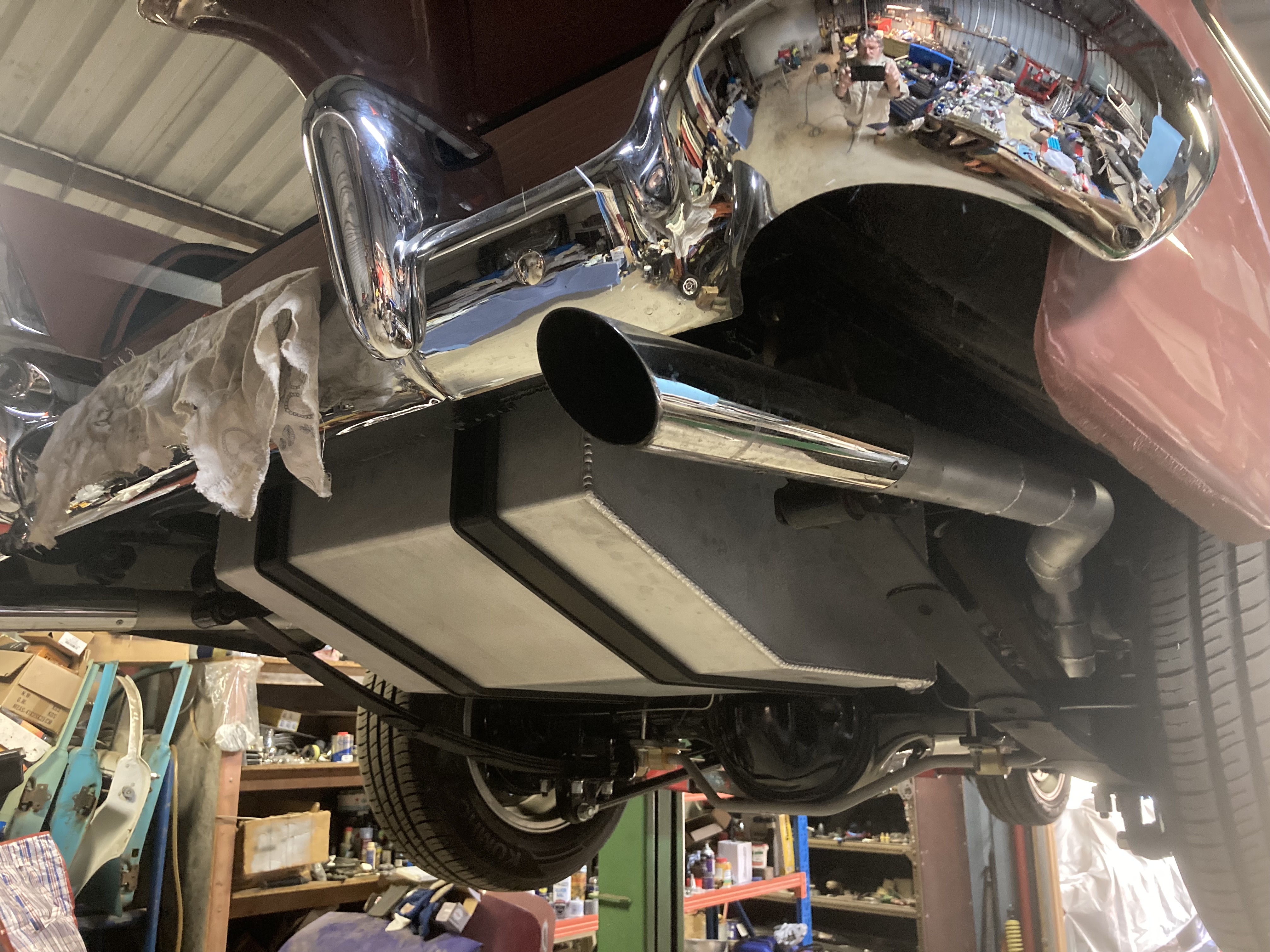

Bloody hell, i want to drive this thing !!
Tank in and the drivers side exhaust done, much better this way heaps of clearance and the springs can move freely without the clanging !!
I have to change a couple of fuel line fittings then wire the computer, dizzy and ignition up, all plug in but I want it neat so more time.
I'm gonna drive it a bit after these mods, no more for a while.

And you're going to relocate the passenger side pipe.....
Good work. Beats cutting rear quarters off an FB van.

Hi Greg are you going to have to wrap the pipe beside the fuel tank? how much heat do you get there?
Re: Chev EK
Posted: Tue Oct 10, 2023 7:05 pm
by EK283
Hi Neil,
No im not a fan of heat wrap, it attracts moisture and rusts your pipes quicker than you can imagine,
There is more than an inch between them, I will measure temps when i get it going,
Absolute worst case a heat shield but i doubt the temp at the tail pipes will be an issue.

Finished the tank,
Now for the fun part more wiring, i'll update that story in a day or two.

Top job Greg! I love the pipes exiting straight and inboard like that. Still room for the towbar mate??
Bet the right foot is getting itchy now...
