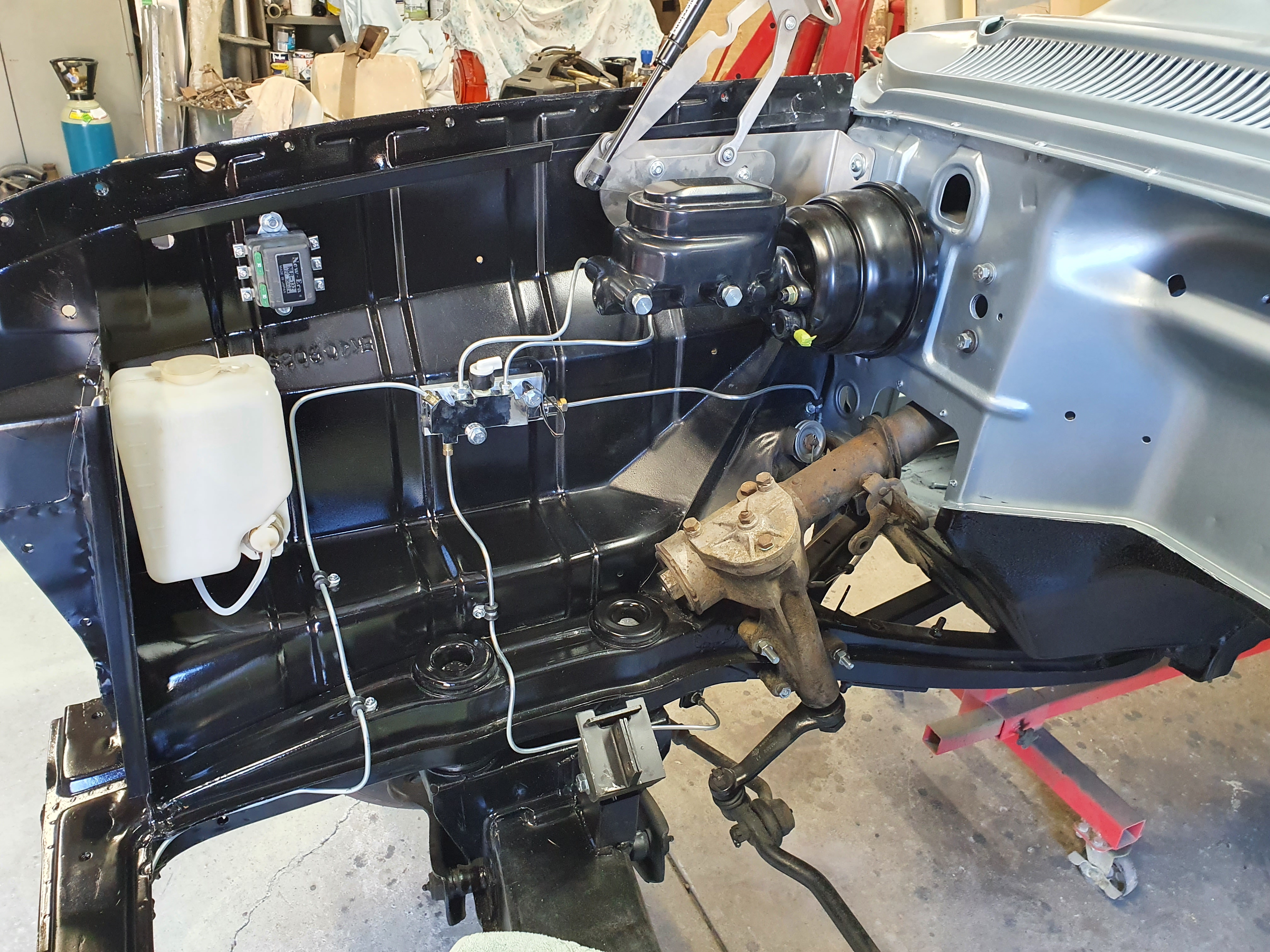

Bit of agricultural looking pipe work done.

Re: Project 2.
I wouldn't say that. Looks functional.

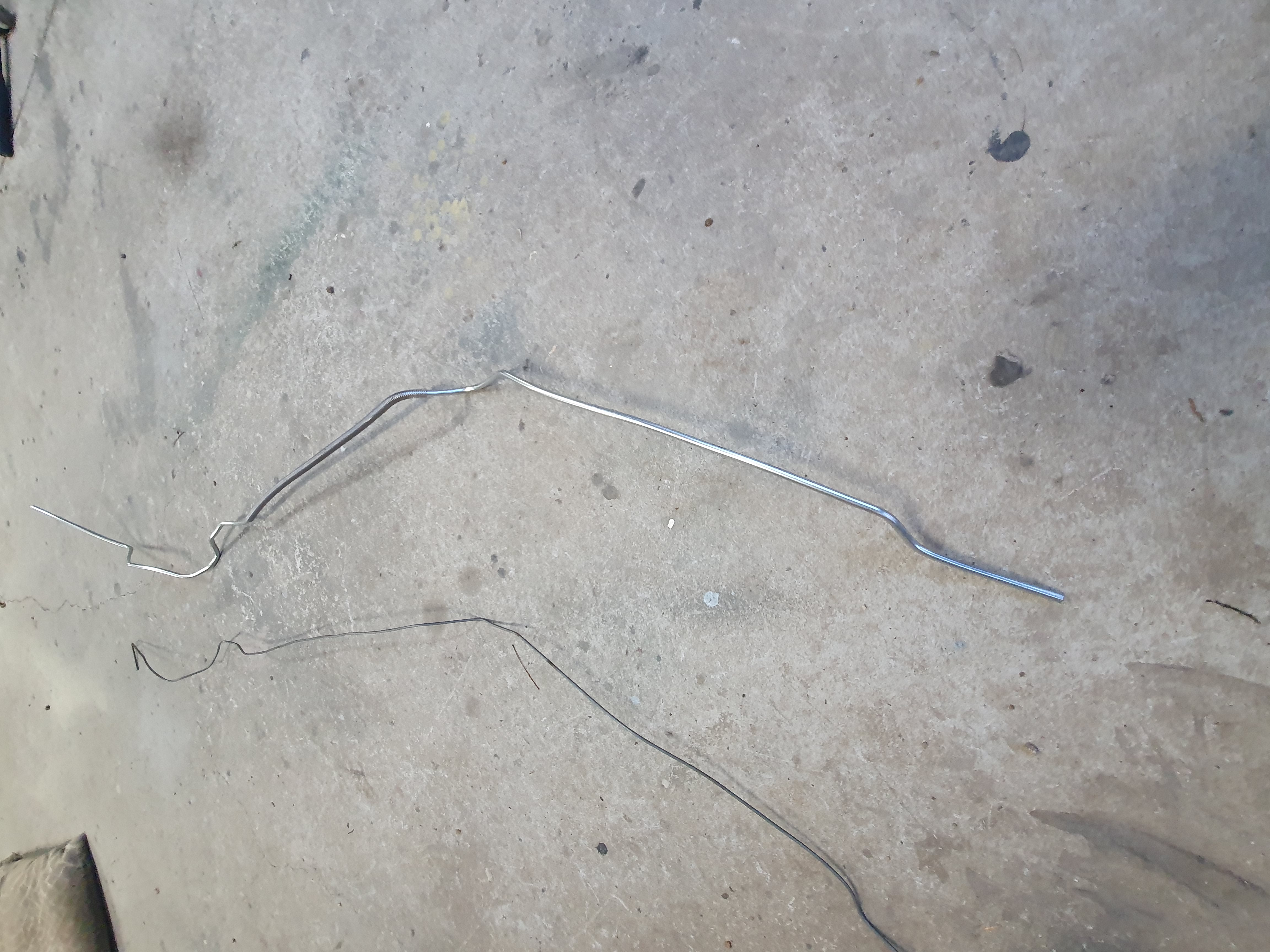

Fuel pipes today. Fiddly shapes on the front one (pictured)

Ok my three bobs worth on the rear fuel line section..
The last bend to the tank outlet I found tricky to line up. Next time I would try and start from that end, and don’t crimp it. You’ll need plenty of flow with those three great jugs guzzling away upfront.

Brake and fuel lines in place now. Waiting on a fuel pressure regulator from UK to finish. Aiming for 3-4 psi at float bowls. A cute little guage to go with it.
Returned the dummy engine block to Orange Betty (Dave) today. Put it in and out 7 times to get everything sorted. Tinleg (Sam) gave me a lift with it yesterday. Your help is much appreciated gents.
