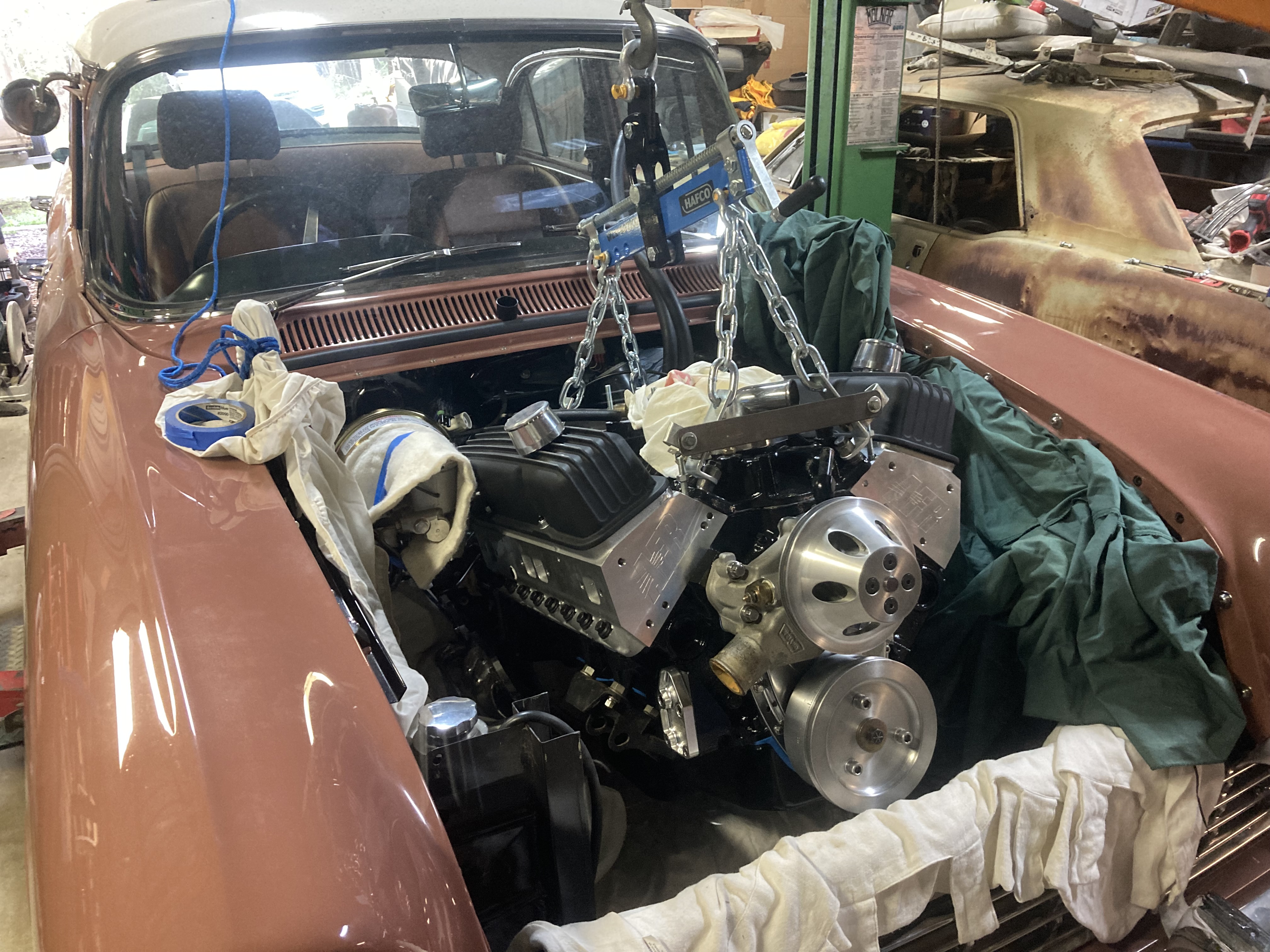

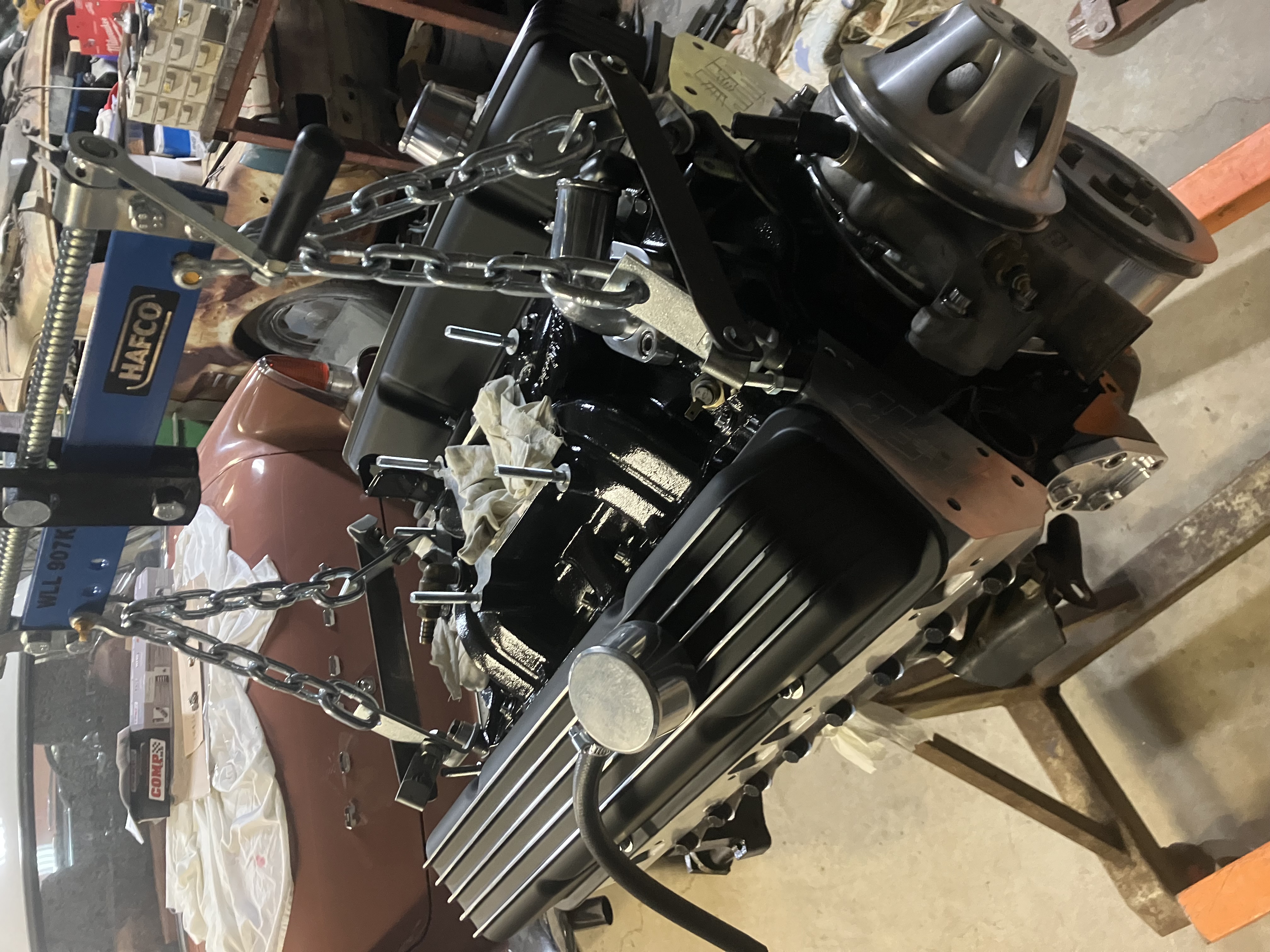

Slotting it in today !!!
New Rocket covers as well :wink34: :wink34:

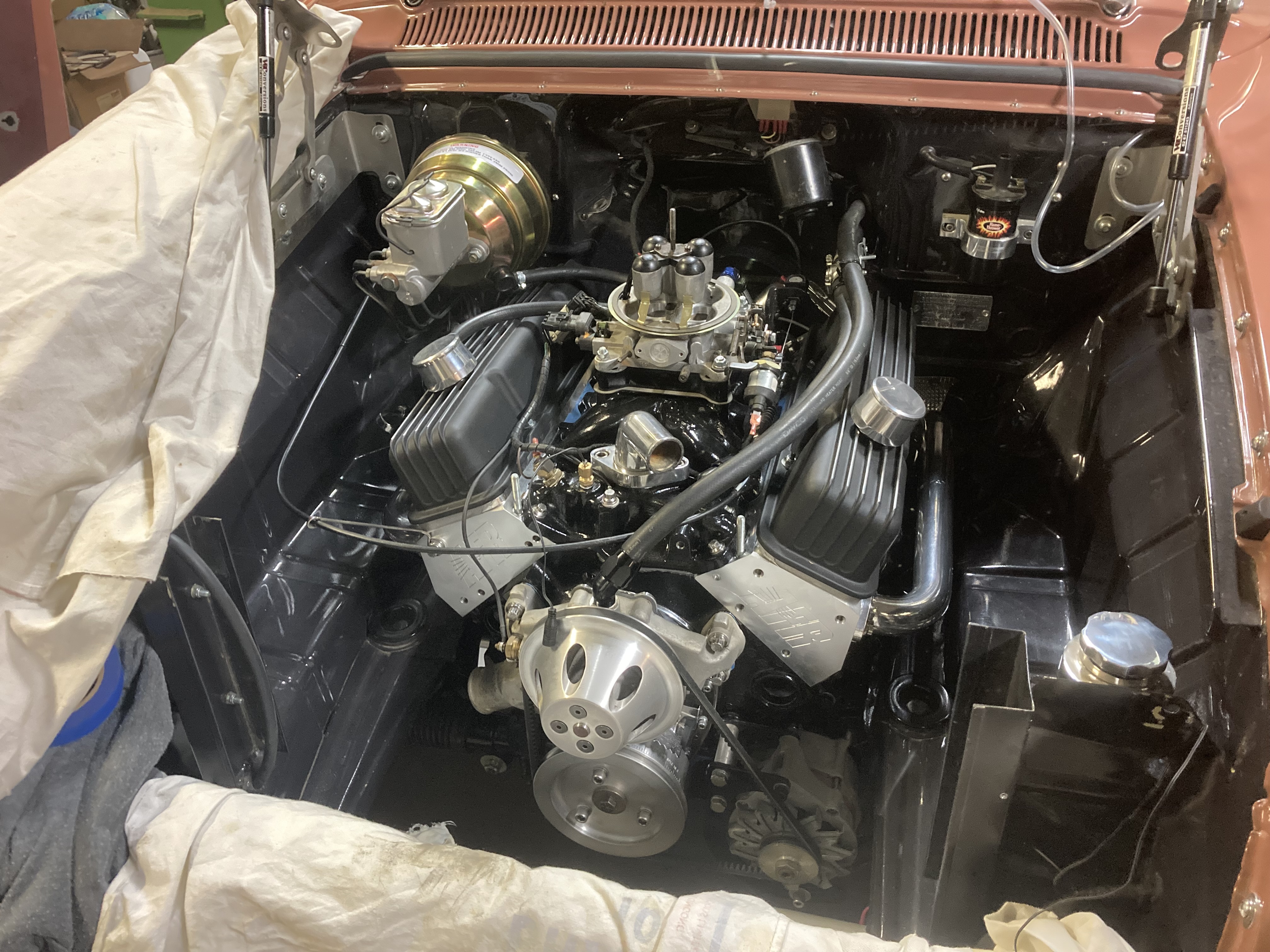

Blacky can you see this ?
The heart is back in !!!
Few anxious moments and yes I chipped the firewall paint with a stupid brain fade !!!!
Oh well brush repair it is.
Hook up all the stuff tomorrow, cant wait.
