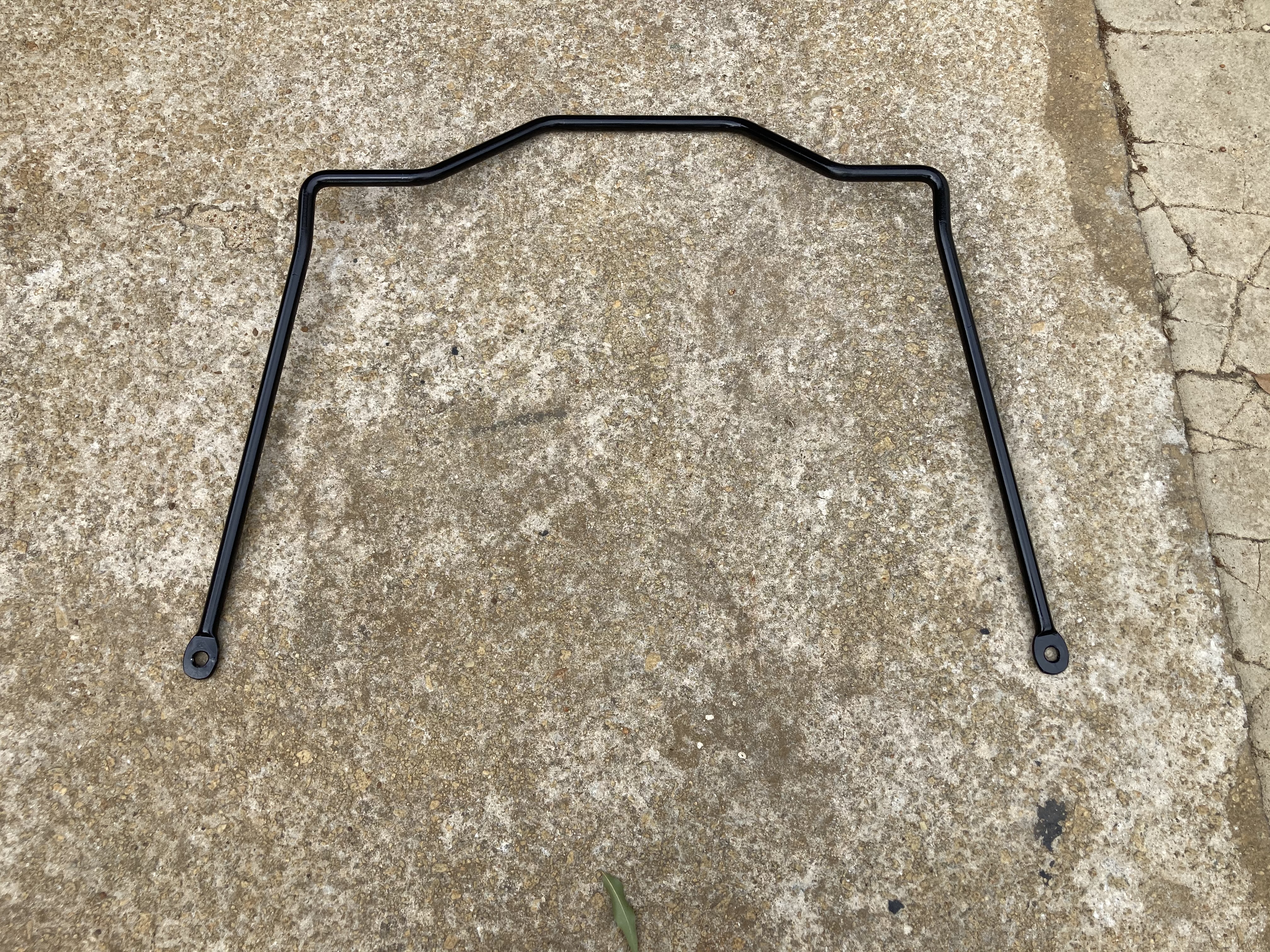

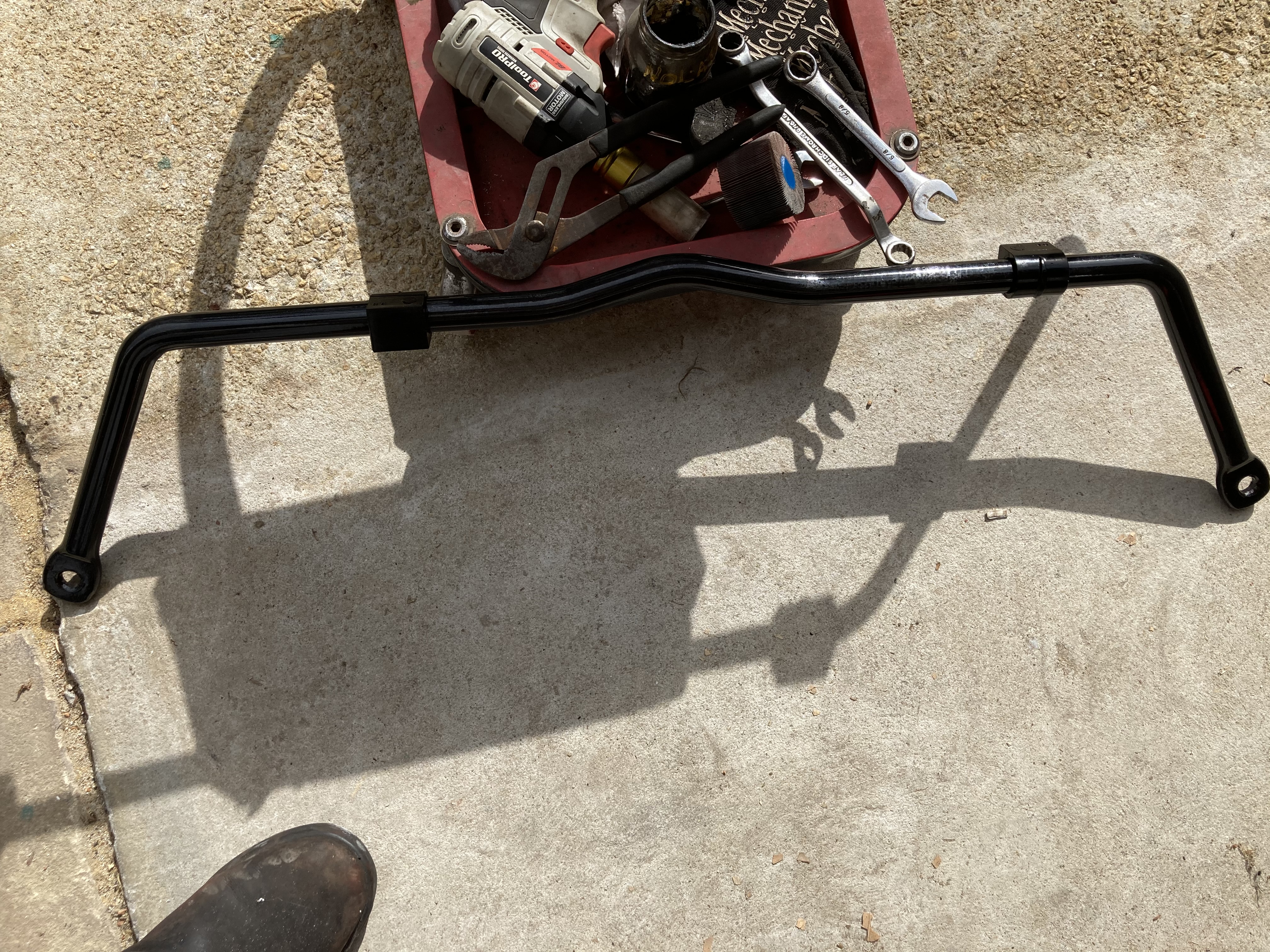

Received my new sway bars last week from Signature Sway Bars in Wollongong (Selby) they looked great and came with all the mounting gear.
Front one went in ok with a little pulling and pushing.
Unfortunately looks like I'm not going to be able to fit the rear bar, the commodore fuel tank is too wide if I try to face it to the rear and my muffler is in the way if I try to face it forward :crazy: :evil: :roll: will have to ponder what to do :shock:

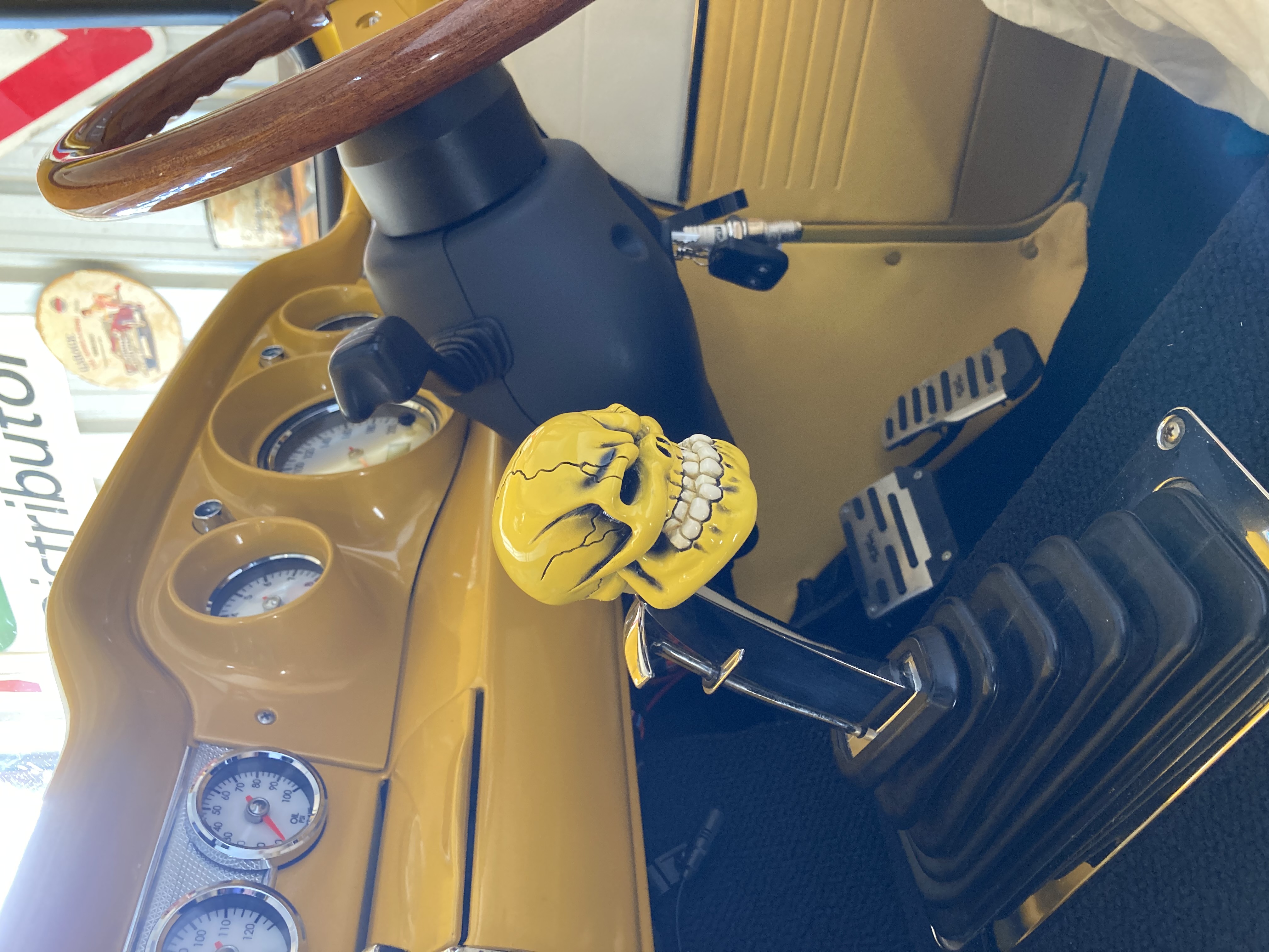

Also played around a little and fitted a new gear knob on the B&M Shifter

Neil,
I have one of those rear bars, but ended up fitting XK-XC Falcon bar per advice from Greg EK283. The one you have has quite long arms, which i believe are intended to mount to brackets located via the spring front bolts. Ideally, I think you would fabricate the exhaust after installing the rear bar, but these things don't always work out and I dare say you have spent a bit on a nice system. The bar I fitted is going to require exhaust mods as well due to position of the left hand body mount. Luckily I haven't splashed any cash on the exhaust yet. I will probably cut mine at the centre mount and stick it out the side for the time being.
Another thing about the long arms, obviously won't be as stiff as the shorter arms for the same diameter bar. If I find my setup too stiff i may try the other bar, or save it for the van. It was originally intended for an EH.
Clay

hi mate just looking at the pic of shifter and just wondering what speedo do you have ??
Re: Neils Frankenstein Ute
Posted: Tue May 18, 2021 9:43 am
by FireKraka
Hi Basic;
Mate the speedo and all of the gauges are from Speed Hut in the good ol US of A it is a GPS speedo have a look at their website they have a lot of styles and can customize not cheap but works and looks really good.
They are very thin so plenty of room behind.

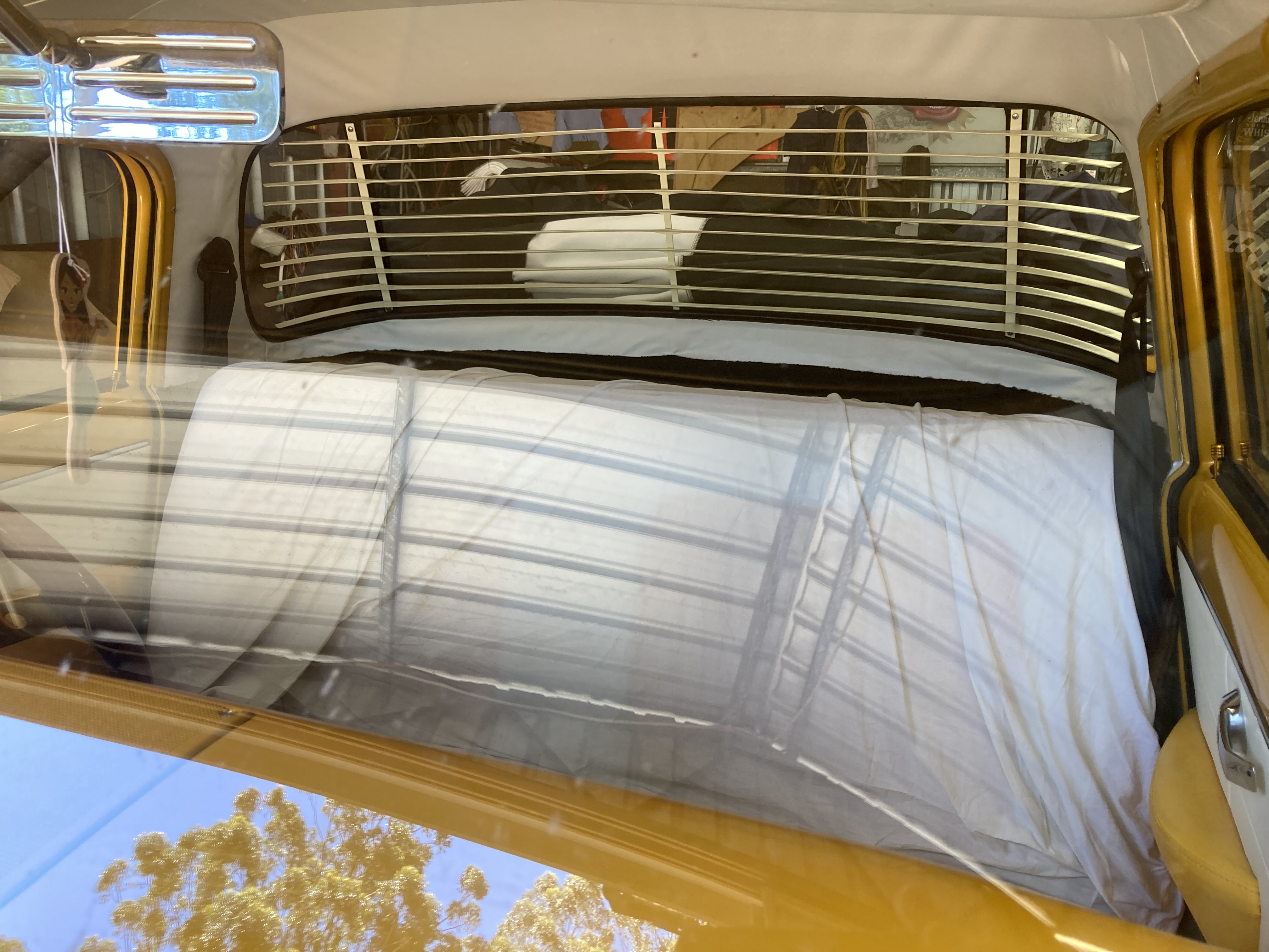

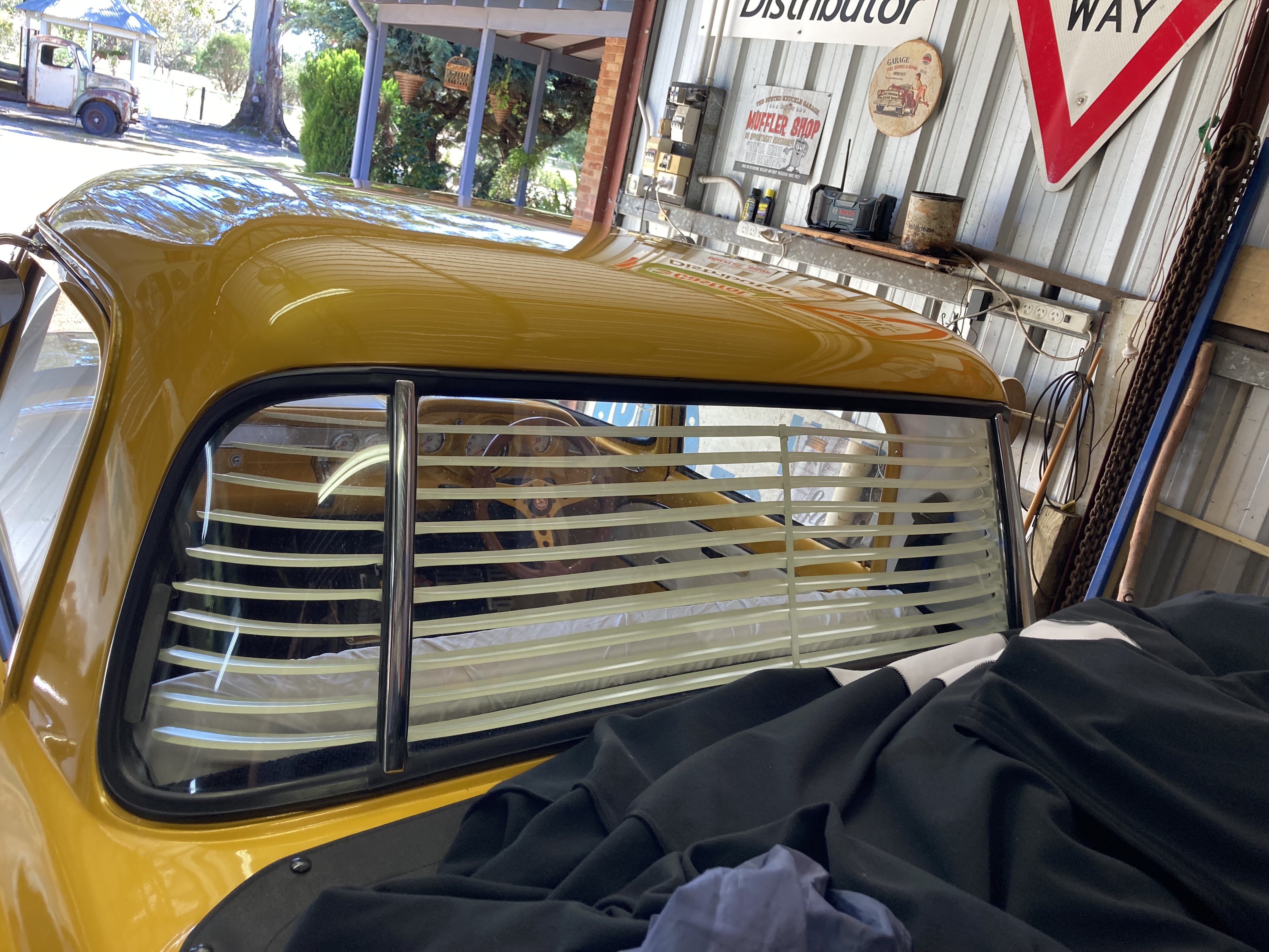

On the cosmetic side, you don't realize how close the back window is to you, when we had been out cruising the heat that comes through the back window was pretty intense so I bought an after market venetian and fitted it last weekend, I thought the quality was not bad, material is metal and fairly well built, funny thing is it doesn't mount by tabs that you slip into the rubbers like other ones I have seen but you have to drill holes in the window dividers and use screws.
Anyway it looks ok and will do the job.
