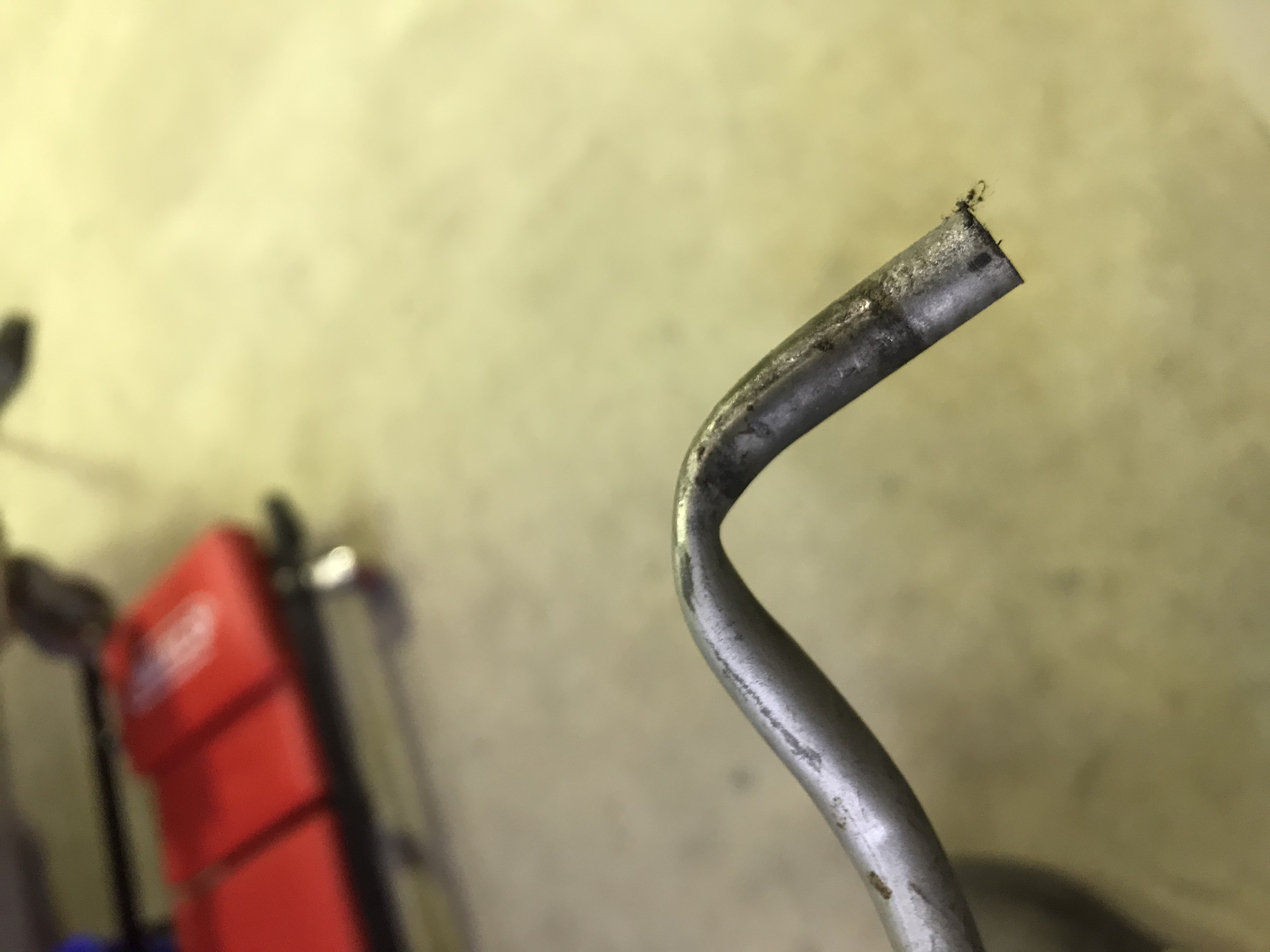

Second - When the gearbox was changing gears it felt like there was a fairly bad vibration when changing between gears and when I did get up to 80 or 90 it would start to lose revs and always wanted to kick back into second so #1 I adjusted the kickdown cable as per the book #2 I went looking at the gearbox oil lines up to the radiator and back and found that the return line to the box had a kink in it :eh: :crazy: :roll:
The pipe is only 5mm I.D. and the kink looks like it has almost completely closed the return off; I know nothing about the oil flow in these boxes but I cut the piece of pipe out and fitted a rubber hose section (for now) and Robyn and I took Frank to a show with the club that afternoon and the gearchanges were heaps smoother and the box did not try to kick back all the time and obviously my fuel consumption has improved.

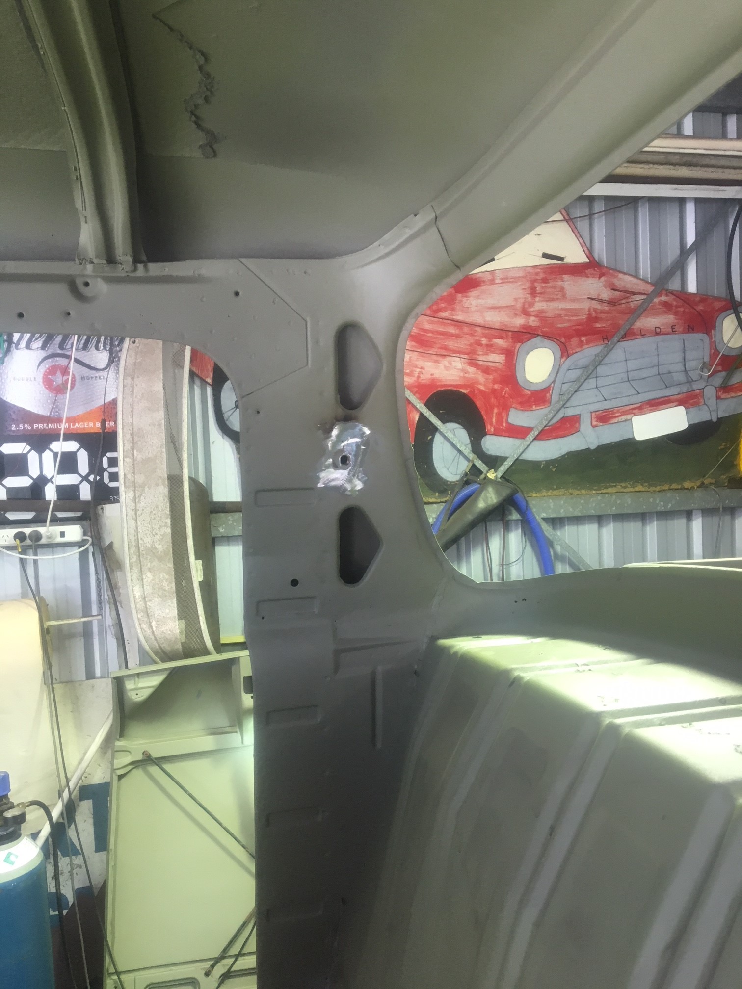

No lastly and this was the one that was $*#@ with my head - I had noticed that when I was driving if I put the windows down even the tiniest bit that the headlining would start to suck down, if I put the windows up it would go back up what the $*#@ :crazy: :crazy:
For the life of me I couldn't find out why it was doing this and then the other morning as I was dozing in bed the light went on :lol:
I remembered when I was fitting the shoulder seat belt doubler plates that when I tried to slip the first one down the B pillar from the top triangle cut out (Utes have 2 in the B Pillar)
I couldn't get the plate to slide down, I pushed up from the bottom and found that there was a large piece of foam in-between the cutouts on both sides so being a dick and not thinking of why it was there I didn't put it back :crazy: turns out that Holden put it there for exactly the reason and problem I was now suffering so I took the seat belt bolt out and put some rapid expanding foam in through the seat belt bolt hole and low and behold it solved the problem drove it that afternoon and the headlining stayed where it was supposed to :clap: :clap:

You've just cleared up a mystery for me: why the FC I'm fixing up has cotton waste or hessian/coconut underlay wadded into the C-pillars. I pulled it out on one side. I'll now put it back.

Good sleuthing. I too pulled the cotton wadding out of Grace’s B-pillars... couldn’t understand why GMH had put it in.
