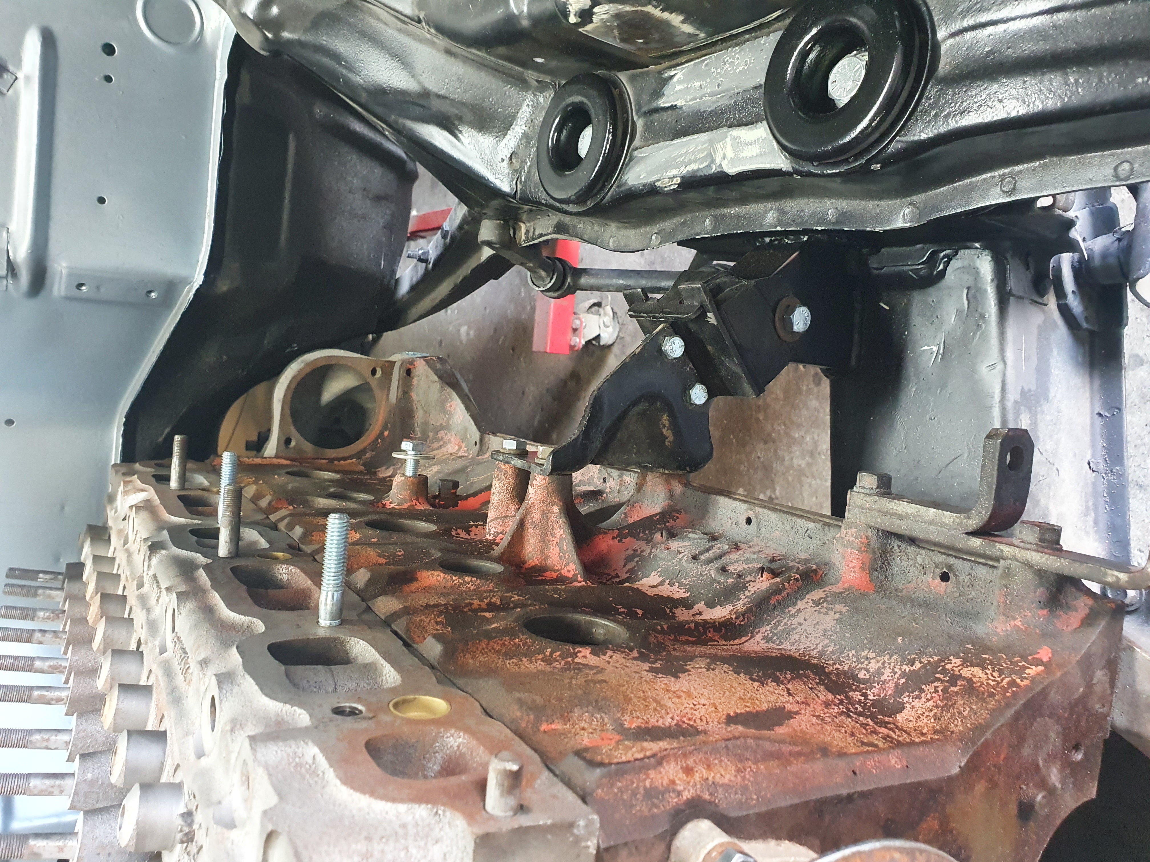

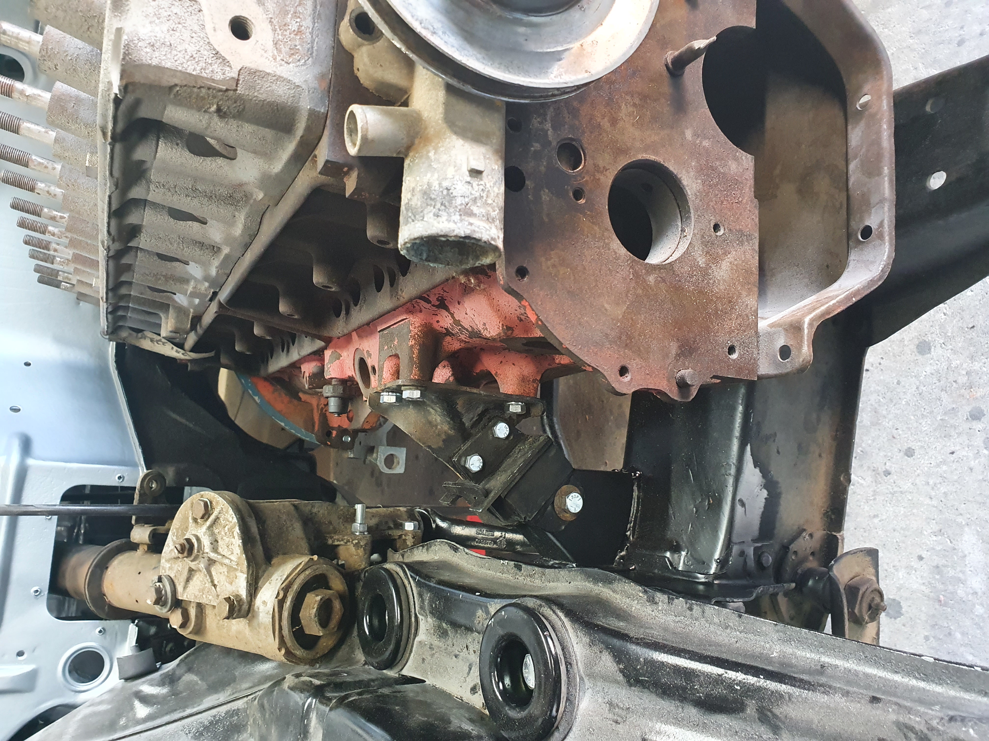

Bungendore Hot Rod Builds has made modifications to the mounting point today to raise the gearbox 12mm and move forward mount 10mm also. CRS crossmember was not quite right for my mods, but more about my placement of the engine mounts. Steering misses sump on full locks so happy camper.

Good solution if you have room to clear tunnel, as it should also improve the driveline angles, specifically if you are lowering the rear. Lowering rear leaf springs by re-setting flatter tends to point the pinion flange down relative to stock height. Lifting the rear mount will help compensate by pointing output shaft up slightly.

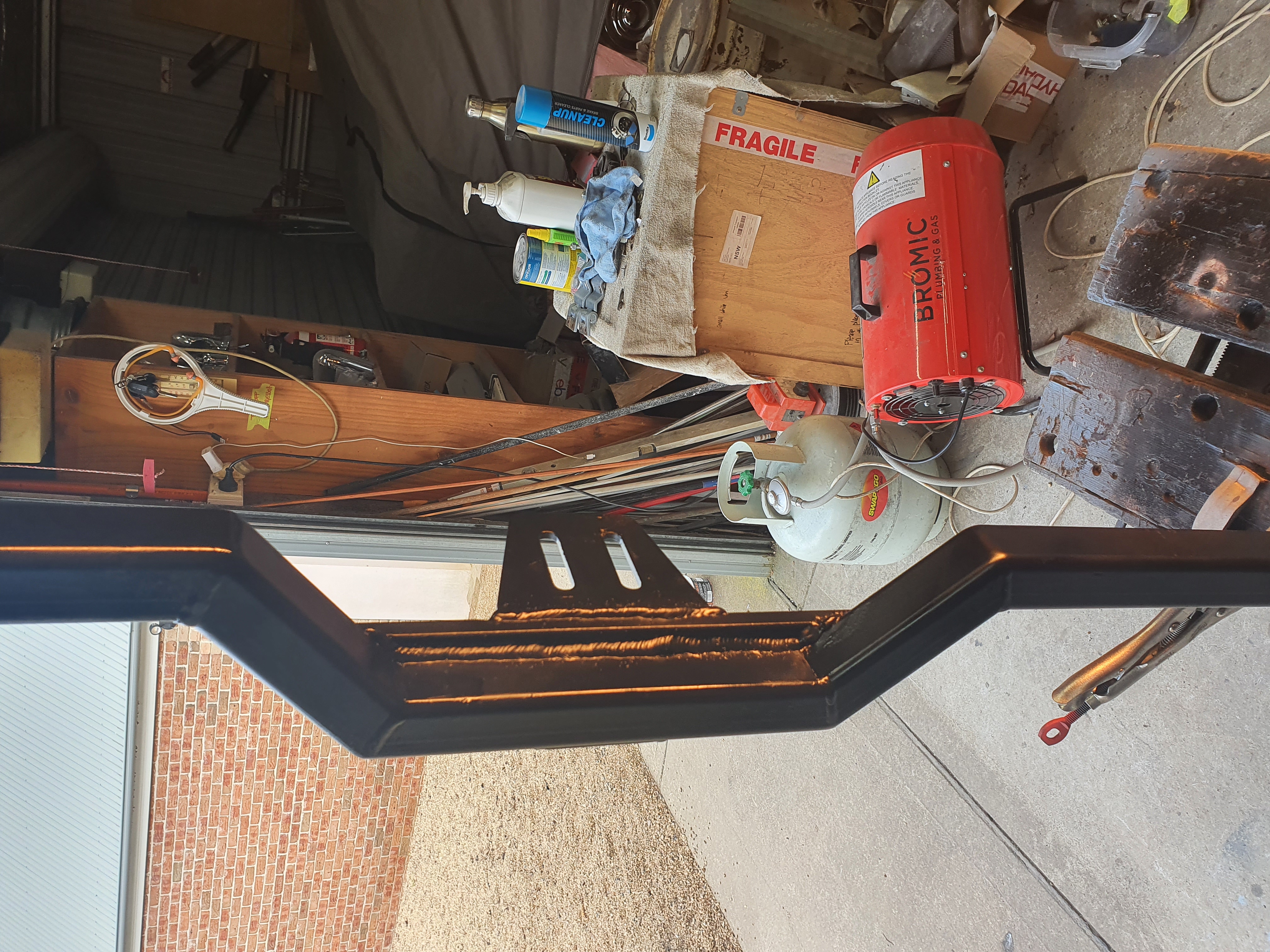

Well, the answer to the positioning of rubber mounts to engine question is pretty clear. If the crossmember mount brackets are welded in the same place on each side, the engine will skew to the drivers side with the rubber mounts both bolted to the front or back. If the drivers is behind and the passenger side in front the engine sits square to the firewall.
Some pics of space etc.

Re: Project 2.
Whatever you do , make sure you keep track of what mounts and brackets you use, I dummied up the rattler with the old motor and when I went to fit the new one it was miles out
, had to root around for ages finding the right sized brackets to get it back to where it needed to be .....
Re: Project 2.
From memory Blacky it is easiest to install motor with only the engine plates on and the rubber mounts in place. So all I have to do is keep track of the engine plates- which is within my capabilities still

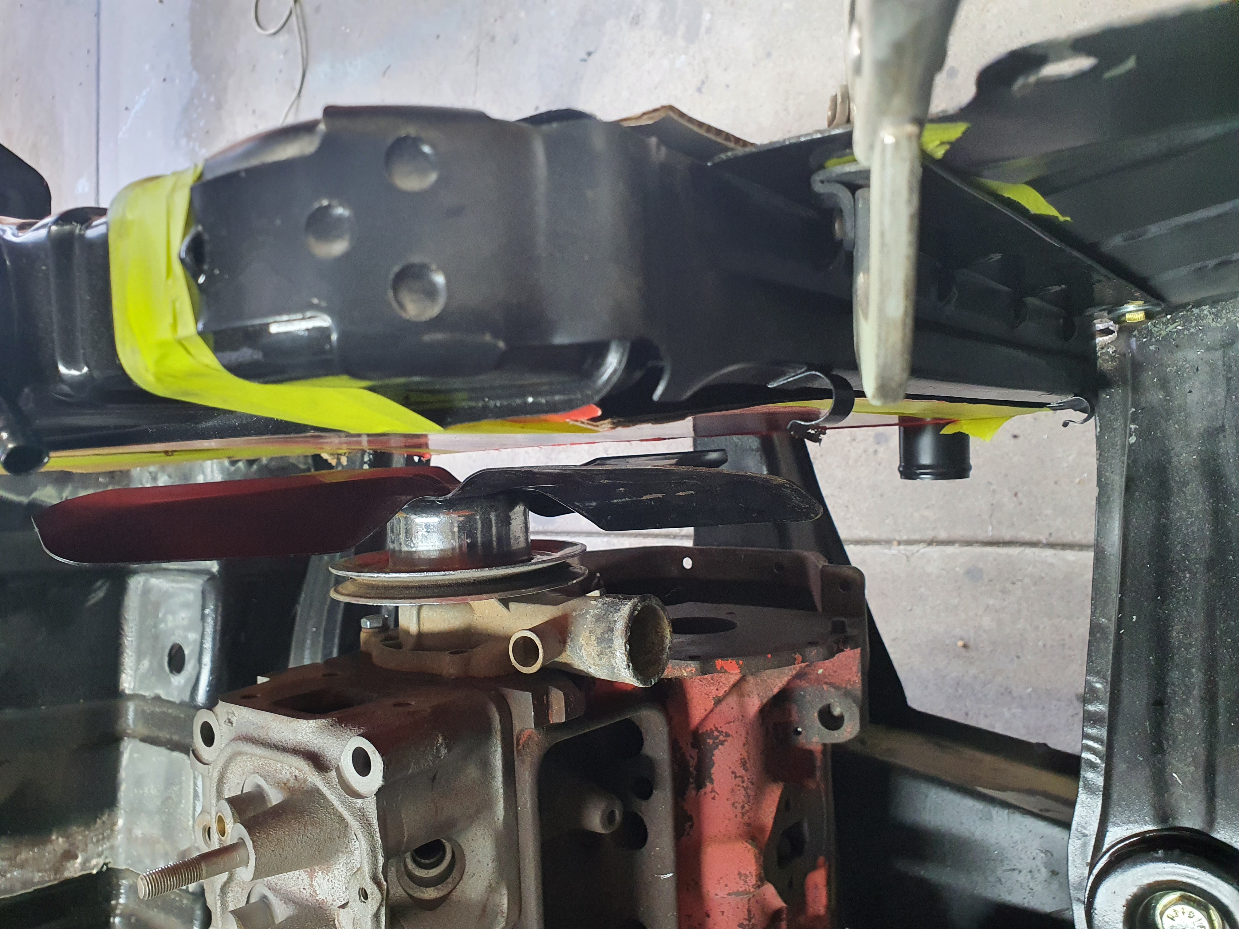

Mucking around with radiator today. Slight changes to top guard brace to allow core to move in about 10mm. Similar mods to kframe around radiator bottom. Have ended up with a reasonable clearance from fan. Some finessing yet to do but basic plan is there.
Motor is still lifting up at front quite a bit. Really noticeable when the fan is in place with rad on. Can anyone enlighten me on how much (if any) a red motor kicks up at the front from level?

Re: Project 2.
5degrees I reckon. As a guide you can bolt on the 186S manifold. Carb flange should be level.
Re: Project 2.
By your photo, relative to the radiator, mine has a bit less slope although still some. Would be nice if you could bring the rear up and/ or slightly lower the front. Balance up the clearances with a bit of shimming and slotting and will be good.
Re: Project 2.
Put the manifold on this morning and low and behold its got a very slight slope the other way. About a width of a piece of paper brings the bubble level, so I'm thinking I'll leave it where it is. Happy days. Thanks Clay.
Re: Project 2.
You could see if you can get the bottom of the radiator a bit further forward I suppose.
