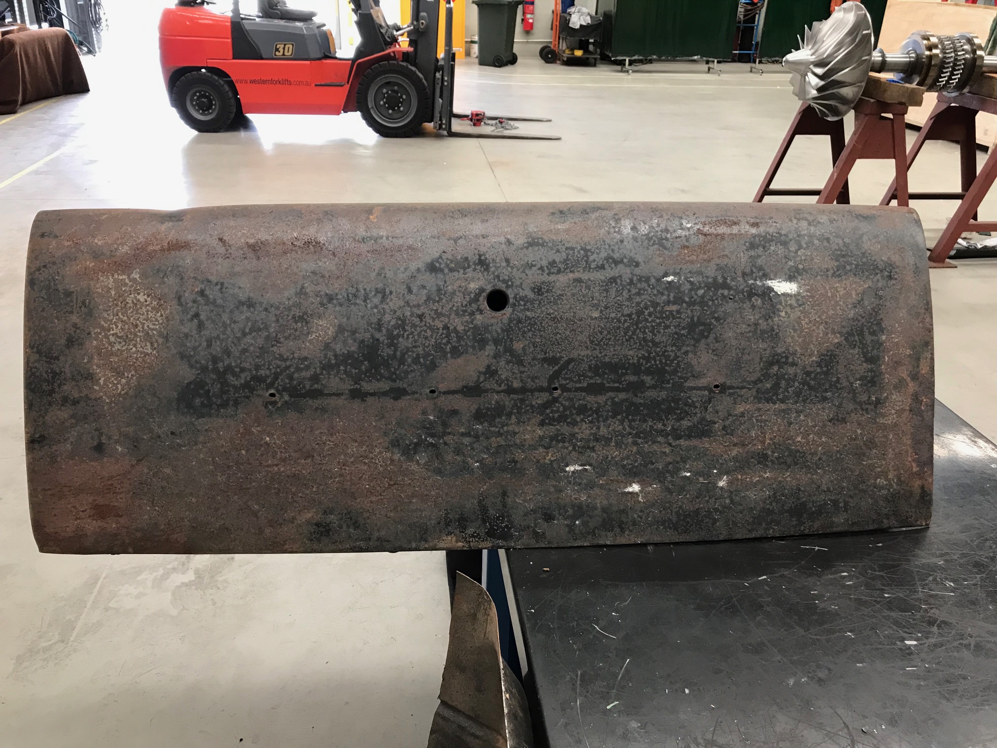

Bit more on the tailgate
ImageAfter wire wheel and soaking in citric some more. Gave it a blast in the car port. Just like a dry windy day st the beach really. Image
I used my $30 blasting gun from Adelaide Tools and $3 worth of dried sand.

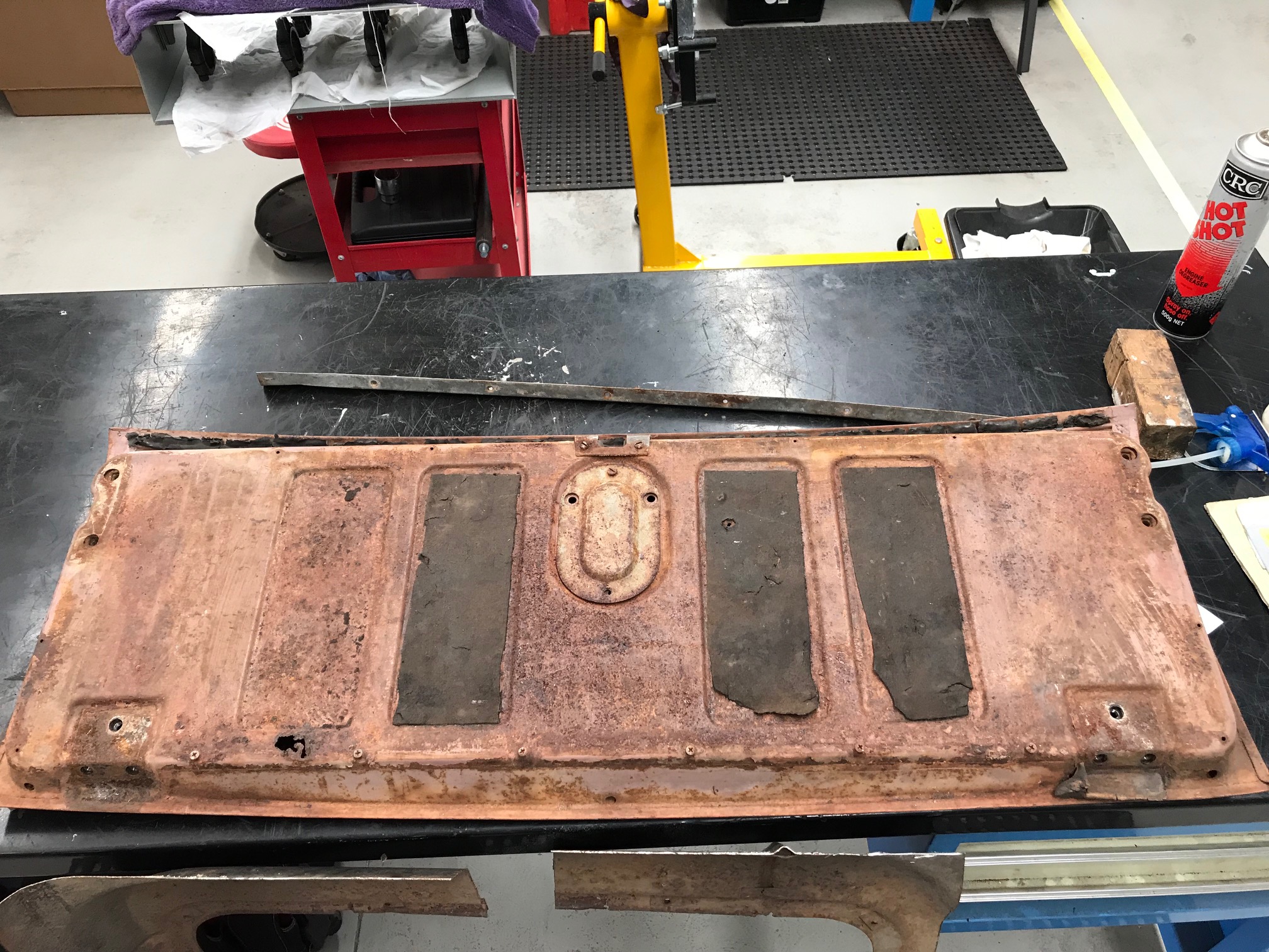

I’m lucky I have the van tailgate as a template as this one although rust free is pretty beaten up. I have it all fairly flat now but noticed that the van one has a fold near the top which seems to be all but bashed flat on this one.

Hi Clay excuse my ignorance but isn't the van one like the station wagon which would make it a bit different to the ute ???? I just received an almost perfect station wagon tailgate thanks to Trev in Wonthaggi and looking at it, it is quite different looks to have more cuve to the skin has a piece at the top for the seal to glue to and the inner shape of the frame is different and the top of the skin rolled over further but as I said I have not seen a van one to be able to compare.
Photos of the station wagon tailgate I would be interested to learn the differences.
Posted: Fri Sep 27, 2019 11:33 am
Neil the van tailgates are identical to ute and nothing like the wagon. This applies to FB EK. FE FC will be a different story as the vans are more like a two door wagon.
Posted: Fri Sep 27, 2019 12:47 pm
by FireKraka
Cheers Clay good to know
