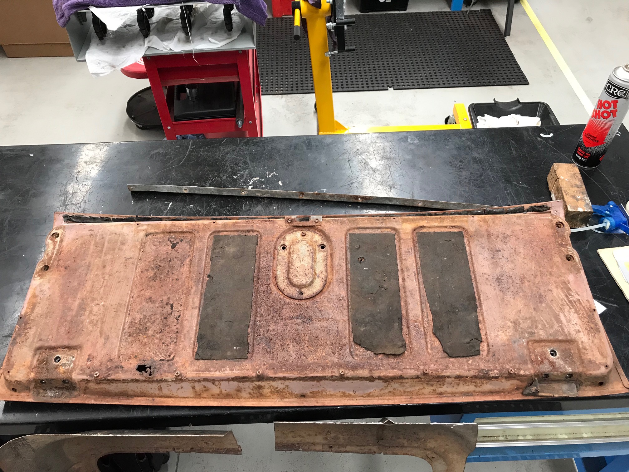

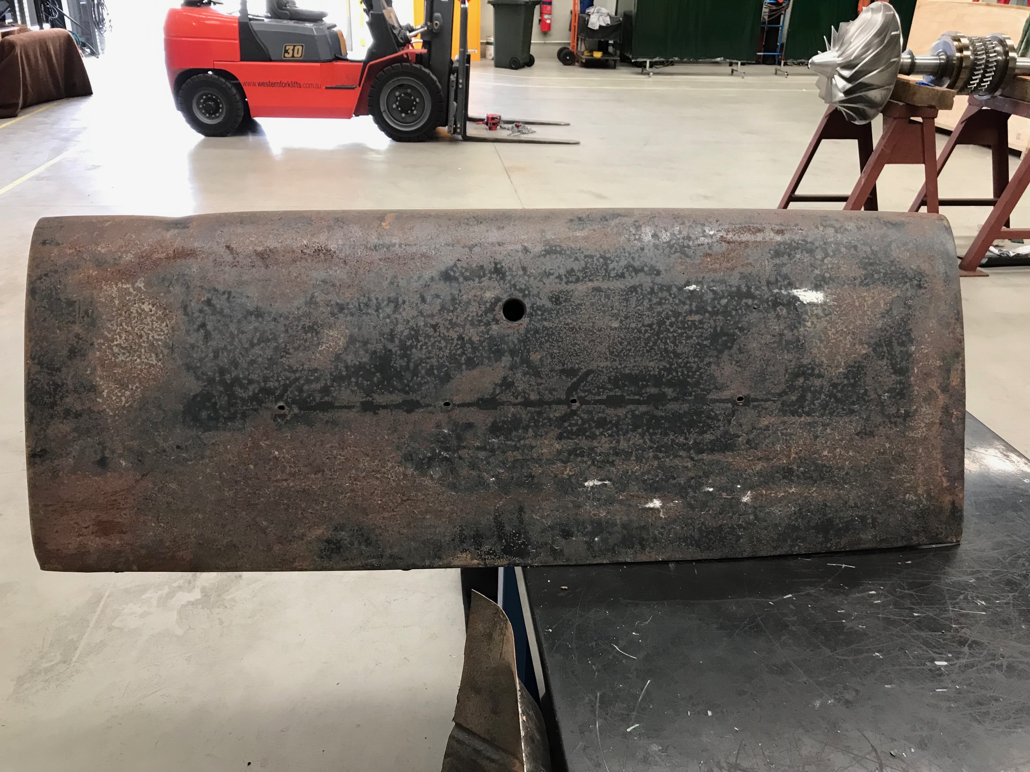

Bit more on the tailgate
ImageAfter wire wheel and soaking in citric some more. Gave it a blast in the car port. Just like a dry windy day st the beach really. Image
I used my $30 blasting gun from Adelaide Tools and $3 worth of dried sand.
Posts: 11652
Clay’s Wedgewood Blue FB Ute
I’m lucky I have the van tailgate as a template as this one although rust free is pretty beaten up. I have it all fairly flat now but noticed that the van one has a fold near the top which seems to be all but bashed flat on this one.
