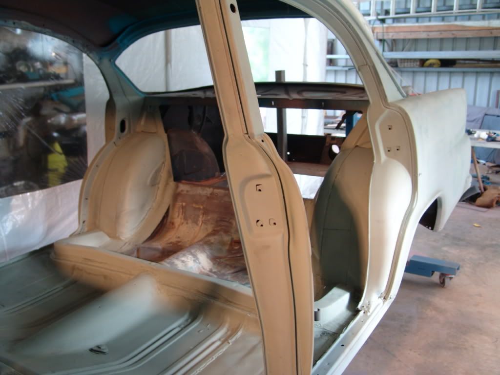

Ratbox: I will take a pick of the inner seat rails after I have welded them in place, I have recessed the seat rail into the floor abot 10mm on the inner rail.
A bit more progress, aiming to have to colour on mid January :roll: :lol: :lol: (wishful thinking!) Gone back to the original scheme: Phantom Mica (VE GTS metallic black), heaps of chrome and polished bits both inside and out, upholstery ..... red & black leather and swede.
I have ditched the HQ GTS fluted guards and have decided to doing something original and very "different" 8) 8)

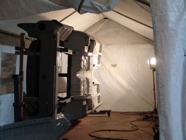

As for the Supercheap Autos carport, I have 2 x 500watt and 2 x 100 watt flood lights in there (I was cold :shock: :shock: NOT!!) and it takes the humidity out of the air and raises the temp like an oven (I will set up a thermometer in there and see how much different it is), good cheap DIY spray booth :idea: .

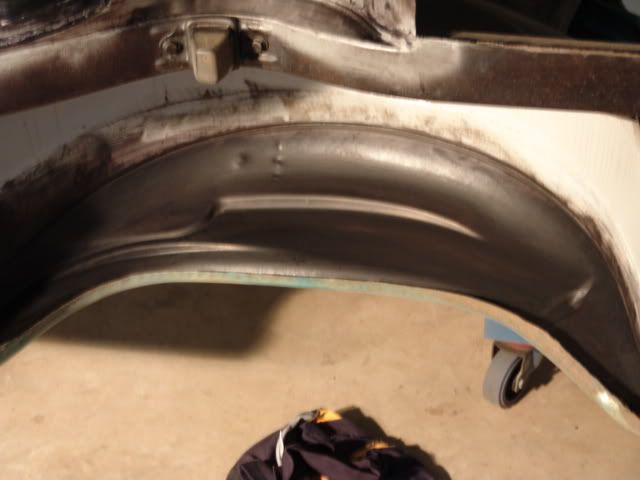

Once it is all blasted and primed the last of the rust (which poked it's head out during blasting :roll: ) will be repaired before final prep & prime. :D :D

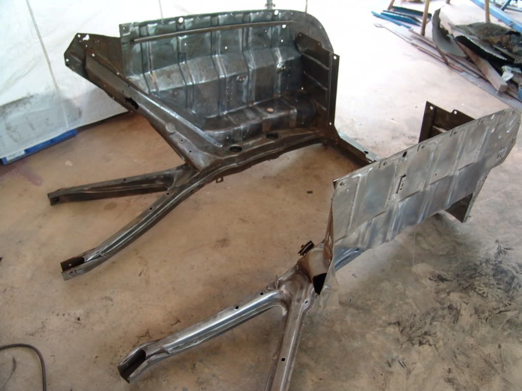

Hi Dave, I have attached a website with the blaster on it (around $200). It is great and does a really good job, I am running garnet (approx $22/25kg bag), best thing about doing it in the "Supercheap tent" is that I can sweep it all up, run it through flywire and put it back in the blaster! I bought 8 bags to start with and I still have 5 unopened :roll: :lol: :lol: .

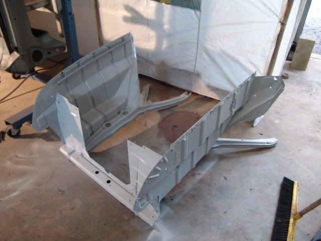

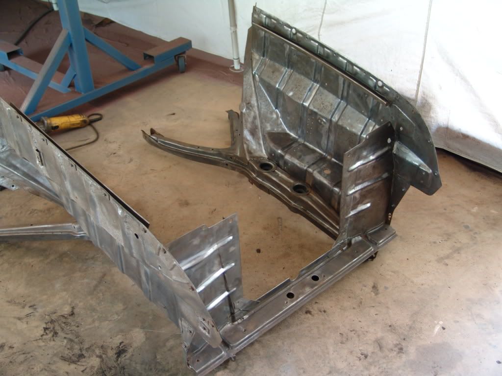

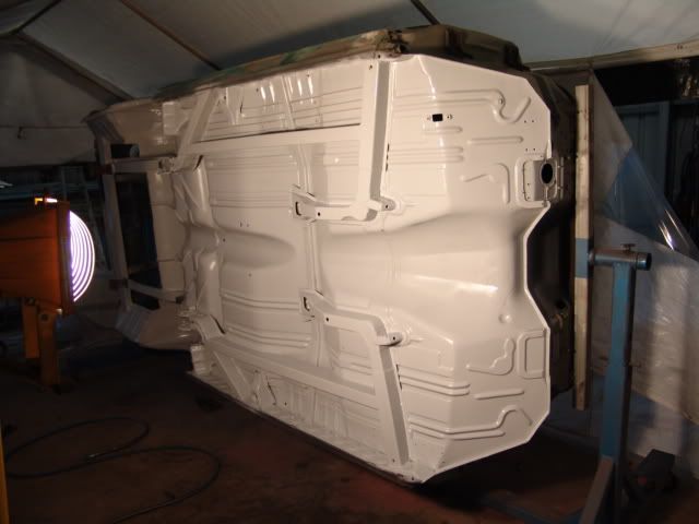

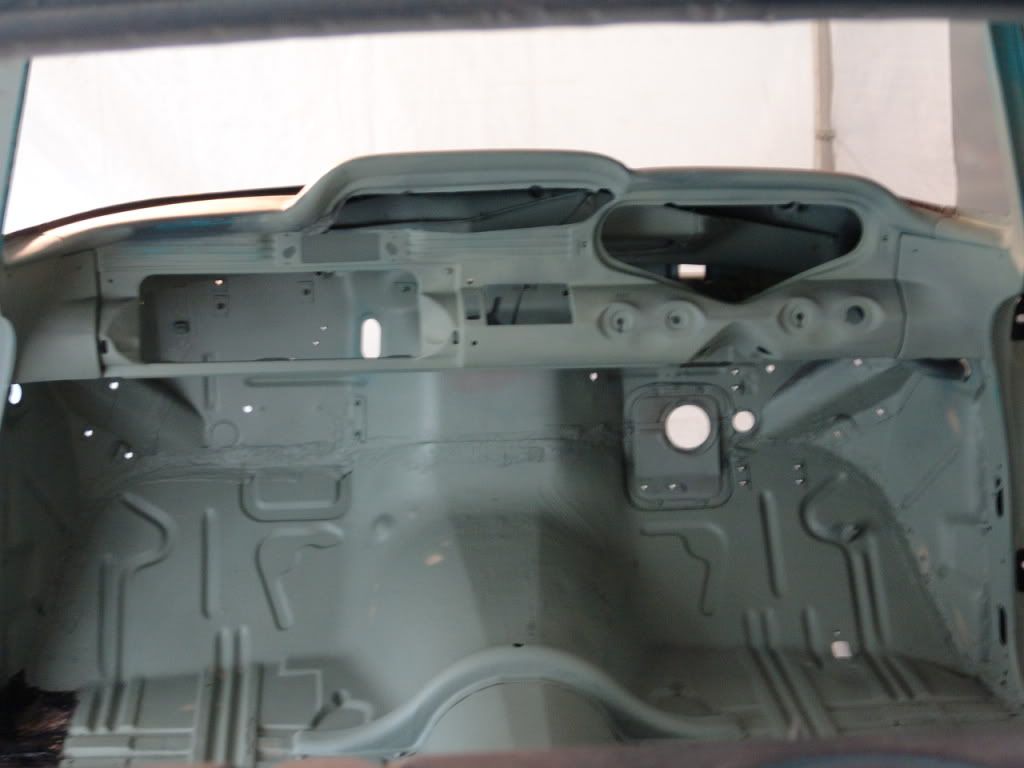

Got a bit more done on the weekend, more cleaning, rust converter-"ing", and finally a 2 pack epoxy primer, still some small repairs to do but at least it's protected now :D :D

Hi Sammy, that's it ..... just unscrew the cap on top and pour in the sand/garnet (kit includes a funnel) and connect the air (I have a compressor that only puts out around 6/8cfm, running at 60-100psi and it does the job, a larger cfm compressor would make the setup awesome (have to stop and start to let the compressor keep up but it still does ok), would recommend it, saves alot of work, like in the hard to get at spots were the wire wheel on the grinder doesn't fit 8) . I used a selection of tools to do the cleaning/prep work;
Grinder with wire wheel
drill with 2 sizes of wire brush (long brushes, not round like the grinder)
scrapers
Sand blaster with garnet
8) 8)
