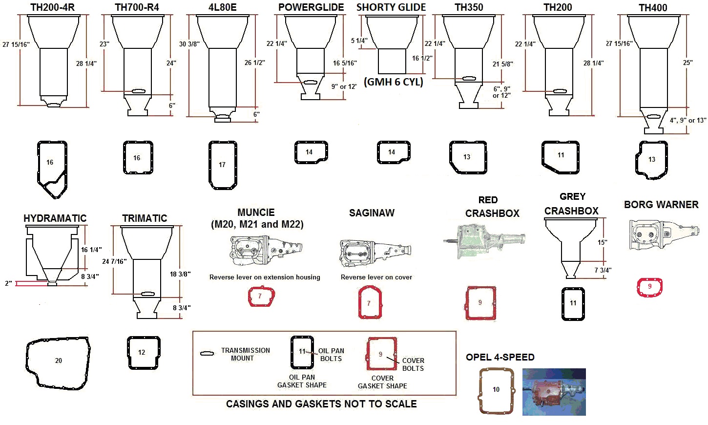

The shorty version weighs in at 40kg with no convertor/flexplate, compared to 46kg for the standard box, 27kg for a crashie, 21kg for a red crashie and 47.5 for a Hydra. The length is as per the diagram below.

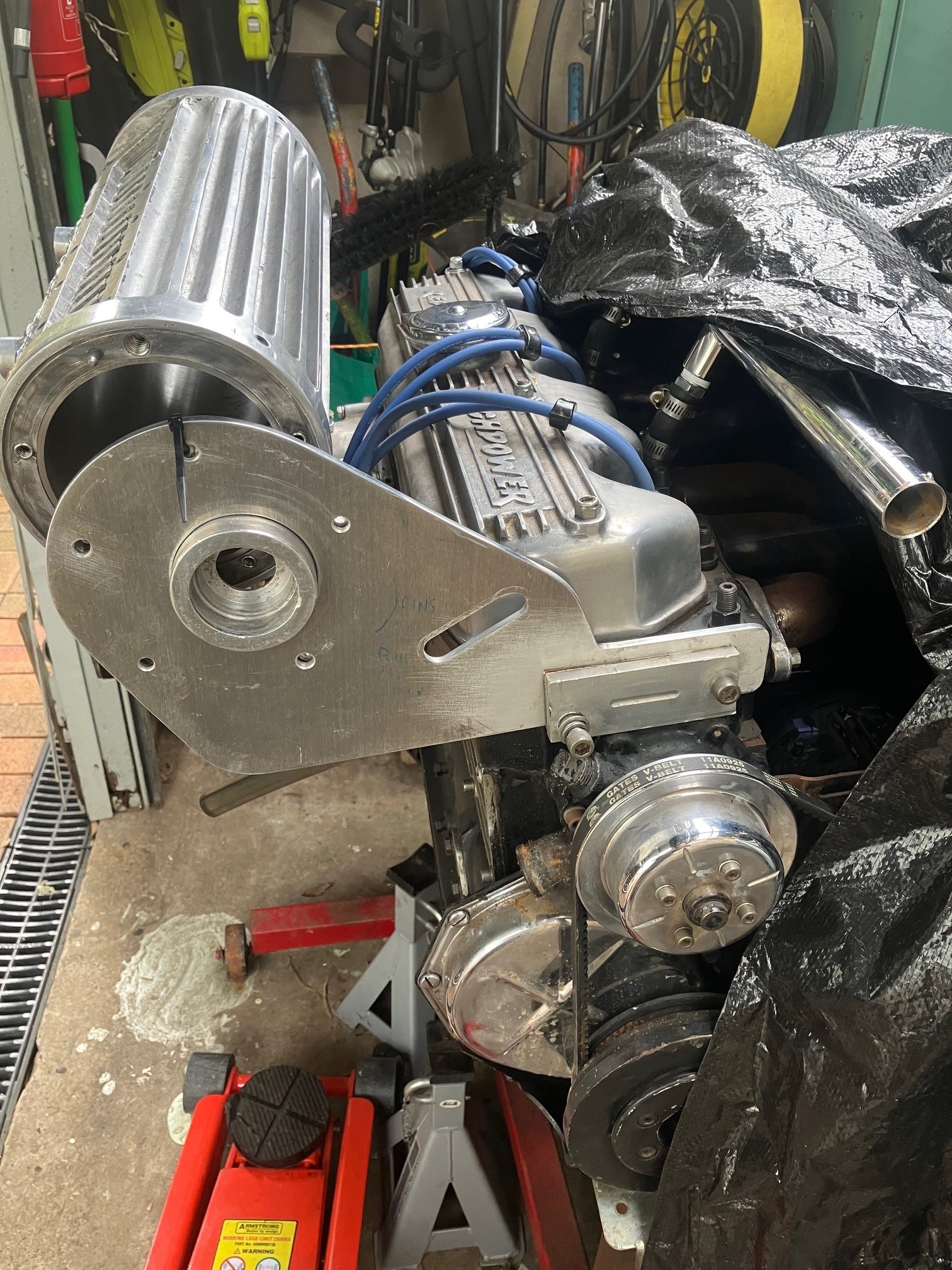

With the chassis nearing completion I need to get a bit more serious about the engine for the FED. Plan at the moment is to run the genuine Repco head, as the repro one is still not done. Not sure if I will run the bottom end that is currently on the head (ex-speedcar), or pull it down and put the newly-rebuilt meth-monster bottom end under the genuine head.
Either way, it needs to have the Norman mated up to it. Got the Norman bits out, and gave them a basic clean (at least enough that it won't give me typhoid just looking at it... old oil, grease and blue silastic now gone :sick: ). The Norman has had a hard life - according to legend, last run in a Toyota at 30psi :shock: . Everything is helicoiled and worn-in. I'll have no regrets leaning on this thing.

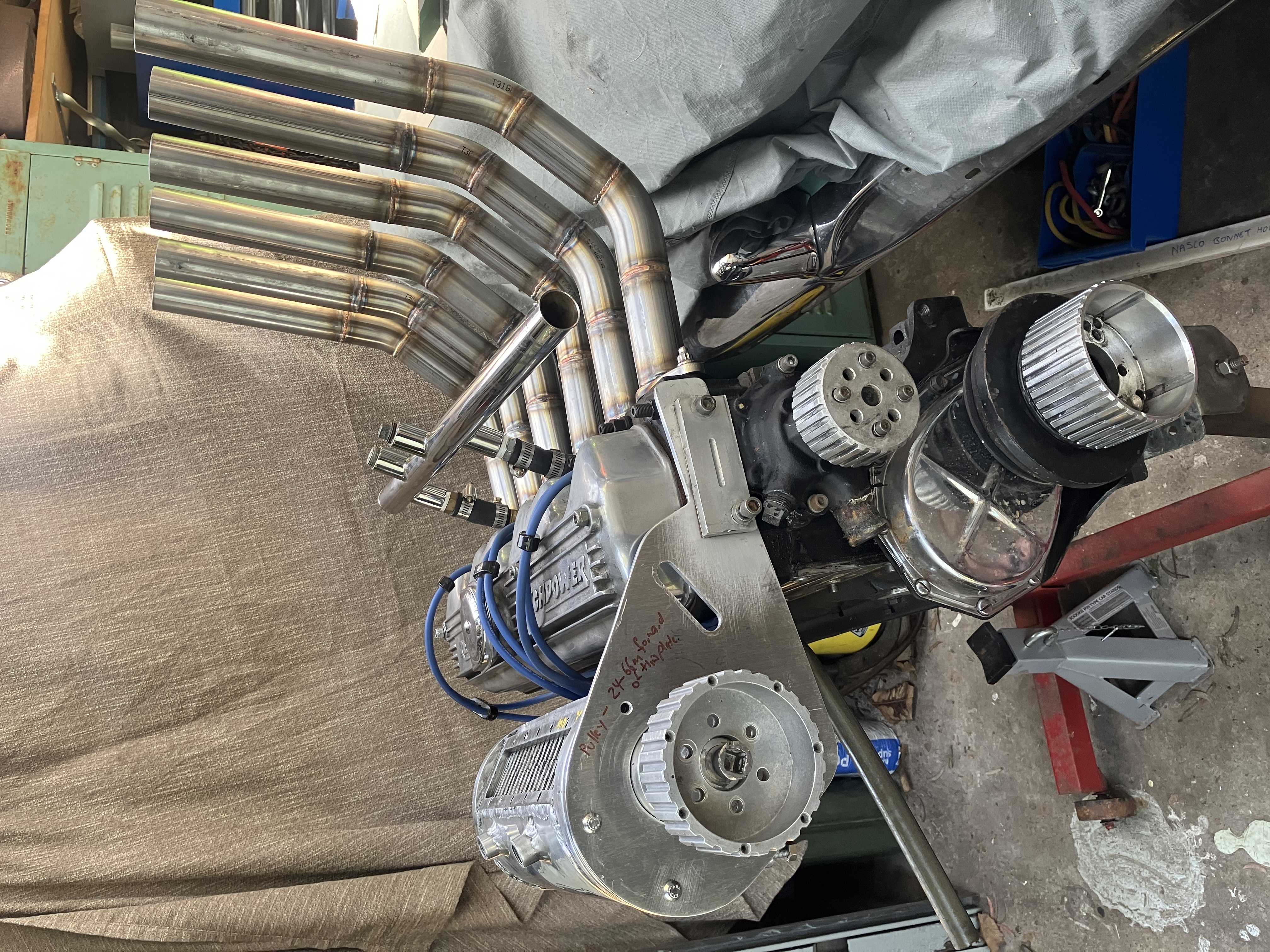

The previous owner of the Norman had used some 5mm ally plate to make a front mounting. I'll do similar, but will put it on the drivers side of the engine to suit the crossflow head. The plate will save the whole Norman from hanging off the inlet manifold. The photo below(with a little imagination) gives you an idea of how it will sit - up in the air, and hopefully a straight shot from the outlet to the Repco inlet. I'll buy some ply and remake the brackety, get it to sit a little better to where I need it. Figure I'll make some ply manifolds, then send them out to get replicated in ally.

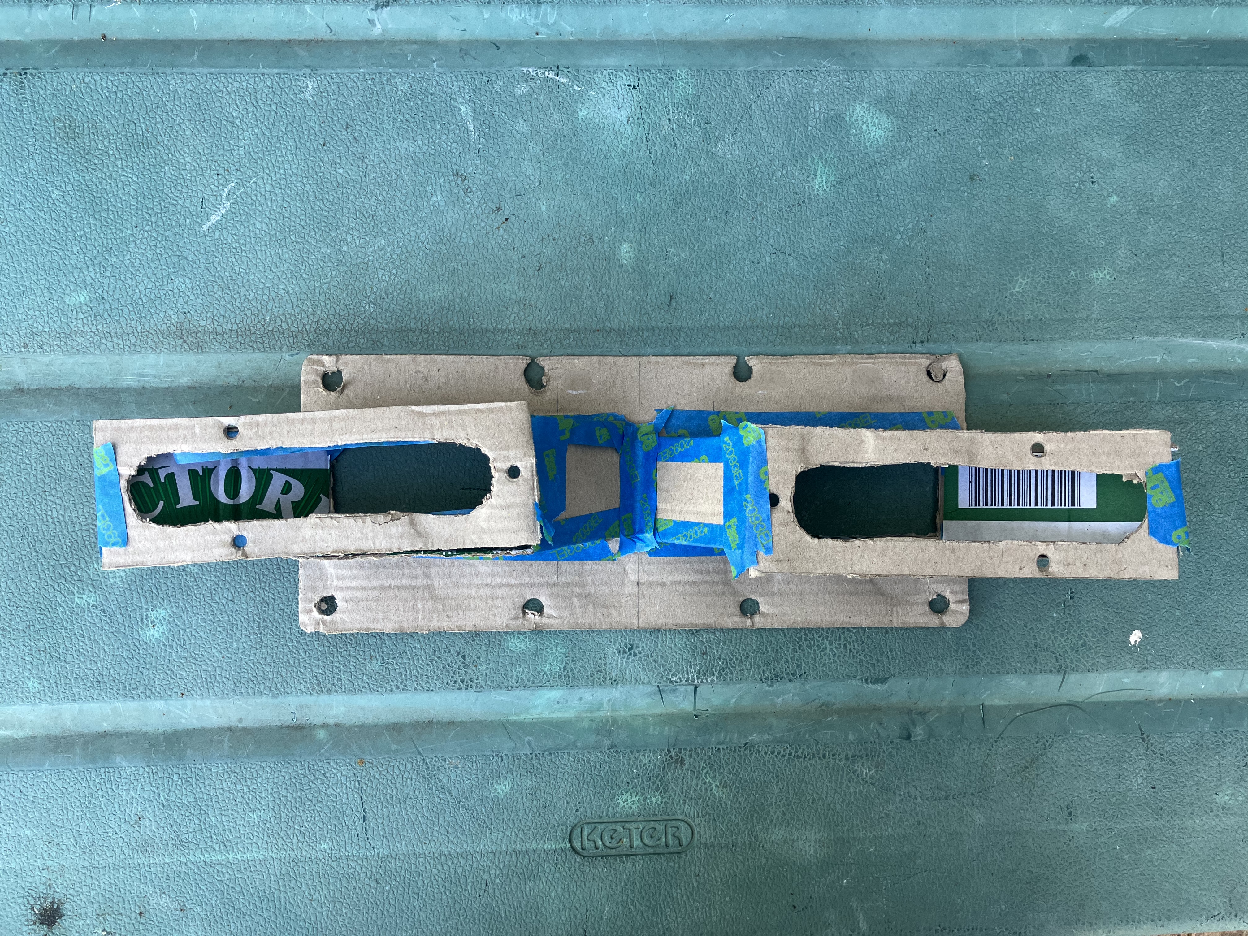

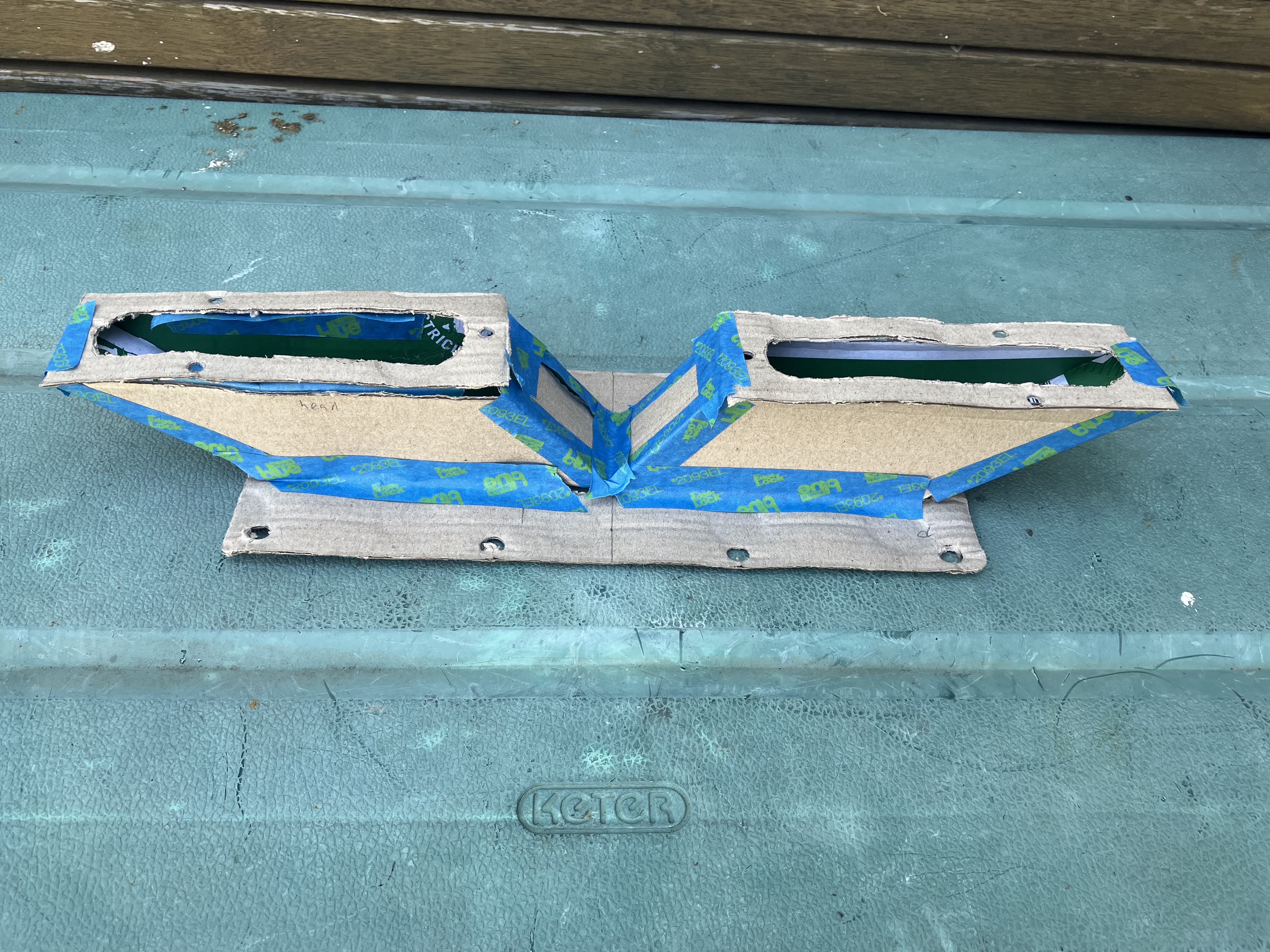

Template for the huffer manifold, made using VBCAD:

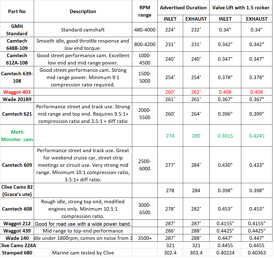

Cam is stamped 403. Looks like Clive's stamping, but a call to them shows its not a Clive or Wade grind. Anyone know of a grey motor 403 grind? Worst comes to worst I'll pull the cam and get Clive to measure it.

Dummied up the Norman and pulleys. I can get a clear shot at the cam end, so cam drive for the fuel pump is still possible. Problem is that the blower belt would almost wrap around the fuel pump. Methinks IHRA won't like that, and that I would have to extend the pump forward off the cam snout about 6". Will have a chat to the IHRA tech inspector next month, as that location may not fly either. Worst comes to worst I can belt drive the fuel pump (and have the bracketry/drives to do so) but had hoped to avoid a second belt.
Some Googling shows that 403 is a Waggott grind, but for a red 6 with hydraulic lifters. Not enough duration for what I am doing, though a hefty amount of lift. 403 cam in red below, the green one is the custom grind Clive did for me for the blown grey:

Bugger. The 403 cam is not a Waggott one. Waggott engrave their numbers (not stamped), and would not have put the hydraulic 403 profile onto a solid lifter cam.
So not Clive, Wade or Waggott. Not a Tighe or Camtech grind either. Possibly Bert Jones, but cannot find any Jones data.
Looks like it will need to come out and be measured by Clive.

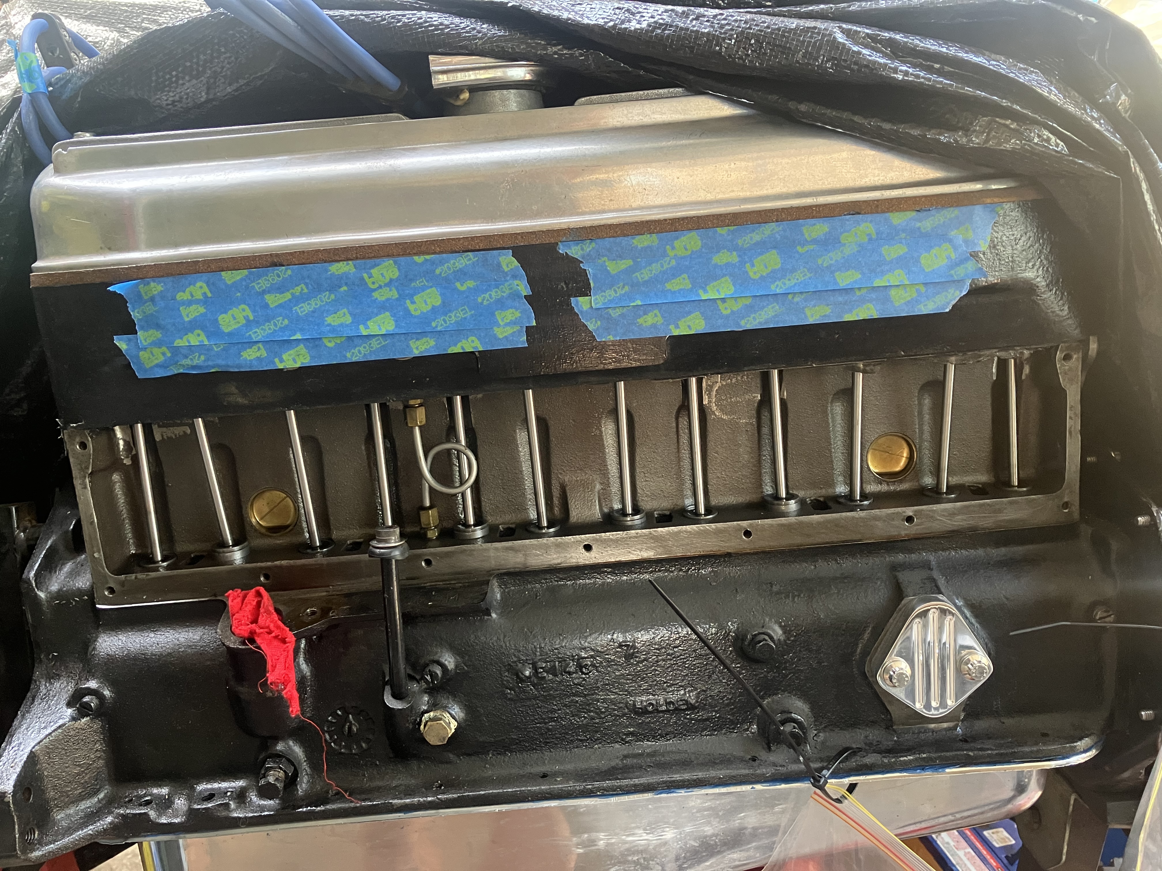

Sump off the Repco headed Speedcar motor. Clean sump, but no crank bracing. Would need new caps/girdle and tunnel boring for the abuse I will throw at it. Looks like the other block (already girdled) goes into the dragster.

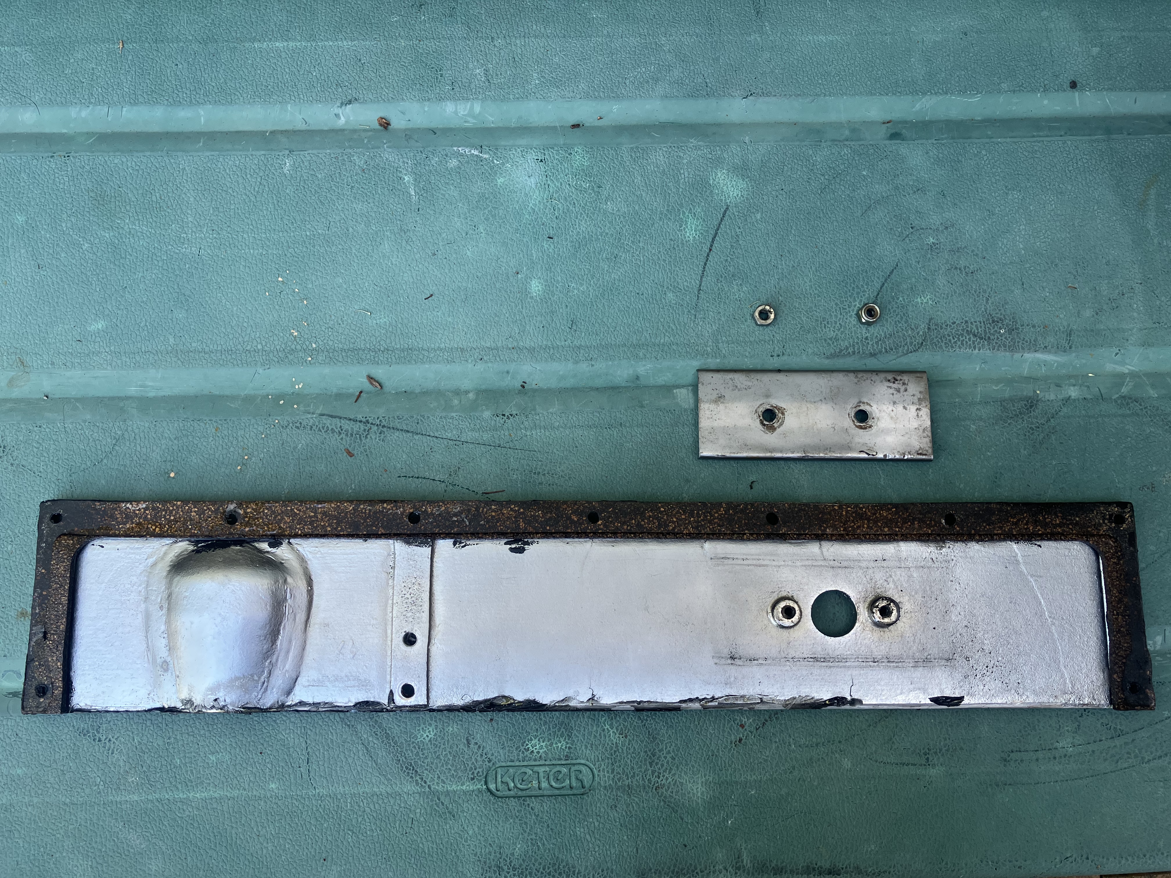

Side plate off, and as suspected I had dropped the breather baffle off inside the side cover.
One locknut, one plain. Can tell this thing was raced… no two fasteners the same.

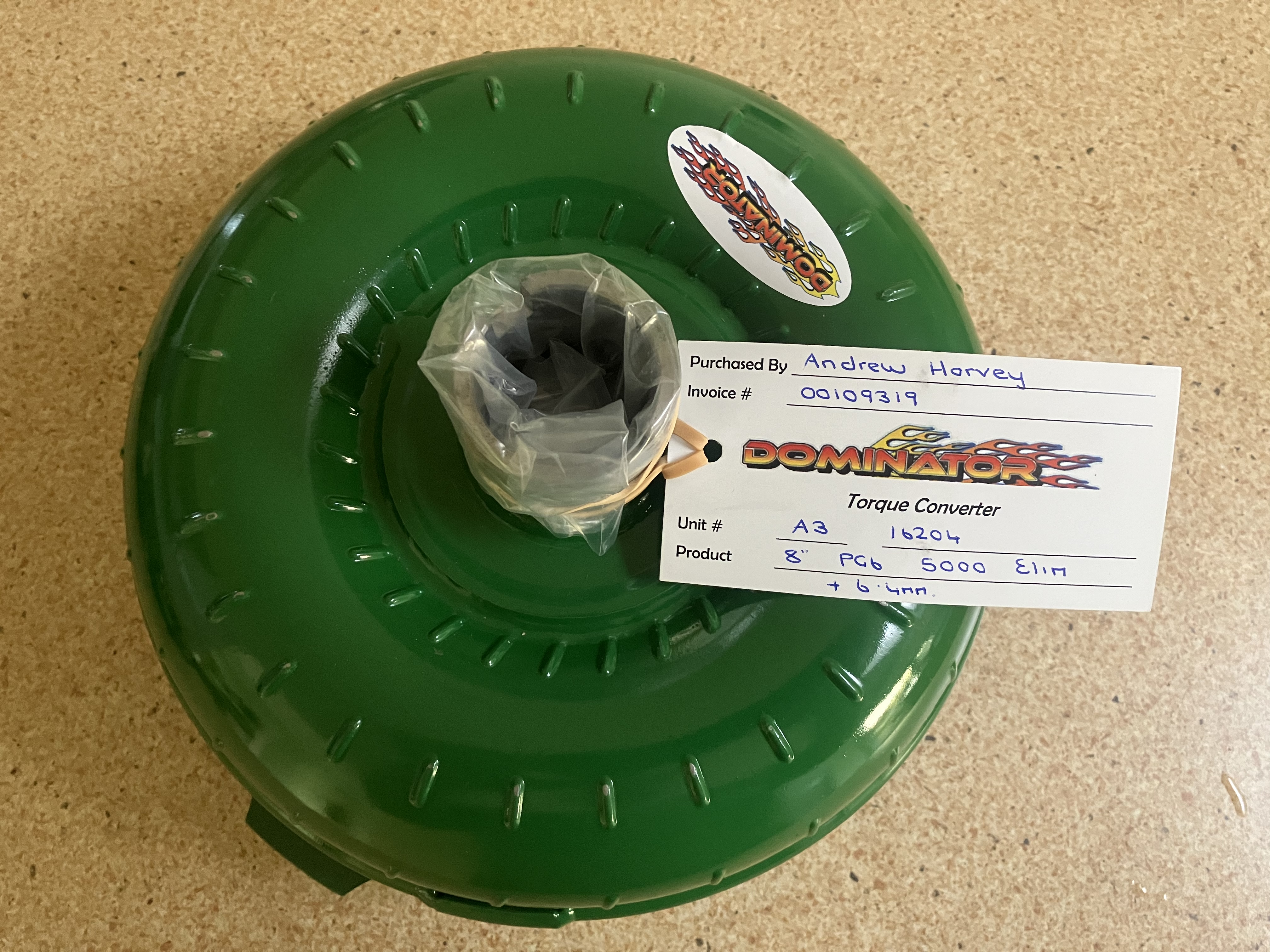

Torque converter arrived from Dominator. 5000rpm stall. It has long bosses welded to it for the mounting bolts. They need to be king because the FED has an ally plate between the motor and gearbox (acts as the rear engine mount). Fasteners are 7/16UNF, which are a smidgen too big for the holes in Roger’s flexplate… will drill the plate out.

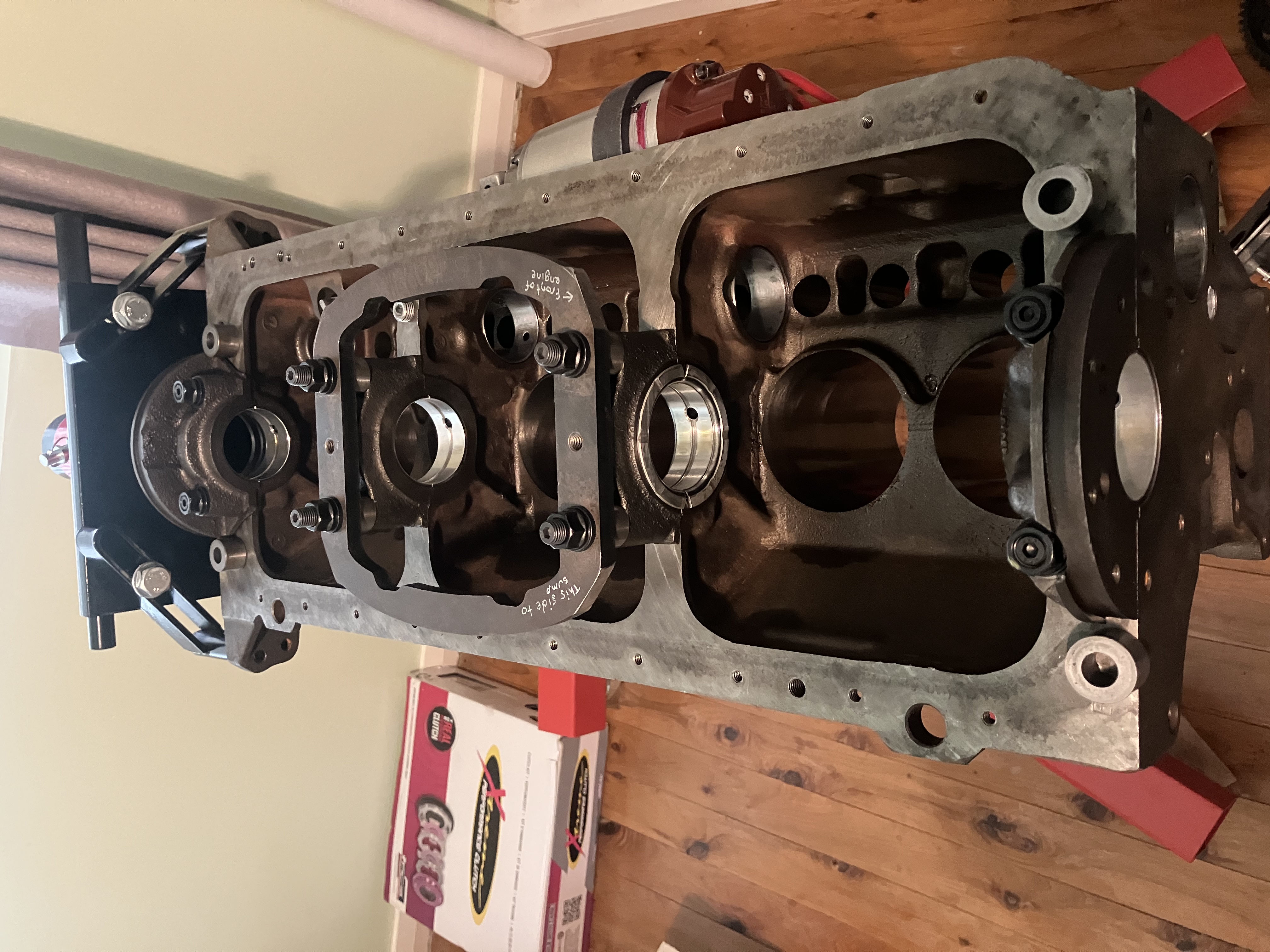

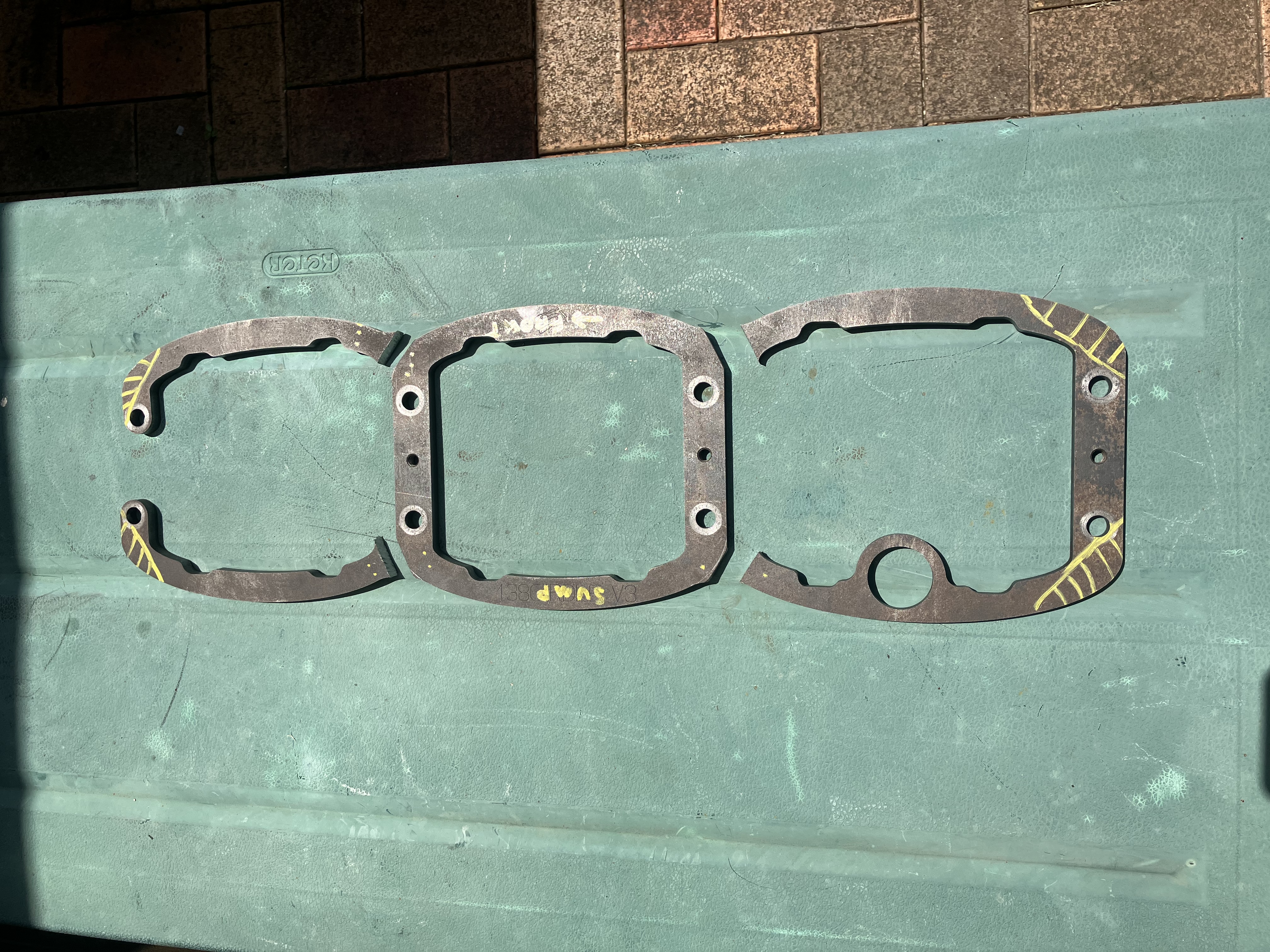

The FED will be wet sumped, so the dry sump pan will have to wait. Hunted in the collection for a spare sump, and sure enough it fouls the Sonic girdle. I knew this, but had hoped the clash would be minor. Nope. The girdle, and studs at each end clash where the sump is reinforced for the end-strip cork gasket. Major pan surgery, and a bugger to seal. Little wonder the dry sump maker would not make a pan for a girdled grey. The clash areas are crosshatched in yellow in the photo below.
The solution? Off with his head!… or at least off with the ends of the girdle. By keeping the girdle over the two middle caps it stops the bearings walking - old lumpy humpy trick, with thanks for educating me Mr Smith. The two end caps now need shorter studs 2.75” OAL to clear the pan. More funds to ARP.
The drama is that the block was tunnel bored with the girdle in place. Now that stupid me had to cut the ends off the girdle, it may no longer be true. Strip all the bits off it, torque up the caps and baby girdle, and off to Duncan Foster to measure for roundness. Wish me luck.
