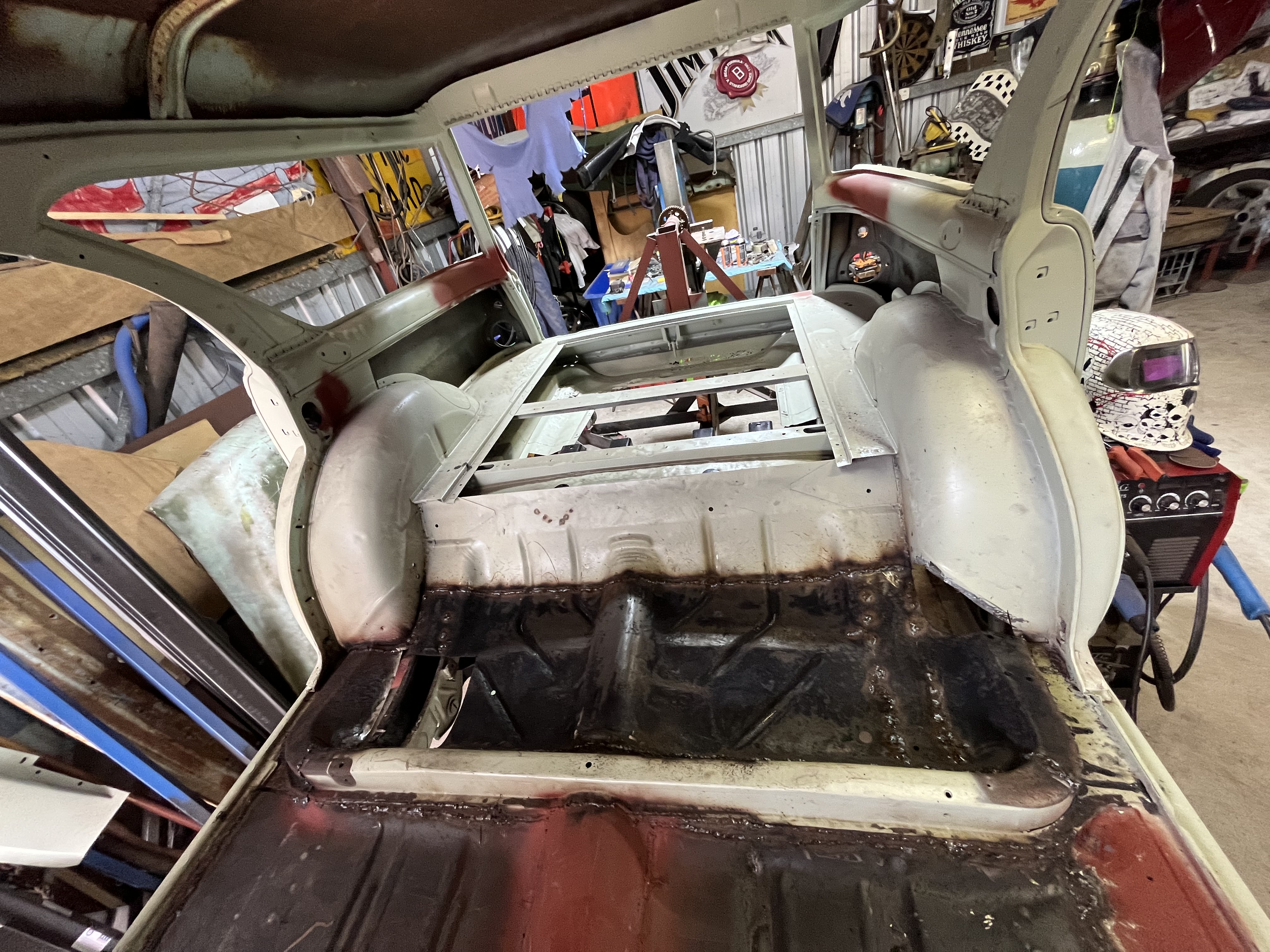

Did a couple of small repairs under the back yesterday and then cut out the small repair section I need to replace in the passenger side front floor.
Every time I am under the "Reverend" or inside doing some work I look around and find more to do by the time the roof and top half of the firewall are changed there isn't going to be much of the original wagon left that's for sure. :crazy: :crazy: :crazy: :crazy:

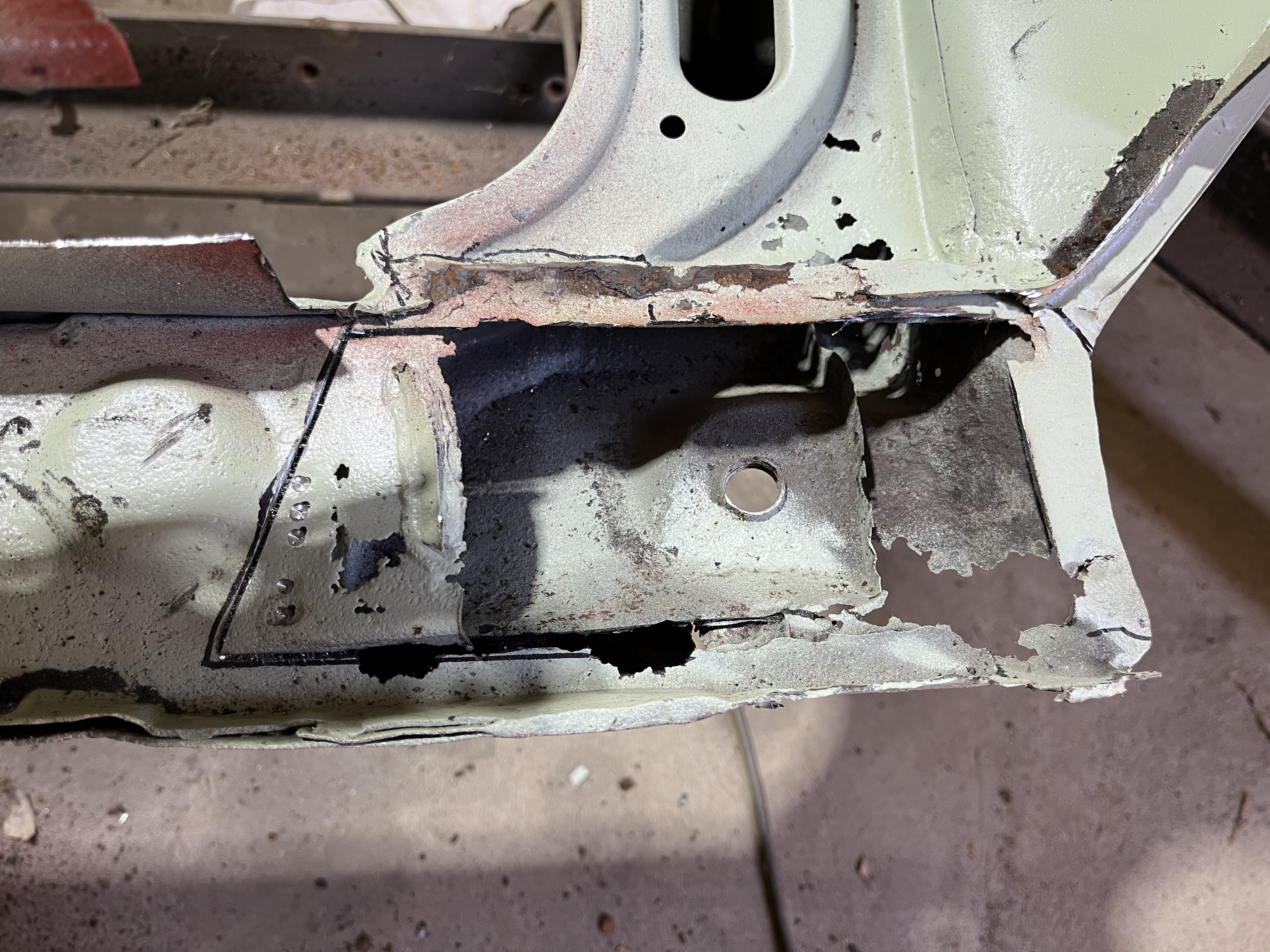

Had a relatively productive weekend :eh: :roll:
I finished off a couple of small things then decided to move to the front floors, passenger side only needs a half patch but driver side will be the full Rares patch piece.

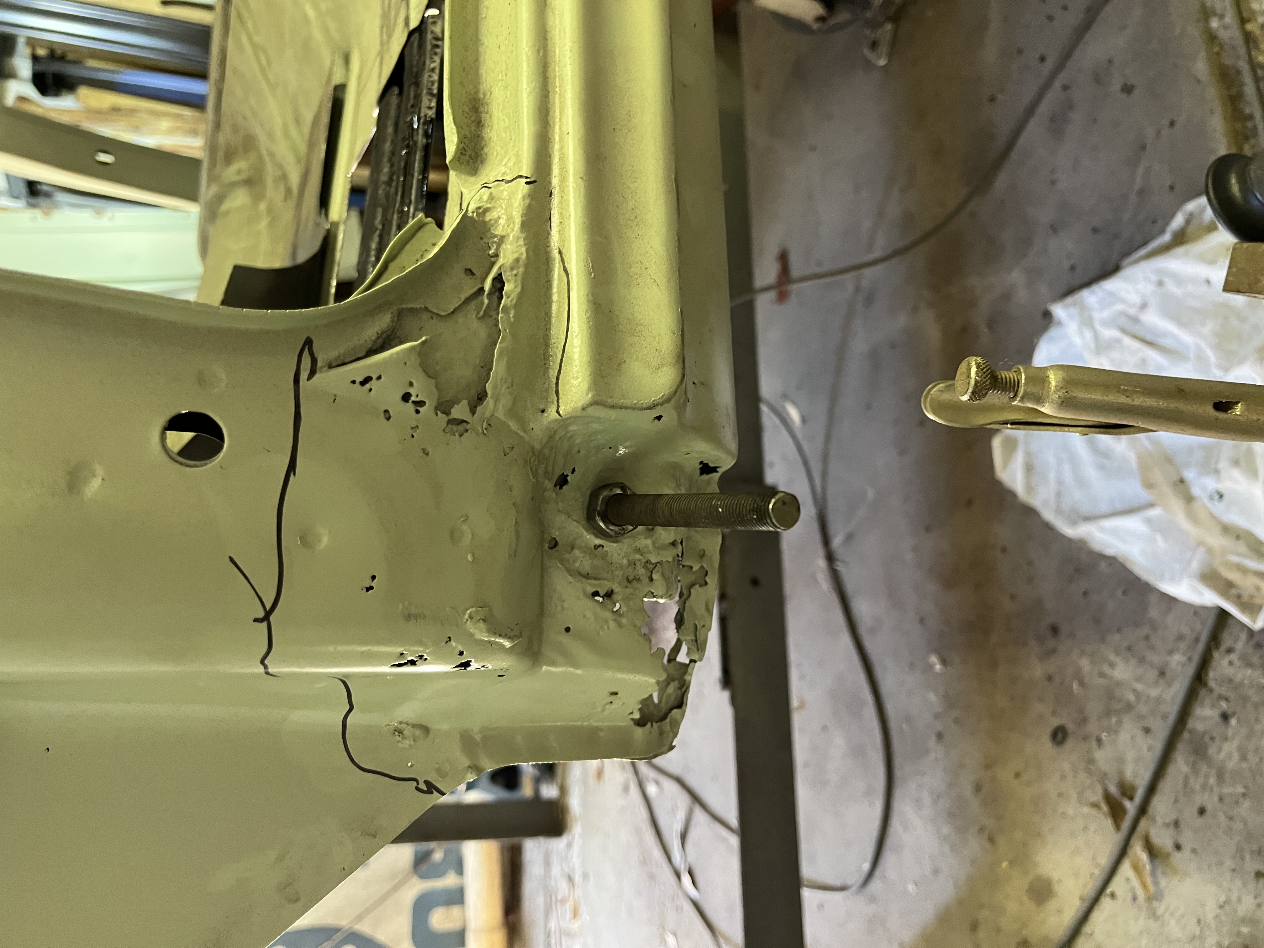

I cut the bad piece out of the passenger side and when I had a good look decided to "Phone a Friend" :lol: I'm going to quote Rob here "it is like eating an elephant" :wtf: anyway gave the man the legend Mr Blacky a message and some photos for some advice i.e. should i weld the floor in and then tackle the A pillar, his advice was very helpful and even though I may not have followed it 100% I think it came out ok.

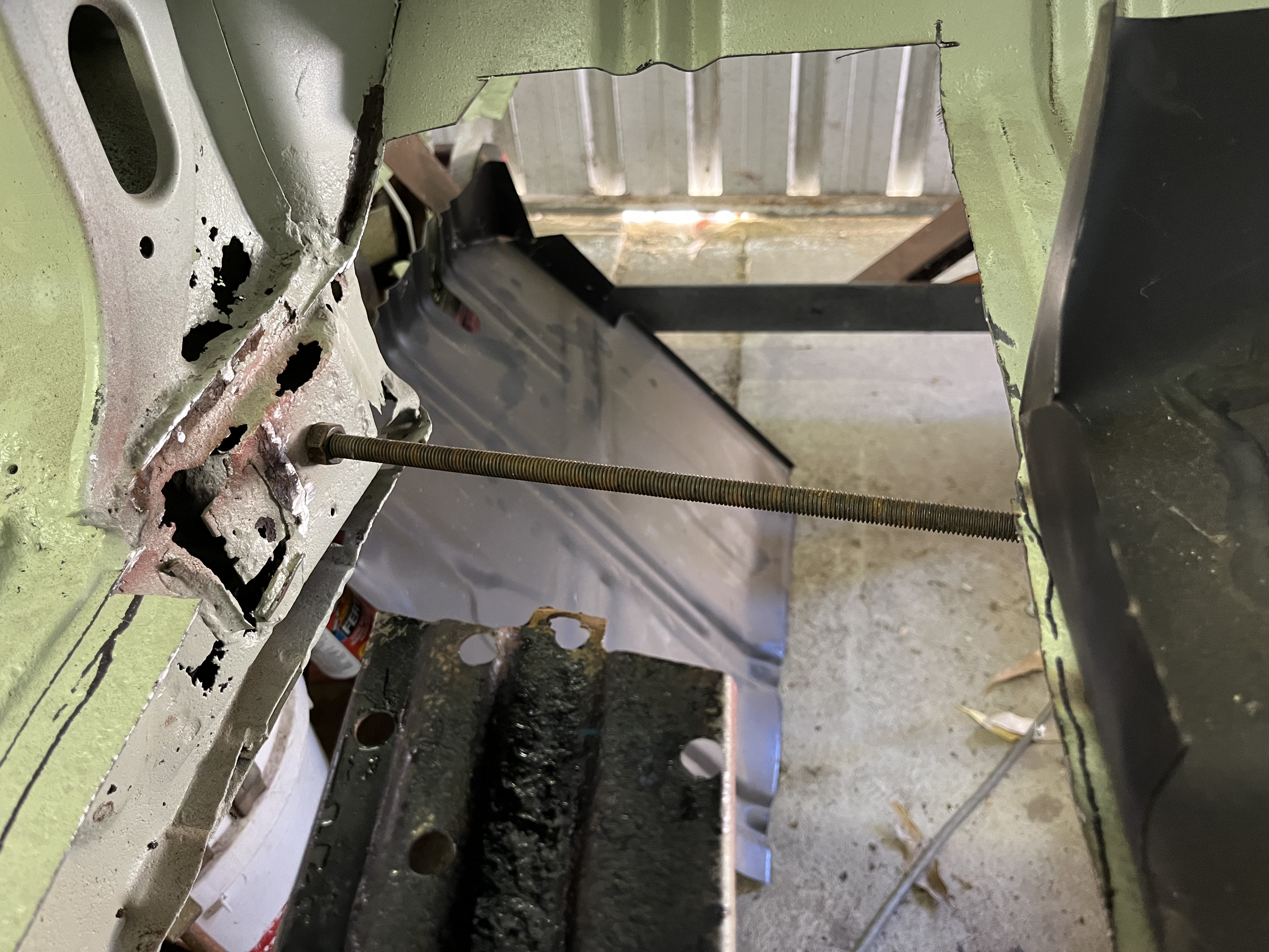

The threaded bar lines up the subchassis mounting holes, you can see the inner sill is pretty wasted.
Put the floor patch on hold so I had access to the inner sill, cut the old one out, the inner now that I can see it doesn't look too bad I may only have to replace the outer.

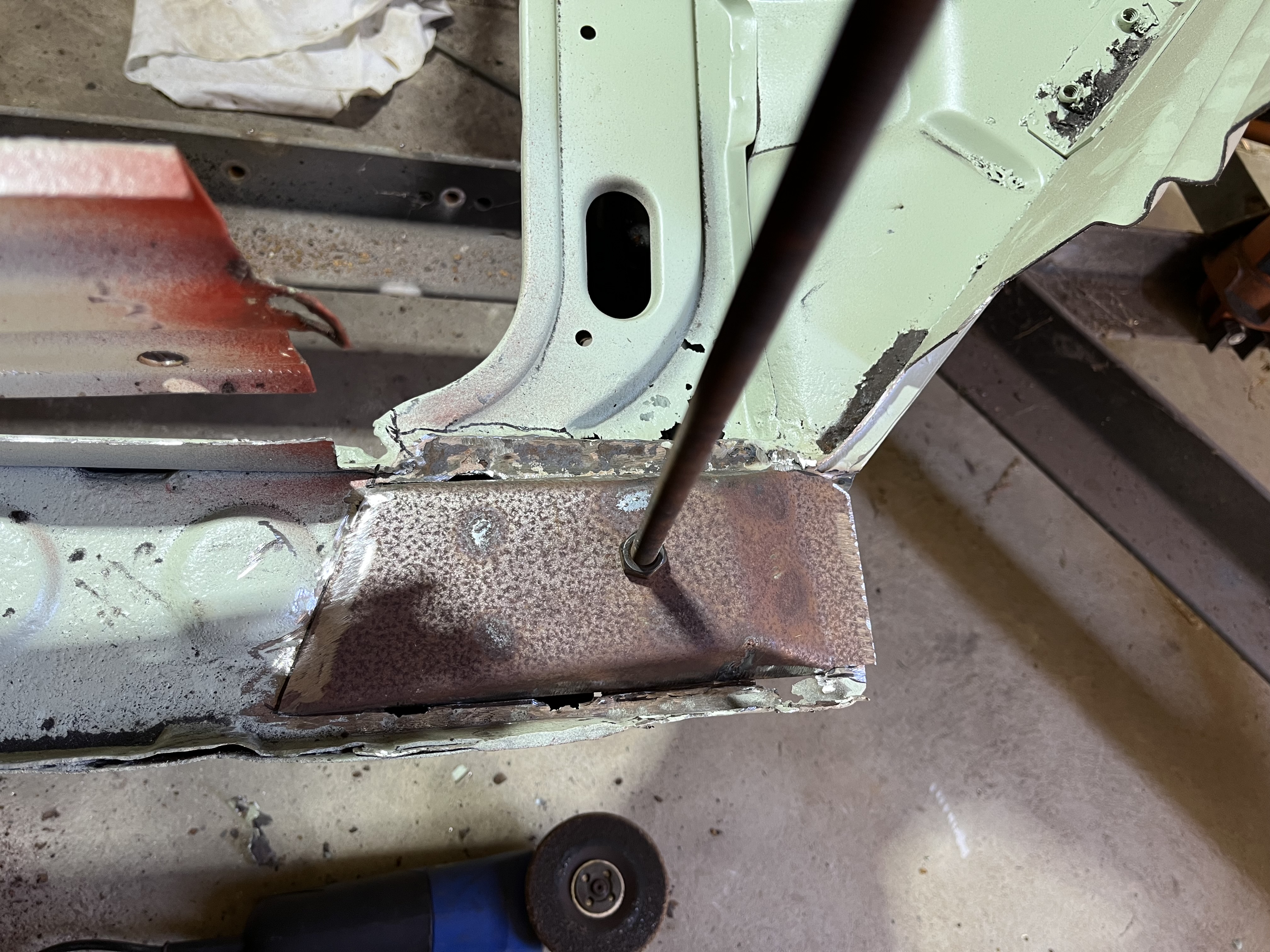

Put the repair piece in place and lined up with the threaded rod and welded in.
Welded in the crossmember, I've wanted to do this for a while now to give the floor some strength back.
I'll get some primer of this now and then tackle the outer, really stretching my abilities at the moment "ONE BITE AT A TIME" :lol: :lol:
