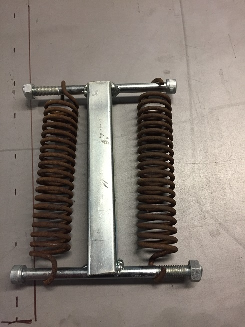

I need to have the hard lid pop up when I unlatch it but do not want a coil spring in the back corners.
Think out aloud, maybe straight spring strip near the strut mounting point ???
Needs only to lift enough to get my fat fingers under at the back.

I revisited the FE-FC forum to see what JB did on his ute. A couple of coils in the back corners work but not neat or tidy.
I will be using gas struts to assist and hold up the lid so will review after installing.

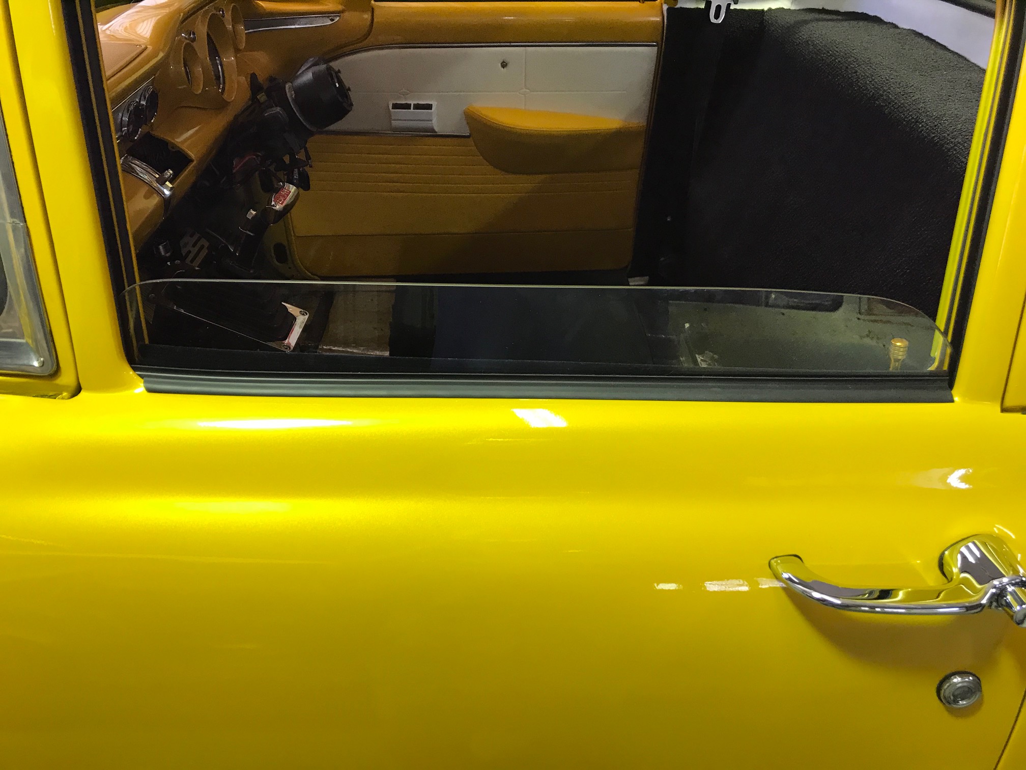

Firstly, the weather strip for the single piece glass doors.
I visited the manufacturer Rubber Seal Australia, here in Adelaide to purchase a couple of metres of the suggested profile but it has a black flocking on the outer side.
I rechecked the photo of Neil’s Frankenstein ute it appears to be rubber only.
I was shown a number of profiles and I think I have this sorted. Just need confirmation on the attachment clips and I will place the order.

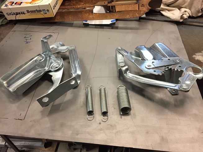

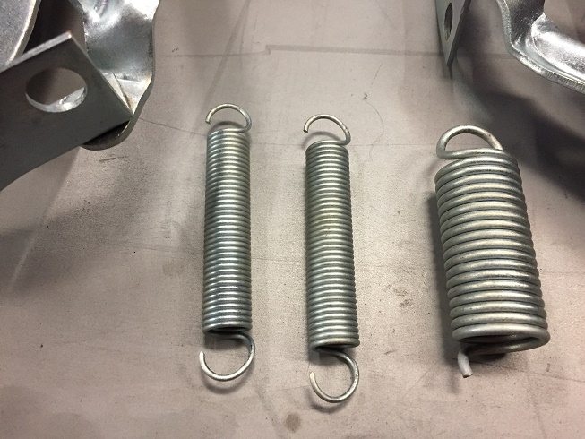

I had the bonnet hinges zinc plated as I could not justify the cost to chrome plate. I used an long time plater here in Adelaide so I thought all good until I when to pickup. Hinges look good but 1 outer spring broken and the other missing. Thanks to Retro Richard donated a couple of replacement springs. I’m stretching the spring to get the plating on all of the coils.

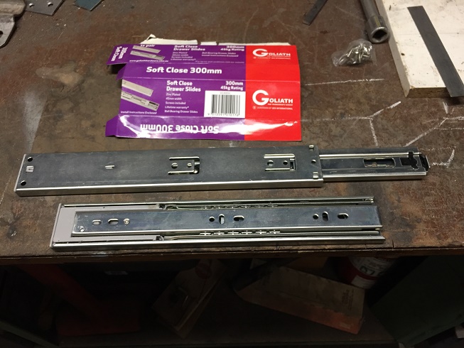

Started on the under-seat storage and will require minor reduction of hump in the floor is needed to accommodate the required drawer.
Using a 300 mm soft drawer closer so smooth running. Home this week so plenty to do.

I had the same problem with the springs Roger - the anodising/zinking weakens them badly so I'd consider not doing them that way and just paint them instead as it will keep happening.
I ended up getting some new springs made at wheelman springs - they now have a very good spring that can be used as a single spring to replace the dual springs.
