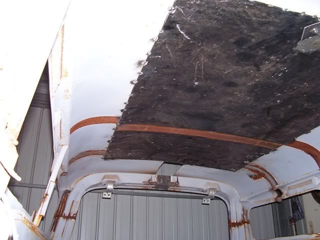

While the outside looks shiney, it is rough inside.
The frame work around the inside of the van is rusted out.
This used to be a ute :shock: and someone has added the van roof
to it at some stage of its life.

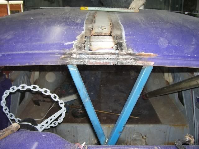

The sparks have been flying, and the roof is taking shape.

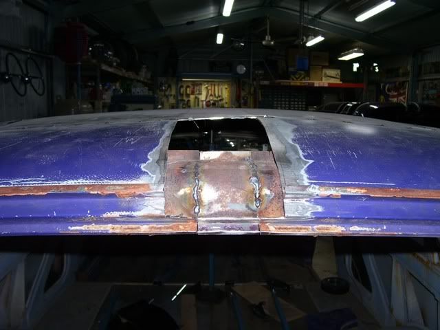

First we replaced the upper center windscreen section with a piece from the donor van.
Tacked with mig, then finished with oxy.
This will all be smoothed off later, we are just welding it in for now.
The dip in the center will be fixed when the longer strip is replaced.

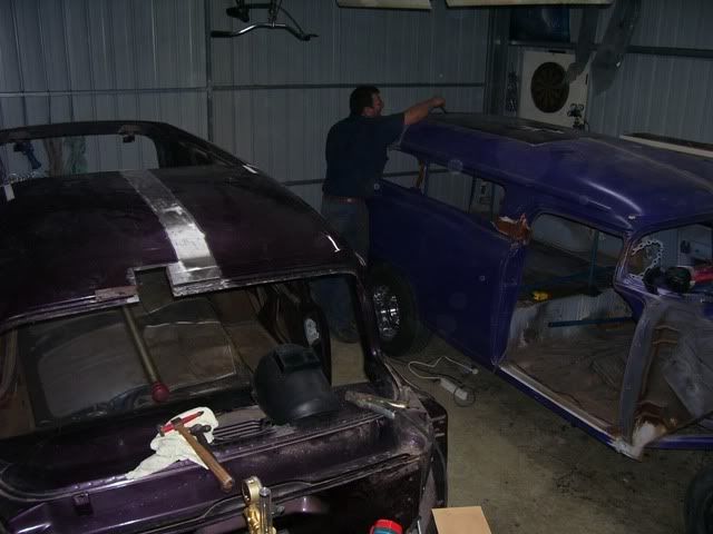

Next we cut out the square tube frame from around the large hole in the roof,
and cleaned up the edges.

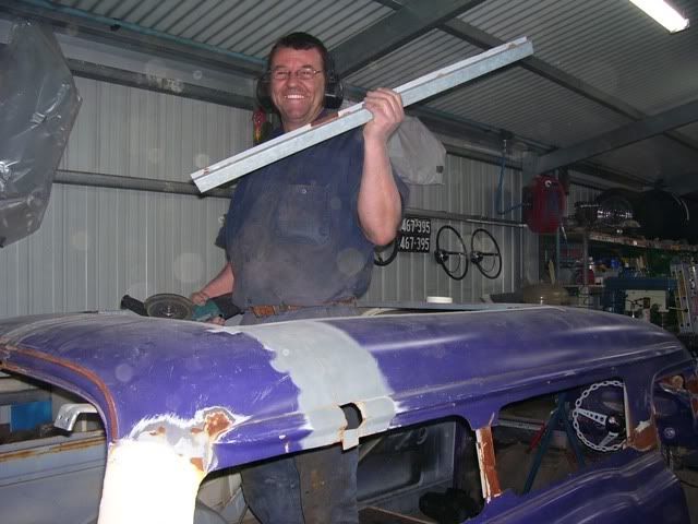

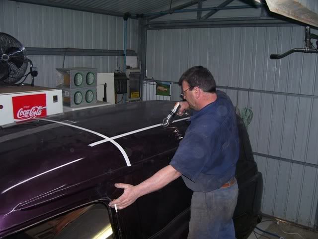

Thats Len in the photo, happily chopping up my cars.
You'd love this guy Ratbox, He's an angle grinding maniac :lol:

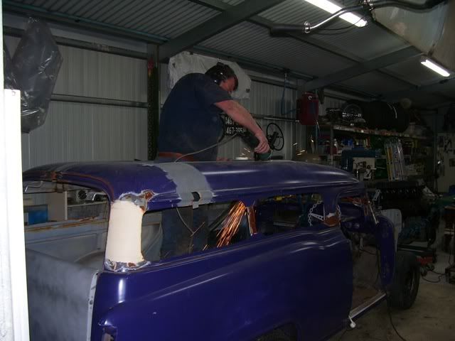

We then marked out the donor van for the main roof section,
and cut that piece out.
You can see a picture of Ratboxs van (Photoshop Chopped Version)
in the background I'm using for inspiration, not copying :roll:

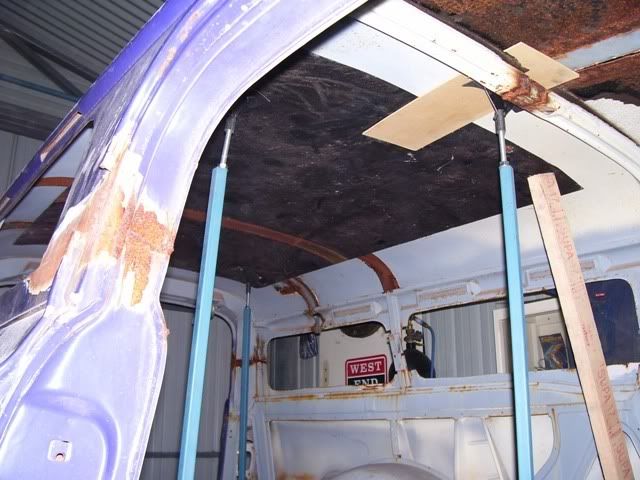

The roof piece is then propped up in its new position for tack welding into place.
Shown here from inside, fully tack welded.

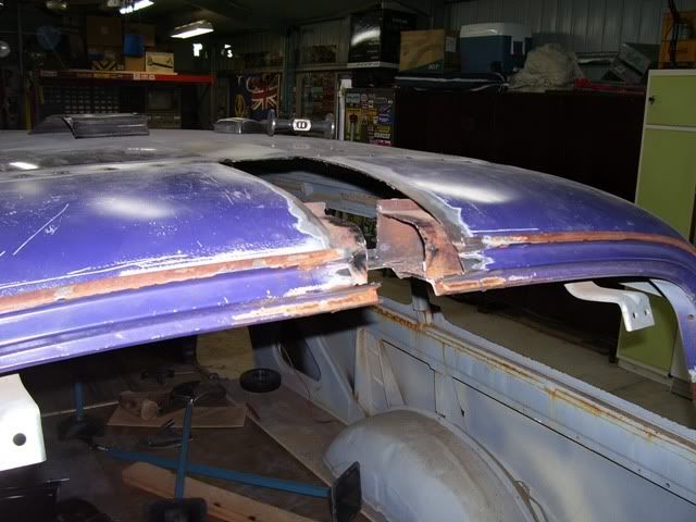

Next, we replaced the upper rear roof section above the tailgate.
We did the inner section first, then we'll do the outer piece after.
This is the inner frame, which will be covered with the outer skin later.
