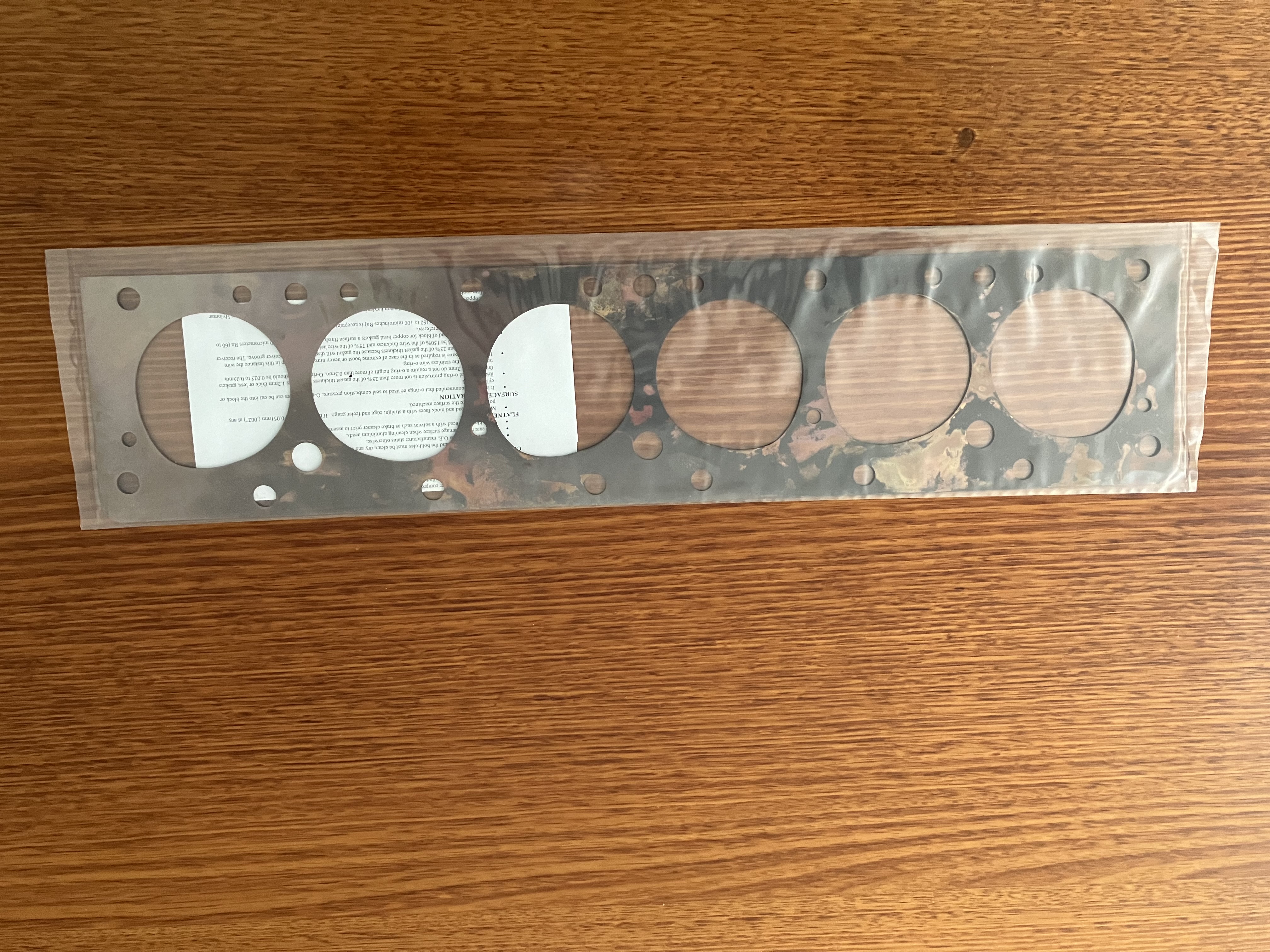

Copper head gaskets arrived today from Gasket Solutions (same mob that makes the improved cooling gaskets for the normal head).

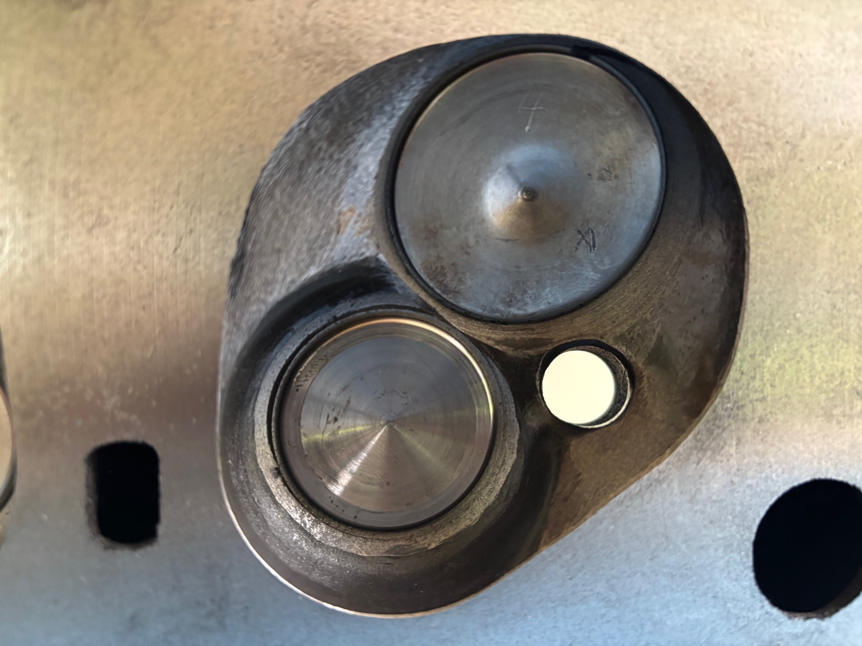

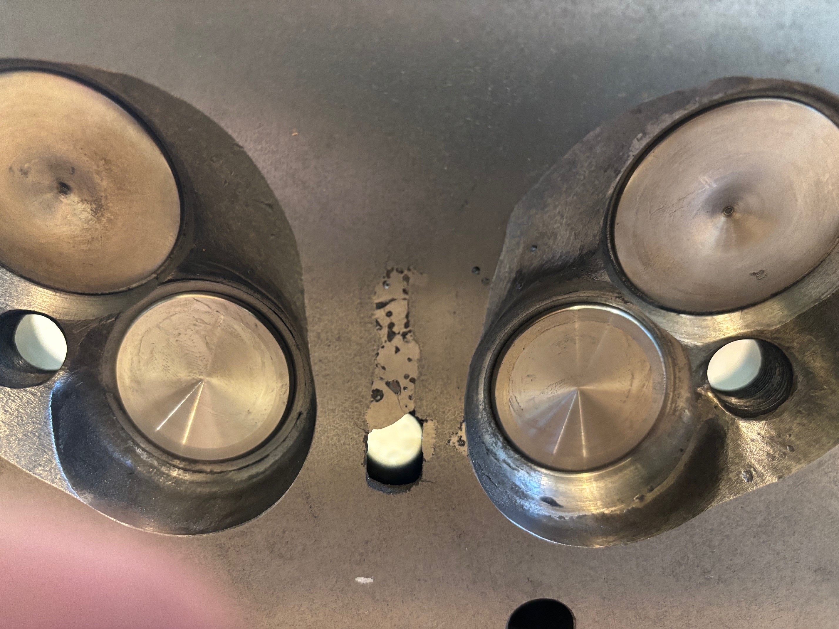

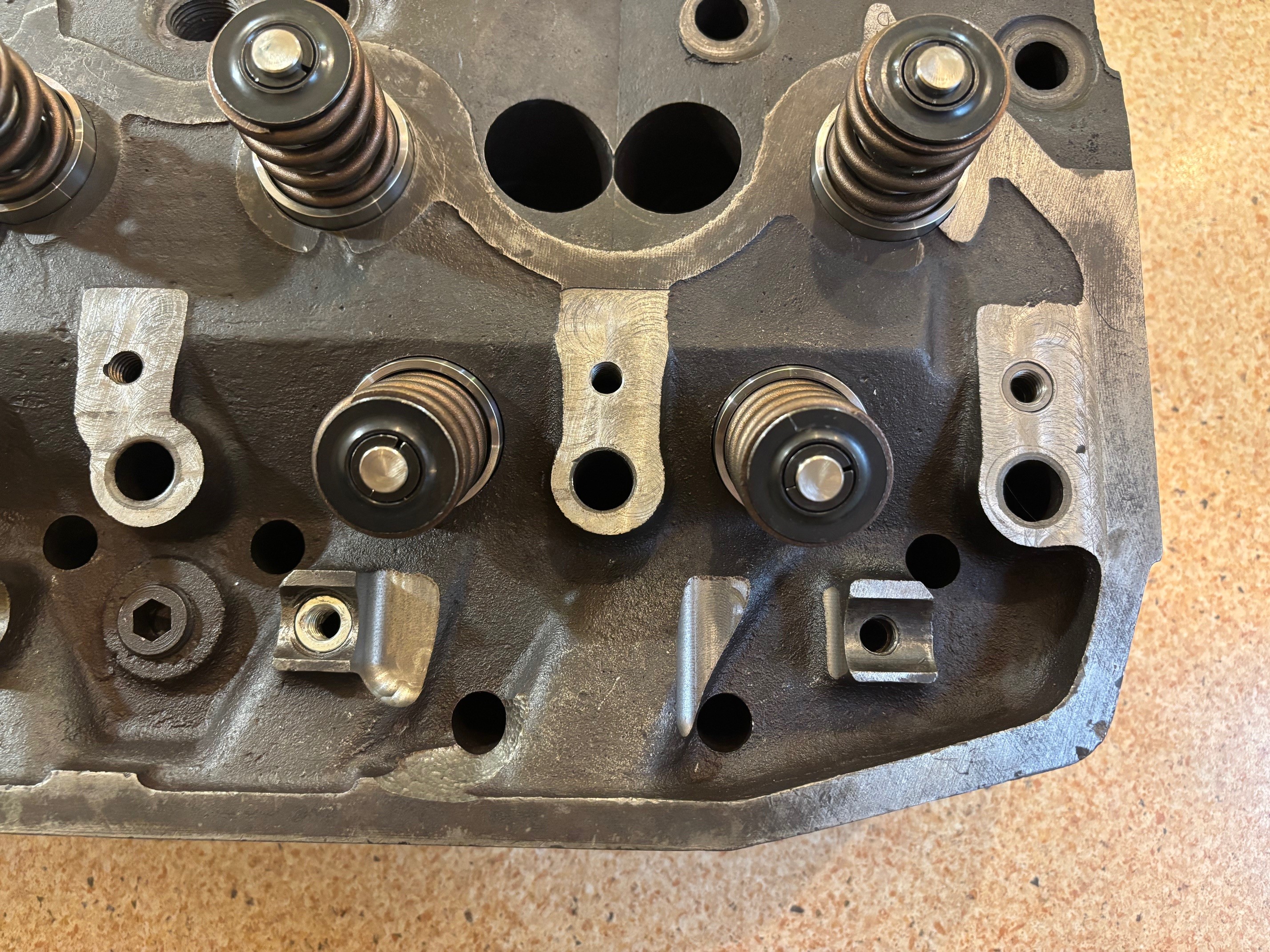

The bare head is a chunky bit of kit, and weighs some 24.5kg. Like most, mine has had a working life. I can see where some casting porosity/void has been weld filled:
Repaired casting goober between numbers 2 and 3.jpg (1.1 MiB) Viewed 12560 times

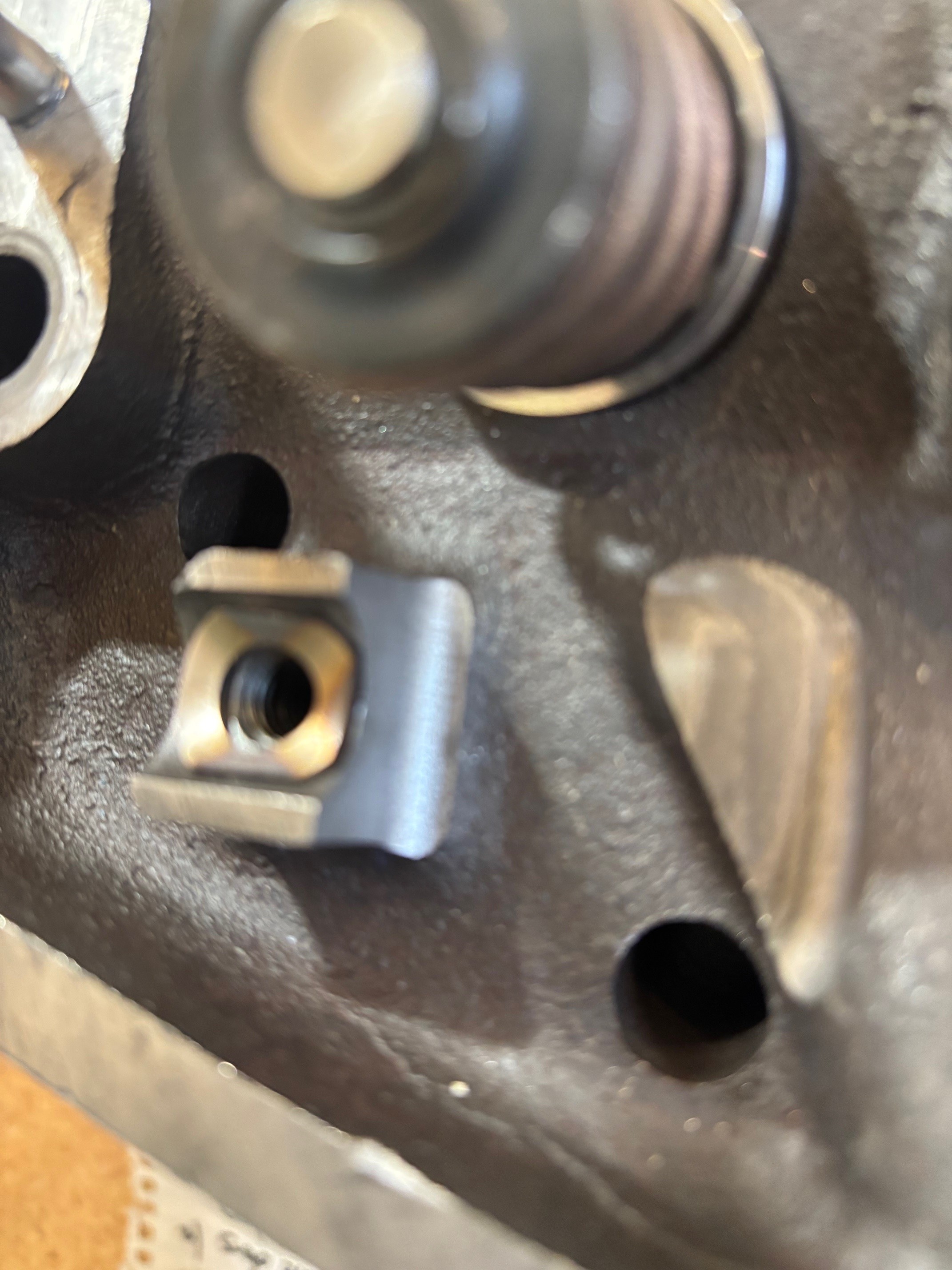

Little wonder these things often leaked water, and that mine was Loctited. Two of the rocker pedestal mounts have also needed thread inserts:
thread inserts near numbers 1 and 2 and machining examples.jpg (1.86 MiB) Viewed 12560 times

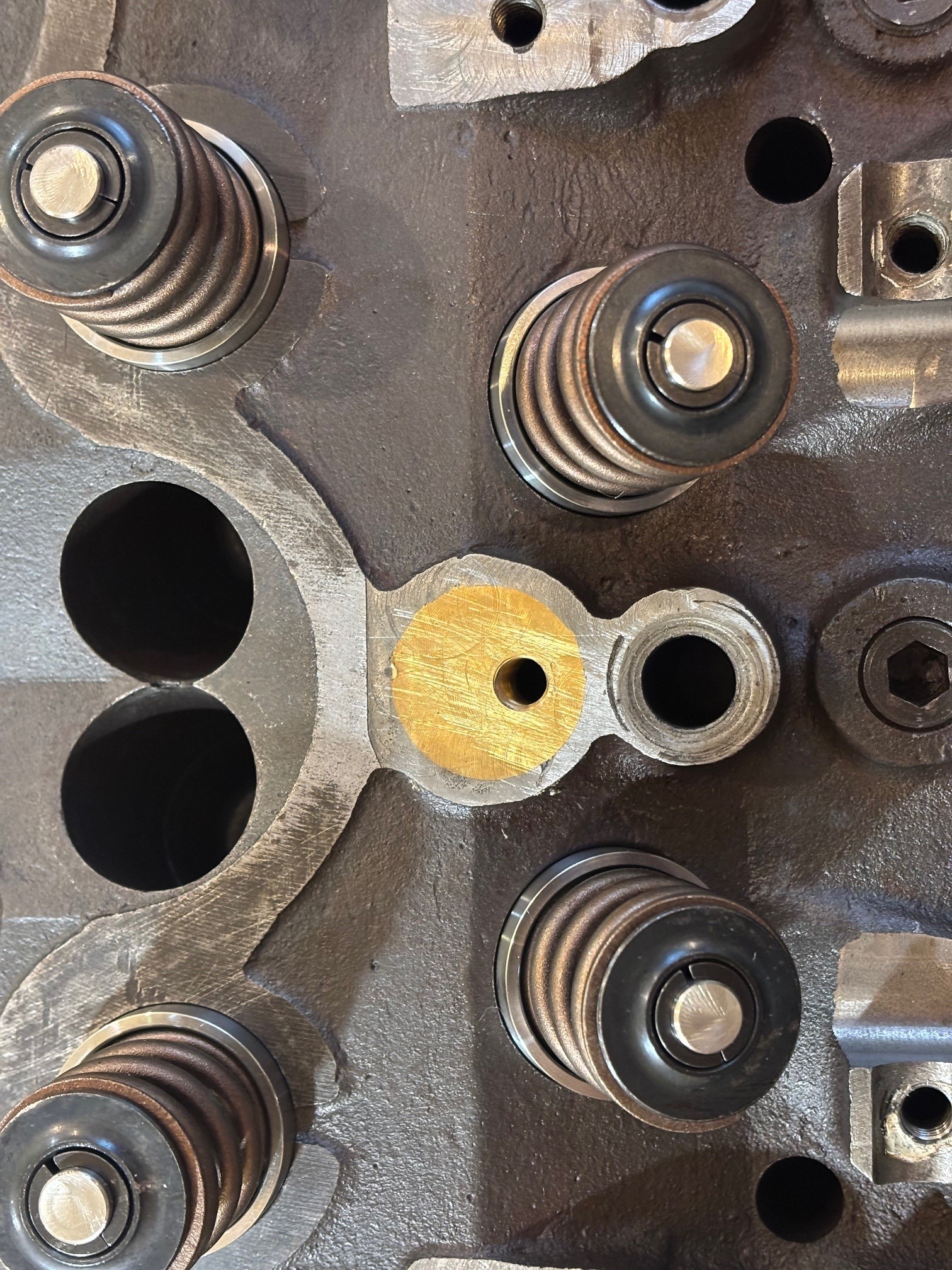

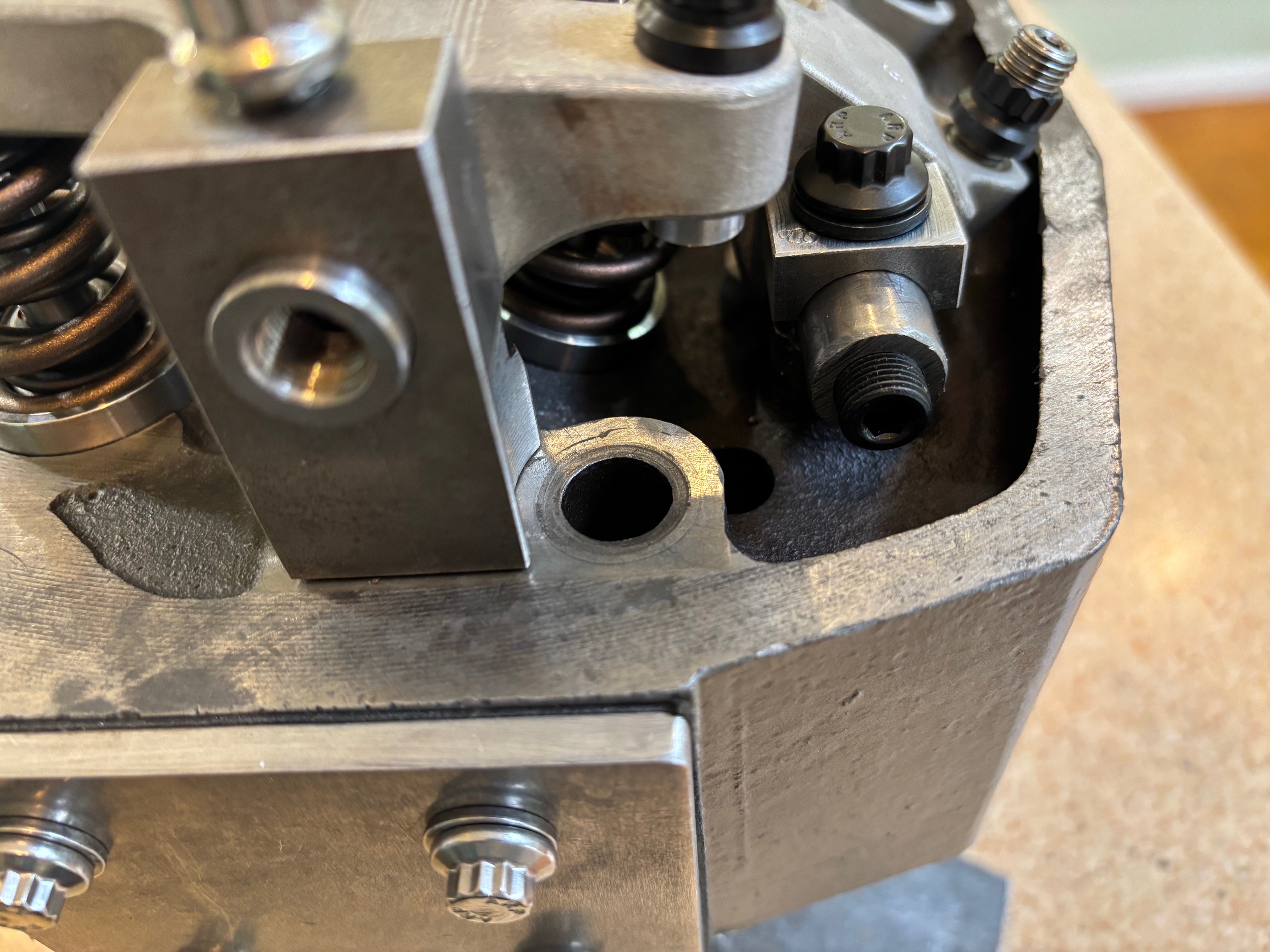

At the bottom of that photo, below number one and number two inlet valves you can see some significant machining work near the rocker pedestals. This is required at each pedestal to allow the roller rockers to clear. They are definitely not a "buy them online and bolt them in" deal. Experience has shown that each Repco head was hand finished from the factory, and needs unique machining. My thanks and kudos to Craig and the guys from HSD who made this work.

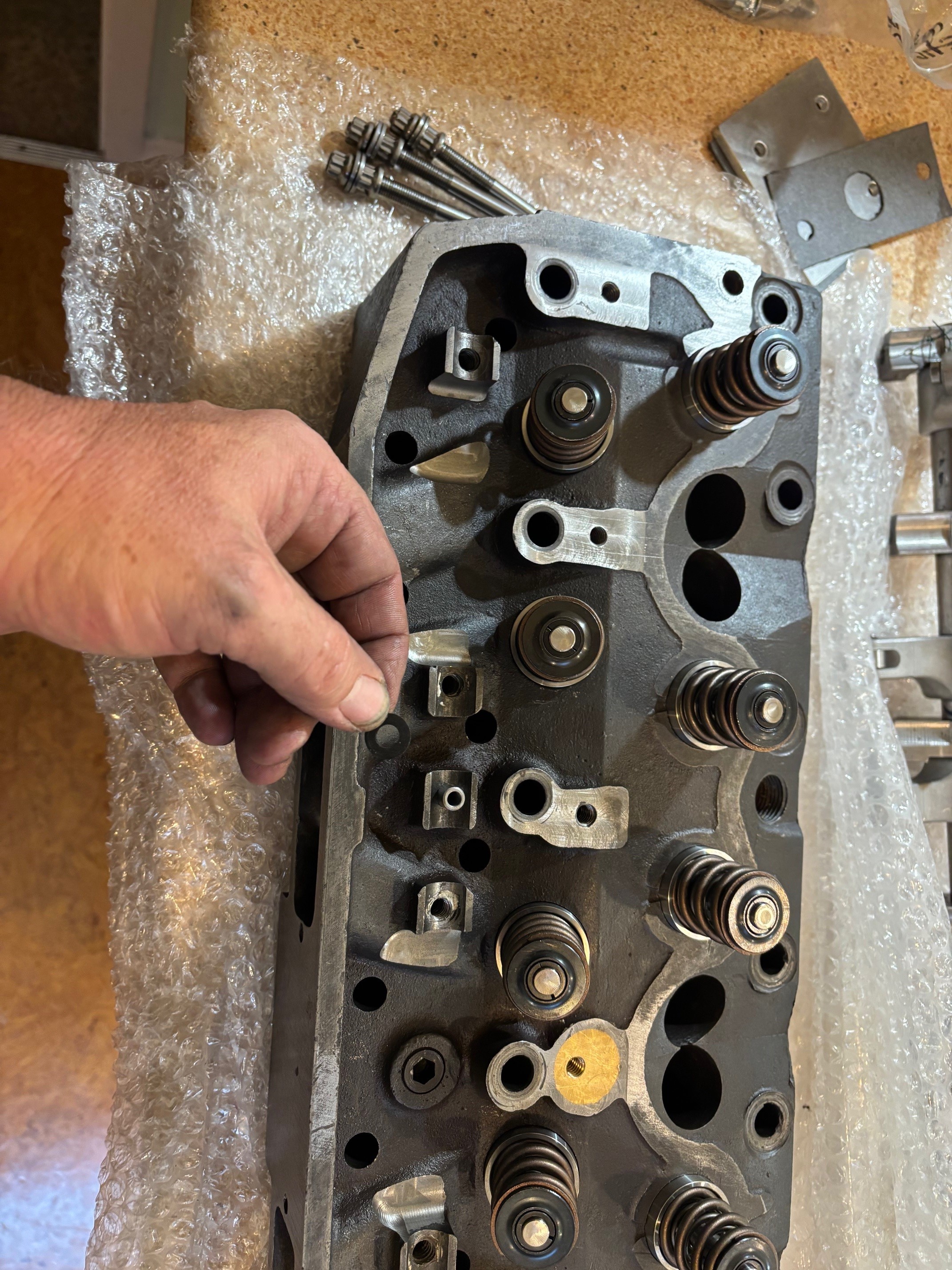

The exhaust rocker shafts are quite long, and tend to flex (a lot) under load. A common way to sort this is to install two additional rocker pedestals. One is a (relatively) easy drill and tap, the other needs a casting plug removed and a threaded brass insert fitted to the head:
Brass insert for six-post upgrade.jpg (974.45 KiB) Viewed 12560 times

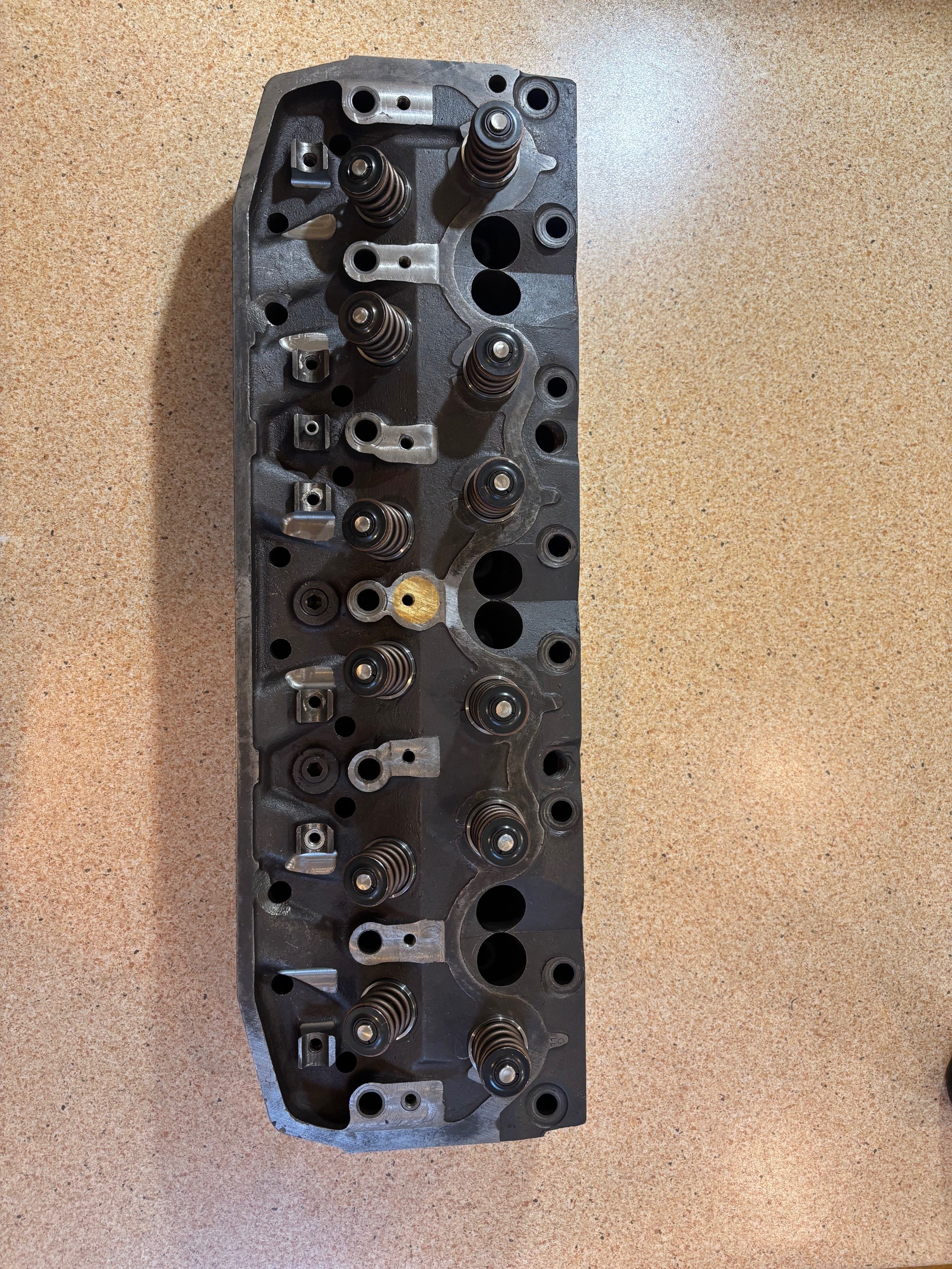

Time to throw the springs in. These are double springs, and have an uninstalled height of 1.643". The HSD guys machined up some valve seat inserts. This gives more flexibility on spring choice as the spring pocket depth can be varied (without shims) and so can the inner and outer seat diameters. Assembly looks like this:
spring and retainer assemblies.jpg (1.13 MiB) Viewed 12559 times

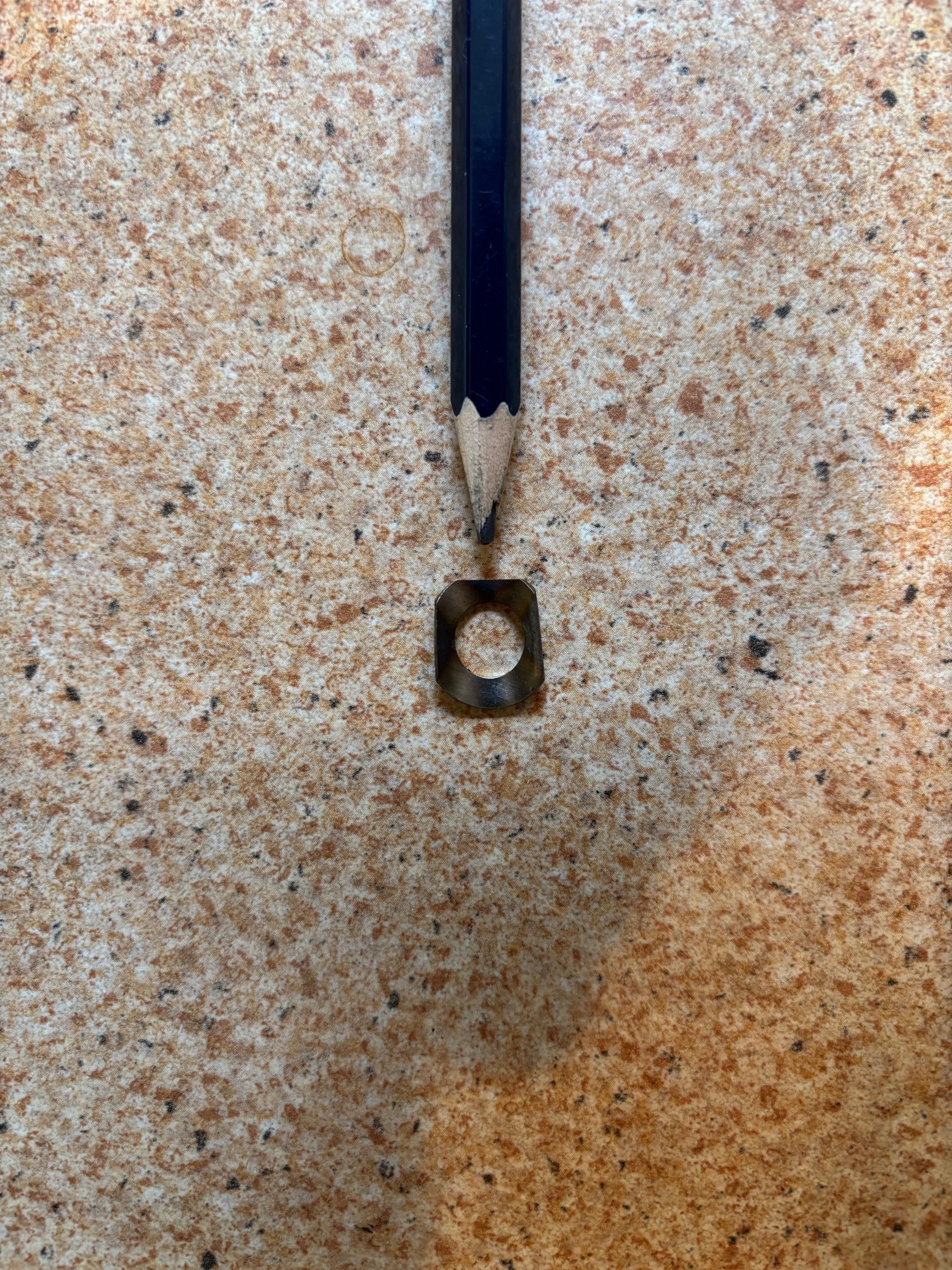

Note to self: inlet and exhaust inserts are different. When I forget this like a durn fool idjit and mix them up, the diagram below will help:
Spring seat inserts.jpg (13.87 KiB) Viewed 12559 times

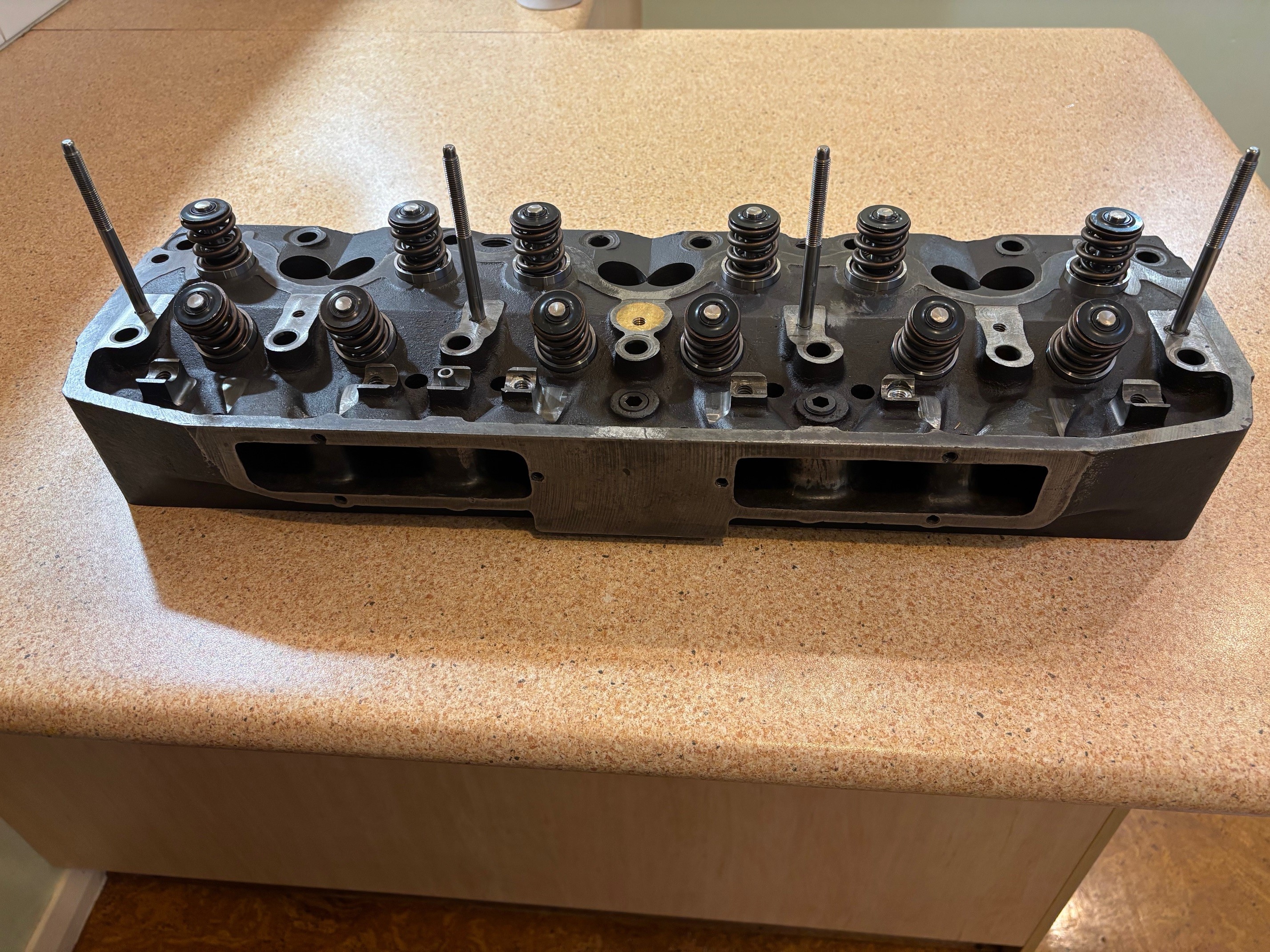

Valves and springs in place:
Valves installed in head.jpg (1.25 MiB) Viewed 12559 times
Springs installed in head.jpg (2.43 MiB) Viewed 12559 times

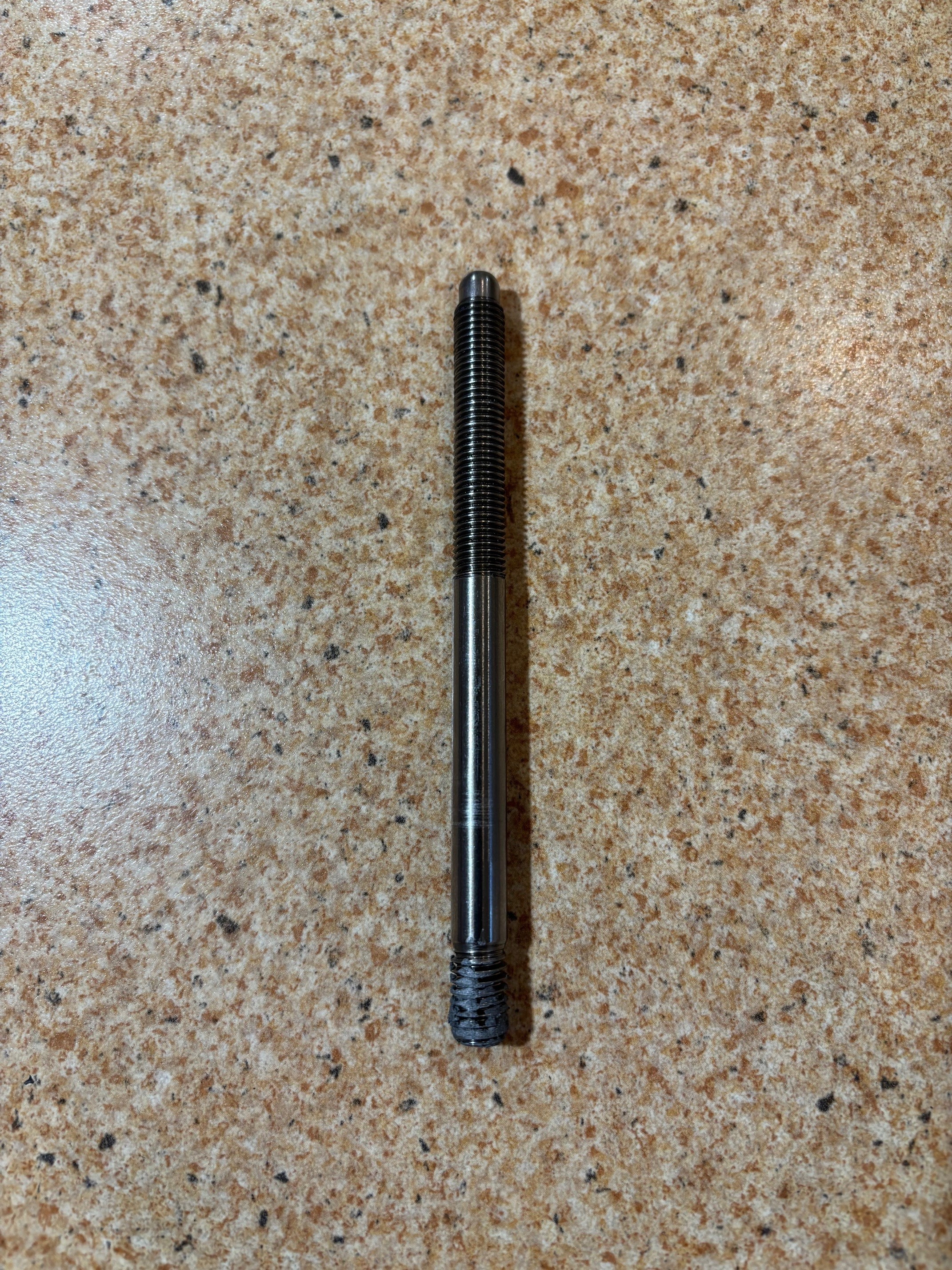

The rocker pedestals are held on with studs. I'm going to replace these with ARP fasteners, so just dummying up for now. Will post details on the ARP stuff once it arrives. Four of the exhaust pedestal studs go through not only the pedestals but the rocker cover too (with two nuts - one on the pedestal, one on the rocker). Studs are 4" long, 5/16" thread, -18UNC one end and -24UNF the other. I’ve used ARP AG4.400-12G stainless bolts, supplied 4.4” and cut to suit. These should look neat poking up through the rocker cover. They are stainless, so antisieze needed to prevent galling.
Rocker cover studs installed in head.jpg (1.81 MiB) Viewed 12558 times
ARP rocker cover stud.jpg (2.48 MiB) Viewed 12558 times

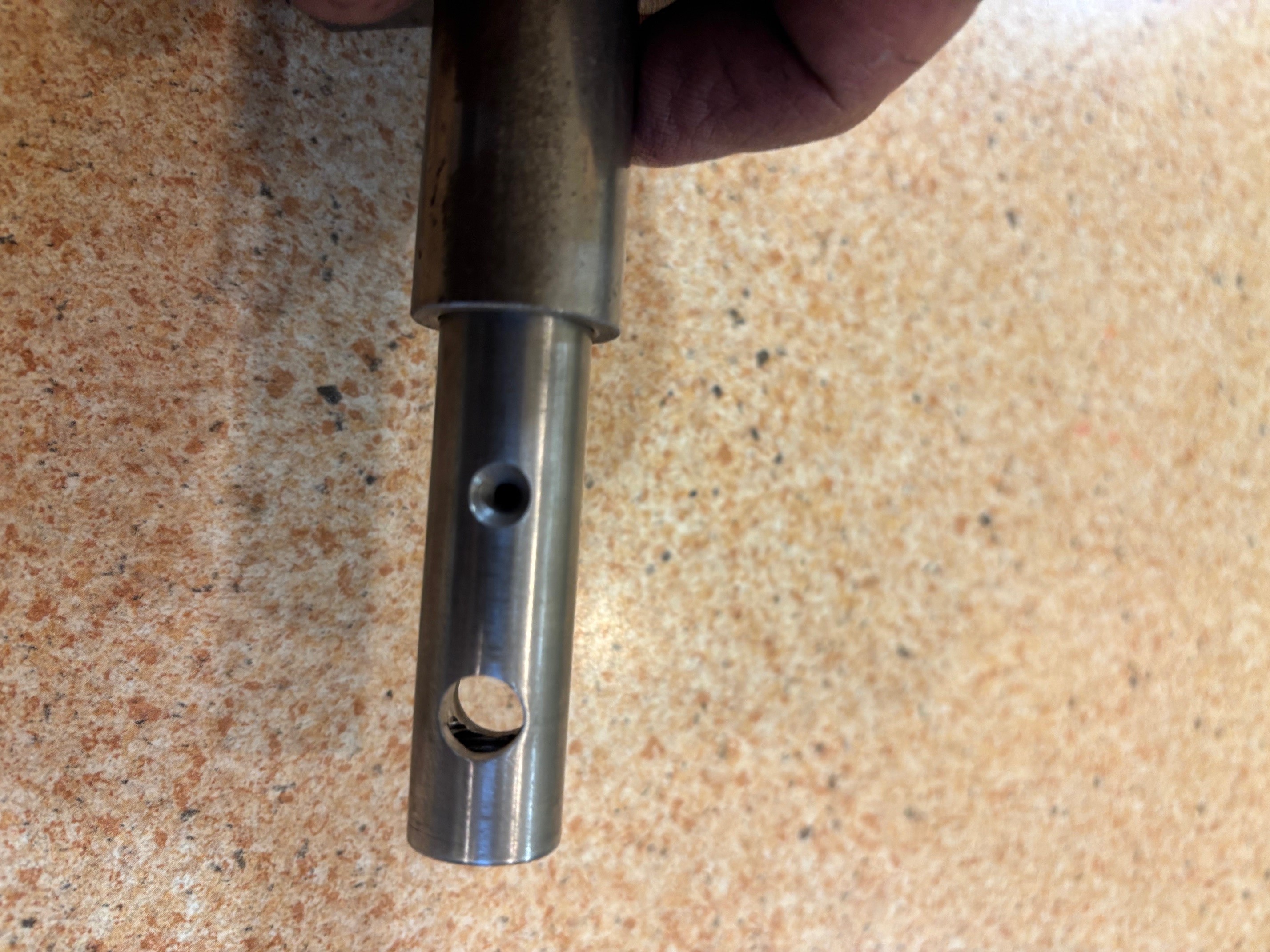

The oil flows though the hollow inlet shaft, and there is a crossover pipe to let it also flow to the hollow exhaust shaft (I'll take more photos of this later). Oil flows along the shafts to each rocker. The shafts had small chamfered holes drilled to feed each rocker bushing:
oil exit hole from shaft to rocker.jpg (1.05 MiB) Viewed 12558 times

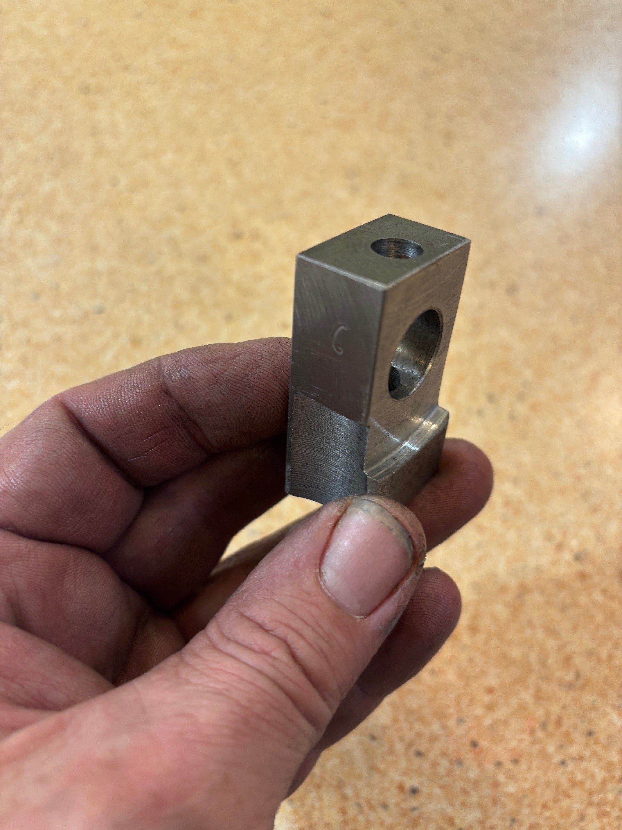

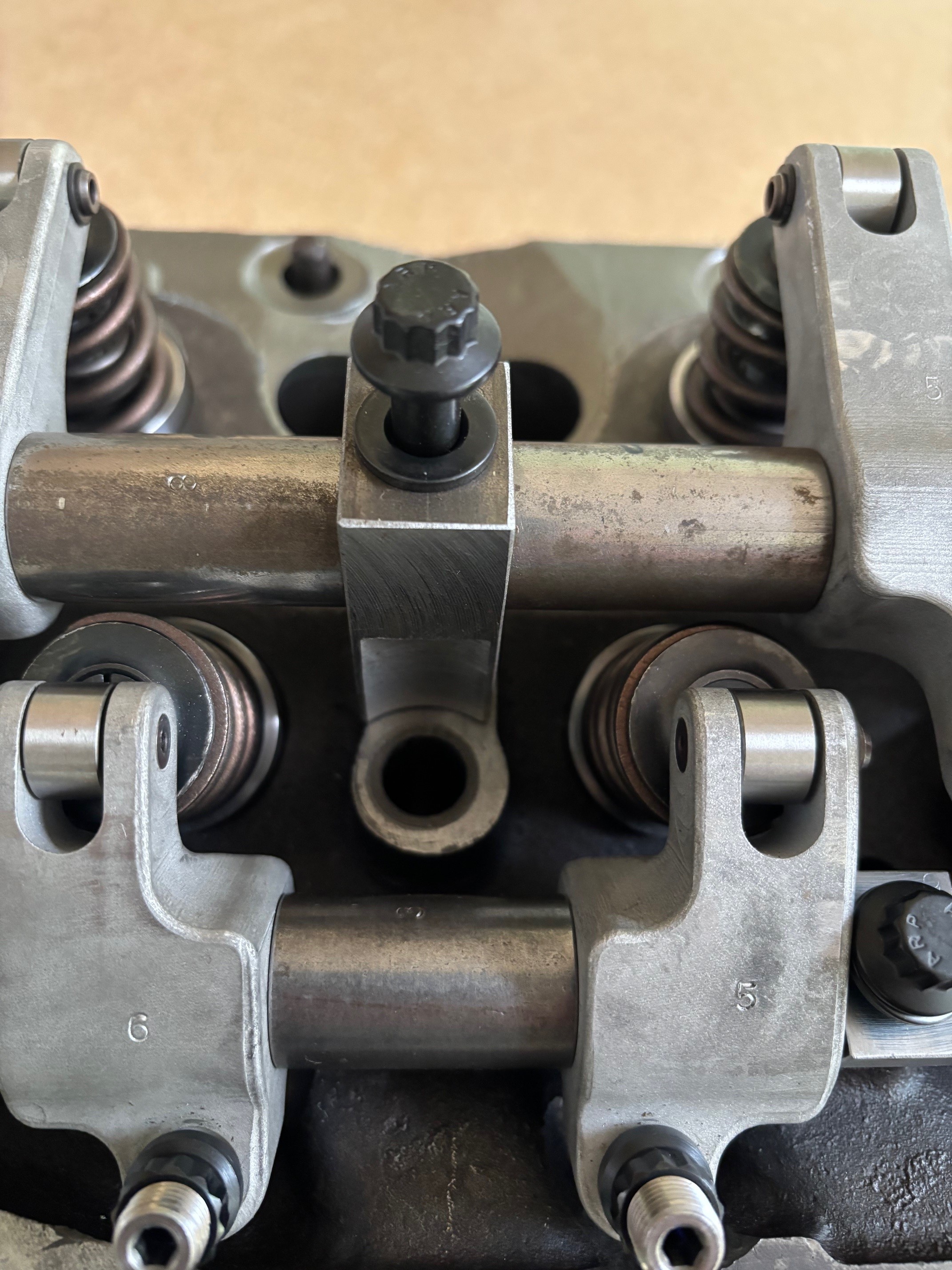

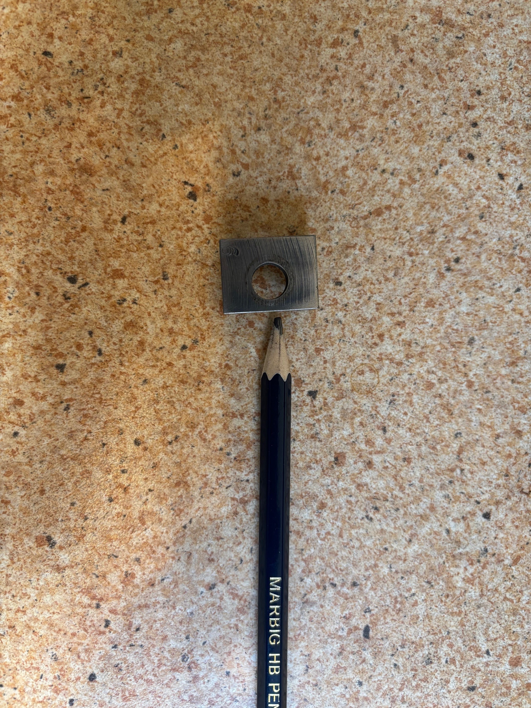

The inlet shaft pedestals have a 45-thou thick spacer placed under each to lift the inlet rocker shaft to the correct roller rocker geometry. Care needs to be taken in assembling these are the bolt holes in the pedestals (and the spacers) are offset. The pencil in the photos below are pointing to the short side of the spacer and pedestals.
offset pedestal cap.jpg (2.27 MiB) Viewed 12417 times
offset inlet pedestal spacer.jpg (2.49 MiB) Viewed 12417 times
inlet pedestal spacer in place.jpg (861.25 KiB) Viewed 12417 times
The assembly looks like the below:
inlet shaft pedestal assembly.jpg (1.78 MiB) Viewed 12417 times

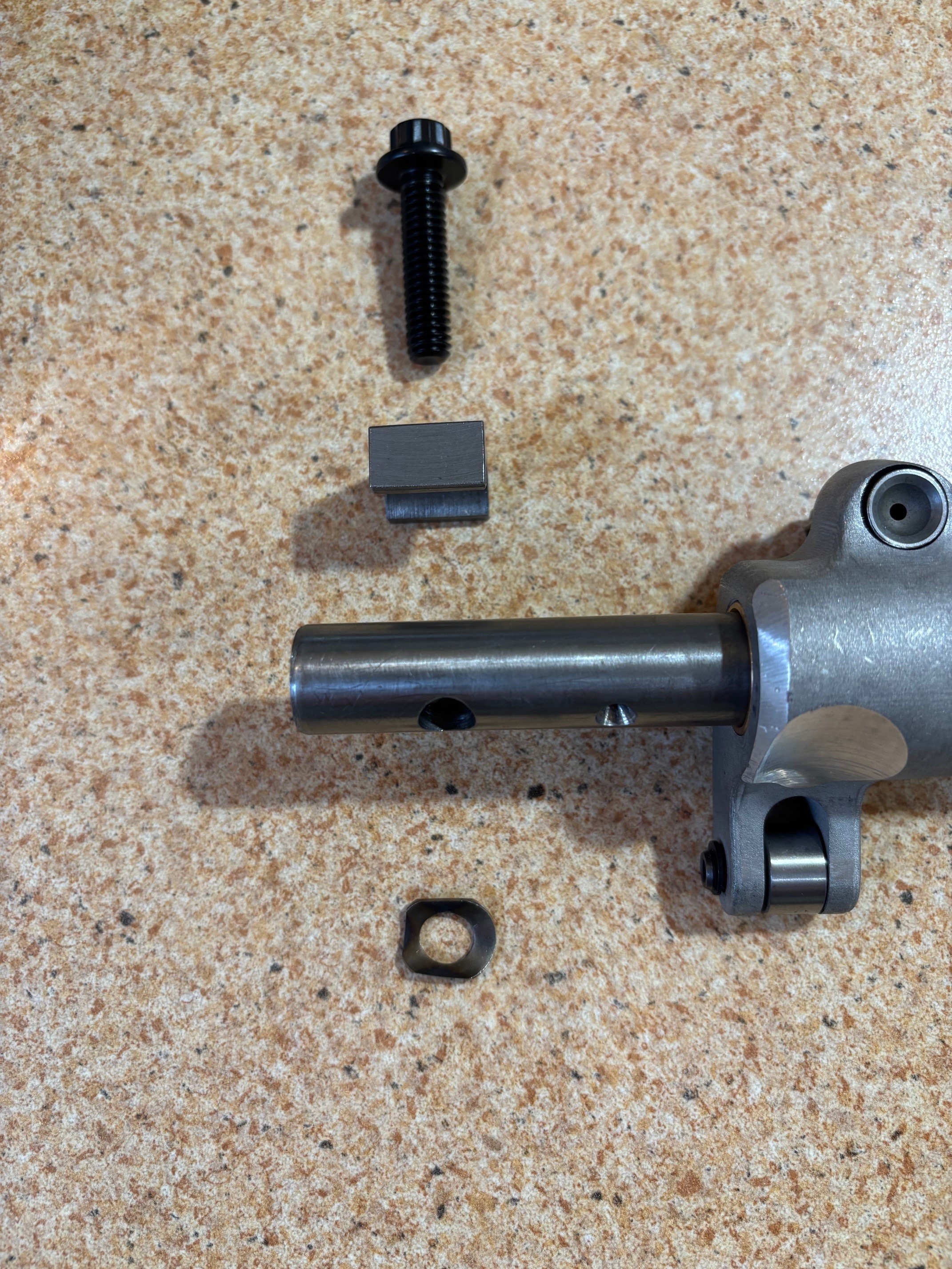

Note that the rockers did have some studs and nuts. I thought I would get cute and use ARP bolts (ARP 641-1250 5/16-18x1.25”). This proved to make the assembly job unbearably fiddly, and the bolt heads are borderline too large for the task (tend to rub on the rocker arms). I will instead use some ARP studs (ARP 100-3219, 5/16-18/24x1.75” OAL) for final assembly.

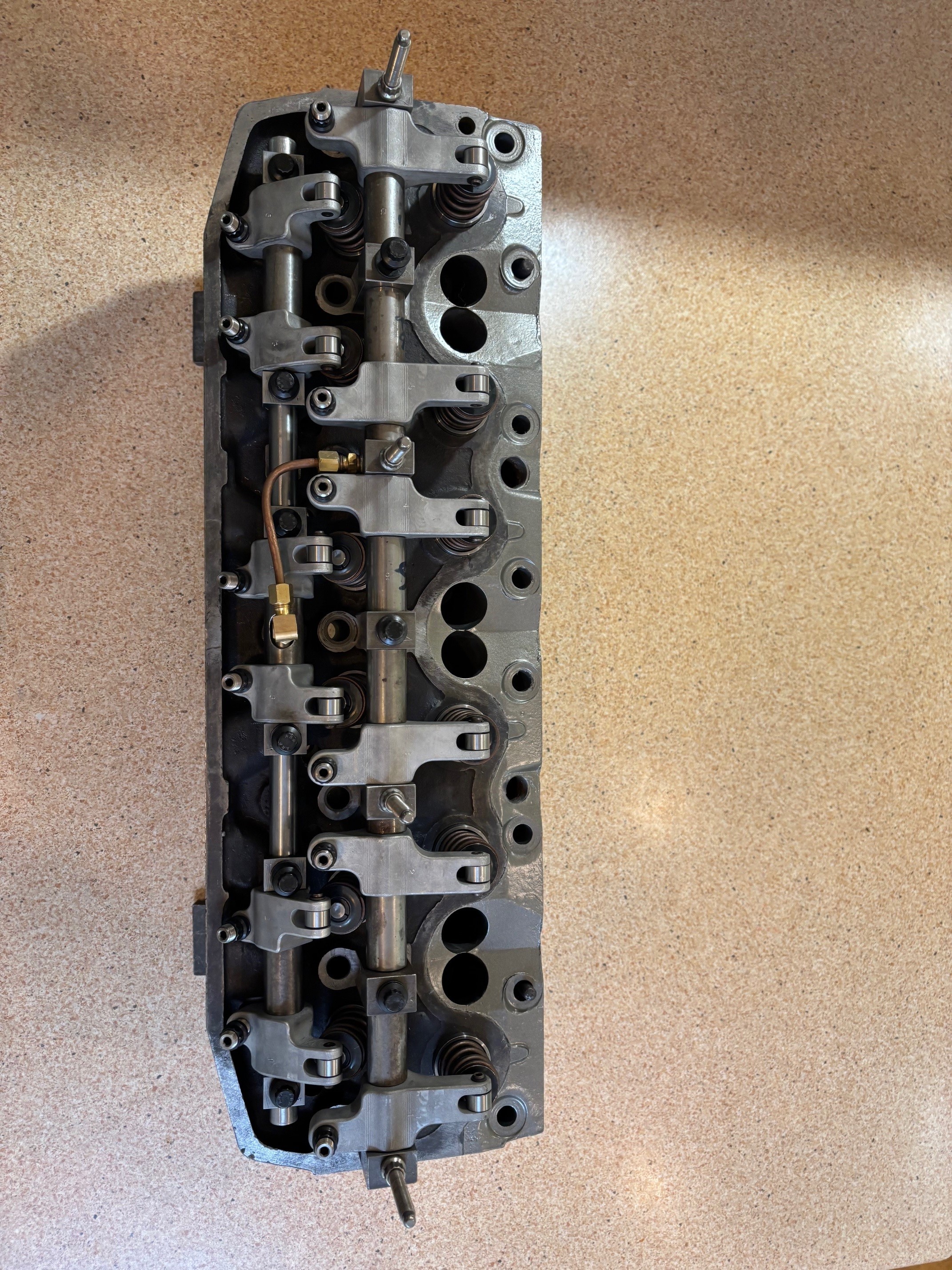

With the inlet and exhaust shafts in place, the twin shafts make the head look like a hemi head:
Looks almost like a hemi head.jpg (1.81 MiB) Viewed 12416 times

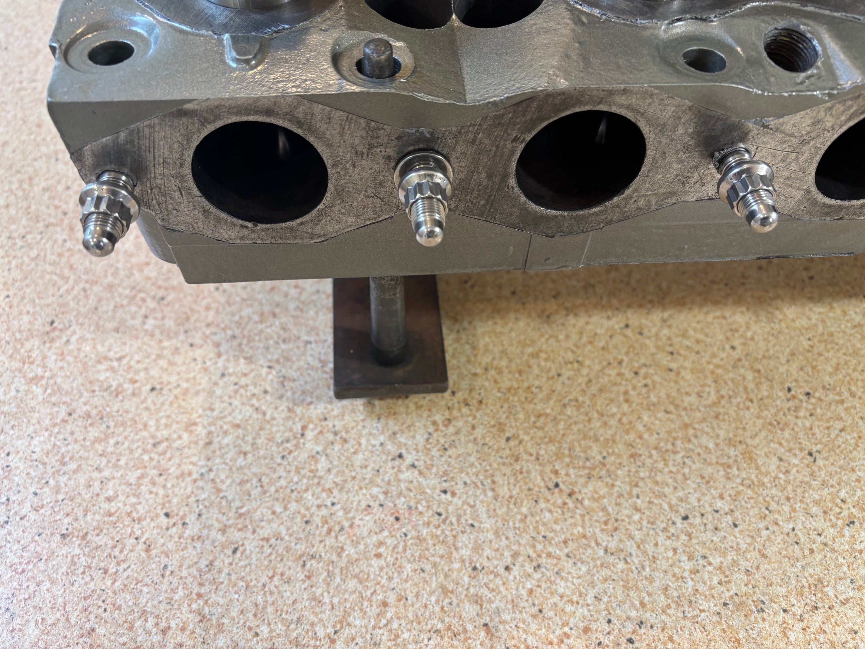

Some exhaust manifold studs were in order (ARP 420-1402 3/8-16/24x1.67”OAL).
exhaust manifold studs.jpg (1.44 MiB) Viewed 12416 times

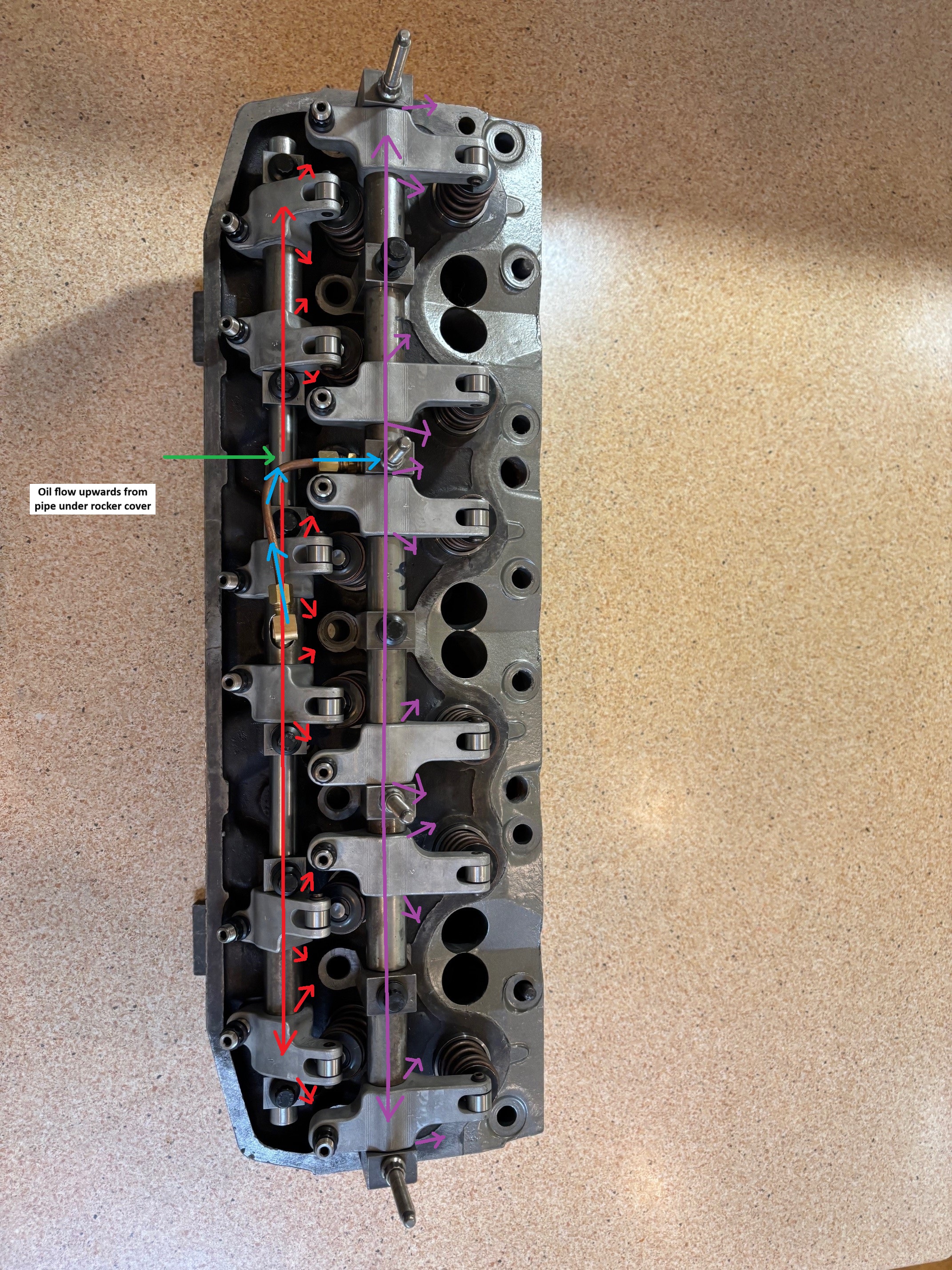

As promised earlier, a better diagram of the oil supply. Oil comes up from the block in a pipe just like a standard grey motor, and connects to the bottom of the head behind the rocker cover (green line in the diagram below). It flows up through one of the inlet pedestals, then along the hollow inlet rocker shaft (red line). At each inlet rocker it squirts into the groove in the rocker arm bronze shaft bushing then squirts out each side of the rocker arm and returns to the sump. Oil flows from the inlet rocker shaft via the crossover pipe (blue line) before running along the hollow exhaust rocker shaft (purple line) and out the sides of each exhaust rocker.
oil flow.jpg (2.38 MiB) Viewed 12414 times
